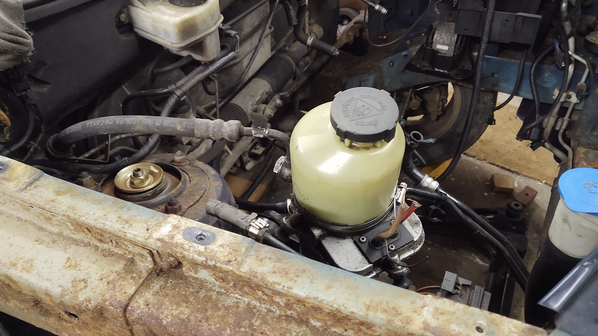

I bought a Zafira power steering pump a few months ago and finally got round to connecting it up last night.
It works but I was a bit surprised at how loud it is and how much current it draws, at idle it was drawing over 20A and when turning the steering it was over 40A.
Is this normal? Judging by the size of the conductors I guess the current draw is normal as they must be 5mm or 6mm sq
Do other folk have it operating only when moving slowly?
I could live with the noise but 200W to 300W for power steering alone seems a lot.

That's a good point, thanks for your reply.
Maybe its the way I have connected it.

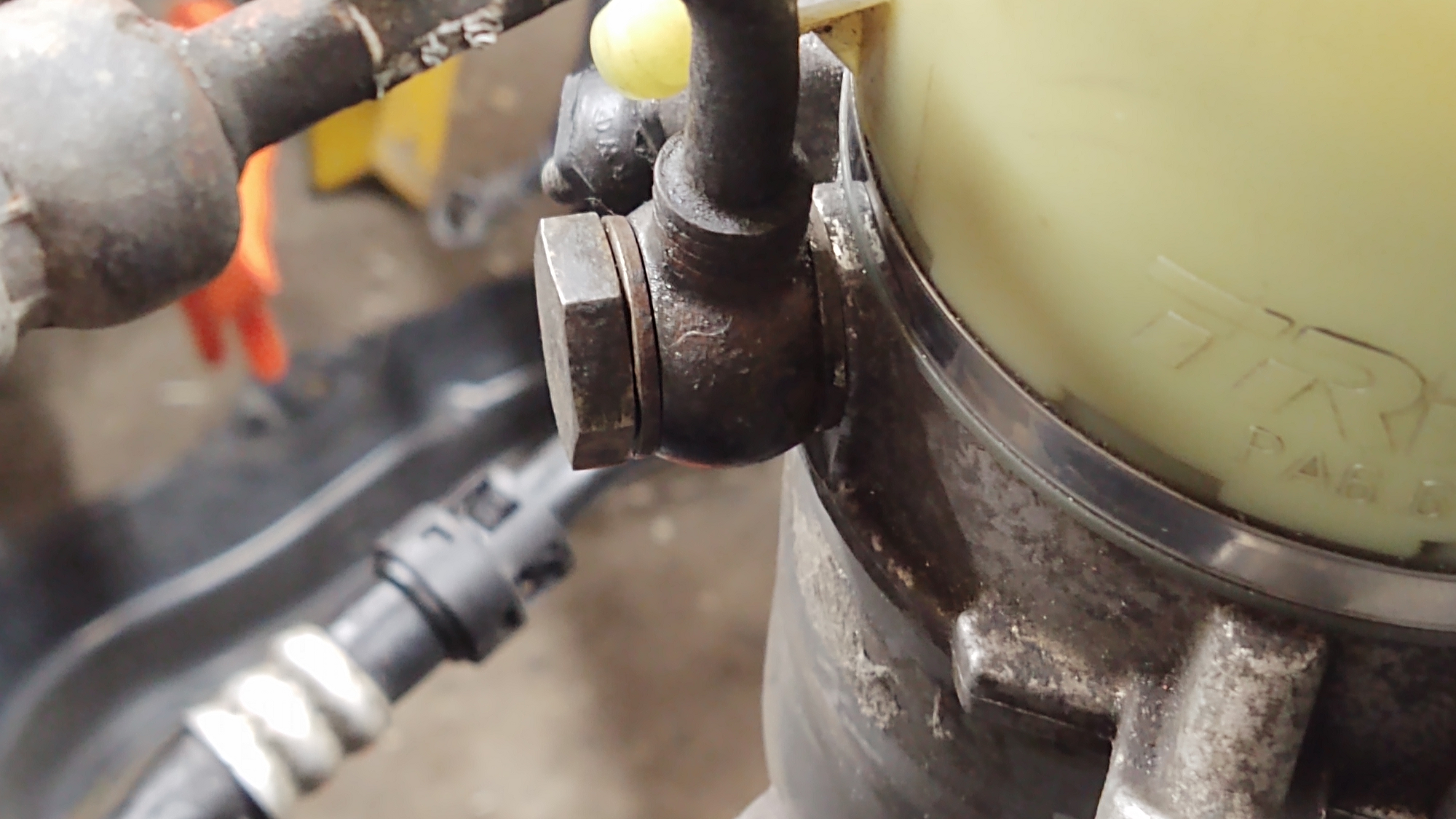

The original power steering pump had a banjo bolt connection and for testing I just flattened the area around the case of the pump where the old hose bolted in and bolted the banjo connector to the casing. It works but maybe isn't ideal.
I'll get a new hose made up at a local hydraulics shop with the correct connector and see how it goes.

Actually, I think, the pump gets louder and uses more amps when fluid starts moving. A power steering rack should block fluid movement when there's no torque applied to the steering wheel. Then the pump only needs to maintain pressure without flow, which consumes less power.
I agree it's loud and uses lots of current, but there should be a huge difference in the sound and current in idle vs. when turning. As there isn't, the rack could be bad.
Alternatively, maybe the rack might have an overpressure valve that causes flow at the pressure the pump wants to maintain?

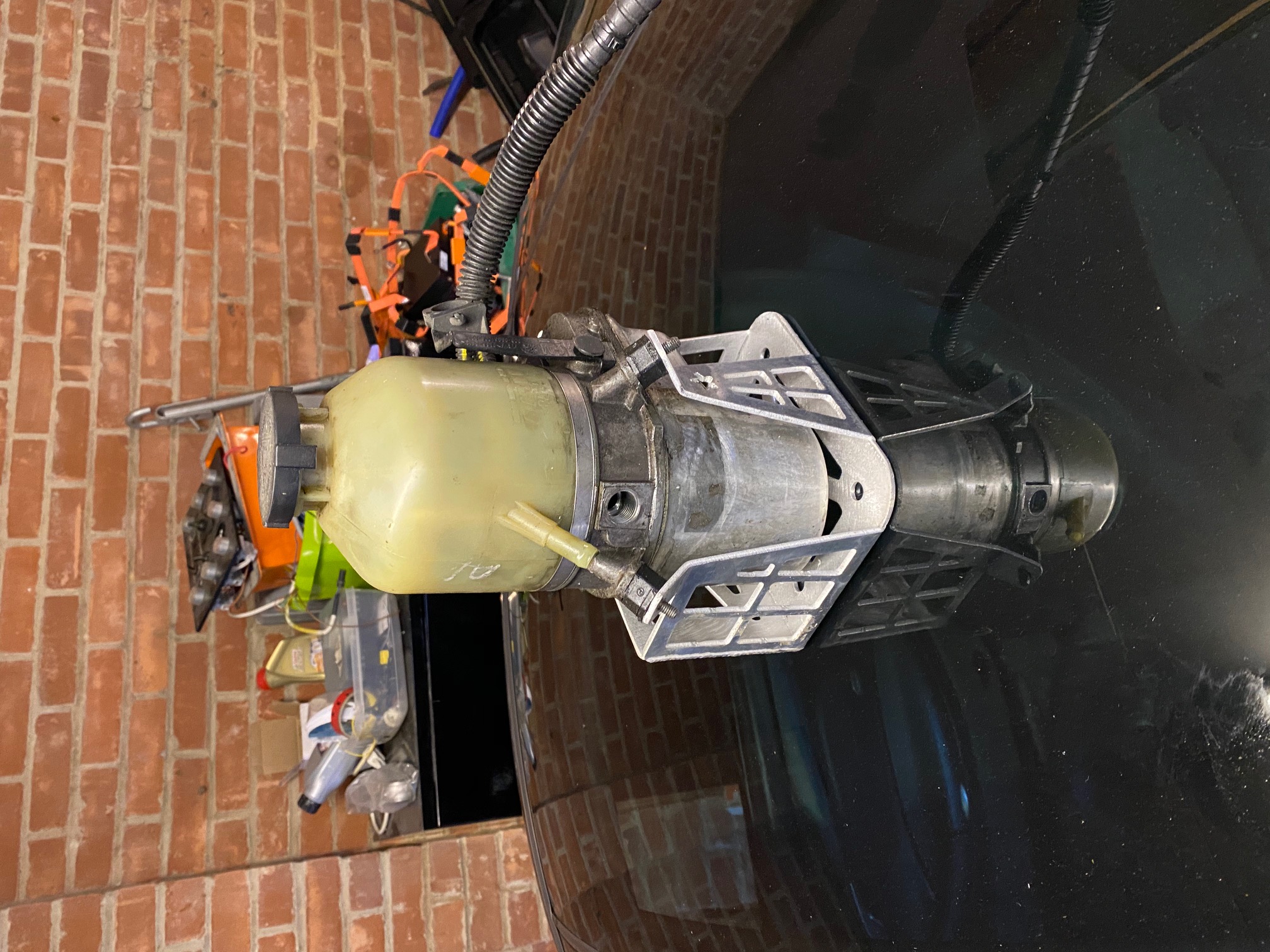

Little thread hijack, but I recently had this frame made, giving flexibility to mount the pump on a vertical or horizontal surface. Shouldn't be too hard to reproduce, so If anyone needs one I can get prices to make a few more.

I haven't connected it up because I cant bear the noise. :D
I'm thinking about mounting it in a sound proof box. 8-)

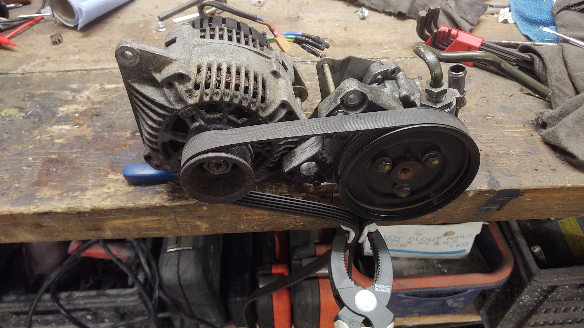

No mate. I didn't try that but for now I've given up on this pump.
I've removed the Freelander power steering pump and am rigging it up with an alternator motor (I built an ebike with it a couple of years ago :) ) that I plan to drive from an ebike controller.
Since taking this photo I've found an old belt that is short enough and made a bracket for it so hopefully I'll be back later with another update.

It'll be very interesting to know how much current and steering assist that will result in. I'm planning to experiment with something similar myself for a cheap "low-tech" conversion. I'm wondering if there would be a little bit of remaining power for air conditioning also...
