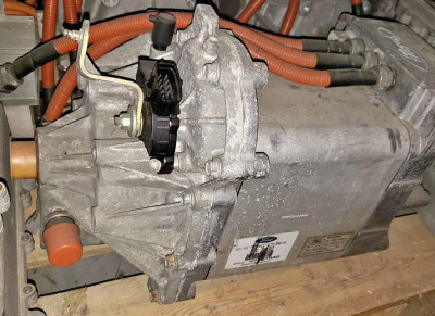

Welp. I’m in Canada, about to pickup 2 semiens 1pv motors from the ev Ford rangers from back in the day.

What kw are they? just at the planning stage, I want the boat to plane so need good size motor, I was thinking of 120 Kw. Any ideas on this.

the inverter you choose will determine the power output. But these motors I think can handle 200kw pushed threw them before heat soakColm Spain wrote: ↑Sat Dec 26, 2020 12:08 pm What kw are they? just at the planning stage, I want the boat to plane so need good size motor, I was thinking of 120 Kw. Any ideas on this.

Are you selling one, what price and model no. is it. what inverter would yo recommend.

It’s the classic Siemens ev motor 1PV5133.
I have a gen 3 Prius inverter I’m going to use to drive one.

Looking for 900 Canadian,Colm Spain wrote: ↑Mon Jan 04, 2021 9:18 pm Hi , what price are you looking for the motor and I can check out shipping cost.
Many thanks Colm.
they weight about 200lbs.
And it has a reduction gear box still on it.

Hi, the price seems fine , as you said the carriage might be expensive, will check it out, do you know the difference between 1PV5133 and 1PV5135 motors.

From my understanding the face plate, shaft and bearings are different. As it’s built around the gear box. Other than that they are identical.Colm Spain wrote: ↑Sun Jan 17, 2021 6:59 pm Hi, the price seems fine , as you said the carriage might be expensive, will check it out, do you know the difference between 1PV5133 and 1PV5135 motors.
Thanks Colm.
There’s quite a bit of miss information on these Siemens motors. power ratting, etc.
But the motor may actually weight around 140lbs
Use without the gear box just requires swapping to sealed bearings.
