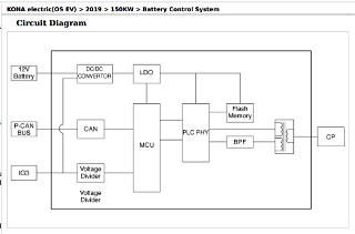

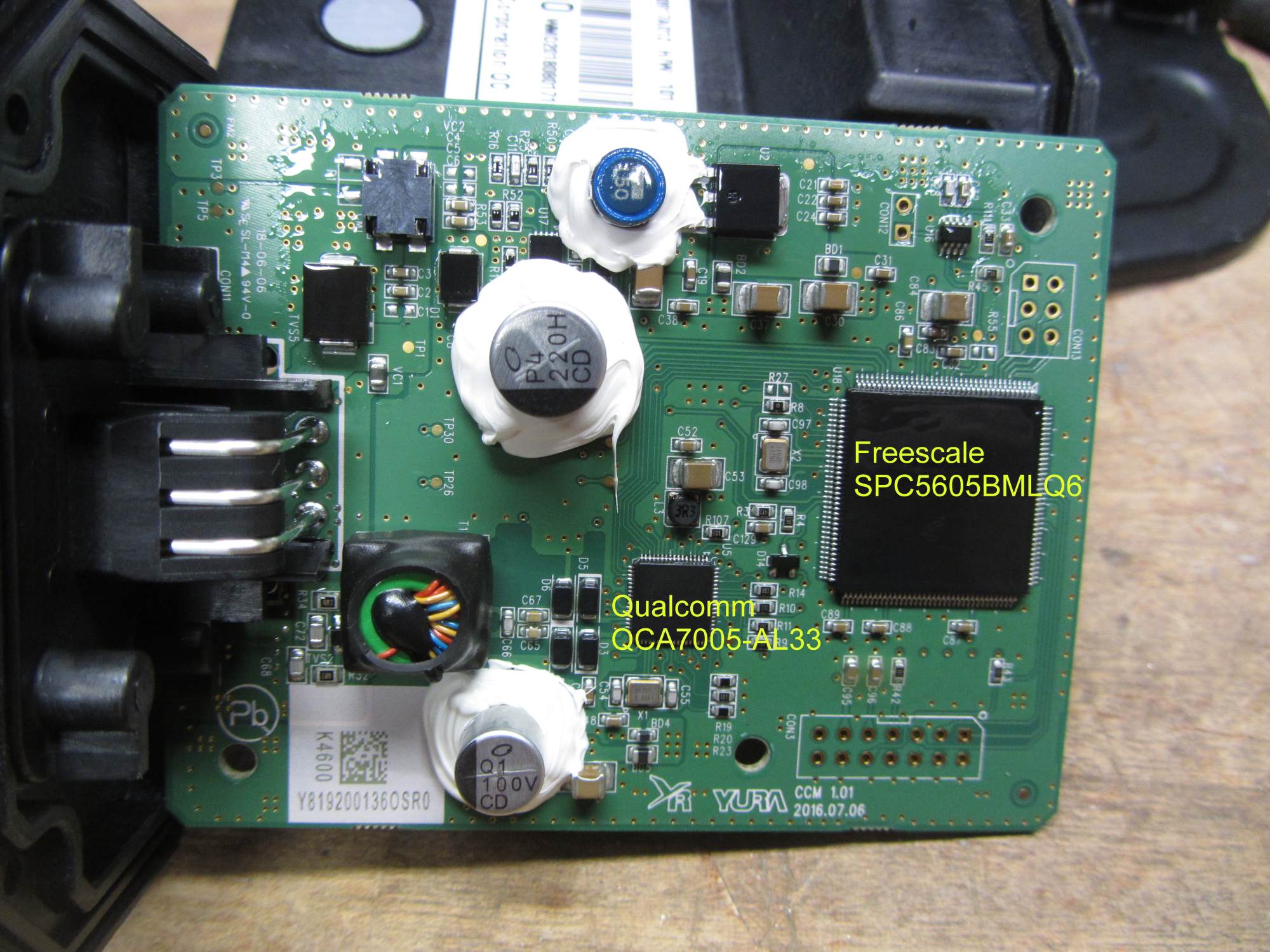

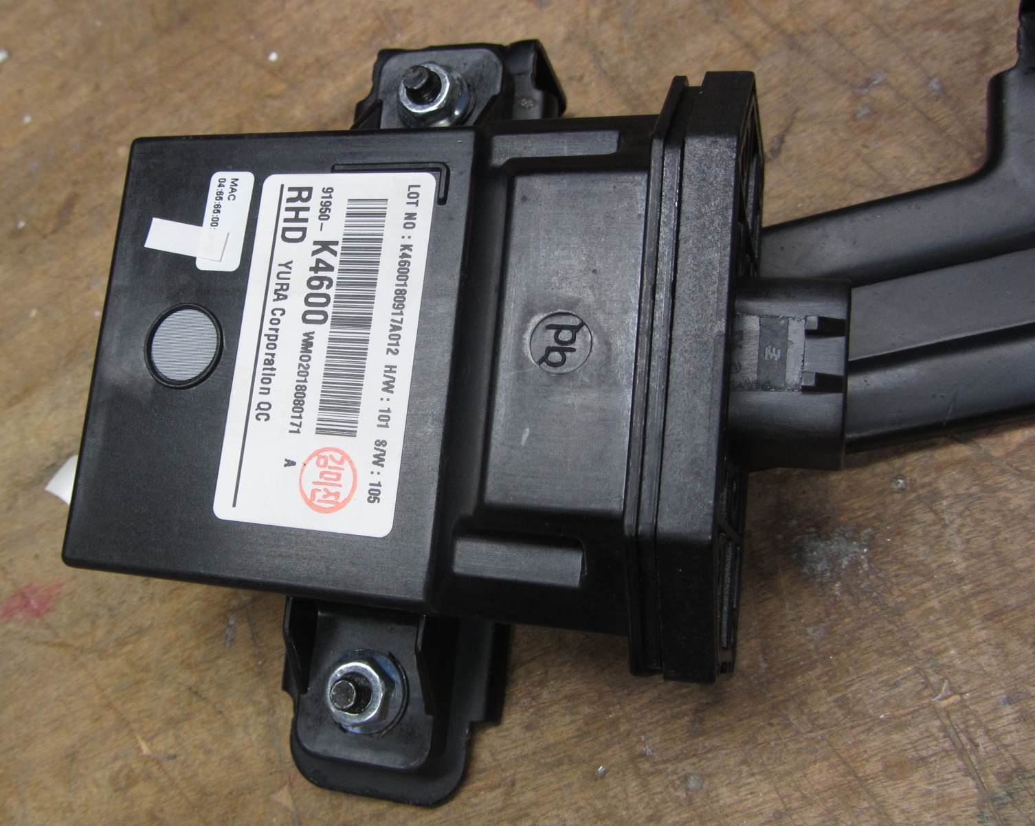

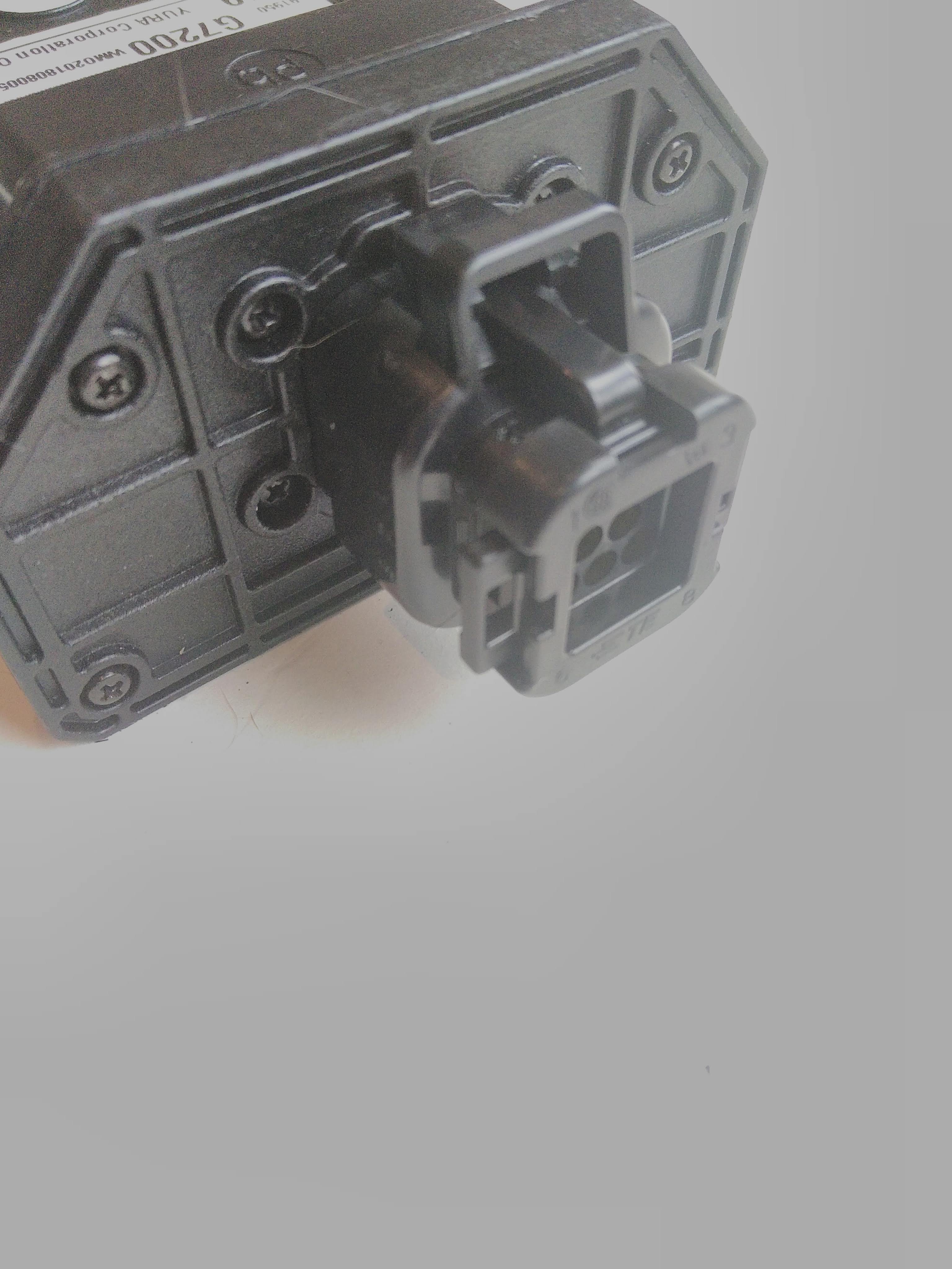

Ok so it's maybe a bit early for this to be useful in a DIY project but thought I'd stick this here in case someone finds it useful or interesting.
The Kona ( and presumably E-Niro, maybe ioniq) uses a CCS-to-CAN bridge, which is a self-contained module that doesn't do anything else, so if reverse-engineered, is a potentially nice little unit for DIY use.
It's located above the steering column, necessitating the "sit upside down in drivers seat" position to get at!

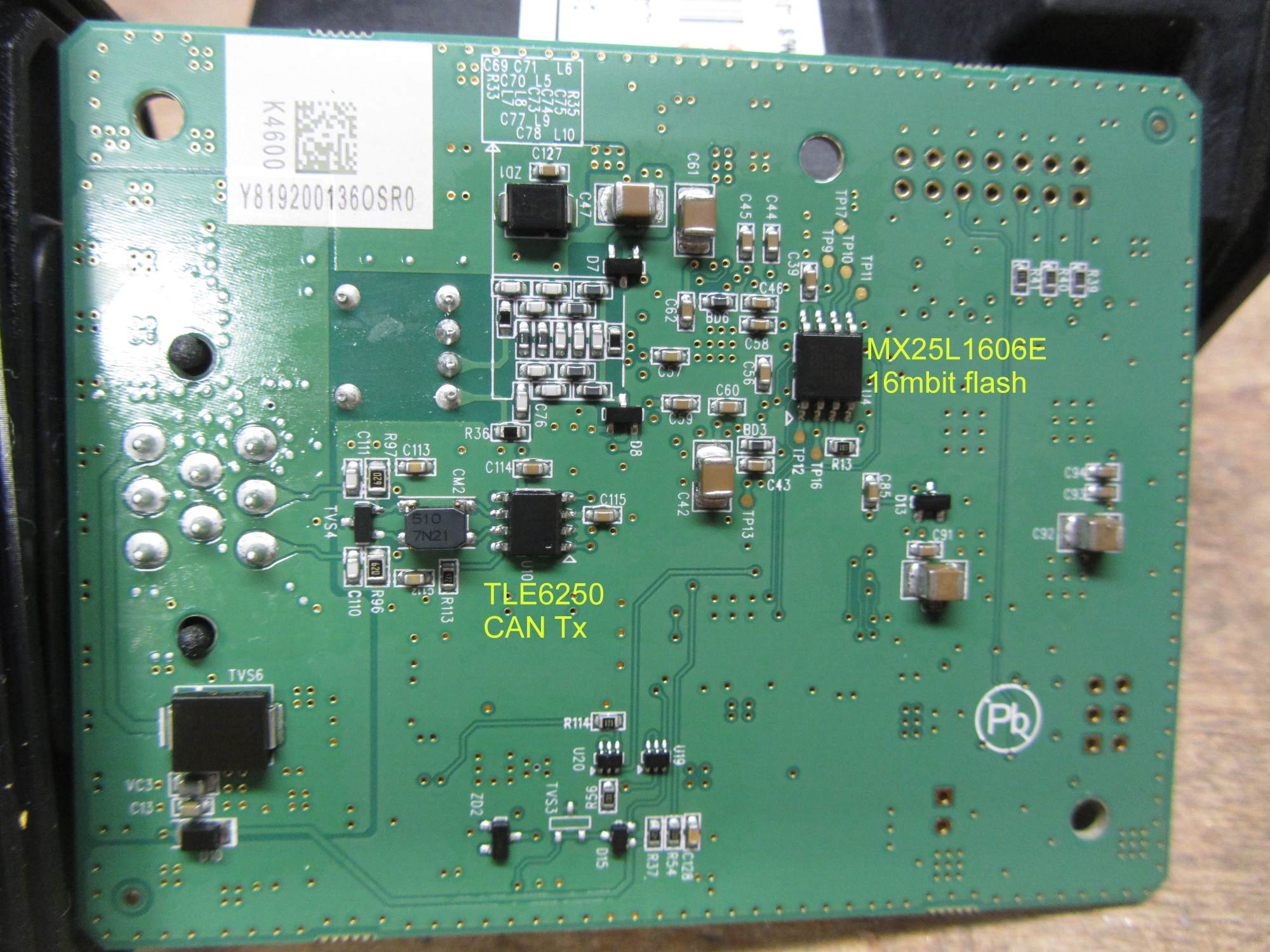

I have extracted the contents of the flash chip - from the visible symbols it appears to be a generic Qualcomm QCA7xxx driver. The main MCU has quite a lot of flash so there;s probably stuff in there as well. I won't post it here as it has my MAC address but if anyone is seriously interested get in touch.
Hyundai part number is 91950-K4500 ( LDH) 91950-K4600 ( RHD). Available for U$400-odd here https://www.hyundaipartsdeal.com/genuin ... k4500.html

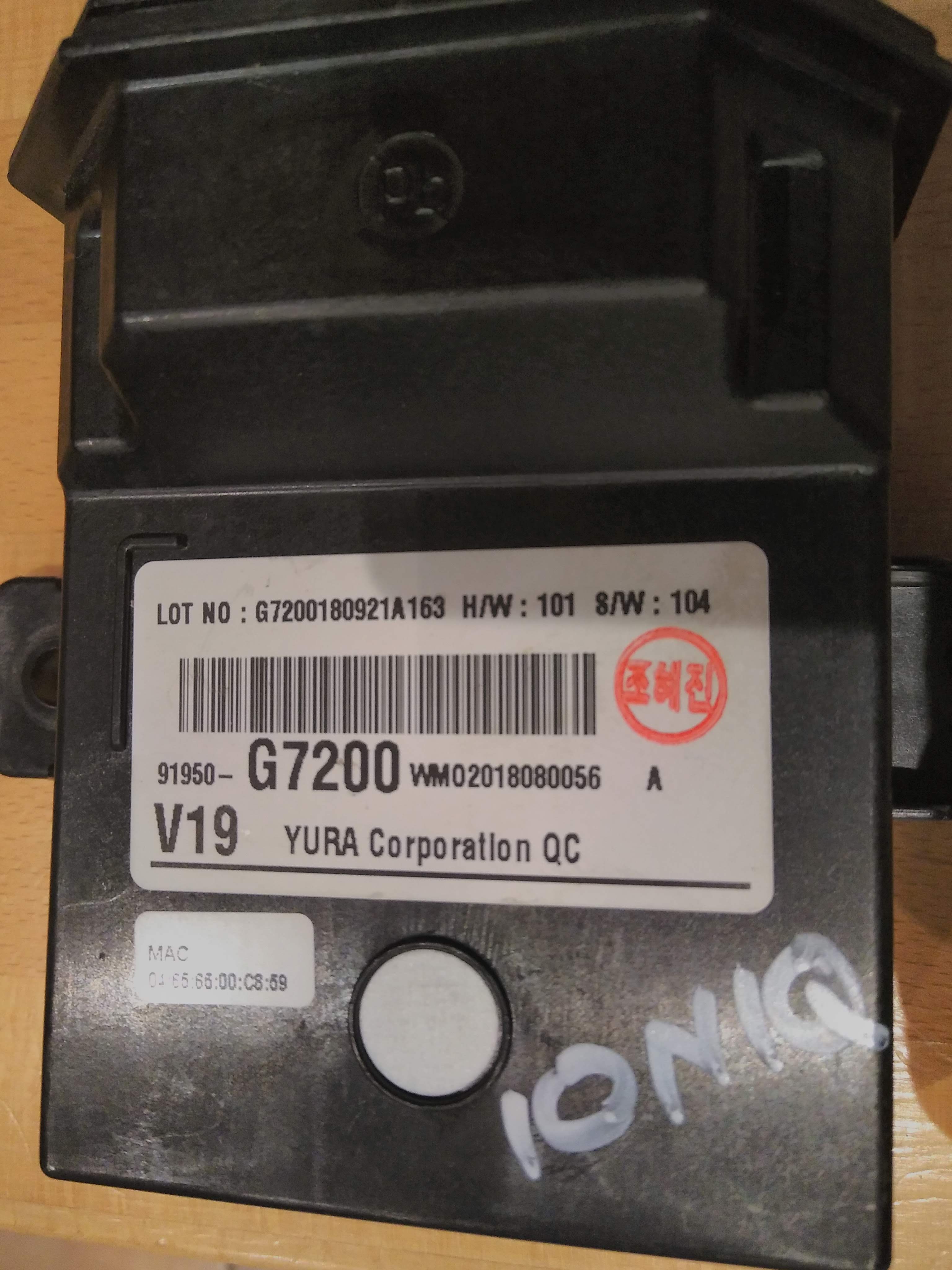

I just had a look on the parts site at the 2017-19 Ioniq, and this appears to have a module which looks identical, similar part number 91950-G7200. Also listed a lot cheaper - $248
https://www.hyundaipartsdeal.com/genuin ... g7200.html

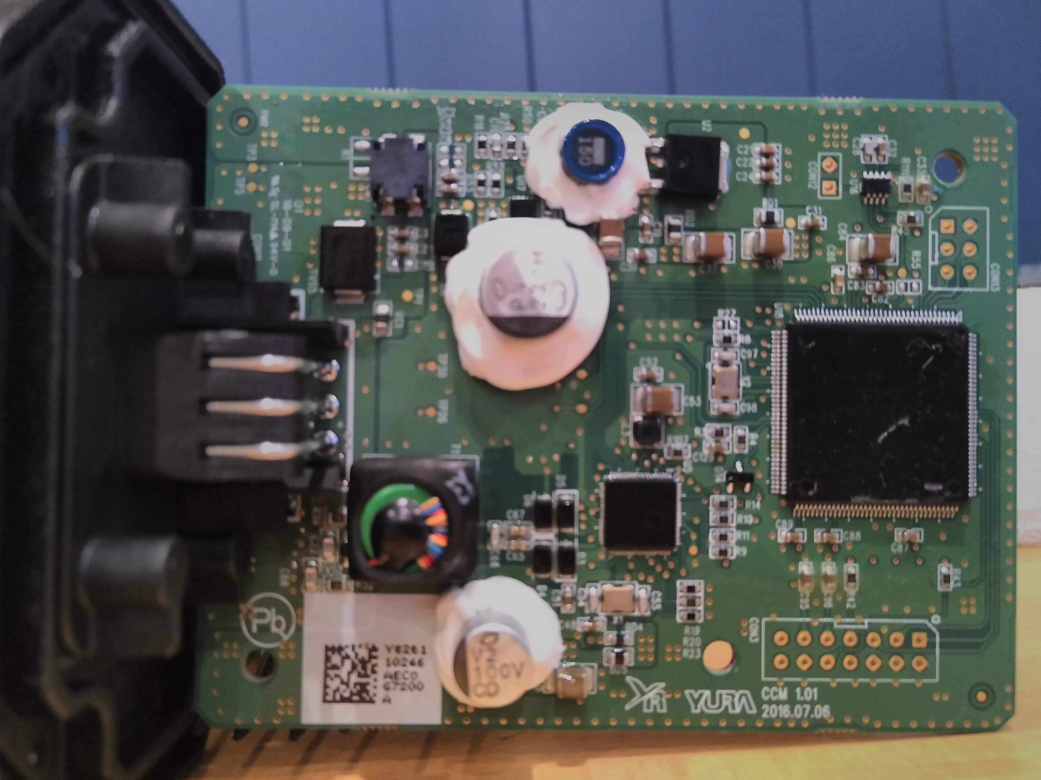

Interesting to see the sealant round the capacitors. That's exactly what we did to solve the vibration issues that I referred to the other week.

It looks like there is a version with the part number of 91950-G7300 used as well.mikeselectricstuff wrote: ↑Tue Nov 17, 2020 6:05 pm I just had a look on the parts site at the 2017-19 Ioniq, and this appears to have a module which looks identical, similar part number 91950-G7200. Also listed a lot cheaper - $248
https://www.hyundaipartsoem.com/oem-par ... 91950g7300
Jamie

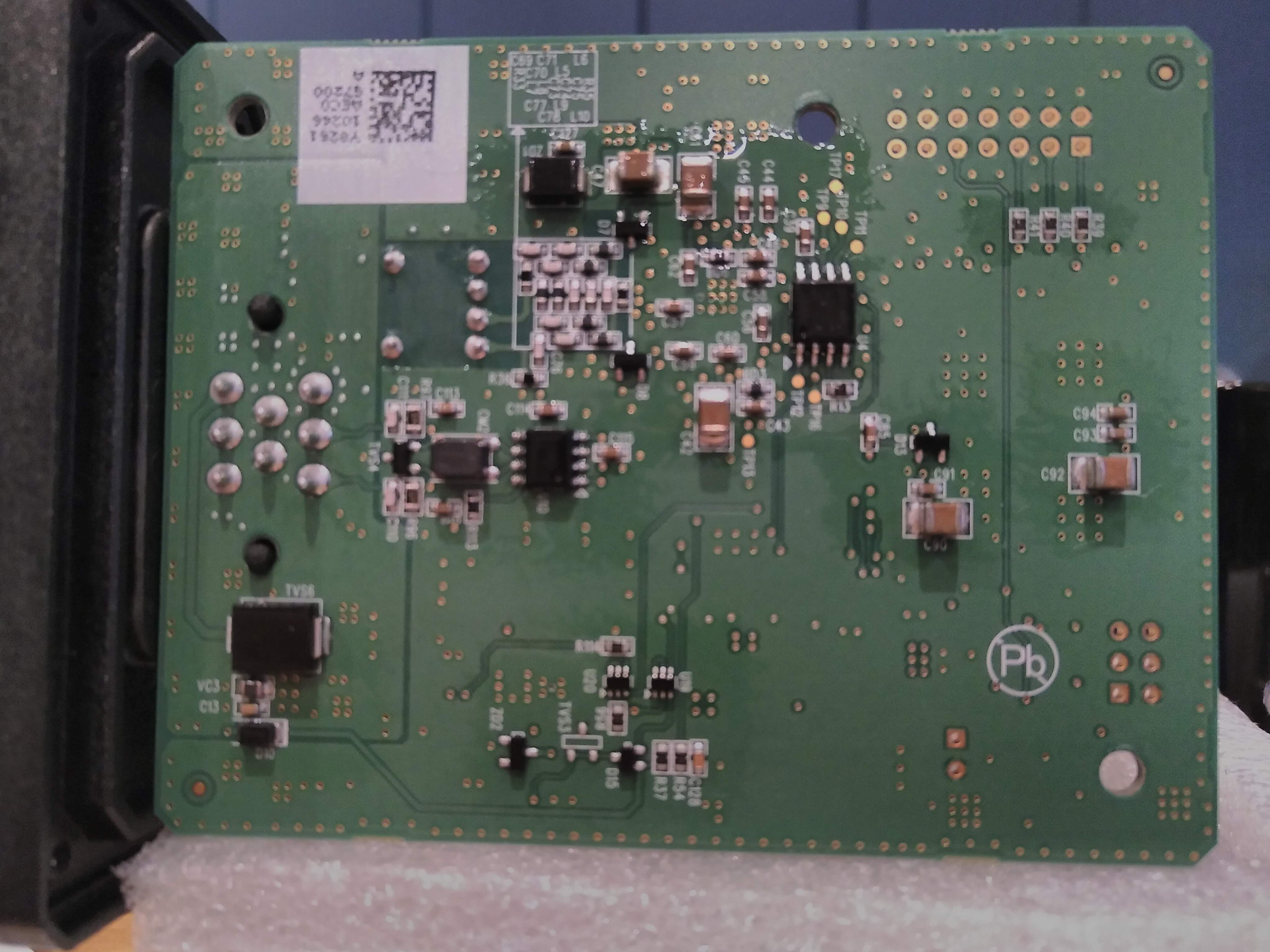

91950-G7200 purchased for 70 euro in Ireland today. Looks like the same PCB
- mdrobnak
- Posts: 692
- Been thanked: 5 times
Re: Hyundai Kona CCS controller
Looks like 1 revision back on software (104 vs 105), barcode is slightly different on PCB, but otherwise looks real similar - and 70 Euros is a steal compared to retail prices listed above

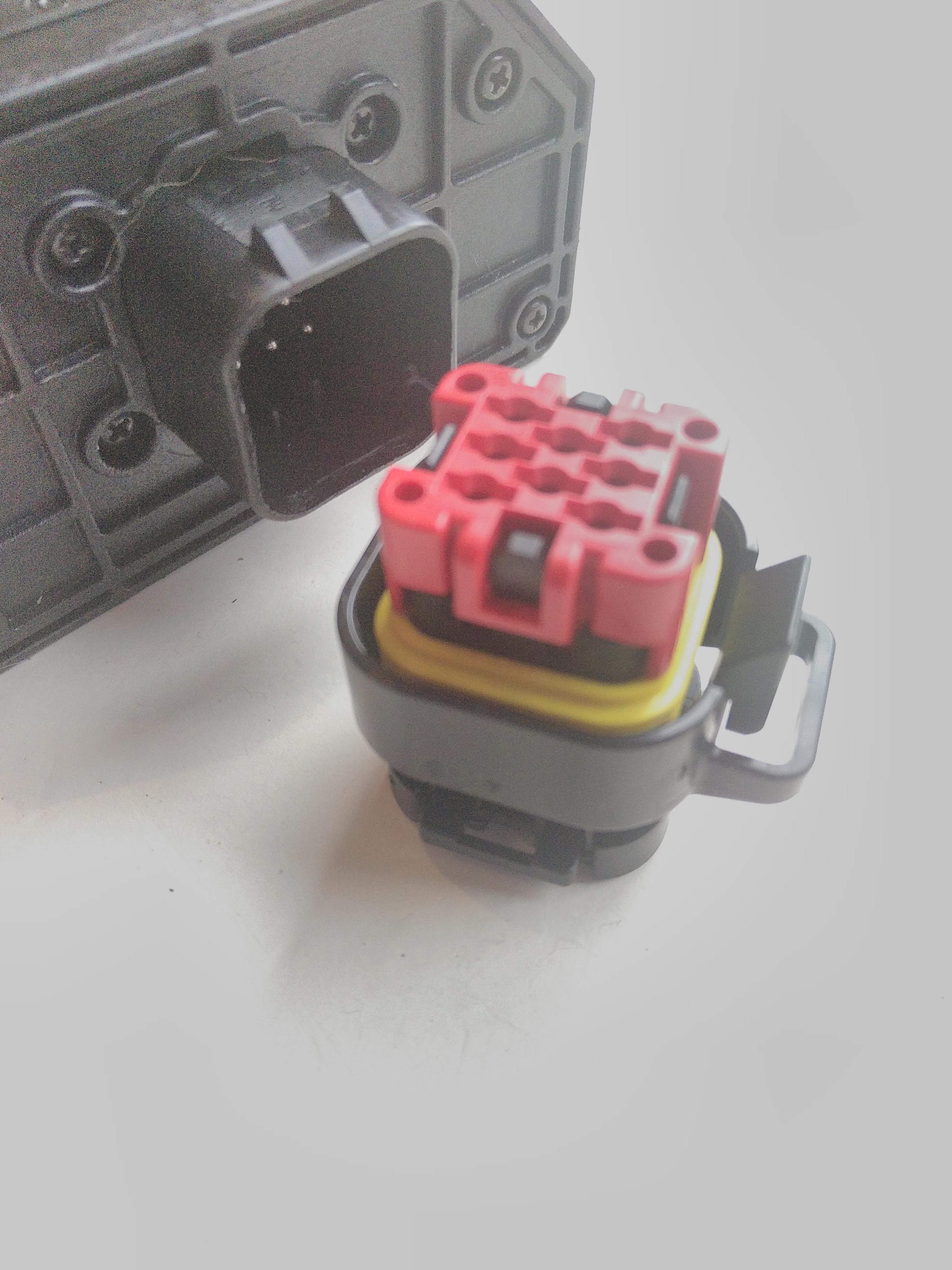

The 8 pin connector located in the housing looks like AMPSEAL 1-776280-1
https://www.te.com/usa-en/product-1-776280-1.html
The mating connector would appear to be AMPSEAL 1-776286-1
https://www.te.com/usa-en/product-776286-1.html

I can confirm the mating connector part number 776286-1 is correct.New Electric Ireland wrote: ↑Fri Nov 20, 2020 6:43 pm The mating connector would appear to be AMPSEAL 1-776286-1
The crimps would appear to be AMPSEAL 770520-3
https://www.te.com/usa-en/product-770520-3.html

No but I've been meaning to do another 1-day sub to the Hyundai Service info site soon to scrape more stuff that I missed last time.New Electric Ireland wrote: ↑Tue Nov 24, 2020 2:02 pmDo you have access to the wiring diagram detailing the connector pinout?
There's only 8 pins, 3 are grounds, so CP, 2 CAN, power and one other so even without that it should be easy enough to figure it out from the PCB.
I should receive the connectors tomorrow.
I also have a battery powered Micsig tablet scope that can do CAN decode, so I may extend the cabling and scope the MCU input to the CAN transceiver to see what it sends, which I'm hoping will yield CAN IDs to use to filter the other data on the P-CAN bus.

Limited time this evening but first look at PCB suggests;mikeselectricstuff wrote: ↑Tue Nov 24, 2020 7:16 pm
1 - CAN
2 - CAN
3 - TBD
4 - GND
5 - GND
6 - TBD
7 - GND
8 - PWR
mikeselectricstuff
- Posts: 120
3 is CP ( direct to charge port, also connects to OBC)
7 (gnd) unconnnected in car
