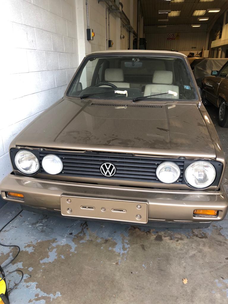

Hi all,

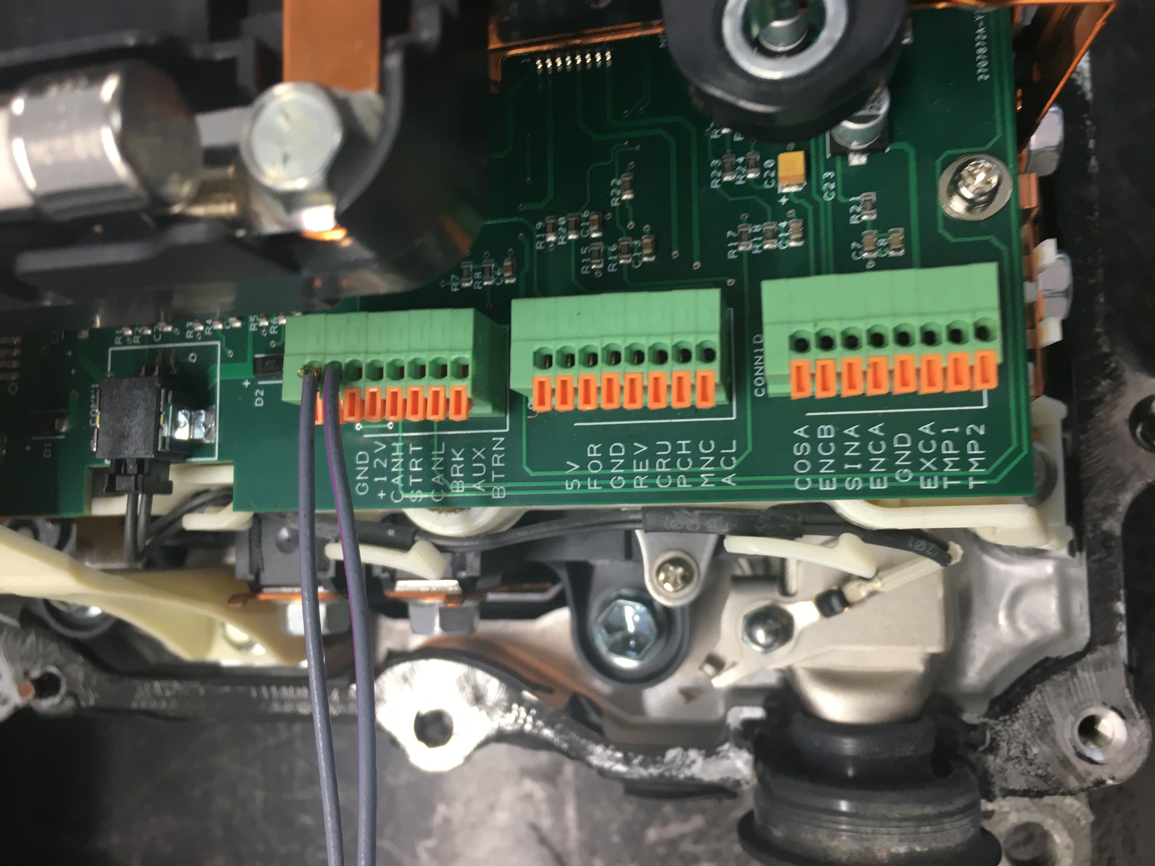

I’m working on a new project for a friend and could really use some help. He is converting his Mk I Golf drop top using a Prius Gen 3 M/G and inverter with the V1b drop in logic board designed by Damien Maguire.
There is an excellent write up on the Openinverter wiki for this setup using the V1c board, big thanks to whoever contributed. If you haven’t seen it, check it out - it’s great.

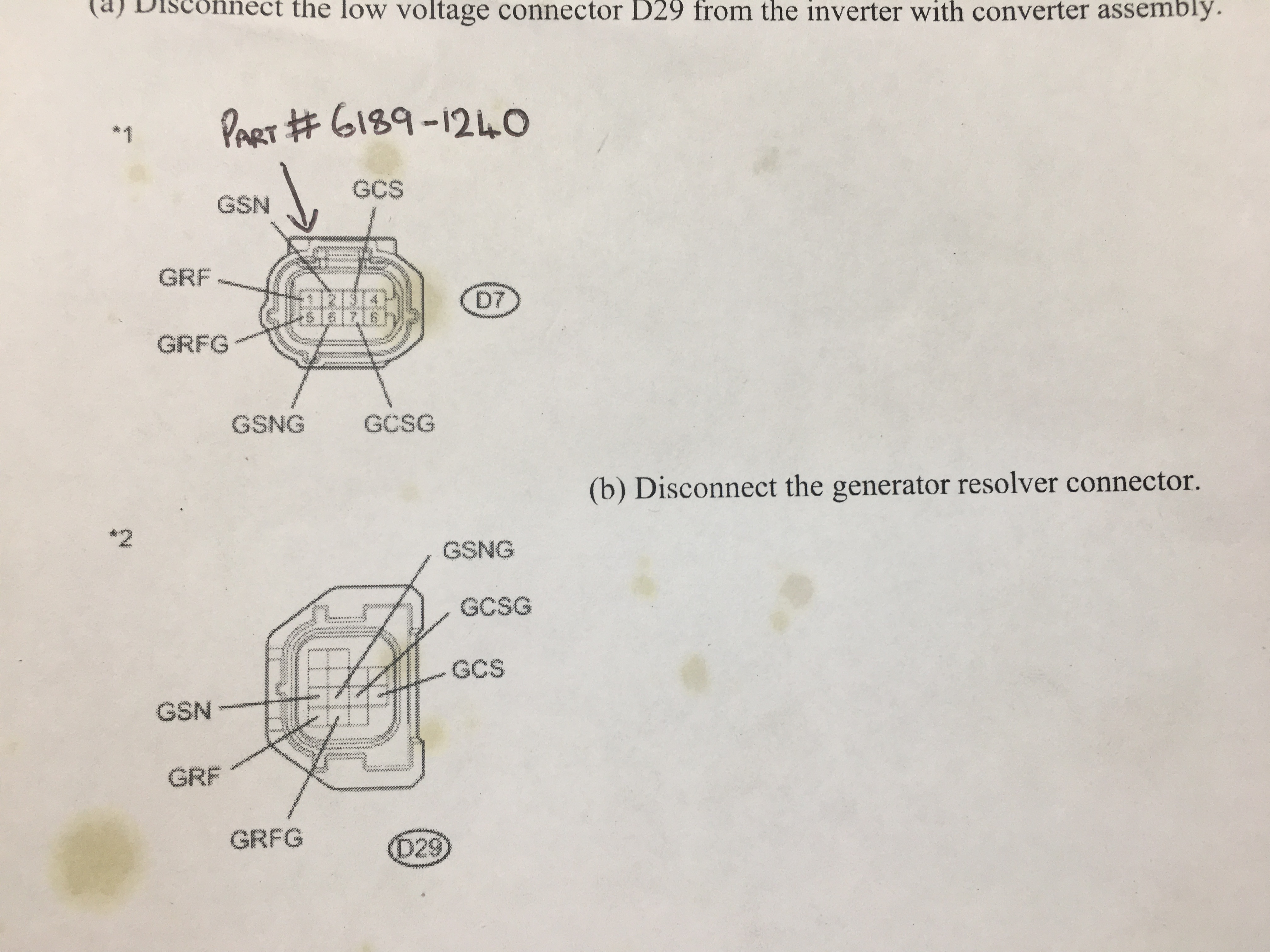

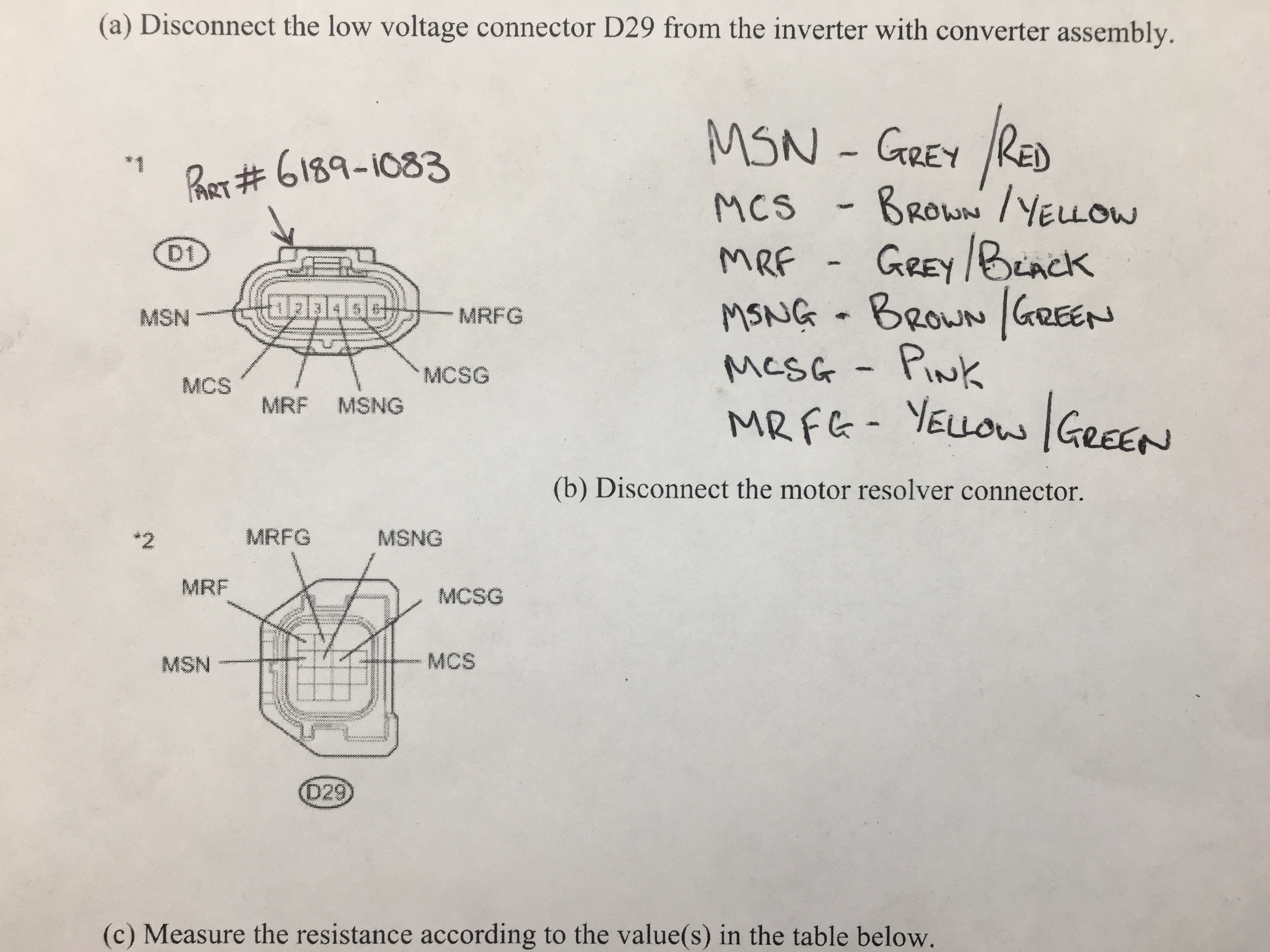

I have the pinouts for the M/G resolver plugs from the Prius wiring diagrams, but haven’t had any success in finding how to relate them to the pinout on the V1b board (which are quite different to V1c. Can anyone help?

As no one else has answered, I think the answer you are looking for is here :-
konstantin8818 wrote: Sun Aug 16, 2020 3:13 pm I've checked with 4.87R already, nothing changed.
resolver connection MRFG-GND, MSNG-SIN A, MCNG-COS A, MRF-EXC A, MSN-ENC A, MCS-ENC B
Phases are connected straight 1,2,3 to 1,2,3.
Basically match pins 16 to 21 to the above list
Have a read around of that area in that support thread (click on the little arrow next to wrote: above to go to that thread

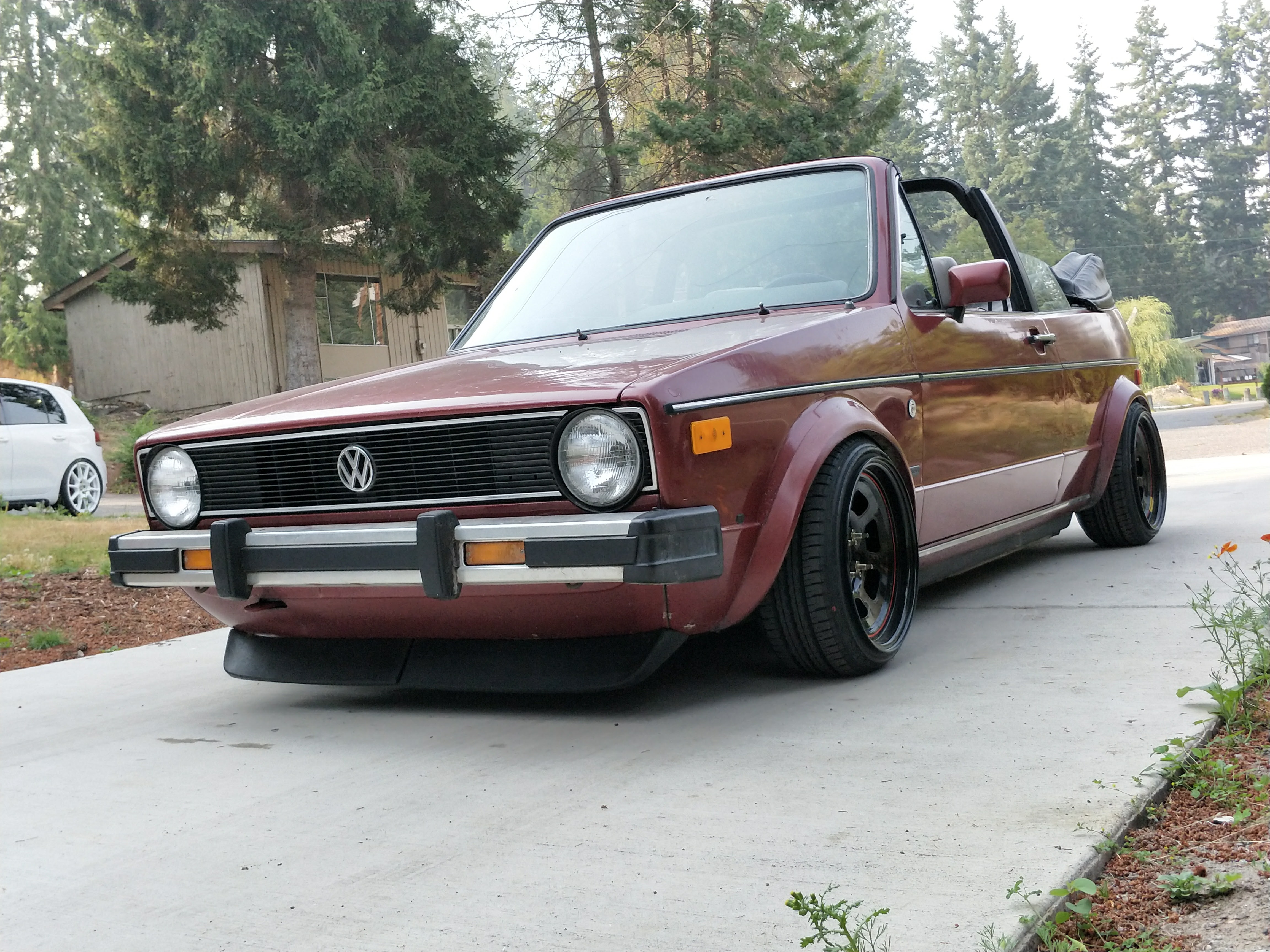

You should continue to update us on the progress here! I am also working on a MK1 vw.
viewtopic.php?p=16785#p16785

About that resolver connection: If, after syncofs tuning, your motor will run good in one direction but run away in other, try to swap ground and positive wires of sine or cosine detectors MSNG<>MSN, MCSG<>MCS. Damien helped me with this hint, when I've stuck with FOC tuning.

what motor are you going to use on the Cabby? also where on earth are batteries going to go?
My Cabriolet:

Please see Damien's video on FOC tuning, beginning with timestamp 37:00 :D
Basically, one MUST absolutely ignore wire colors and designations and: a) use a multimeter to determine the wire pairings and b) go thru the process of pairing to find the 1 of 4 possible connection methods that actually works.

Hey guys it was a big day yesterday, not only did we get my own project fig-leaf moving for the first time, but also managed to get the Gen 3 Prius motor and inverter communicating. Has anyone used the Gen 3 Prius inverter and Gen 3 Motor together yet and if so would they be happy to share their parameters please (for either Sine or FOC)? I’m happy to post mine to get it working in sensorless for testing but as you can see from the results I think they must be quite a bit out.
Edit: Also, if anyone knows why MG2 clicks alternately every 180°I’d love to know. The last 12 seconds of my video sound like the intro to Angel by Massive Attack! :lol:
