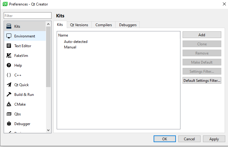

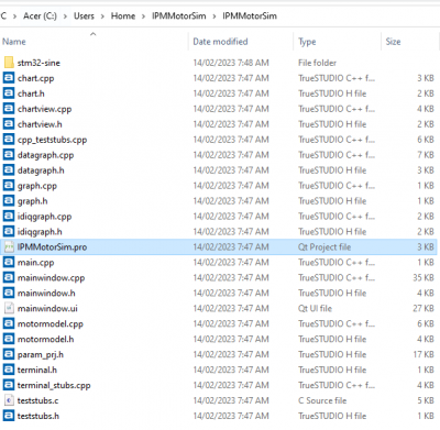

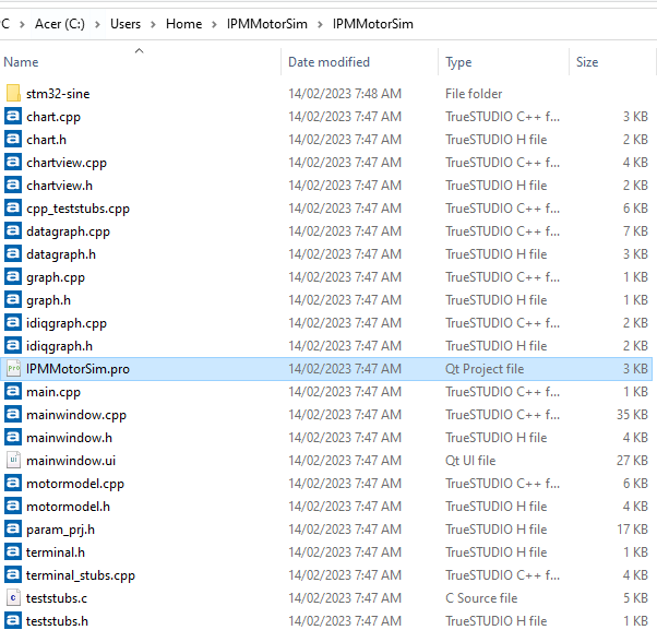

Hi all, I am trying to build the software, so far I have these screens:
just wondering what I am doing wrong,
Kind regards,
johnspark
Pete9008
Posts: 1801
Has thanked: 102 times
Been thanked: 351 times
Post by Pete9008 »
You should just need to open the project (.pro) file. It looks like you may be trying to import the project which is normally only used for non qt projects.
Edit - sorry, misinterpreted the above, it looks like it is kit that is missing. Qt should have set up a default kit that suited your computer when it was installed and it should just pick that up and use it when you first open the project. When you look at the available kits (manage kits button) what are the options shown?
johnspark
Posts: 264
Has thanked: 59 times
Been thanked: 48 times

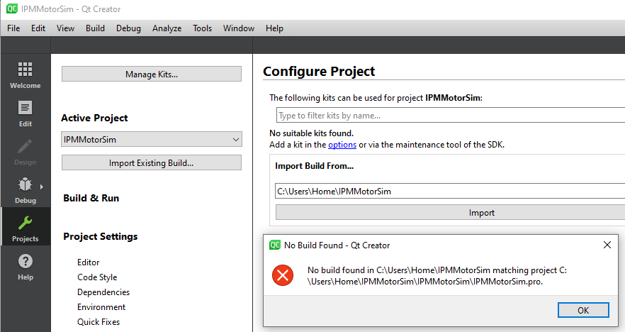

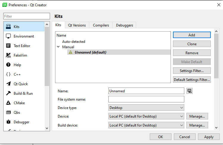

Post by johnspark »
Thank you Pete9008,
so I managed to find a kits page and got this:
wondering what to do next,
Kind regards,
johnspark
Pete9008
Posts: 1801
Post by Pete9008 »
Yep, no valid kits. Looks like you might be missing the toolchain, see if this helps? https://forum.qt.io/topic/109793/no-s ... ve-this
Not sure what's happened there, the qt install always used to include it all by default. If going into the management tool it is also worth checking that qtcharts are included (there is another post about that somewhere above).
I need to do a clean install sometime to check the install instructions are right but don't have a suitable machine at the moment.

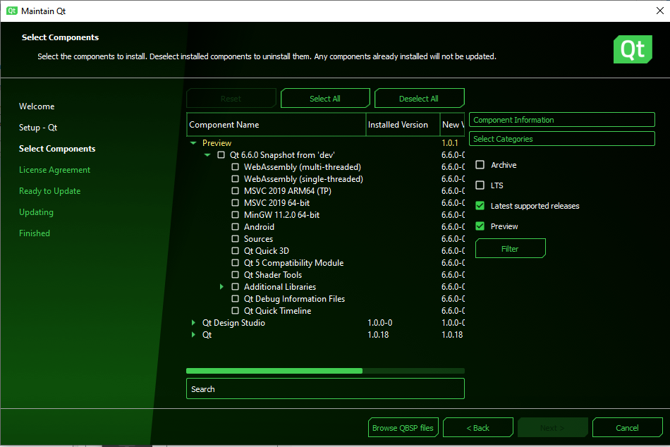

johnspark
Posts: 264
Post by johnspark »

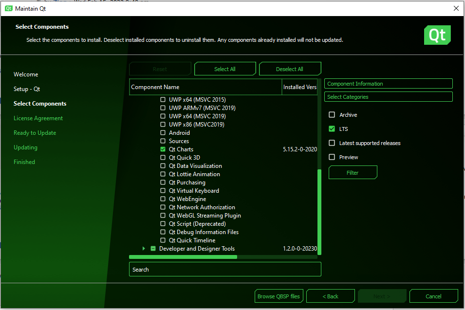

So here is the next screen, (I guess the screens I find can be added to the how to instructions later on):
kind regards,
johnspark
Pete9008
Posts: 1801
Post by Pete9008 »
I think you need to expand the Qt section at the bottom first.
Edit - I tend to go for the Long Term Support (LTS) rather than the latest version too but it's not critical, just personal preference.

Fantastic! Just been doing a little digging and found this https://forum.qt.io/topic/127564/qt ... enance/16 , seems there are two places charts are listed in the maintenance tool and the one within the Qt tree is the one to go with. Does that agree with what you found?

So I have now added QT charts:
Thank you Pete (and also for LTS)
I have this for kits:
and this for build:
sorry guys, I looked at wiki but could not find instructions for QT.

Hm, it says 5.15 there.. does that match the version of Qt you have installed?

Zieg is correct in that the version of charts installed needs to match the version of the rest of the install. Given the missing kits it's probably worth uninstalling and doing a clean install from scratch. The instructions (complete with Zieg's install guide and screenshots) are here https://openinverter.org/wiki/IPM_Motor_Simulator

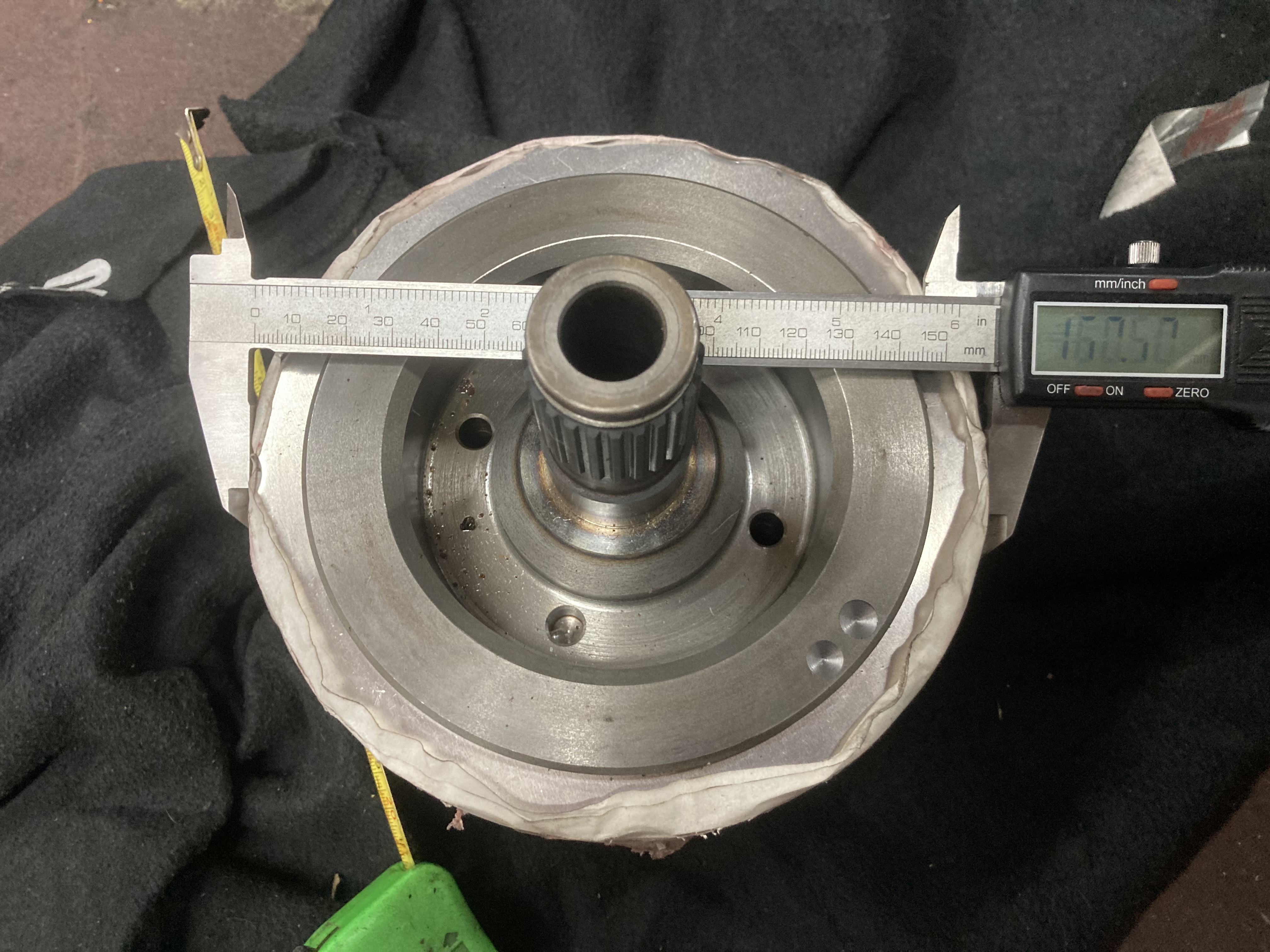

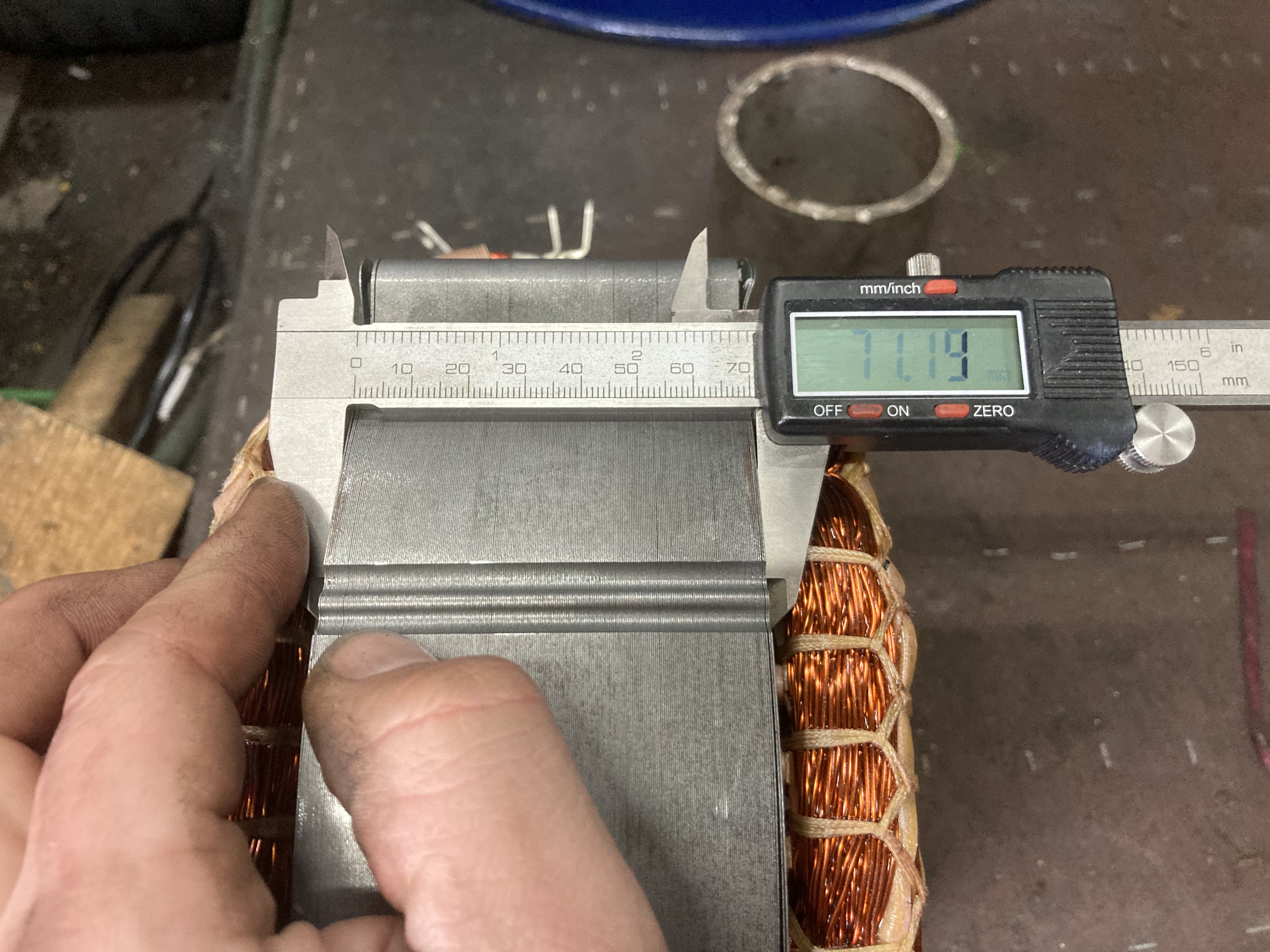

Ev8 wrote: Sat Oct 29, 2022 7:05 pm Ok I dug out some spare motor parts, only tested with stationary rotor in one position but these are Lexus rx400h transaxle
Mg2
@Ev8 - any idea what the size and weight of MG2 is?

Post by Ev8 »
Will weigh that spare rotor and stator tomorrow
Ev8
Posts: 834
Has thanked: 44 times
Been thanked: 172 times
Post by Ev8 »

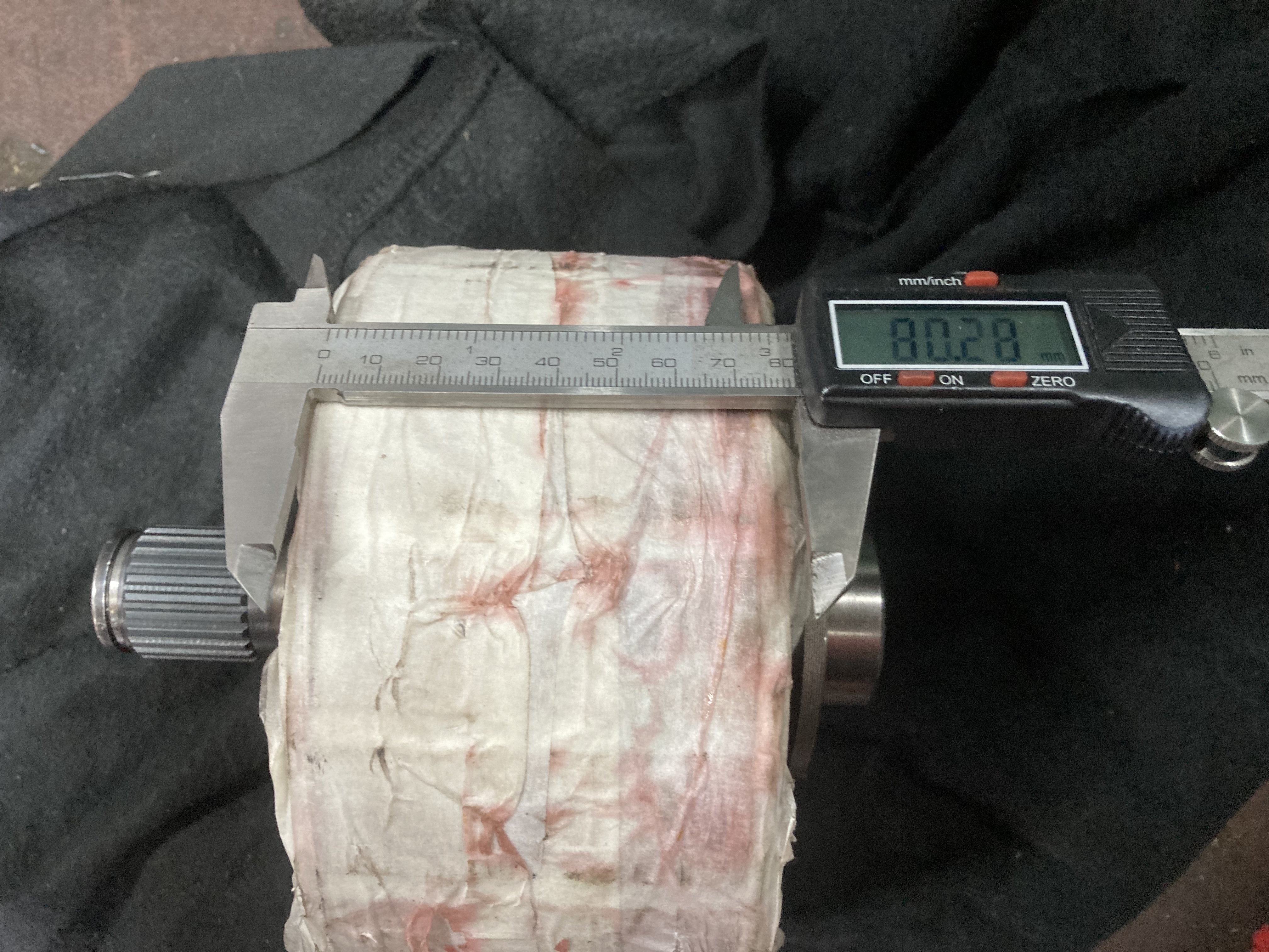

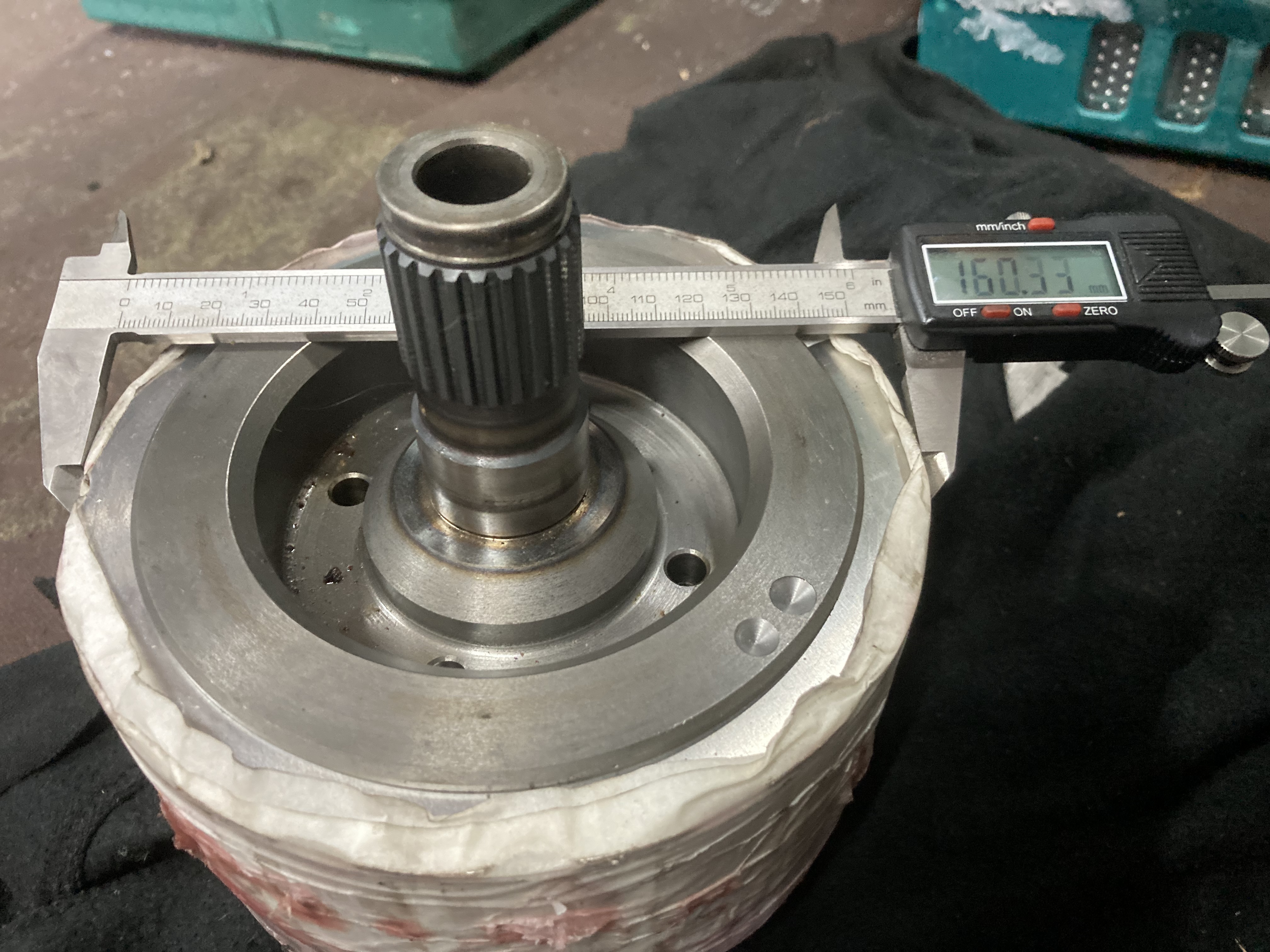

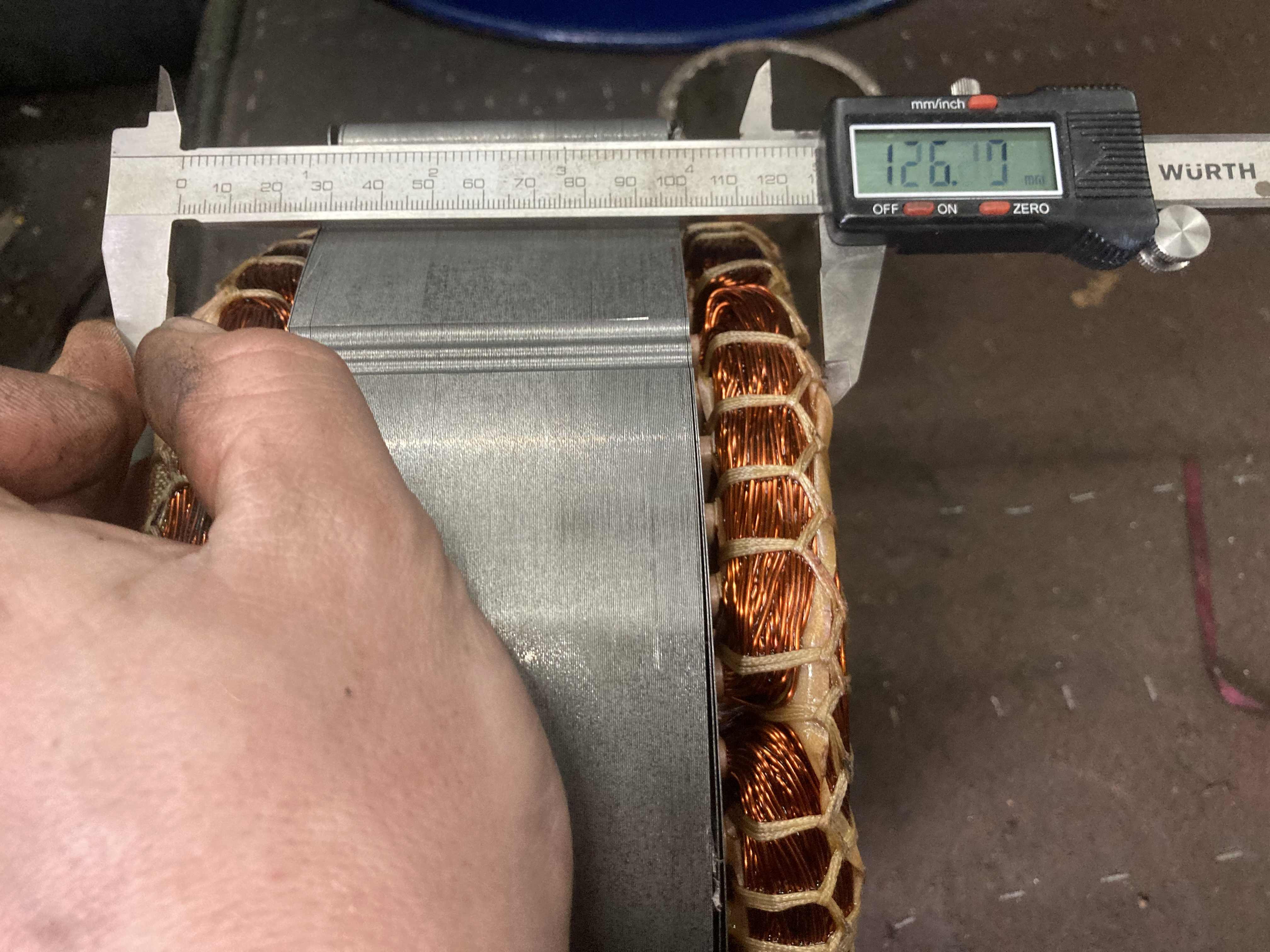

Okay rotor diameter 160mm 80mm deep 10.1kg
Stator approx 270 od to outside of lamination’s x 71mm 20.9kg
