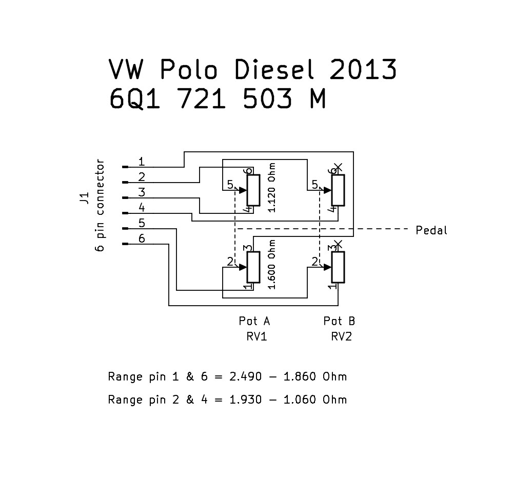

Just wanted to share my finding on the VW Polo pedal.
I managed to take some measurements and found out which pin does what.

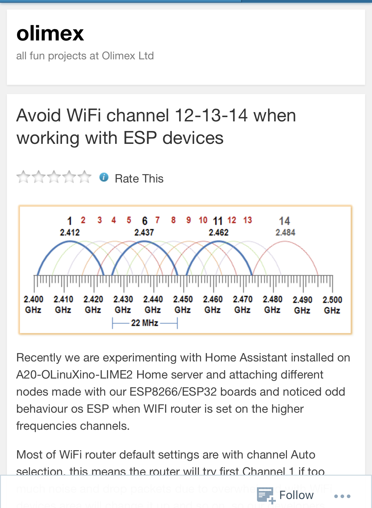

Dunno if this is relevant, re wifi issues.
https://olimex.wordpress.com/2021/12/10 ... p-devices/

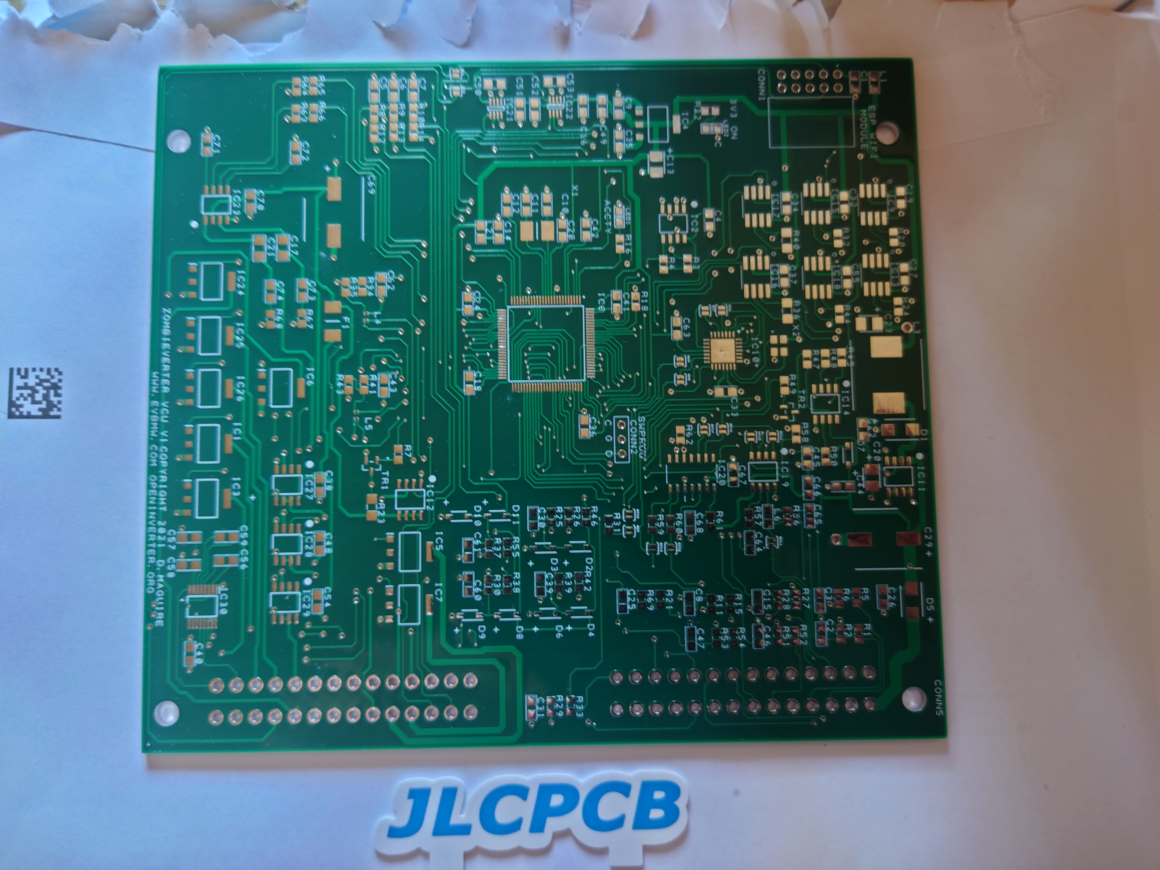

Now my board arrived just waiting for components.
If there is someone in Sweden or Nordic region i have pcb over.

blasaab wrote: Mon Dec 27, 2021 1:47 pm Now my board arrived just waiting for components.
Did you correct the small errors?
I think Damien ships a V2?

EV_Builder wrote: Mon Dec 27, 2021 2:35 pm
What i know there is only v2 for Lexus controller

In the support thread the information is spread out. Other FET partnumbers and some wires/jump leads are needed if I'm right.
Posts: 4000
Been thanked: 1115 times
There has not as yet been a V2 for the Zombie VCU. The initial beta boards of which 10 were made and sold at cost to encourage uptake and participation in the project had two pcb layout errors. These were fixed and all release boards are as per schematics.
