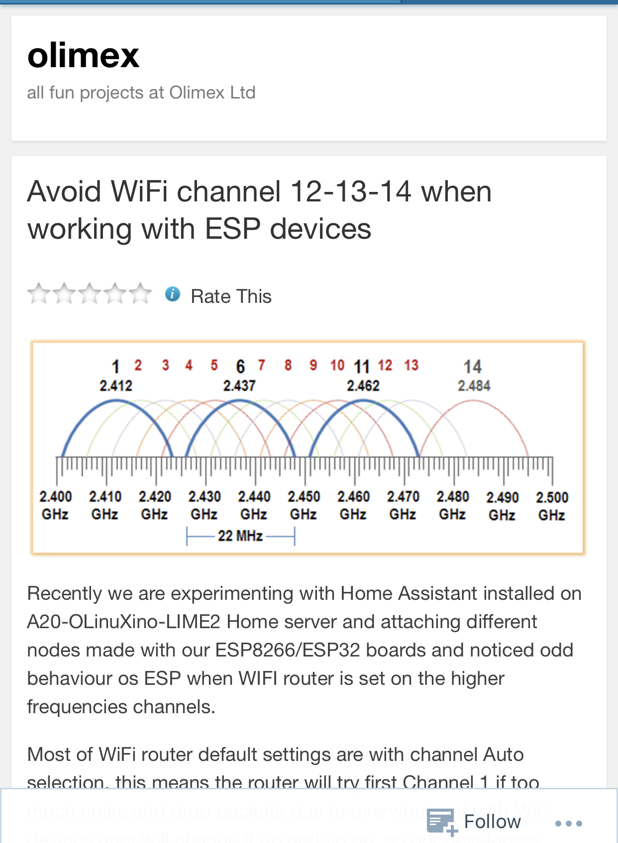

Dunno if this is relevant, re wifi issues.
https://olimex.wordpress.com/2021/12/10 ... p-devices/

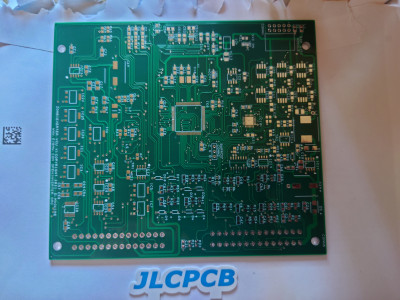

blasaab
Posts: 8
Joined: Sat Nov 20, 2021 6:17 am
Post by blasaab »
Now my board arrived just waiting for components.
If there is someone in Sweden or Nordic region i have pcb over.

blasaab wrote: Mon Dec 27, 2021 1:47 pm Now my board arrived just waiting for components.
Did you correct the small errors?
I think Damien ships a V2?

Posts: 3831
Has thanked: 75 times
Been thanked: 696 times
There has not as yet been a V2 for the Zombie VCU. The initial beta boards of which 10 were made and sold at cost to encourage uptake and participation in the project had two pcb layout errors. These were fixed and all release boards are as per schematics.
