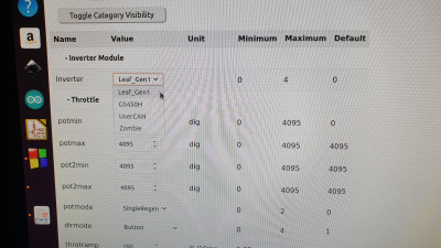

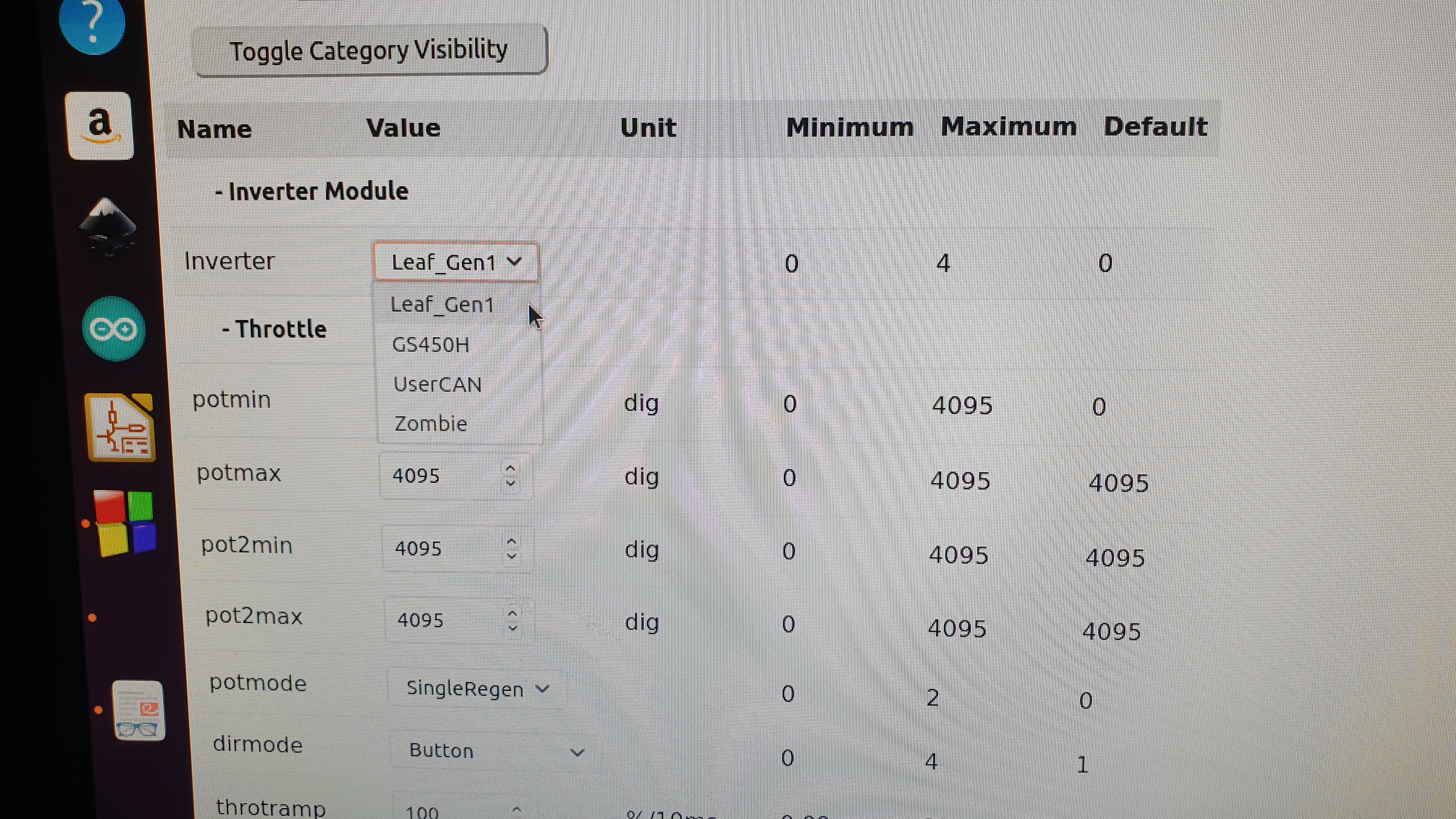

So over the past few days I've been mashing together a project from these and other code and learning fun stuff like : Whats a static and when (not) to use it:) , How to hard crash an STM32 and other fun things. But yeah this is addictive. I'm loving the edit in a text editor and compile from the command line approach.
So what we have as of now is the openinverter wrapper with things like :
Throttle cal and mapping,
Precharge and contactor control,
Temp derating,
BMS limits,
for/rev/neutral control,
Graphing and monitoring,
Firmware updates via the web interface,
Cruise control,
Fuel gauge driver,
etc , etc
BUT, rather then driving an inverter powerstage this version sends CAN for the Leaf inverter or Sync serial for the GS450H and of course can be expanded to any number of others. This will be the default firmware for all vcu products from now on and future hardware will support future fun packed stuff like FLEXRAY!!!
As of now its a bench queen but its pumping out can that may or may not spin a leaf motor and talking to an isa shunt. Hardware should arrive next week and Dilbert is working away on the GS450H part. So that's all for now......where was i....oh yeah

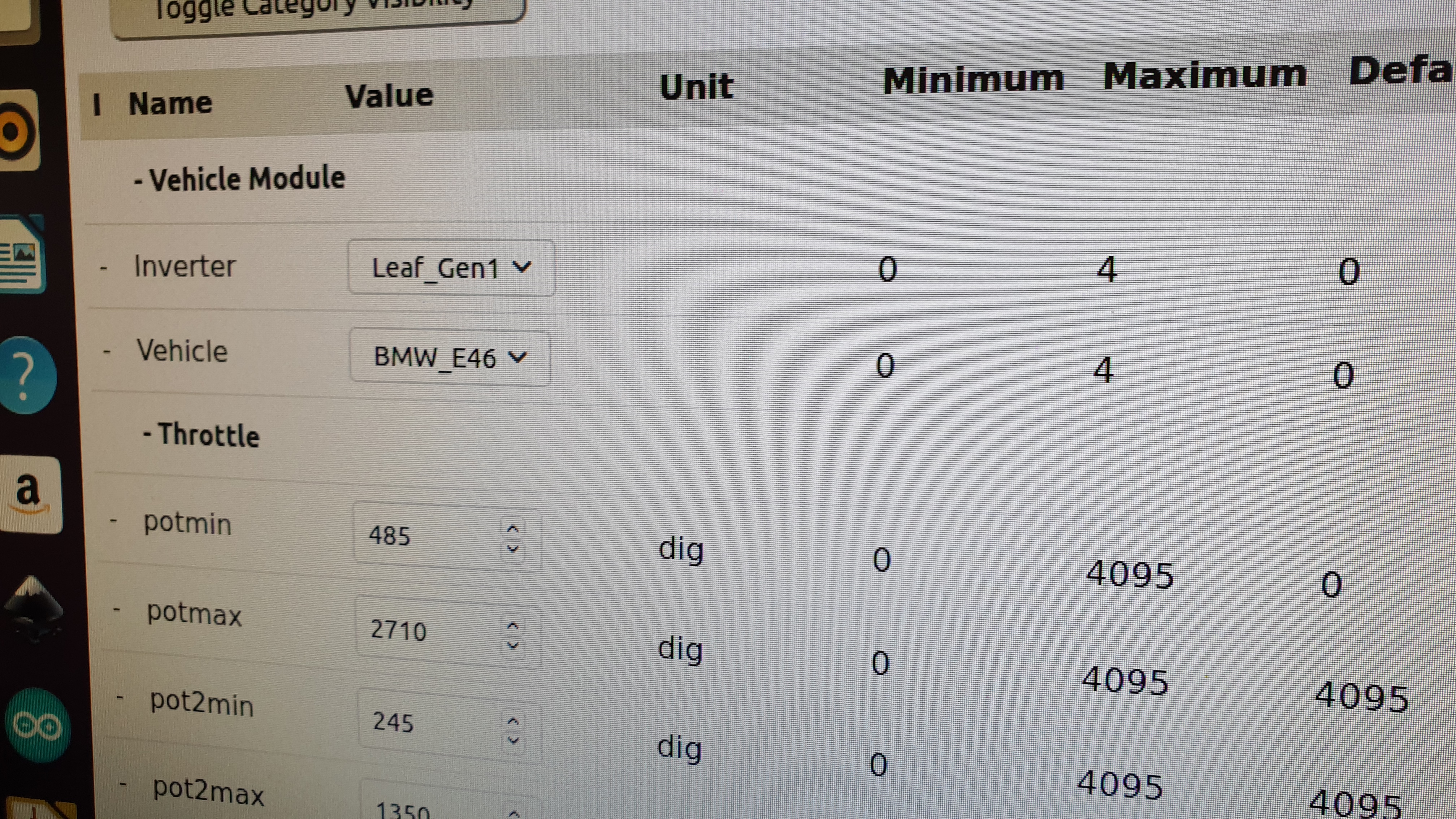

Following some collaboration with Johannes we now have a first official binary release for the vcu : https://github.com/damienmaguire/Stm32- ... ses/latest
Modules tested in this release :
Basic functionality e.g. contactor control, precharge ,throttle,brake etc
External charger control
CAN1,CAN2 and CAN3.
Native Chademo fast charging utilising CAN3
Timed AC charging
BMW E39 module
BMW E46 module
Nissan Leaf inverter module
OpenInverter module
ISA shunt module

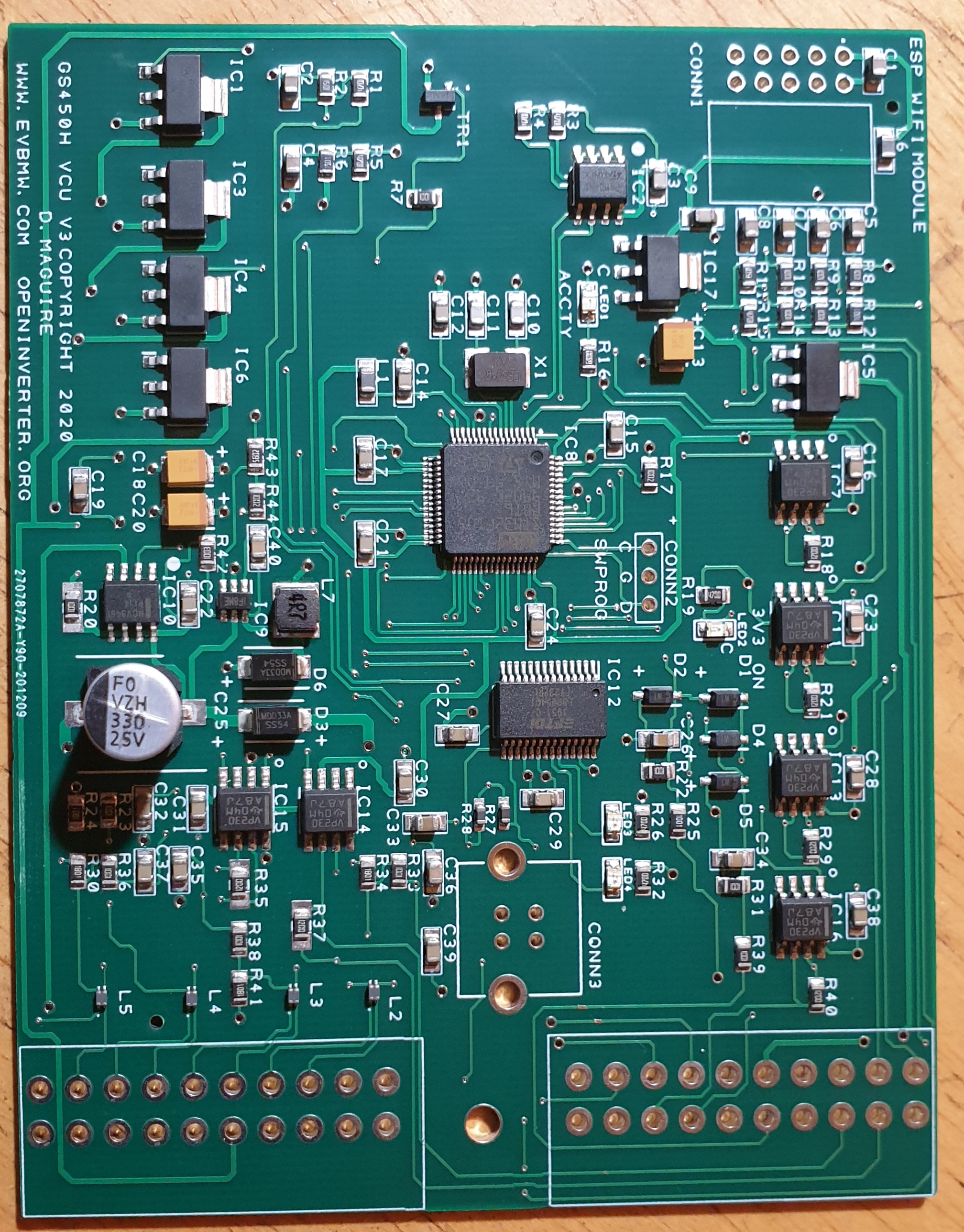

- Posts: 3563
- Been thanked: 87 times

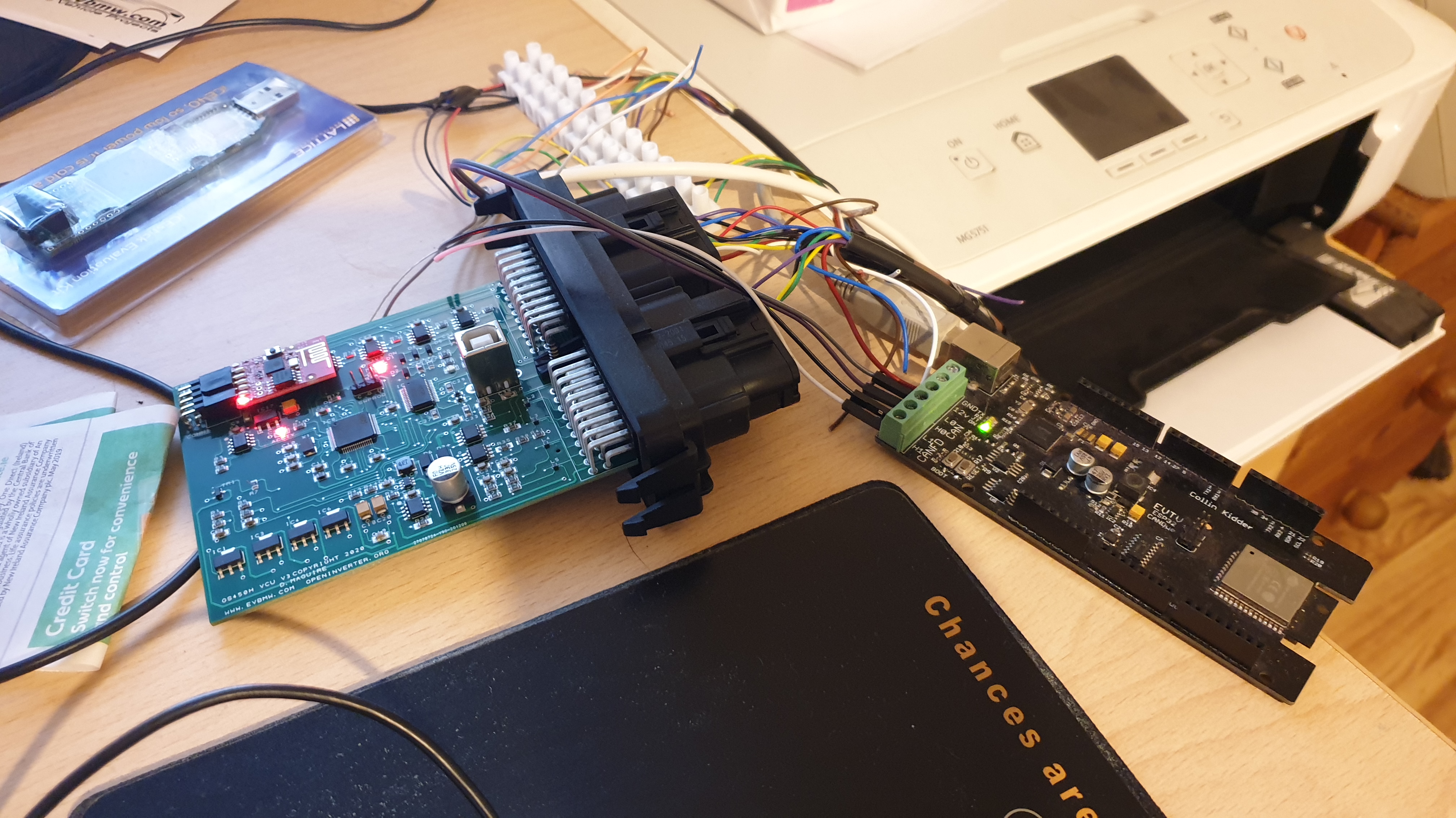

Ok so we are up and running on a 105:) Just using a spare bms master board as still waiting on the vcu hardware. Due tomorrow now according to good old DHL.... Now on to porting Dilbert's GS450H code over to libopencm3.
Pro tip : writing or reading IO pins you haven't defined really annoys the STM32. It just sits there and mocks me like Nelson from the Simpsons....

- Posts: 3563
Good news : boards arrived. Better news : they power up and program:)
Full kit on the way to Dilbert today to assist with the GS450H module development.

- Posts: 3563
This was a Tour De Force :
gpio_primary_remap(AFIO_MAPR_SWJ_CFG_JTAG_OFF_SW_ON,AFIO_MAPR_USART3_REMAP_PARTIAL_REMAP);//remap usart 3 to PC10 and PC11 for VCU HW
Moron here had decided when designing the hardware that it would be a good idea to have the option of using Uart4 for the wifi. As the Uart4 pins are capabale of hosting Usart3 it was win win.........Yeah right. All day yesterday I struggled with trying to remap USART3 onto PC10 and PC11. OF course I made the usual mistakes like not enabling the AFIO clock etc but would they work? HELL NO. Got up this morning and decided to do it in assembler. And it worked! So not a hardware issue but libopencm3 just kept laughing at my attempts.
What am I doing wrong? I had been using AFIO_MAPR_USART3_REMAP_FULL_REMAP because that makes sense right? We want to remap the pins.... I'm sitting back in my office chair looking at my good old Commodore 64 which I still get a kick out of using connected by RS232 to my pc as a terminal. Ah the good old days, just rx,tx,cts,rts,dsr,ri.dtr..........wait........oh you are F%^King kidding me!!! change to AFIO_MAPR_USART3_REMAP_PARTIAL_REMAP and everything starts working. Because of course a FULL REMAP moves ALL the USART pins!
So yay. Bootloader and firmware now running on the V3 vcu.
Yea that's why i've been using cubemx for configuration as it knows about little things like that. Looking forward to getting the board, I'll test my initial firmware on it and make sure we are still clocking at the correct rates and get the MTH data back correctly.
I'm probably going to have to put a fly-wire on the USART2_CLK line to bring it on to PA0, as the current pin PA4 will not allow me to generate the pseudo clock line.
I wonder for the next build would it be worth stuffing the 32KHz oscillator, as this would allow us to do charge timers etc, from the web interface.

Ah yes, remap is quite an exercise. None of that easy to use IO matrix rubbish, as Dave Jones would say.
The 32 kHz is mostly helpful when you want to keep the RTC running while the STM32 runs off V_bat.
If you just want to use the RTC for relative timing you can just clock it from the 8 Mhz crystal, the prescaler is sufficient to divide it down.

The board arrived today, thanks to JBJack Bauer wrote: ↑Mon Dec 21, 2020 9:14 am Good news : boards arrived. Better news : they power up and program:)
One small issue i have is that i wasn't able to generate a pseudo clock off PA4, so i've had to tap onto PA0 which is mapped to a timer i can use.
I was seeing data coming in and out on the scope, which is a good sign. But i seem to have locked myself out of the CPU (cubemx doesn't have swd interface enabled by default). So i've tried resetting lots of different things but can't get back in with the ST-link.
