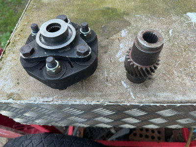

Short update on this project. The front pack BMS has a few issues. One module is lying about the value of a couple of cells, and pretty sure another module is overstating the voltage a tad as i manually checked and balanced them all. Have been looking at DIYBMS as an alternative as BMW modules are hard to come by.
In other news, the original coupler stripped. I knew it was wearing after the last gearbox removal, so prepped the replacement thinking it would be a job for the easter break. It didn't last that long. Let the wife down a mile from home, got towed back by a mate. Hoping the new couple will be a bit more forgiving, plus the latest VCU ramps up and down the regen more sympathetically, so it kinder on the drive train.
I'm guessing there must be some mis-alignment though got to say it isn't obvious.
I think MK3 coupler will be a star based coupler.

Re: [DRIVING] BMW Touring + prius + phev
yep - in about 2k miles
no noise from the start, but it was a bit clunky as i didn't have the regen ramp up and down sorted.
according to my local gearbox guy, solid couplers can have issues, and on Land Rovers, the coupling has a life of about 50k miles

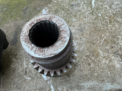

Re: [DRIVING] BMW Touring + phev motor & inverter
I knew i would jinx it by saying how well it was going.
Coupler gave way without warning on the way to take nipper for an exam. This time it has stripped the splines on the gearbox end of the coupler. There do seem to be two versions of the clutch driven plate around. The one i used for this has quite a thin wall couple with 6 legs to fix it to the 'asbestos' liner carrier. Some are much chunkier and deeper.
So plan c is rebuild using a star coupler. Although alignment looks spot on North-South and only 1.5mm out East-West (taken up by movement in the layshaft) the star coupler should make for a happier fitting.
Parts ordered, will take a few days to machine and weld up, hopefully back on the road in a week or so.
