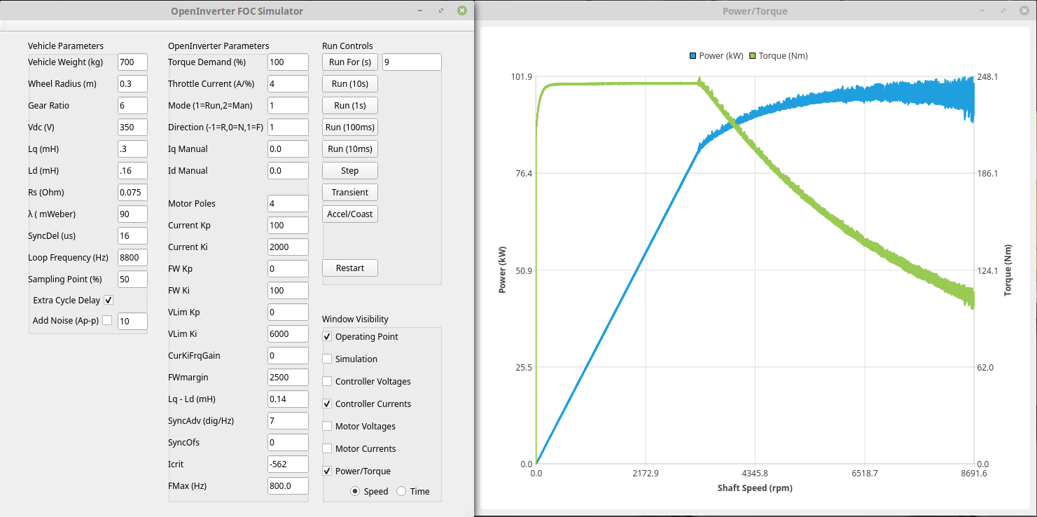

When I first started this project one of my first questions was how much can you get out of a motor - how much can it be overrated in terms of power and torque. Unfortunately there wasn't an awful lot of data (there was a fair bit of speculation though ;) )
Well the simulator has got to a stage now where I think it may be possible to use it to get an idea what a motor can do. This is a plot produced using it based on winding inductance measurements taken on the Outlander rear motor I have, and a few guesses!
I produced plots for a few other motors based on other peoples measurements which can be seen here viewtopic.php?p=47770#p47770
Now I very much doubt that it is perfect but I what it does do is increase my confidence level in a few of the total guesses I made at the start. These were that I could get 100kW out of the motor (Mitsubishi spec is 60/70kW) and 250Nm torque (Mitsubishi spec os ~195Nm). The graph comes pretty close on both of these. On other motors, where more data is available, the simulator seems to be underestimating a little so overall I'm fairly happy that the 100kW and 250Nm I'm after should be possible.
It also gives a good idea of what the torque curve might look like which is something that worries me about EVs. I'm used to ICE cars and they have a pretty flat torque curve, the electric motor drops off at higher speeds (although changing gears in a ICE has the same effect). The graph has convinced me that I will have enough punch left at say 60mph for it to still feel quick enough at A-road speeds :) (although if I can afford the weight I'm still tempted to keep the Roadsters gearbox so that I can use 2nd for sports mode, 3rd for more relaxed cruising and maybe even 4th for economy? (it's a 6speed box btw).
The measured winding inductances of the Outlander motor, at Lq=.3mH and Ld=0.16mH, also means that it is fairly low inductance. This means that it shouldn't suffer from any of the remaining FOC control issues.
The only slight worry is that, being low inductance, it may not be happy being driven at the Prius Inverters 4.4kHz upper PWM limit.
Does anyone know what frequency the OEM Outlander rear inverter runs at?

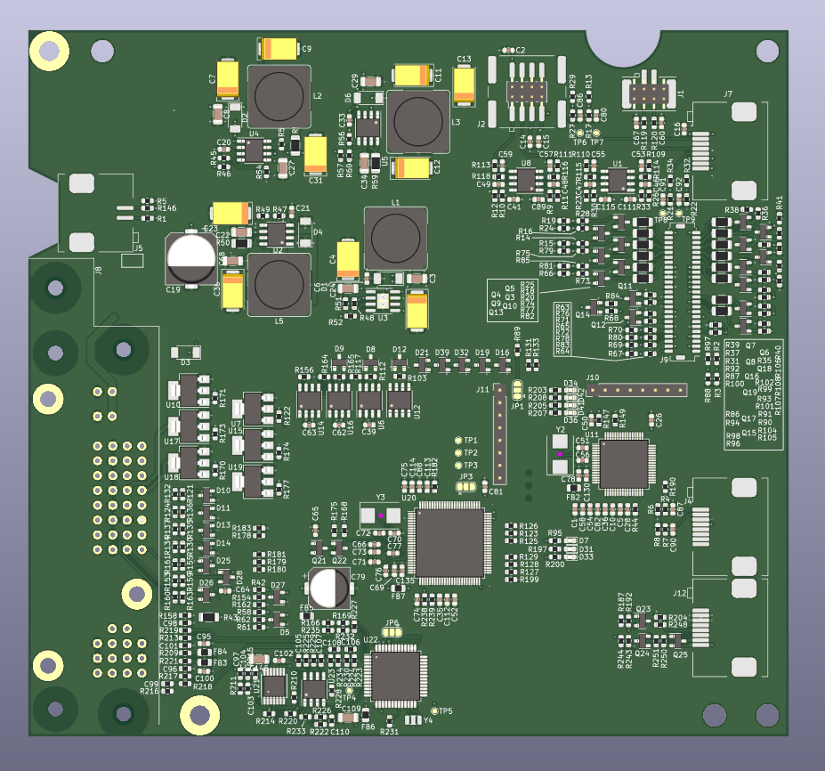

Ages ago I started designing a PCB (see viewtopic.php?p=39624#p39624 for details). It never got finished because I ended up going down the simulator rabbit hole to prove to myself that the FOC control with OpenInverter was the right way to go. Well I'm now happy that it is and so I can now get back to the hardware. Here is version 2 of the PCB:
It's essentially a slimmed down version of the last one but modified to reflect the stuff that I've learned on the simulator and logging threads. So what's changed and what's still there?
First the unchanged bits, it still uses reclaimed Toyota connectors for the interface. It also uses the resolver interface IC off the Toyota board.
Pretty much everything else has changed:
  • The STM32L496 has gone, at some point in the future it will reappear as part of a climate control and charg controller. This change has also simplified the power supplies as the permanent 3V3 rail is no longer needed.
  • It no longer uses the STM32F103 for motor control. Instead it uses a STM32F405 (actually a 407 as I've managed to get hold of a eval board with one on).
  • Both CAN interfaces on the F4 are routed out, one will be for the BMS bus and one to interface to the Roadster CAN bus.
  • Both advanced PWM timers on the F4 are used, one to drive MG1 and one for MG2. Not planning on using this feature but it seemed sensible to track it out that way. If both were used, and separate resolver interfaces needed, a second resolver daughter board would be needed connected to a header. There are also links to allow both to be driven from timer1 which is the way I plan on using it.
  • I'm a little concerned about current sampling on low L motors so have added anti-aliasing filters (2nd order sallen-key) on the current input lines to make things a little easier.
  • The ESP8266 module and SD card that were on the board have been removed. Instead a remote ESP32 with an SD card (as per the logging thread) will be connected via a RS485 link. This removes the wifi from inside the screened metal inverter housing which should both remove the noise it induces and improve signal strength, hopefully to the point where it can connect to the house wifi from the parking spot around 20m away. It also makes it much easier to modify if needed and the card can be removed to read the logged files.
  • It now has a STM32F103 driving the DC/DC converter and buck/boost converter. Probably overkill but I have a few and it means that the CAN interface can be used to control it.
  • It has an interface for a HLSR current transducer, intended for measuring the current in the buck/boost converter, connected to the F1 processor.
It's not finished yet (the signal tracking was supposed to be this afternoons job but I got sidetracked onto the final simulator release) but hope to get it done and out for manufacture in the not too distant future.
Moving to the F4 will be a bit of a pain but I think it will be worth it. While the fixed point math works well on the F1 the floating point coprocessor on the F4 will eliminate all the potential for overflows, improve performance and should make the code simpler and easier to maintain. I was planning to change the way the peripherals were configured to reduce latencies anyway so combining the move to a different processor at the same time makes sense.

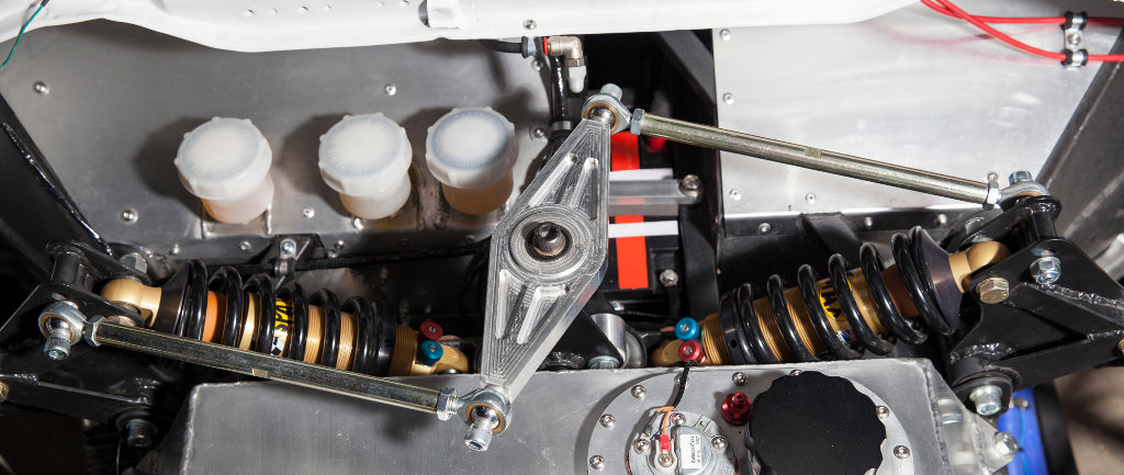

Suspension sounds similar to the bell crank system I put together on the front of my track car. Started off designing using a blade to provide the spring element for the anti roll but due to the limited adjustability and design uncertainty on spring rates I went with a rocker arm working on a pair of die springs underneath. Not as light but very easy and cheap to have both fine (via link positions) and coarse (via spring change) rate adjustment. Not the best picture but I think it shows the idea.
Have you kept the dedion axle?

Sorry, I usually associate 5-link with live axles (two trailing links per side plus a panhard rod or watts linkage) and hadn't read you post correctly!
So is that two links at the bottom of each upright (one of them used to adjust toe in), one at the top (adjusted to set camber) and then a drag link at the top and another at the bottom (adjusted to set castor)? As you say infinitely adjustable. I went for solid wishbones with very limited adjustment and lots of simulation first to fix the geometry. Seems to have worked and it handles pretty well (although it took a while to tame the snap oversteer!).

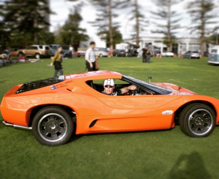

Yes the "Purvis Eureka" is the Australian Licenced version of the UK-NOVA (but of course not the Chevy Nova). When I get a bit further through this gs450h EV conversion with the SLK I hope to have some more spare time to do some "build biology" type of threads for each of my EV projects.
my "other" Nova/Eureka (built in 2006)

Noticed that your image is marked as built in 2006 - does that mean that it's the later space frame chassis version rather than the Beetle floorpan underneath? A retrospective build thread on your EV conversions would be be great :)

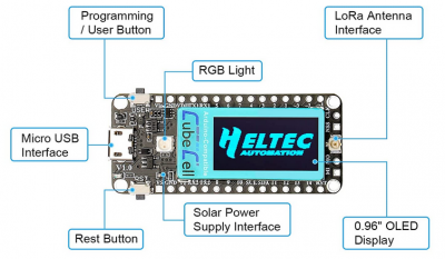

Talking of non-essential creature comforts the one thing that I have always wanted to add to a car is a way to remotely enable the heater/AC to either warm or cool the car ready to go (and the recent UK weather has focused my mind on the heating/defrosting side!). Now I could do this with the existing remote plip, the trouble is it is very limited in range and there is no confirmation if you can't see the car. An alternative would be to use a mobile SIM, but I'm not keen on this for a number of reasons (SIM costs, complexity, don't like smartphones, power consumption, need static IP address, poor local coverage, etc). Instead I've ordered one of these:
It's a LoRa wireless transciever with a M0 48MHz micro, oled display, couple of buttons and battery management circuits. The LoRa wireless transceivers can supposedly give a range of >5km line of sight (been tested to 14km!) or ~1km in built up areas, only uses uA in standby mode (and the car end 6mA in receive mode or 2mA @ 12V via a switch mode supply) and is supported by numerous code libraries. The plan is to make a fob sized remote out of it, have it show the car status (SOC, range, voltages,temps) on the display on a single button press and on an additional long press start the car climate control.

Hi Peter, what talks to the "LoRa" at the vehicle side? Looks like an awesome thing.
The "built in 2006" is actually when I Re-built it as a full caged tarmac-rally spec vehicle. It's an original 1976 eureka (had a full vw pan). From about 1994 I drove it as it was when I bought it. In about 2002 a stripped it back to all of its individual pieces and started planning the "rally" car build. Due to classic tarmac-rally regulations of the time it still has a "vw backbone" and "suspension pick-up points" however the integrated roll cage and tubular frame carries all chassis torsional loads and in essence the vw parts are just "satisfying the rules".
The one I'm now building as an EV (I have 3 eureka' in total) is following on in the footsteps of the principals of the rally eureka in so much as it will (ror road registration laws) retain its "vw backbone" however everything else is fabricated to make the "battery-chassis-seating" the fully stressed structural component. As with the rally car this will have significant body tub alterations to re-angle the bodywork in a more aerodynamic orientation. I'll save the rest of those details for when I do a proper thread.

Makes sense. Always liked the Nova, especially the roof, but the Beetle floorplan put me off and back when I was building kit cars I didn't have the fabrication skills to add a cage the way you have (it should stiffen things up a treat). A friend who used to build Novas commercially when they first came out mentioned that they always went light at the front at speed, have your aerodynamic improvements addressed that (I would have thought a proper front splitter would help a lot)? Lots of other questions but will wait for your thread!
On the LoRa the plan is to build one of these https://www.fanstel.com/lr1262 into the VCU. Will probably add another into the house BMS (Building not Battery!) to allow it to monitor the car's state too (could do that with WiFi but don't like having the constant power drain associated with WiFi and the car will also be parked a little too far away for WiFi to be reliable).

The PCB's have arrived and the last of the bits I forgot to order before arrived from Digikey this morning so hopefully will have a go at assembling one over the Christmas break :)
Just working through porting the software over to the STM32F405. Johannes has done a fair chunk of the work already with the libopeninv port but it needs bringing up to date and then there is still a lot of configuration to do to suit the new board. So far it feels that all I have achieved it to get thoroughly confused by git and github!
