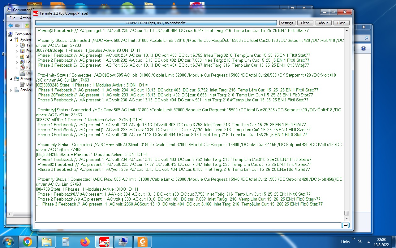

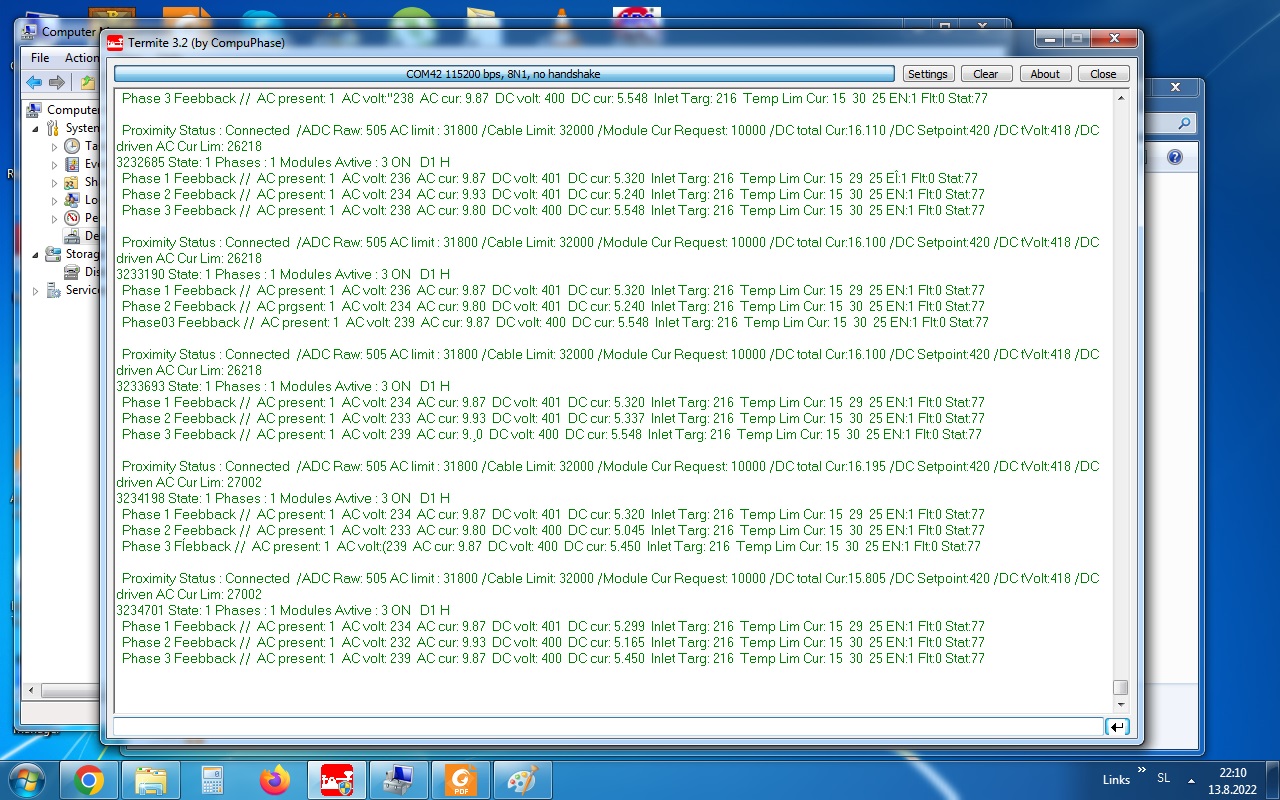

EV_Builder wrote: Wed Aug 10, 2022 8:45 pm Post a canbus log of it and I will take a look at it. From turning charger on couple of those cycles and turning off.
Ok, see the serial log appended.
Also see photo of the charger running at 16A AC limit. It pulled only 13A despite 30000 current limit.
Next i tried to set charger in manual mode and it reverted to 9A AC limit!!!!
Damien, would you check your ported code? Maybe there is just a silly current limit set in hex file...
EDIT: Now there is another thing... as soon as i removed my usb/FTDI module from the serial cable charger stopped and released EVSE. I tried several times. It is definitely EMI on serial line, if i keep USB connected its all good.
Tesla charger debug.txt
(102.84 KiB) Downloaded 412 times

DOH!
I found the V5 code ported for STM32 chip
https://github.com/damienmaguire/Tesla- ... er_Gen2_V5
There i went into a file main.c and browsed around 8-) .
I managed to find this from line 213
  EEPROM_Read(&parameters);
  if (parameters.version != EEPROM_VERSION)
	  parameters.version = EEPROM_VERSION;
	  parameters.currReq = 20000; //max input limit per module 1500 = 1A
	  parameters.enabledChargers = 123; // enable per phase - 123 is all phases - 3 is just phase 3
	  parameters.can0Speed = 500000;
	  parameters.mainsRelay = 48;
	  parameters.voltSet = 40000; //1 = 0.01V
	  parameters.tVolt = 40000;//1 = 0.01V
	  parameters.autoEnableCharger = 1; //disable auto start, proximity and pilot control
	  parameters.canControl = 1; //0 disabled can control, 1 master, 3 slave
	  parameters.dcdcsetpoint = 14000; //voltage setpoint for dcdc in mv
	  parameters.phaseconfig = Singlephase; //AC input configuration
	  parameters.type = 1; //Socket type1 or 2
	  EEPROM_Write(&parameters);
If you divide up max limit for module 20000/1500 you get 13.33A which is what i am getting! LOL...
I just need to reset EEPROM parameters and compile code... not my area of expertise.
Is there anyone who knows where this code is compiled... or better, could compile this for me with change in particular line to 24000?
tnx

arber333 wrote: Sat Aug 13, 2022 9:26 pm If you divide up max limit for module 20000/1500 you get 13.33A which is what i am getting! LOL...
In my version of the code that value is set to 0. I think this is because it reads this value from whatever you set in eeprom via serial settings. There is a current limit somewhere else in there. I'm only able to request 16A AC per phase and my charger is gen3 and can output quite a bit more. Can anybody help please?

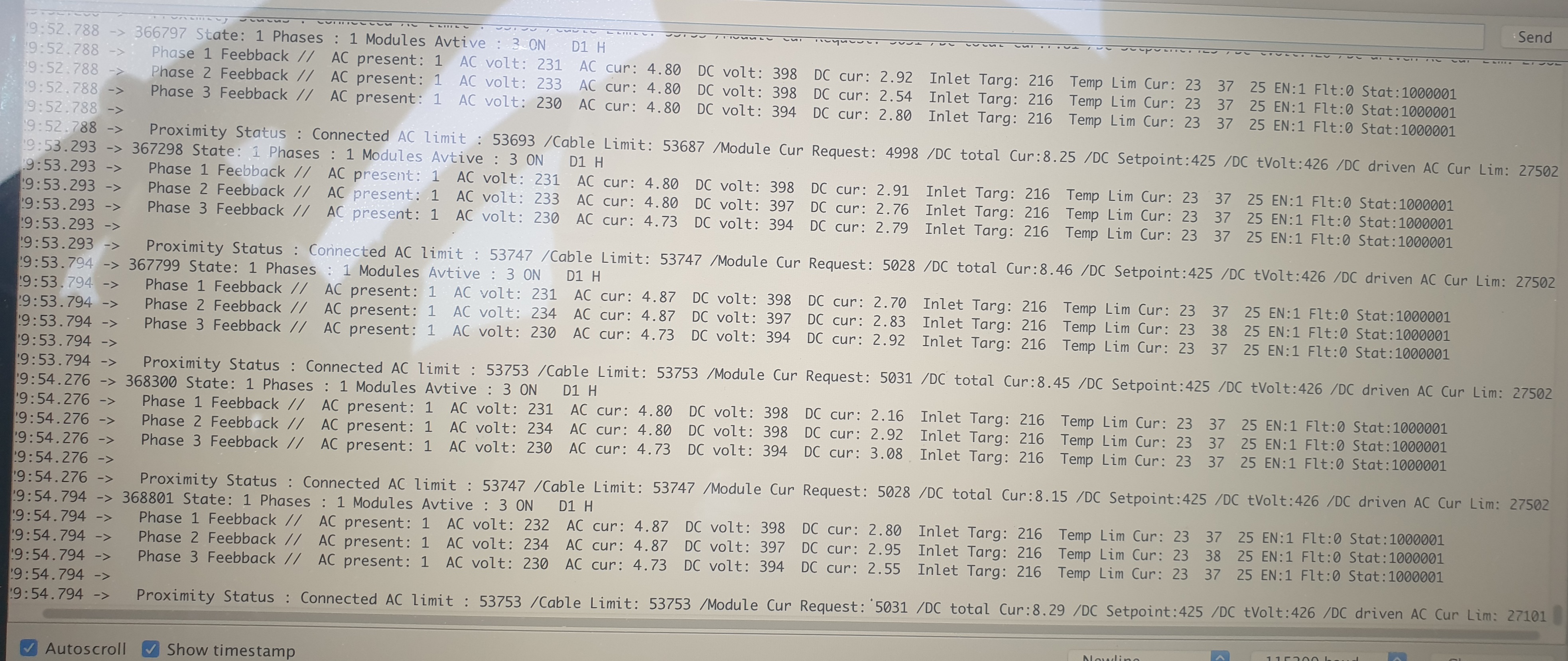

I tried now to put it in manual mode and it shows 8A module current request but it doesn't even start!
EDIT: I changed phase current mode to 1 and then upped the AC current to a larger value and module current request went up to 9A max. So there seems to be something wrong with how module current request is calculated.

m.art.y wrote: Sun Aug 14, 2022 4:44 pm I tried now to put it in manual mode and it shows 8A module current request but it doesn't even start!
I managed to compile and upload my changed code and now i get the same problem as you do. Charger current swings wildly from 720W to 8kW in auto mode. While in manual mode i only get 8.8kW from it.
I dont see any other inhibiting constants.
@TomDB do you think there is something in your code that would cause this kind of behaviour?
EDIT: I changed cable value in main.c line 666 but no difference...
 if ( parameters.type == 2)
    if ( val > 950)
      Proximity = Unconnected;
    else
      Proximity = Connected;
      if ( val < 950 && val > 800)
        cablelim = 16000;
      if ( val < 800 && val > 700)
        cablelim = 20000;
      if ( val < 600 && val > 450)
        cablelim = 32000;
      if ( val < 400 && val > 250)
        cablelim = 63000;

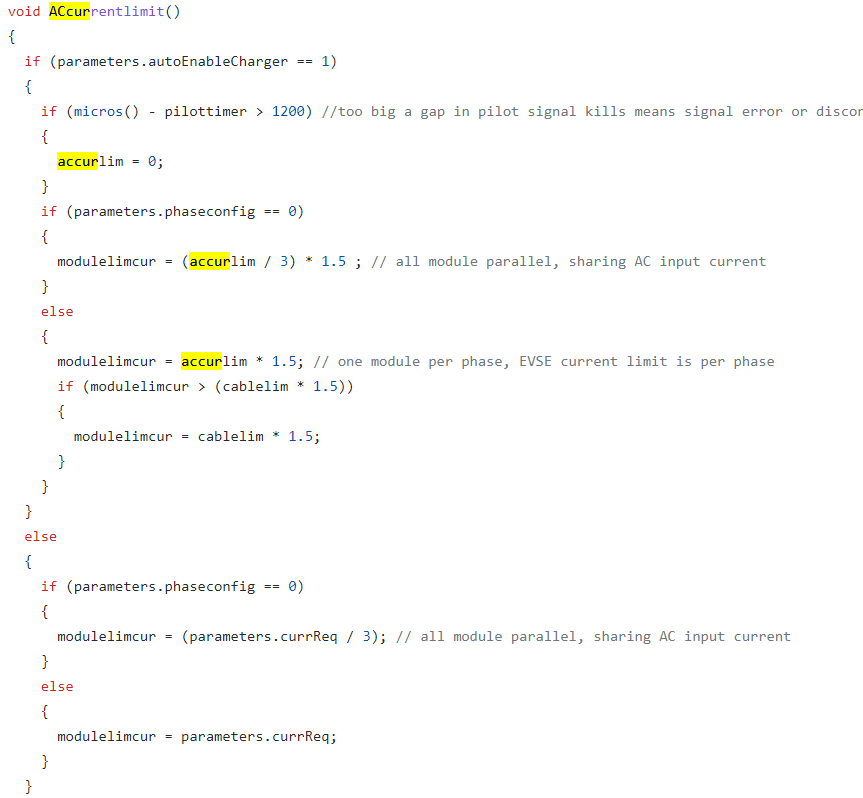

arber333 wrote: Mon Aug 15, 2022 9:11 am I managed to compile and upload my changed code and now i get the same problem as you do. Charger current swings wildly from 720W to 8kW in auto mode. While in manual mode i only get 8.8kW from it.
This is ecaxtly what I'm talking about! What did you change in the code and which version you used? I think this ramping up and down significantly reduces average charging power as a lot of time charger spends at low amperages while it's ramping up.
One thing I noticed yesterday at the 53A charger where I was limited to 5A per module when I was randomly changing all sorts of numbers and settings in the code: I set the charger configuration to 1 phase shared current while it actually is 3 phase (one phase per module) and then upped the current request in serial settings to 40A and I somehow managed to get the code to set 10A current request per module and charger kept 10A per module stable all the time! So I don't know what's going on here, maybe a bug in how current request is calculated?
Posts: 3796
Been thanked: 413 times
m.art.y wrote: Mon Aug 15, 2022 9:36 am This is ecaxtly what I'm talking about! What did you change in the code and which version you used? I think this ramping up and down significantly reduces average charging power as a lot of time charger spends at low amperages while it's ramping up.
Nothing seems to have worked...
I tried to compile the open code, but there is a persistent warning about serial reports i dont understand.
Whenever i compile the code i get charger with wild current swings.
Also i contacted Johannes and he tells me there is a hwaclimit reference. I think we will work this out in the next days. Either it can be increased or not.

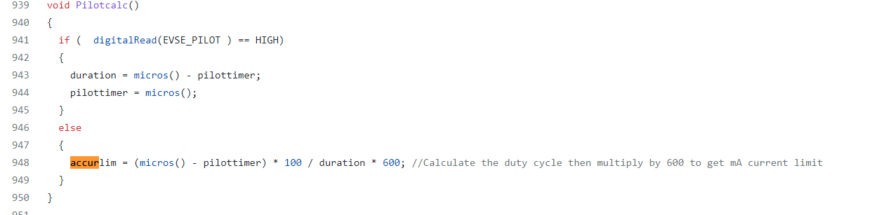

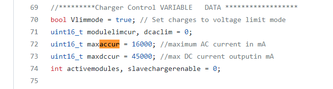

m.art.y wrote: Tue Aug 16, 2022 2:21 pm how module current request is calculated and where it is limited in the code?
There are so many places.
I would believe you might have the canbus setup so its trying to control a second charger
what is the max value you get in debug with "Module Cur Request: " infront of it?
Posts: 2962
Has thanked: 330 times
Been thanked: 848 times
Just reviewed code some more.
"dcaclim" does not limit and same for "maxaccur"
So indeed set the canbus control setup to "Off" to get it not to limit by trying for a second charger with load sharing.

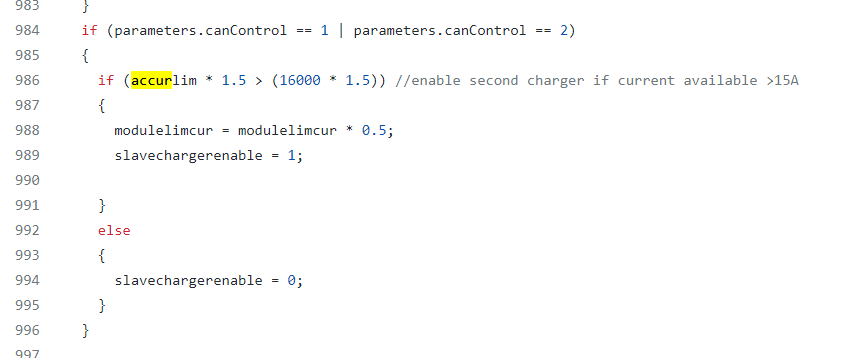

tom91 wrote: Tue Aug 16, 2022 3:57 pm So indeed set the canbus control setup to "Off" to get it not to limit by trying for a second charger with load sharing.
I might have an opertinutiy in a month or two to work on a setup using a Gen 3 charger so can do testing myself then.
So had a chance to test this finally and you were spot on. I set CAN control to Off and I could set AC Amps above 16A, not sure what's max for gen3 but I went up to 22A AC per phase. Thanks a lot Tom! I totally missunderstood what CAN control was for and didn't even think this could be the issue.
I also solved the other issue with code limiting module current request when it sees 53A as the accurlim over CP. It just doesn't like that high number. So with my limited coding abilities I added an extra line under accurlim calculation:
if (accurlim > 32000) accurlim = 32000;
And it now allows to request current as usual. I have also noticed that it helped with current ramping up and down because accurlim is now stable 32000, previously it had been reporting ~32050-32150mA so a little jitter in there as well, perhaps it does not like that because module current request is calculated from accurlim. Current is still ramping up and down but not every couple seconds as before, it seems to hold max current longer, sometimes quite long which wasn't the case before. Would be nice to eliminate that ramping altogether. 😊 But overal I like Tesla gen3 charger it outputs some serious current 😊
