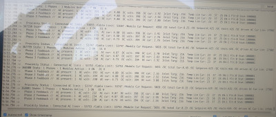

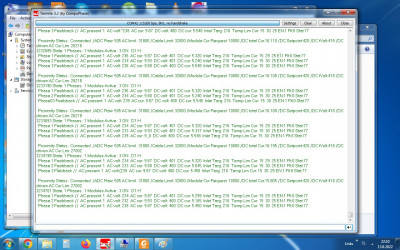

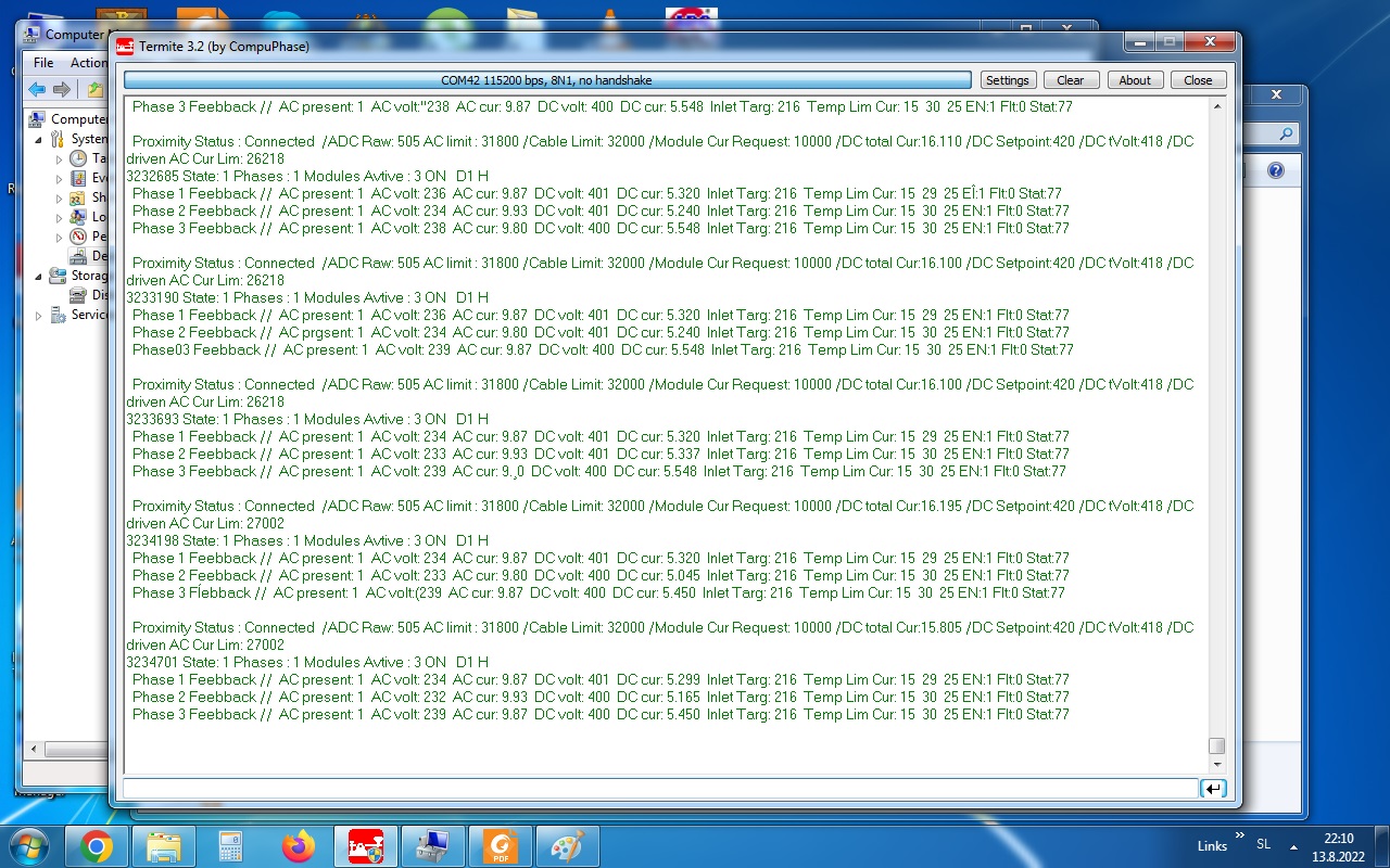

Ok, see the serial log appended.
Also see photo of the charger running at 16A AC limit. It pulled only 13A despite 30000 current limit.
Next i tried to set charger in manual mode and it reverted to 9A AC limit!!!!
Damien, would you check your ported code? Maybe there is just a silly current limit set in hex file...
EDIT: Now there is another thing... as soon as i removed my usb/FTDI module from the serial cable charger stopped and released EVSE. I tried several times. It is definitely EMI on serial line, if i keep USB connected its all good.
Tesla charger debug.txt
(102.84 KiB) Downloaded 405 times

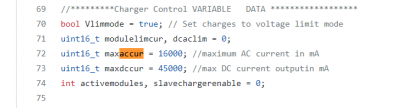

arber333 wrote: Sat Aug 13, 2022 9:26 pm If you divide up max limit for module 20000/1500 you get 13.33A which is what i am getting! LOL...
I just need to reset EEPROM parameters and compile code... not my area of expertise.
Is there anyone who knows where this code is compiled... or better, could compile this for me with change in particular line to 24000?
In my version of the code that value is set to 0. I think this is because it reads this value from whatever you set in eeprom via serial settings. There is a current limit somewhere else in there. I'm only able to request 16A AC per phase and my charger is gen3 and can output quite a bit more. Can anybody help please?

I have another problem with the Tesla gen3 charger and arduino code. So far I have been limited to charge at 16A per phase. But I encountered this high power charger and I am limited to 5A per phase despite whatever I set in serial settings. Any ideas? Why module cur req is only 5A? 😊
Posts: 3660
Has thanked: 145 times
Been thanked: 369 times
m.art.y wrote: Sun Aug 14, 2022 4:30 pm I have another problem with the Tesla gen3 charger and arduino code. So far I have been limited to charge at 16A per phase. But I encountered this high power charger and I am limited to 5A per phase despite whatever I set in serial settings. Any ideas? Why module cur req is only 5A? 😊
Do you use the charger in manual mode. I can only get 9A per module that way.. if i use it in auto mode i can get 13A!

I tried now to put it in manual mode and it shows 8A module current request but it doesn't even start!
EDIT: I changed phase current mode to 1 and then upped the AC current to a larger value and module current request went up to 9A max. So there seems to be something wrong with how module current request is calculated.

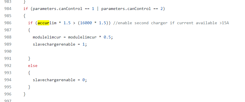

tom91 wrote: Wed Aug 14, 2019 4:15 pm I have a crude version of DC current control that needs testing, once this is tested I will look at merging this back into the open source version.
Hi, Tom, would you happen to remember how module current request is calculated and where it is limited in the code? I can't go above 16A per phase and my charger is a gen3. Also when I went to a charger with it's own cable the accurlim was reported as 53A but module current request was only 5A. I know you have worked on this long time ago but maybe from a glance at the code you'd have an idea? 😊
Posts: 2754
Location: Bristol
Has thanked: 264 times
Been thanked: 717 times
m.art.y wrote: Tue Aug 16, 2022 2:21 pm how module current request is calculated and where it is limited in the code?
There are so many places.
I would believe you might have the canbus setup so its trying to control a second charger
what is the max value you get in debug with "Module Cur Request: " infront of it?

Just reviewed code some more.
"dcaclim" does not limit and same for "maxaccur"
So indeed set the canbus control setup to "Off" to get it not to limit by trying for a second charger with load sharing.
I might have an opertinutiy in a month or two to work on a setup using a Gen 3 charger so can do testing myself then.
m.art.y
Posts: 673
Location: UK/EU
Has thanked: 37 times
Been thanked: 36 times
Post by m.art.y »
tom91 wrote: Tue Aug 16, 2022 3:57 pm So indeed set the canbus control setup to "Off" to get it not to limit by trying for a second charger with load sharing.
So had a chance to test this finally and you were spot on. I set CAN control to Off and I could set AC Amps above 16A, not sure what's max for gen3 but I went up to 22A AC per phase. Thanks a lot Tom! I totally missunderstood what CAN control was for and didn't even think this could be the issue.
I also solved the other issue with code limiting module current request when it sees 53A as the accurlim over CP. It just doesn't like that high number. So with my limited coding abilities I added an extra line under accurlim calculation:
if (accurlim > 32000) accurlim = 32000;
And it now allows to request current as usual. I have also noticed that it helped with current ramping up and down because accurlim is now stable 32000, previously it had been reporting ~32050-32150mA so a little jitter in there as well, perhaps it does not like that because module current request is calculated from accurlim. Current is still ramping up and down but not every couple seconds as before, it seems to hold max current longer, sometimes quite long which wasn't the case before. Would be nice to eliminate that ramping altogether. 😊 But overal I like Tesla gen3 charger it outputs some serious current 😊
