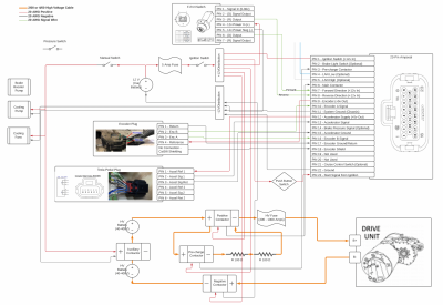

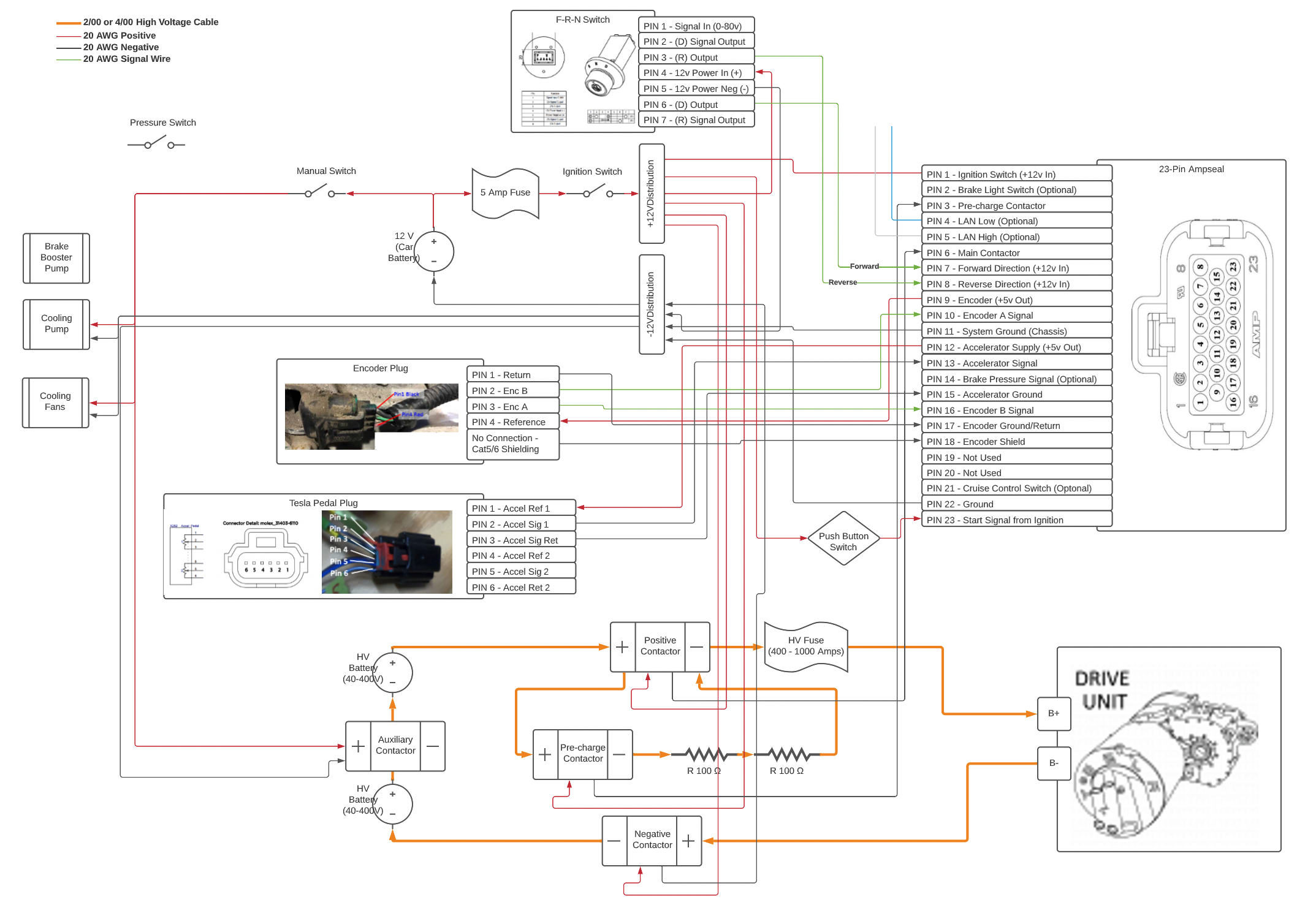

Hi!
Tried to search here but didnt find anything, I may be stupid but rather one question to much than on to little.
Pin 11 Says "System Ground (Chassis)"
Pin 22 Says "System Ground"
Is there any difference to these? I feel like both should be to the chassi of the car? Or should Pin 22 go to Negative on then 12V system? (but thats the same as chassis..)
Thanks in advance, Im building myself a harness!

Here is the wiring diagram that I have operational in my car. I did as you said, I grounded both 11 and 22 to the chassis. (Open for objections by others)
