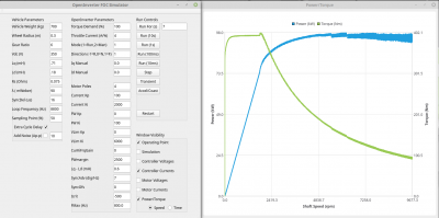

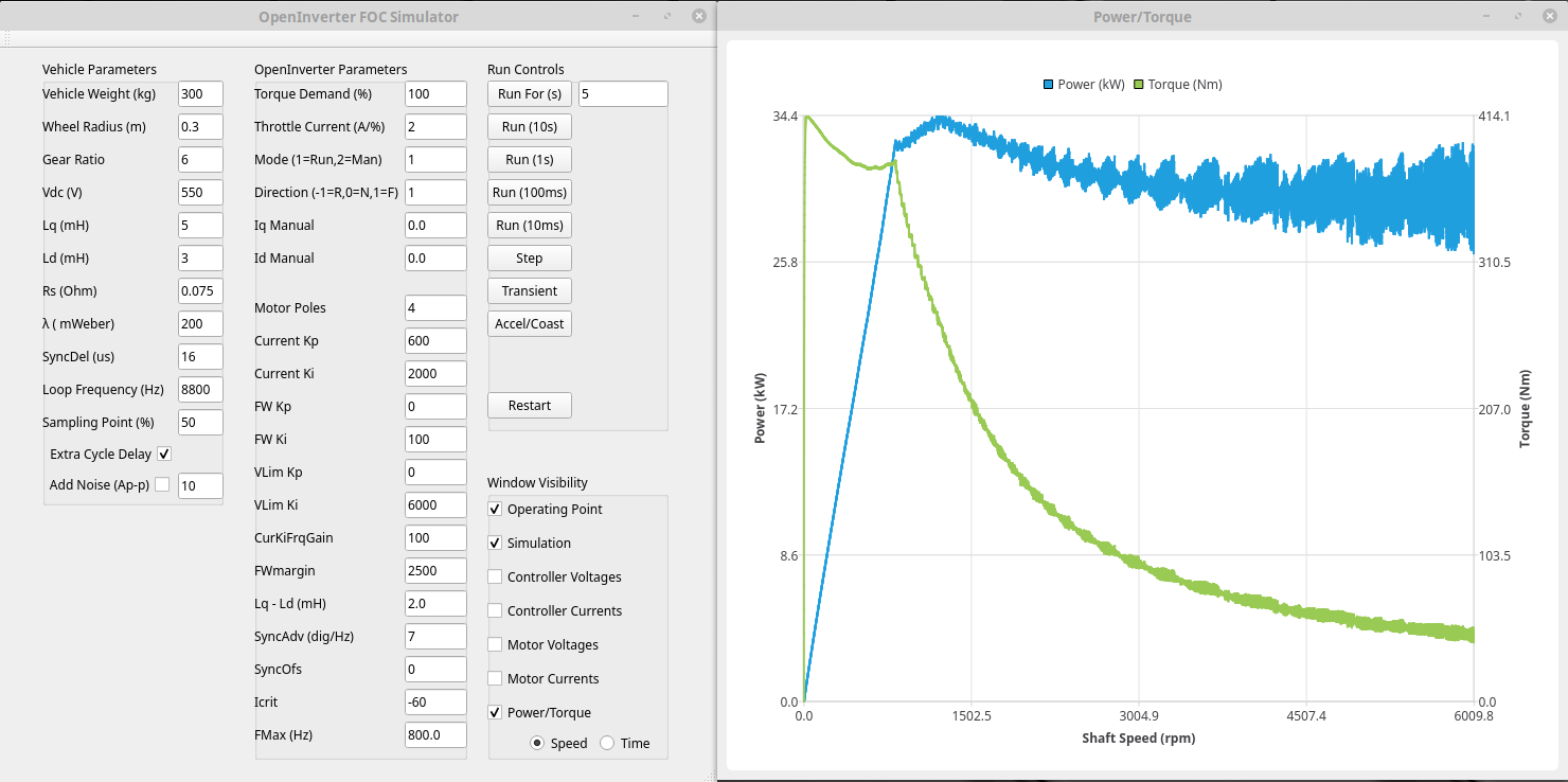

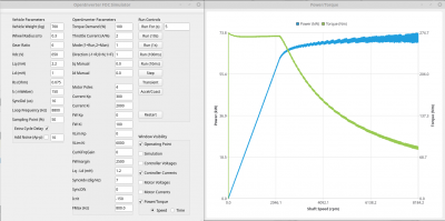

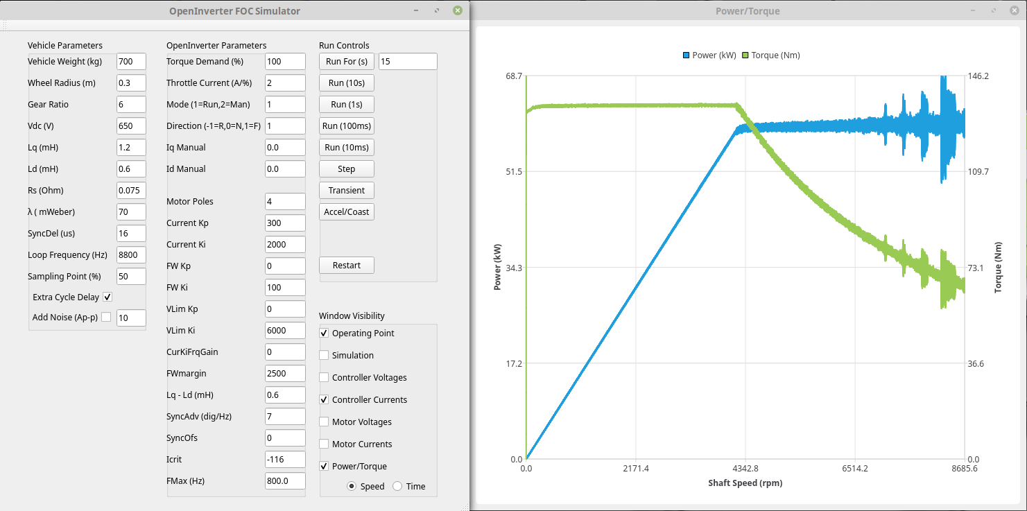

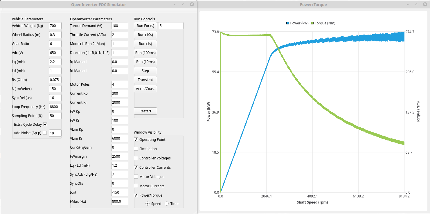

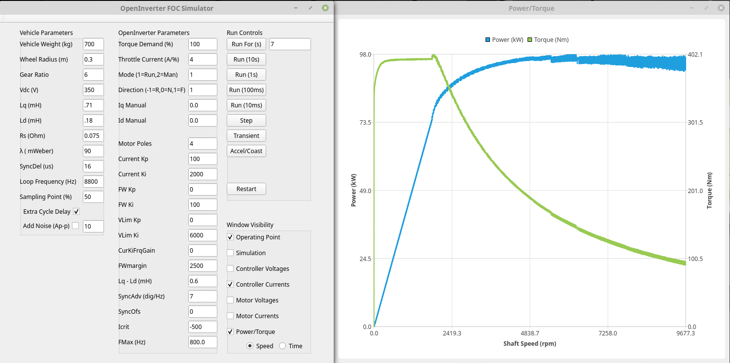

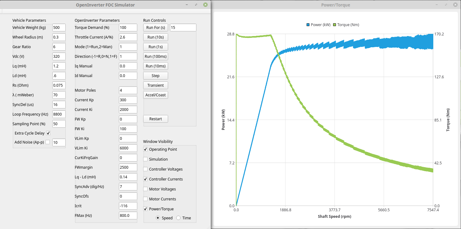

Just added a new power/torque window to the simulator :) Since each plot I add slows it down (a 10sec simulation was taking 30sec to render) I've also made it so that you can select which plots are shown/processed; with a couple of windows up the same run only takes a couple of seconds.
I thought it would be interesting to try and model the motors we have data for so far. The flux linkage is sort of guessed, it's been tweaked until the plot shape is closish to the plots found here https://www.semanticscholar.org/paper/S ... 5db9322241. The gains have been adjusted a bit for each but I wouldn't say they have been optimised, all the settings can be seen in the screen grabs.
First the Prius Gen2 (based on inductance data off the web):
If anyone has data for the Gen3 let me know, from the link above it looks like it might work better.
Leaf (based on @Bigpie's motor measurements):
Outlander rear (based on my motor measurements):
RX400H MG1 (based on Ev8's motor measurements) (note this is at the Lexus voltage of 650V):
RX400H MG2 (note this is at the Lexus voltage of 650V):
Not sure why but I couldn't get the RX400H figures much higher than this. We may need better flux linkage data to get much closer, I'm not sure how good the values we have at the moment are?

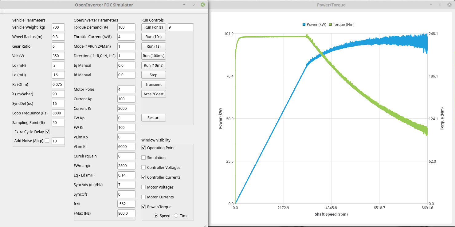

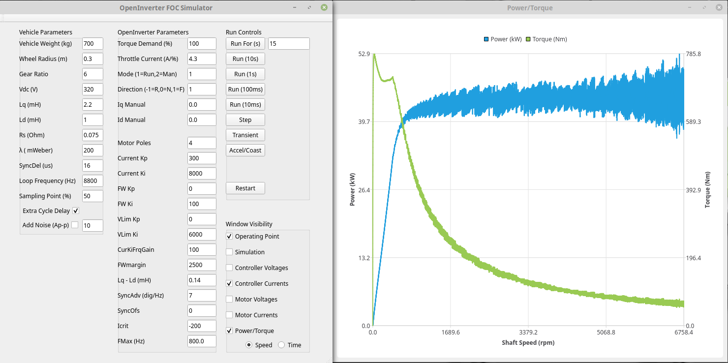

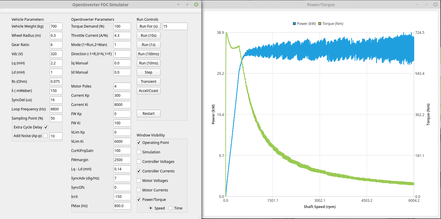

And here are a few plots for @Ev8 with the Lexus motors running at 320V.
MG1:
MG2:
And MG2 again but with the flux linkage increased from 150mW to 200mWeber:
This seems to pull the power up by maybe 20% which is what is making me wonder whether we have our numbers right here?
