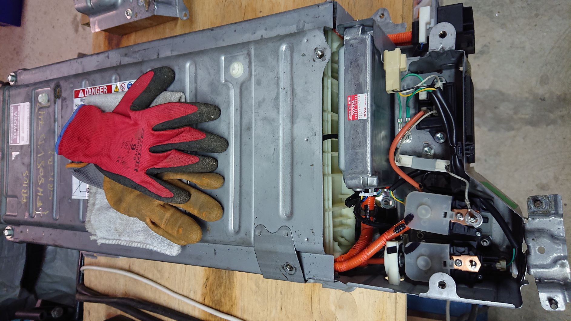

Hope to complete PWM phase positions in relation to adapterboard pinswap5 command. Once all is good, I will move to next power stage....happened to stumble on a Gen2 battery pack looking for a good home with 211 volts sleeping inside
. I hope to start with 4 modules at a time (28 volts) , so will make up some jumper cable system and remove the original bus bar set up in the meantime. Since the Safety Lever is connected to the pack in the middle, I will have to start there and move outwards in both directions when adding modules.
Would recharging 4 modules at a time with a 24 volt charger be a problem (short term solution)? I haven't gone into charger mode of the Inverter yet, and don't have a BMS yet.
I saw somewhere talk about Prius contactors not having economisers and there being a code to add for making them draw less current..Could this be a short term solution untill I sort out some certain Kilovacs with economisers ?

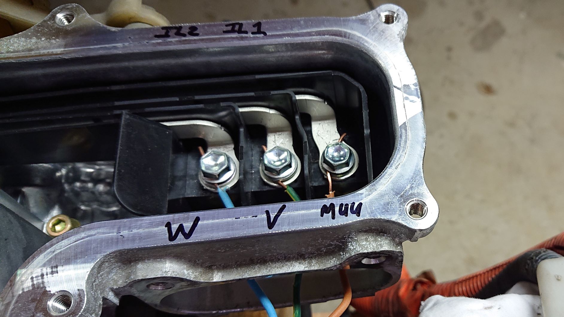

Got Foc set up on the bench, and trying to verify pinswap functions.
AFAIK, pinswap is only in FOC firmware. So I have noted my currents (that need swapping) along with PWM signals.
If I do any of the pinswap drop down selections in Foc mode, no modifications appear at inverter for currents or pwm.. (after update, refresh and restart of board)
I had to physically swop cables last time round.
Since I'm planning on bumping up voltage, and using original prius connections, I can't go swopping cables around.
Any ideas? What am I missing?
