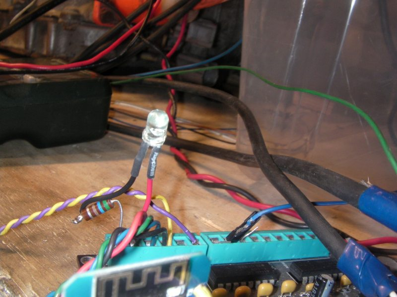

What you are doing is done with IPM motor with resolver.
If i understand you have ACIM and dual channel encoder. Four wires channel A, B and +12v, gnd.
Inside the brain this is converted to quad encoder position but you need to input how many pulses does single channel make. You count this by putting a LED on signal A and 12V and count it blink.
... If signal is pnp you need to provide gnd to other side of the led...
Count... one physical rotation?
And then... do what with that number? Is that my numimp?

LED will blink when encode moves beyont the next step. Here i used 60 slot single channel optical encoder and it worked with ACIM really fine.MattsAwesomeStuff wrote: ↑Sat Mar 23, 2024 7:54 pm Count... one physical location?
https://mazdamx3ev.wordpress.com/2015/0 ... er-senzor/
Yes "numimp" is actually number of impulses on one channel along one rotation. So if you see your encoder stating 64ppr this is 64 pulses per rotation. But inverter sees it as 256 signal for determining speed and direction of rotation because A and B differ in phase. When signal A is 1 B is 0. Thats your AB encoder. Mine was just 60pr without direction data. To do that my inverter switched phase count in software directly. So my motor could simply roll downhill and inverter never knew. Yours could apply a "hil hold" function i guess...
Can you state the P/N for your encoder and some photo of its sticker?

https://www.dynapar.com/technology/enco ... e_encoder/MattsAwesomeStuff wrote: ↑Mon Mar 25, 2024 8:56 am
Hmm, no. The only thing I know about the encoder is that it's a superseal connector that goes into the far side of the motor.
Nothing in the spec sheet identifies the encoder other than its pinout.
Ok, then your best bet would be to put a wheel (a handle) to the shaft and count LED pulses from channel A for one revolution. If there are 64 pulses then so be it, but i am inclined there is more...

Re: Toyota Prius Gen 2 Inverter Controller
That was a great link, it was explained the right way for me to understand.
80.Ok, then your best bet would be to put a wheel (a handle) to the shaft and count LED pulses from channel A for one revolution. If there are 64 pulses then so be it, but i am inclined there is more...
80 pulses per revolution.
I set NumImp to 80 et voila. Zero means zero. A plot of angle shows exactly 1 revolution when I complete one revolution.
I found out what the resolver pole pair parameter does too. It correctly tells the software what 1 revolution is. So if I have 3 pole pairs and tell it to be 3, then 1 hz is actually 1hz instead of 1/3 hz. I'm not sure if that's helpful or not, or immaterial (just a number, whether it's 300% or 100% the speed doesn't matter).
