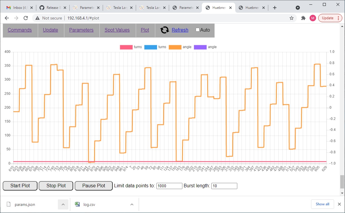

The jerking sounds to me like an encoder problem.
If you turn the motor by hand, can you see the 'speed' and 'turns' values changing?
If you plot 'angle' do you get a nice increasing graph? (It should go up to 360 and back to zero).
These can all show you if the board is reading your encoder correctly.

Isaac96, thanks for the overheat warning. My test setup is limited right now, I don't have room to insert the drive shaft to turn the motor, and my motor is missing one of the coolant intake coupling...
I plotted the angle and turn, if I am not mistaken that the "angle" is the angular position when the motor is turning, then I think there's something wrong. when I am NOT pressing, I logged values like a "step sine wave":
Did not notice any meaningful change to angle when pedal is pressed.

Finally got the firmware updated after a few attempt, works after I accidentally bump the voltage from 12.0V to 12.3V, which is closer to car battery voltage.
Also able to access encoder setting by this commend (from earlier post)
Default setting for encoder is A/B, which is jerking and very slow. I am able to get the motor to run smoothly and fast with "encoder mode = single", opposed to what Damien suggested... need to figure out why.
Next, will calibrate the throttle paddle, only reacting when the paddle is press down close to half way.
Thanks for all the help and suggestion.

Okay, your encoder A/B might be switched.
Good to hear it's working otherwise!

I switch the pins for encoder A & B and reset the encmode to A/B. It works the same as previously with encmode = single. I will keep it this way.
However odd, I realized the motor is spinning opposite direction for both Forward and Reverse. I checked the wiring and pin on the Ampseal connector and it is correct. Would there be adverse effect to switch the F/R signal so the motor will run correctly?
