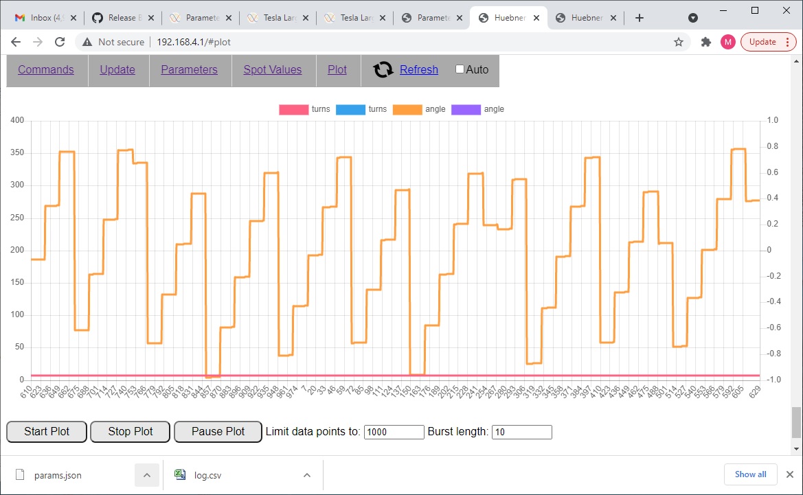

The jerking sounds to me like an encoder problem.
If you turn the motor by hand, can you see the 'speed' and 'turns' values changing?
If you plot 'angle' do you get a nice increasing graph? (It should go up to 360 and back to zero).
These can all show you if the board is reading your encoder correctly.

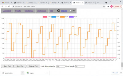

I plotted the angle and turn, if I am not mistaken that the "angle" is the angular position when the motor is turning, then I think there's something wrong. when I am NOT pressing, I logged values like a "step sine wave":
Did not notice any meaningful change to angle when pedal is pressed.

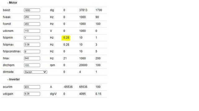

What you're seeing is slip frequency. Set fslipmin=0 to get rid of it.

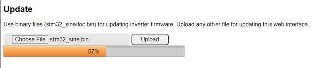

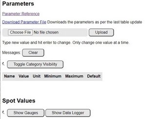

Well updating firmware was not successful. downloaded the latest firmware R5.11.R sine.bin and use the upload function on web interface. message indicate download complete, then status bar starts, but stuck at 57%:
waited for a long time and no change in status, no reaction from other buttons. I have no choice but to reboot the inverter card. It reconnected but all the parameters and spot section has rotating wheel with no values.
I attempt to upload again but it is the same for a few times. The contactor would click uncontrollably for a few second in some of the update attempts.
With the "upload complete" message, what is the meaning of the % status bar? what should be the typical update process like?
on the update section, there's also an option to "upload other files to update the web interface", am I missing this file for the new firmware?
Hope I didn't break my board...

You didn't break it. Since contactors are clicking make sure there is no HV.
Right now there is no valid firmware so the board will reboot every 2s and *should* allow to upload another update.
As long as there is no valid firmware you will not see parameters, as they are downloaded from the STM32
Upload complete means the file has been transferred onto the ESP8266 module. The percentage then shows the transfer from the ESP module to STM32

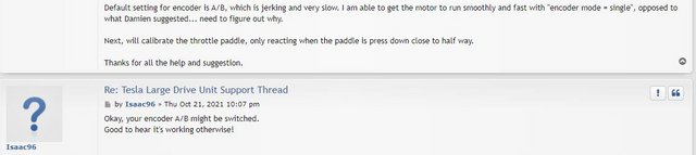

Finally got the firmware updated after a few attempt, works after I accidentally bump the voltage from 12.0V to 12.3V, which is closer to car battery voltage.
Also able to access encoder setting by this commend (from earlier post)
Default setting for encoder is A/B, which is jerking and very slow. I am able to get the motor to run smoothly and fast with "encoder mode = single", opposed to what Damien suggested... need to figure out why.
Next, will calibrate the throttle paddle, only reacting when the paddle is press down close to half way.
Thanks for all the help and suggestion.
the min value of my interface for fslipmin = 0.28...

- Posts: 656
Okay, your encoder A/B might be switched.
Good to hear it's working otherwise!

Oh, you're right. Hmm, put it to neutral then, that should disable slip.
