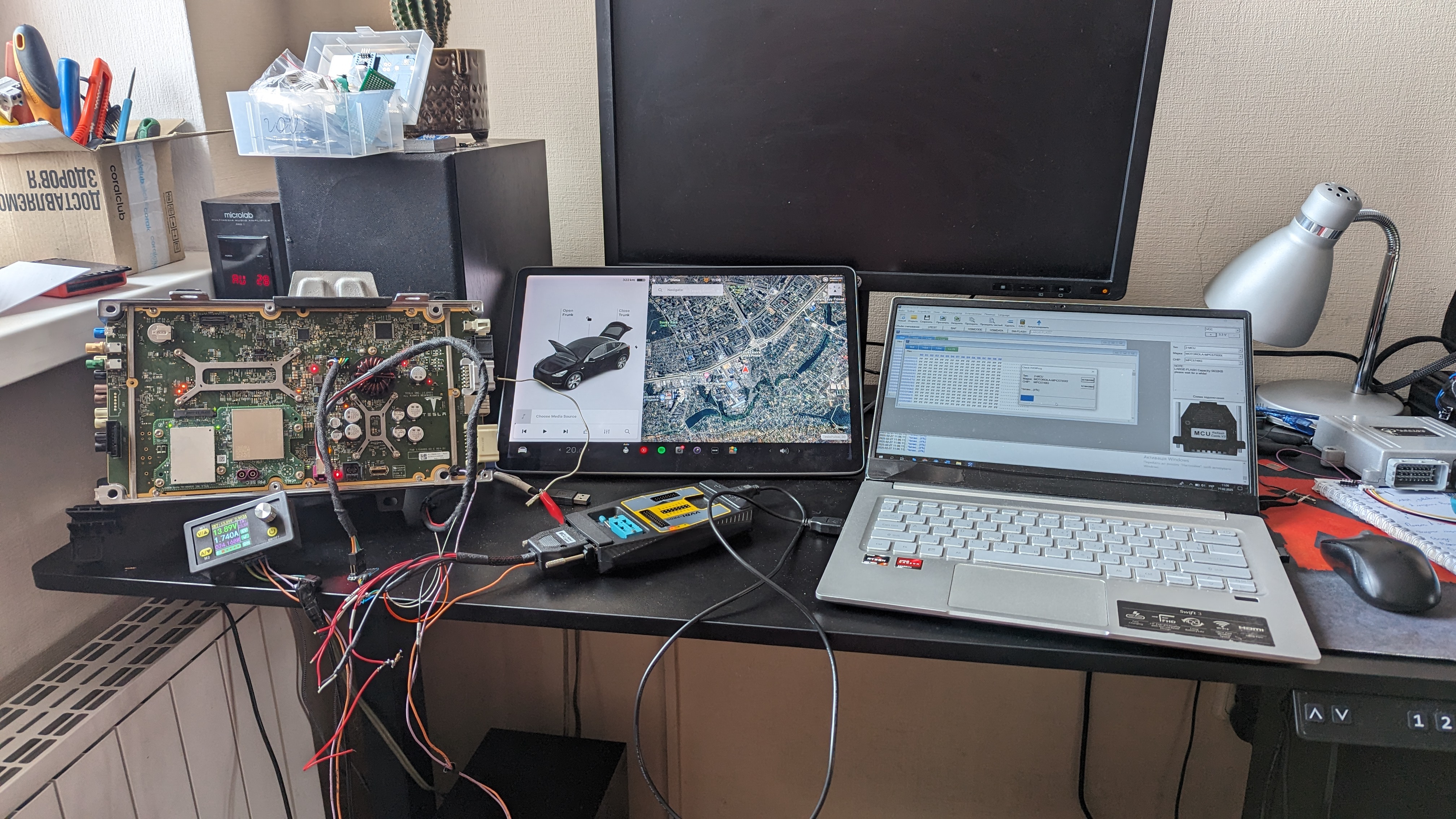

The new power supply didn't help, which means the problem is somewhere in the can messages.

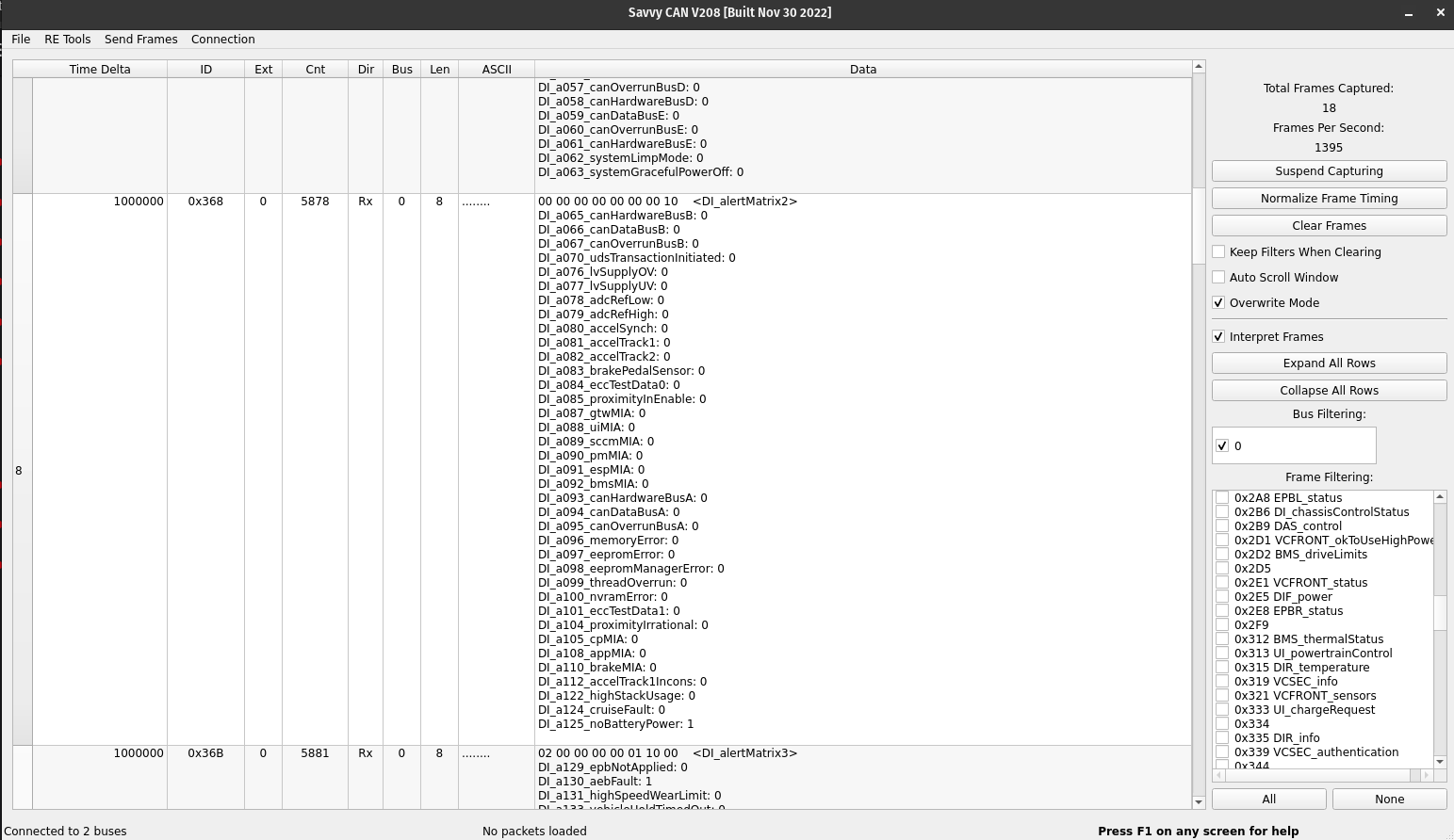

Post by AMP3R »
It works. Switches to D and R, but for some reason immediately returns to P. Also, a new alert DI_a125_noBatteryPower appeared.

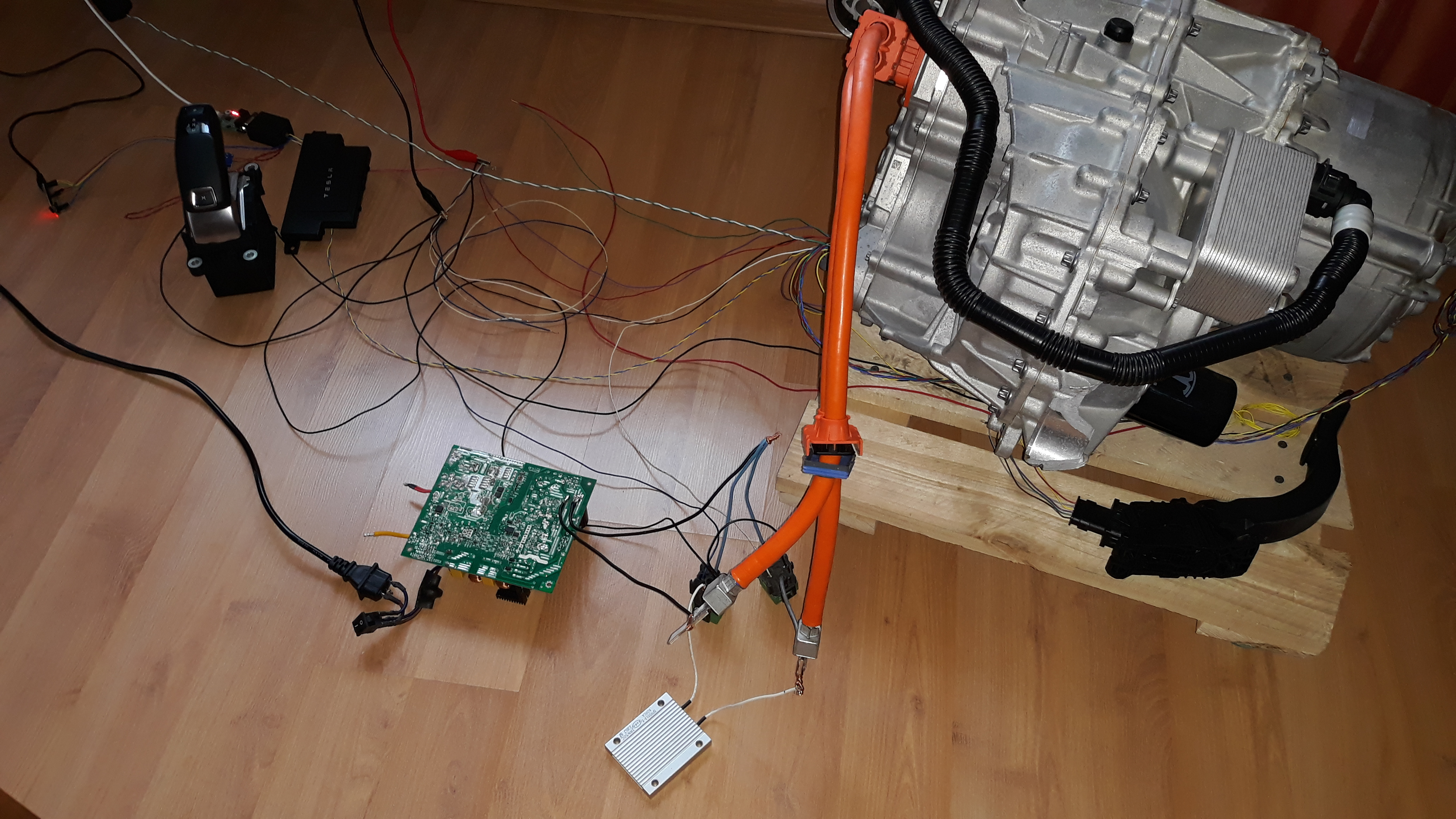

Bratitude wrote: Wed Apr 02, 2025 5:42 am great work AMP3R, just to recap:
-stock M3/MY drive unit
-matching VCSEC (from the same vehicle)
-stock pedal
-vehicle CAN
-HVIL terminated
key card is not required? or key card is required to enable keyless driving?
Key card is not required. You can enable keyless driving via can and that's it.
