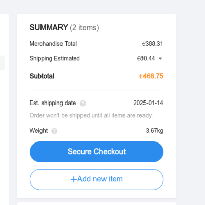

Working through the BOM ....

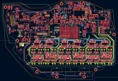

Latest schematic and PCB layout now on the githyb repo:
https://github.com/damienmaguire/Tesla- ... ter/Design
Posts: 3661
Has thanked: 10 times
Been thanked: 335 times
Needless to say if anyone has any info on the circuit or feedback etc would be much appreciated:)

Post by davefiddes »
Couple of comments on the video:
Seems like the STGAP1BS could be pre-supplied to JLCPCB like the QCA7000 on the Foccci for production runs of your board. Sure it adds cost but reflect that in what you charge for the board. No such thing as a free lunch.
I can recommend the "Fabrication Toolkit" from the KiCAD plugin repository. This creates the gerbers, BOM and position files in a form that JLC are happy with (and they recommend it). More details: https://github.com/bennymeg/Fabrication-Toolkit
If you want to make measurements on the Tesla gate driver behaviour with or without HV enabled this is entirely possible provided you are happy with fixed phase PWM values. I don't have a functioning inverter but the gate driver and PWM generation works fine. Shoot me an email if you want assistance.

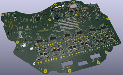

Thanks to a good friend in Germany with a Prusa XL, we have a 3d printed prototype board for fit tests. Good news is it is a VERY good fit. Bad news is genius here totally forgot about the hole and pads for the HV connection hvil :) Would have been quite an expensive mistake even with bare boards.

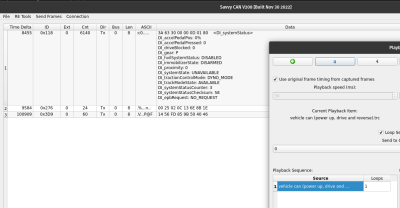

A few days ago I had an idea to take another close look what the inverter sends to the vehicle CAN and after poking around found something interesting. It turns out that there are many more ids with alerts and errors than I thought. By simple calculations edited the dbc file and when turned on the drive unit I was stunned.
Of course, nothing will work, because the DI_a174_notOkToStartDrive alert is active. The logic lacks 12 volts, which I supply from a regular ATX power supply. If this turns out to be the cause, it will be very funny. But it is too early to rejoice.

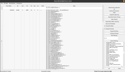

Managed to unlock the processor/memory in the drive unit via the UDS 0×27 security access service. It turned out that Tesla use static seed and key for all CAN ECUs.
I don't know what to do with all this yet. Maybe it will be possible to upload/download something from the inverter or at least change its config.

AMP3R wrote: Sun Feb 02, 2025 9:18 pm A few days ago I had an idea to take another close look what the inverter sends to the vehicle CAN and after poking around found something interesting. It turns out that there are many more ids with alerts and errors than I thought. By simple calculations edited the dbc file and when turned on the drive unit I was stunned.
The new power supply didn't help, which means the problem is somewhere in the can messages.
