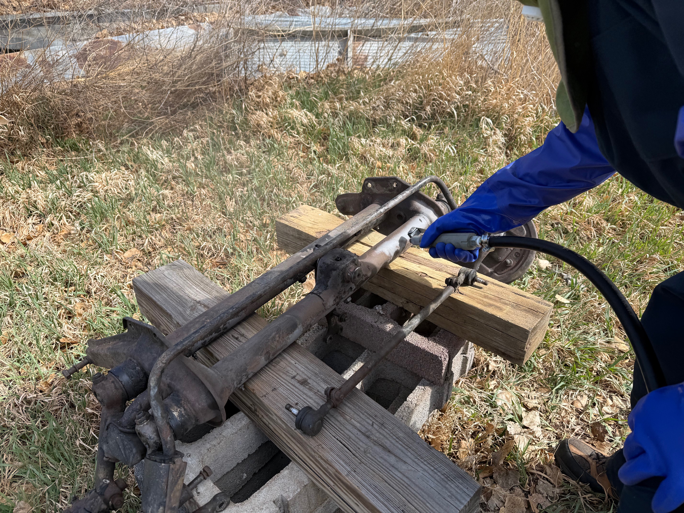

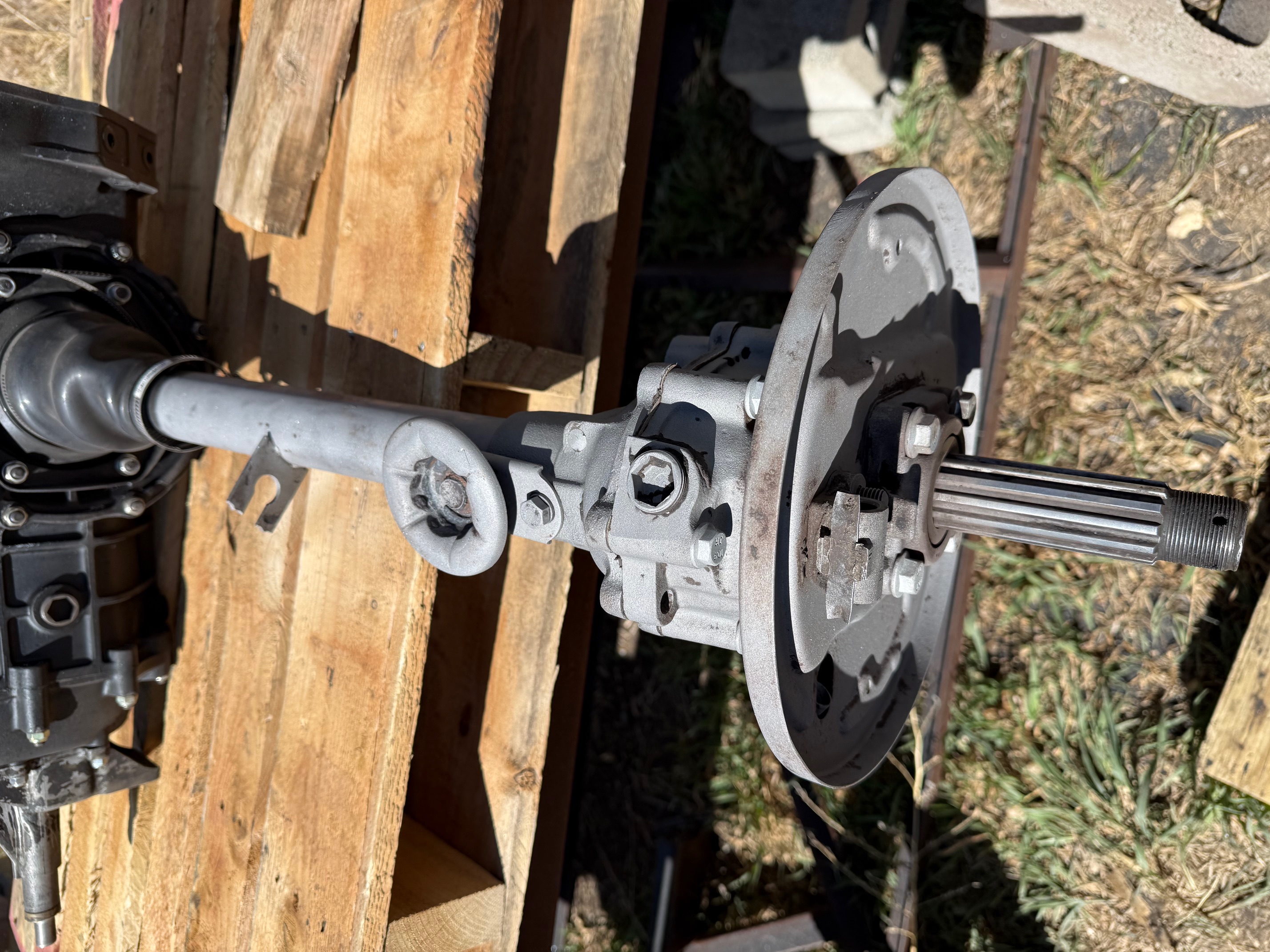

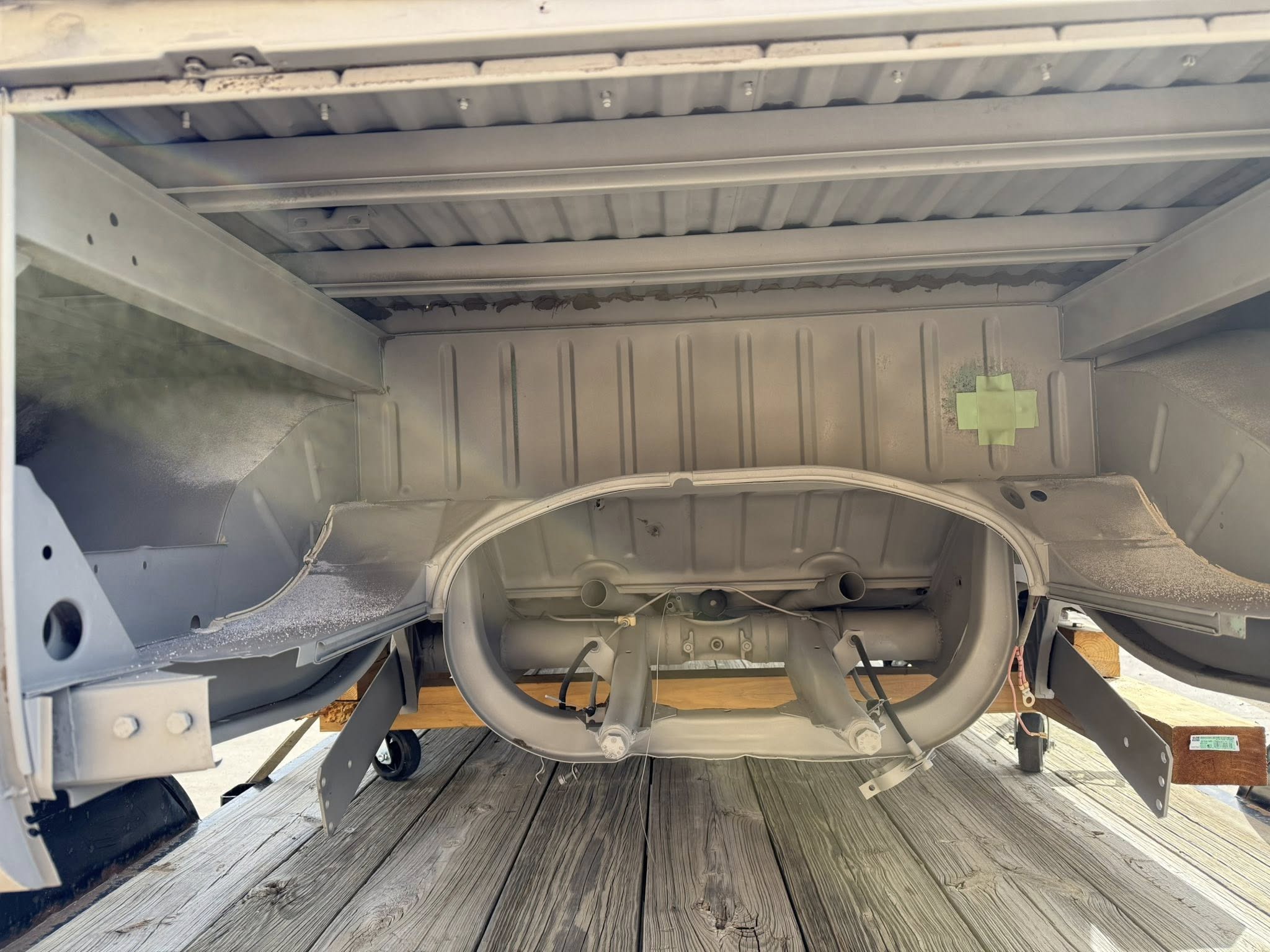

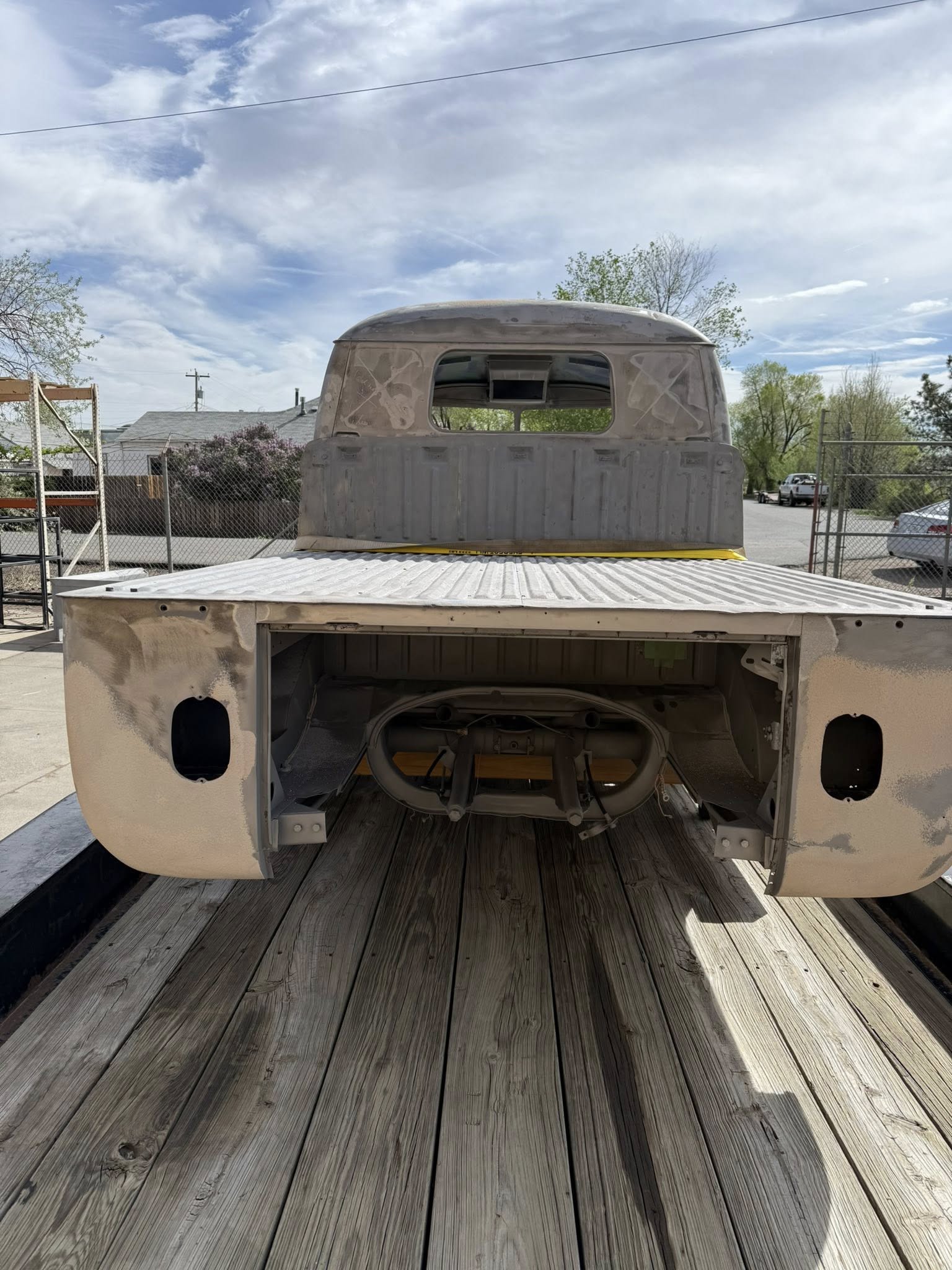

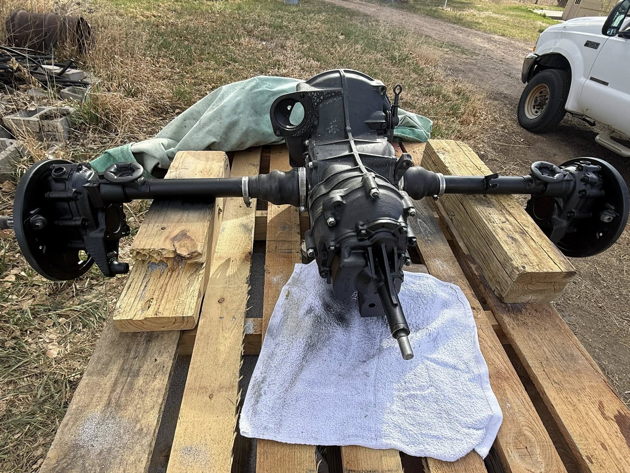

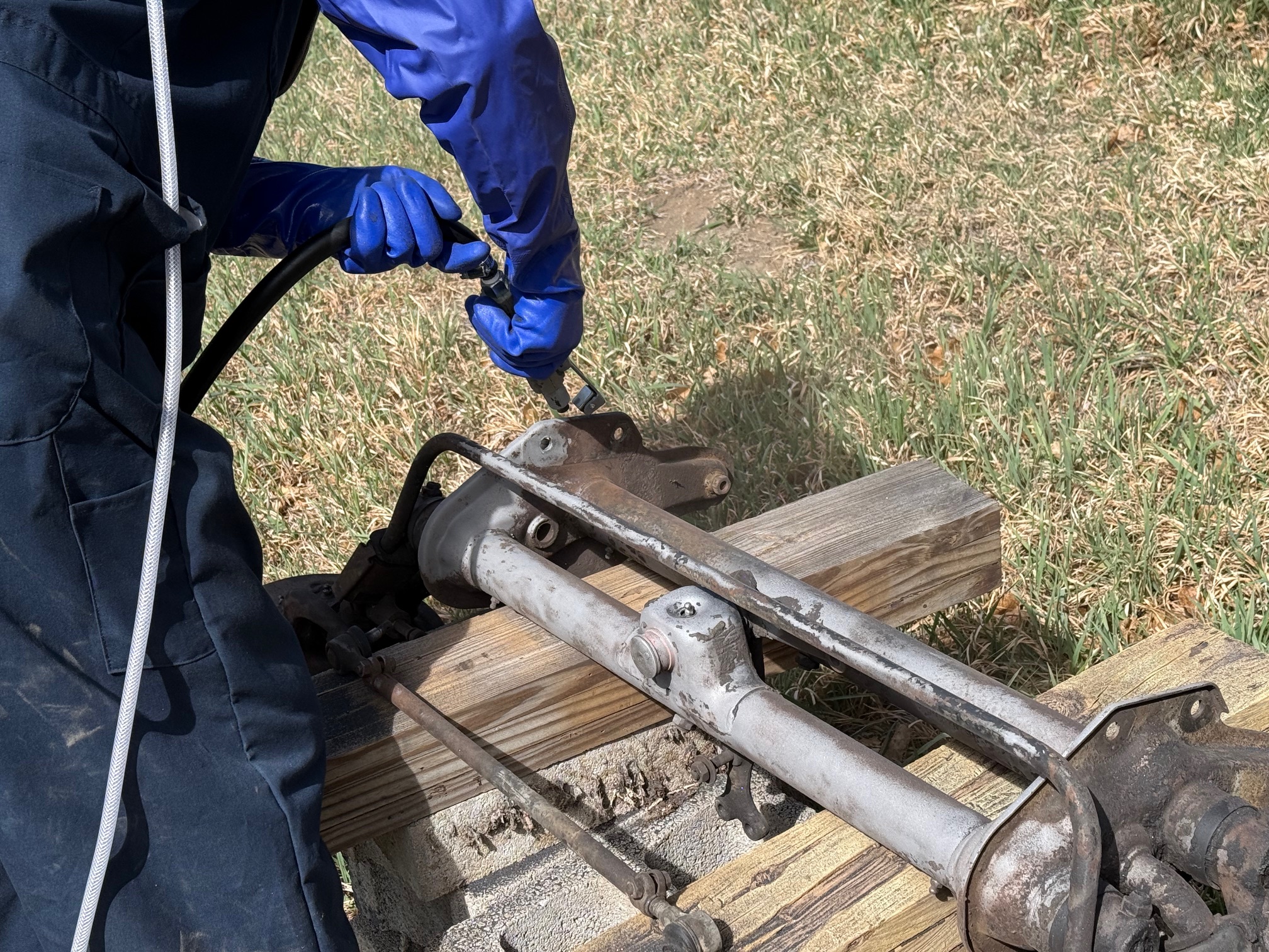

Couple of updates

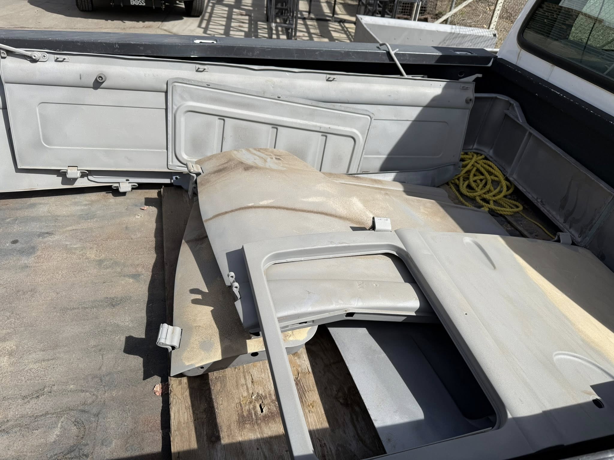

VW Transporter is at the metal stripper in Golden CO. Should be getting it back soon.

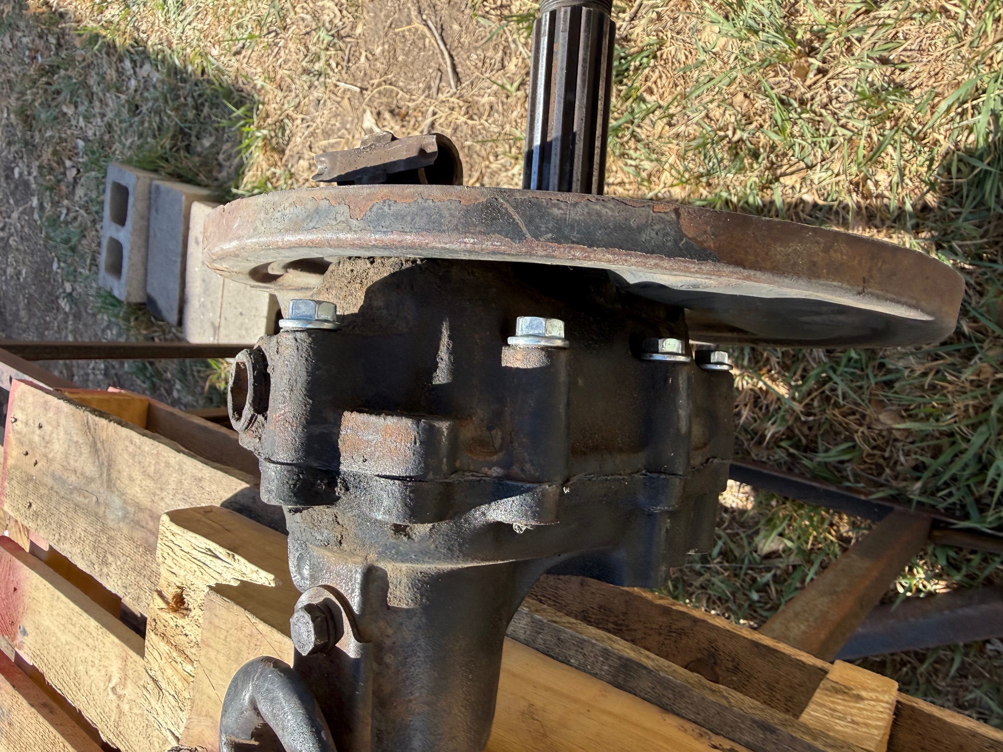

Have been replacing the "small nut" transmission with a new freeway flyer trans mission with the "Big Nut" Reduction Gear axels.
And stripping them at home and painting them. Also been working on the Front beam waiting on parts to rebuild the steering and king pins. Lots to do.....

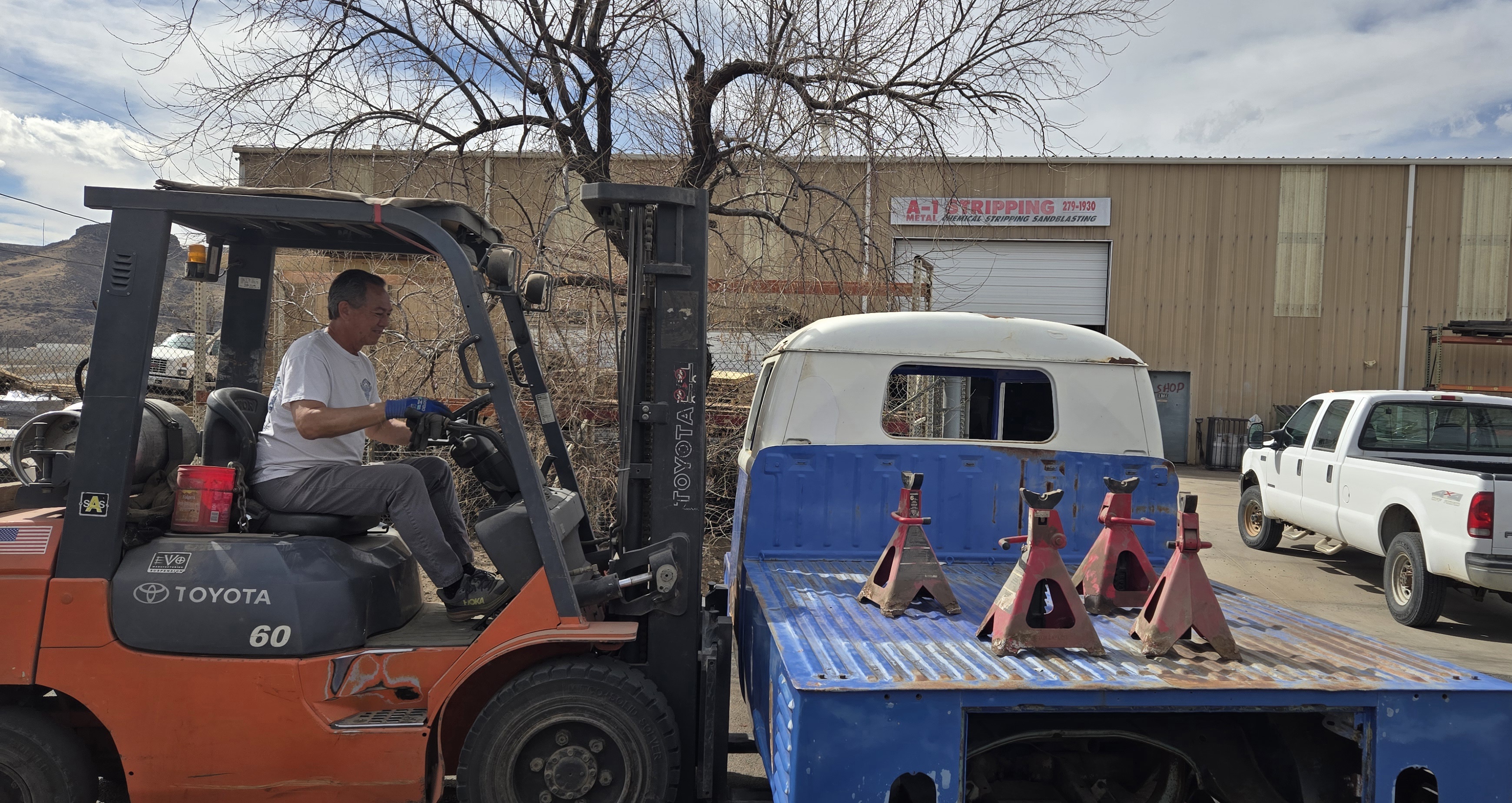

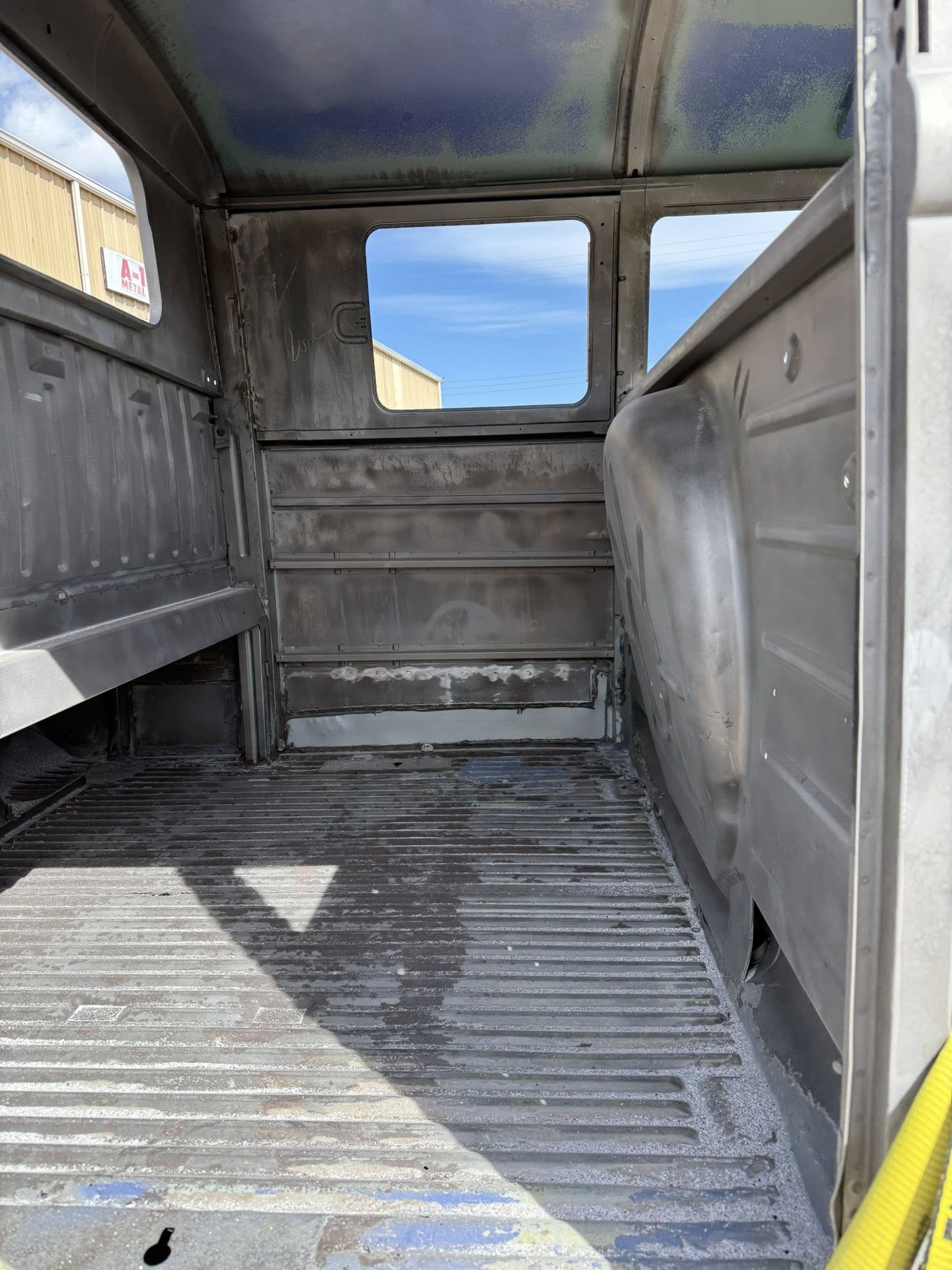

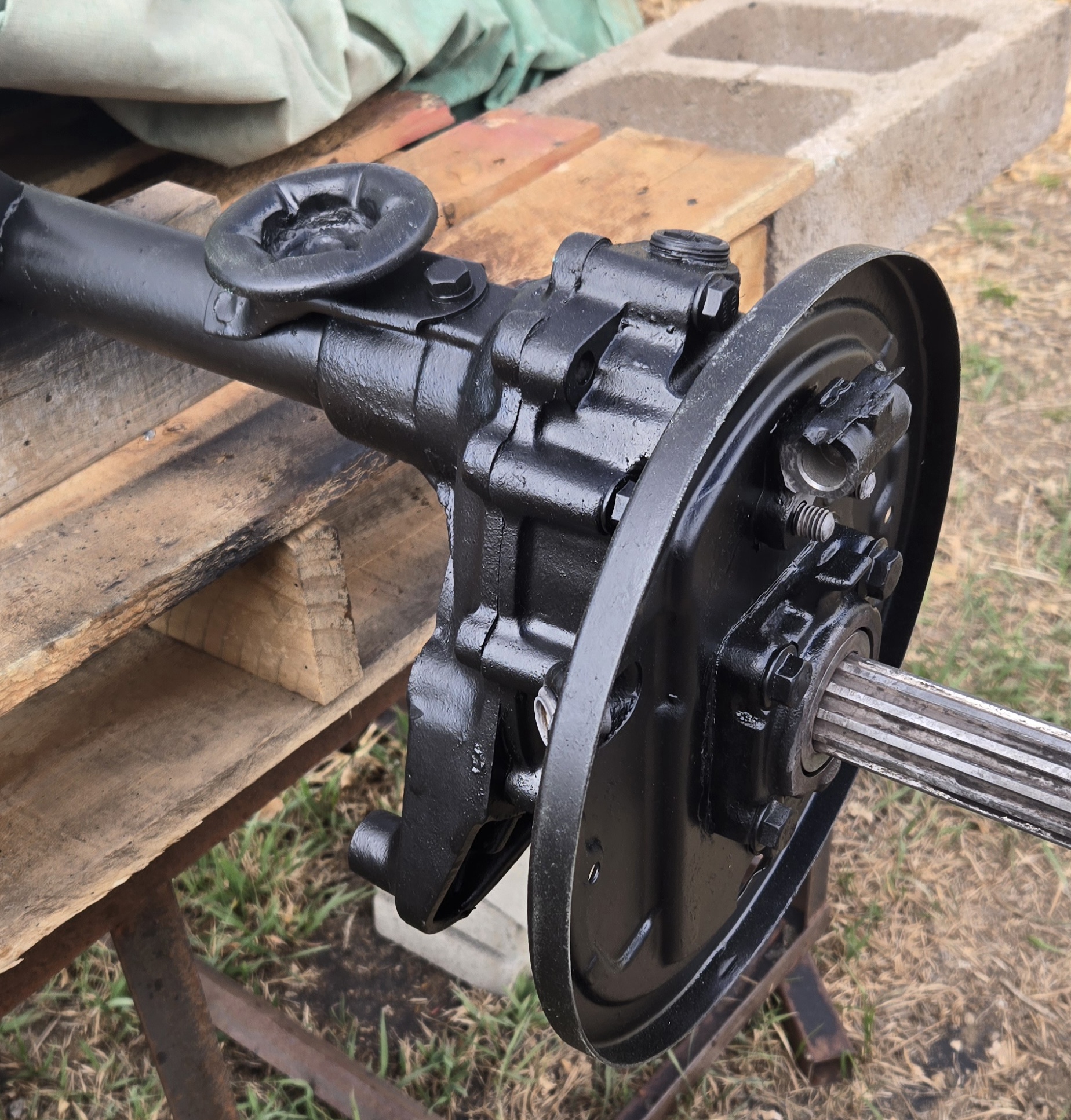

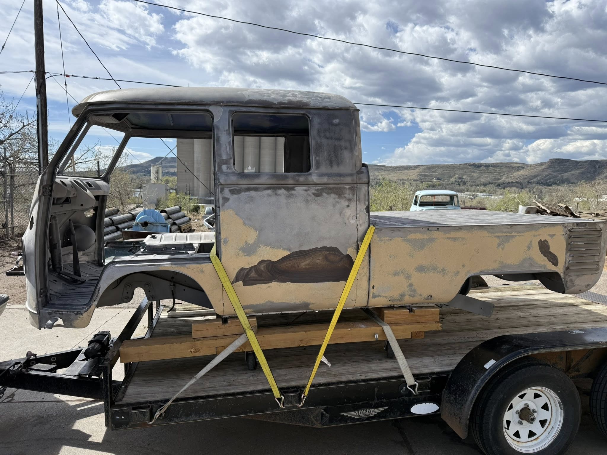

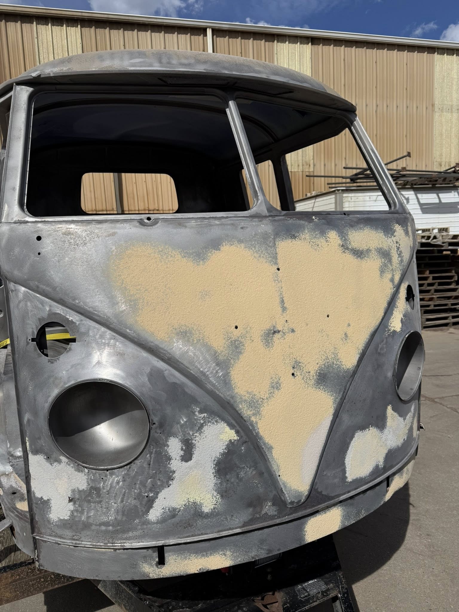

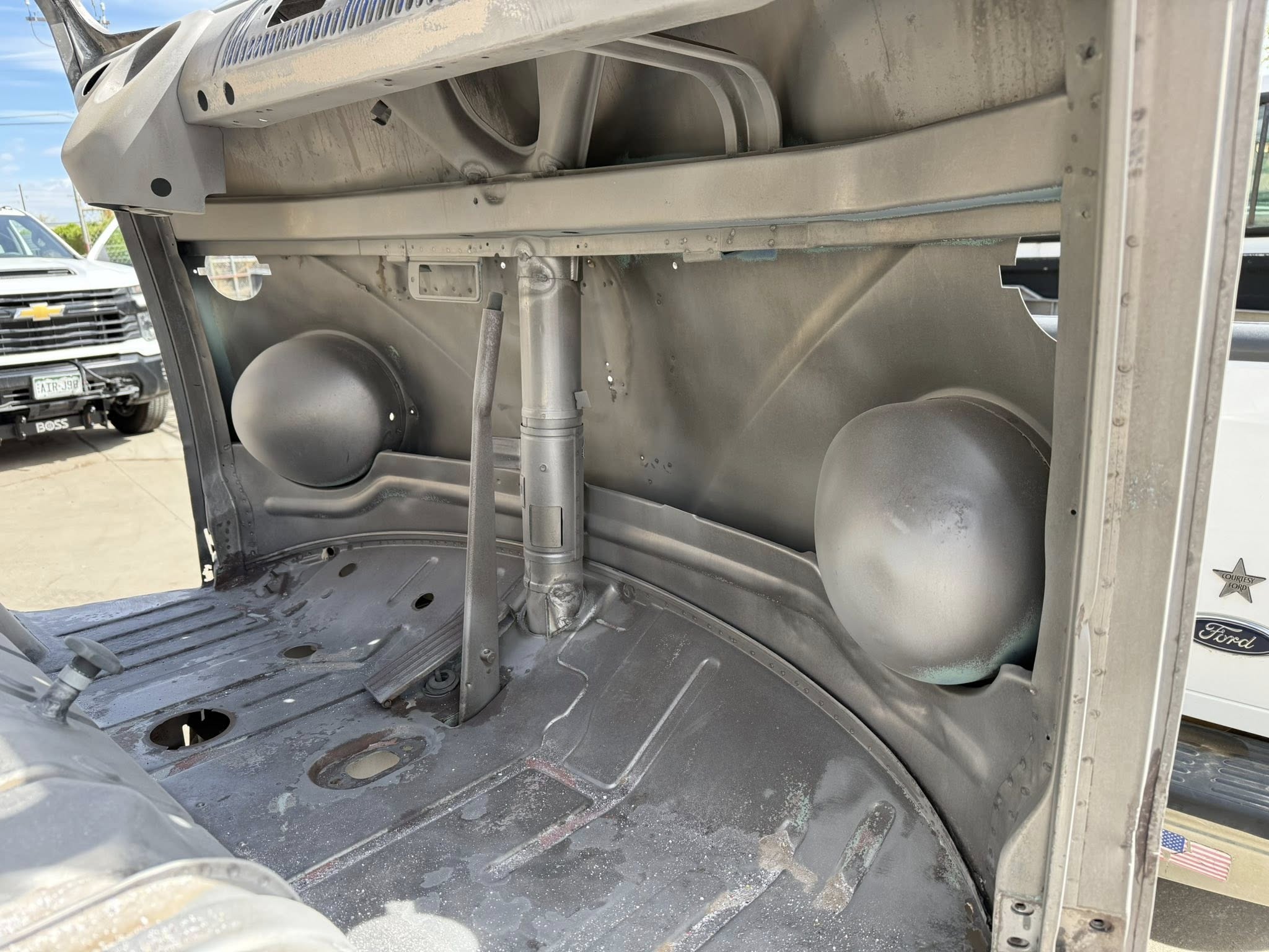

More Progress: Got the transporter back from A1 Metal Stripping in Golden CO. Back in the shop.
Lots more to do. Also finished the trans axel. Waiting on Brake parts. And the Freeway Flyer Transmission and the rebuilt BIG Nut RGB's. The pile of work left to do is mind boggling!
