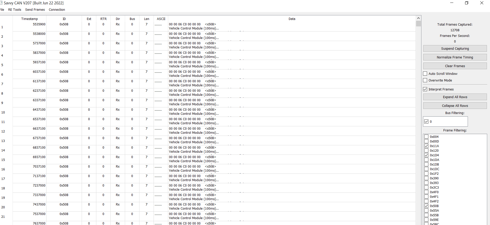

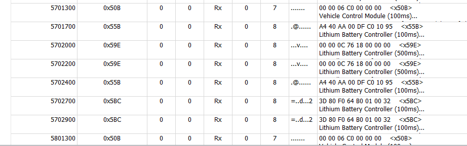

You made some breaking changes.
I can see 0x50B happnening and not the 10ms messages, so you made mistakes.
Same here I see the BMS messages not insync with the 0x50B which is not possible with the code.
To see if CAN has stopped there is now a spotvalue "CanAct"
