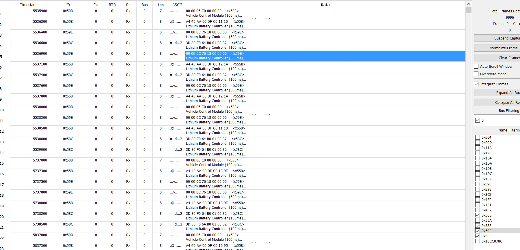

Spent the time today to pull and pick the code apart resulting a new Leaf specific CAN frame generator .cpp. Also now includes waking up on pdm 0x679 and trying to have everything shut down when going into OFF mode.
https://github.com/Tom-evnut/Stm32-vcu/ ... te-01-2025
I made only one tweak in the STM32_VCU rest should be easy to just copy across.
The code has been bench tested, there are arbitrary time outs, so when the PDM sends 0x679 it has 100 x 100ms to get the Zombie into Charge mode.
When the Zombie goes into off mode it also currently waits 100 x 100ms before telling the CAN devices to sleep.
Please test this on your build and provide me some logs and feedback.

I cloned your latest FW and made my changes to cope with my setup, then went ahead and tested.
Driving works, then I went to off-mode and wait several minutes to make sure all units are sleeping.
Then plugged in the charging. Pre-charge works and system goes to charge mode, but EVSE relay does not click and there is no charging power.
Then I made another test with a fresh start after hardware reset, but still no charge power. Here is a datalog of the failed charging attemp.
First I apply permanent 12V, then in a few seconds, I plug in the charger, wait for the EVSE to apply power (never does), then disconnect the charger and wait for a while in off-mode until switching off the datalogging.
20250111_TomsTestFW_charging_attempt.zip

You made some breaking changes.
I can see 0x50B happnening and not the 10ms messages, so you made mistakes.
Same here I see the BMS messages not insync with the 0x50B which is not possible with the code.
To see if CAN has stopped there is now a spotvalue "CanAct"

Can you look at the CAN log and CanAct param to see it go to sleep. I have not seen a long with a start up.
You can change the lines
SleepCount = 100;//10s shut down counter reset
to 10 instead of 100 should speed this up.
https://github.com/Tom-evnut/Stm32-vcu/ ... eafMng.cpp
Are you sure you have fully replaced the Leafinv.cpp and nissanpdm.cpp? The CAN messages still look messed up.

I was too curious to know, so I had one more go at it now, that I am actually compiling the correct version...
And sure enough - Driving and Charging both work! :D
Here is a datalog of the operation.

No, it is not in the previous log of your V2.22A, but I went and took a datalog for you.
This is the datalog of the Main branch V2.20A FW with my changes to the Stm32.ccp to execute the Inverter 10ms task outside RUN mode if FORWARD=0:
- Starting with Pwrspnt=500 (battery current around 1A)
- Gradually increasing the Pwrspnt value 1000, 1500, 2000 (Battery current rises on each increase as expected, current is the 0x3C3 from CAB300)
- Finally, the current is 6.5A at Pwrspnt=2500
20250114_MainBranchFWv220A_KeljuMod_charging.zip
(807.83 KiB) Downloaded 480 times

Kelju wrote: Tue Jan 14, 2025 6:23 pm This is the datalog of the Main branch V2.20A FW with my changes
Okay so there is an issue with the UDC and IDC spot value being properly translated for the BMS message 0x1DB. Do they show up as they should on your spot values with my firmware version, or did you do changes to get them from some other source?
I will bench test this tomorrow as I believe this is one of the messages where I cleaned up some of the very old and not "100%" understandable way of reading spotvalues.

tom91 wrote: Tue Jan 14, 2025 7:50 pm I will bench test this tomorrow as I believe this is one of the messages where I cleaned up some of the very old and not "100%" understandable way of reading spotvalues.
Bench test confirms errors in my population of voltage and current into the BMS spoof message, will fix now.
EDIT
Update for fixing the mapping issue, will review logs to see if anything else is not behaving. But if you get a chance it be good to test with this change.
https://github.com/Tom-evnut/Stm32-vcu/ ... c0ad8cf83e

Finally had some time to test this and I am happy to let you know, that the charging power follows the request as expected.
Thank you once again Tom! :)
