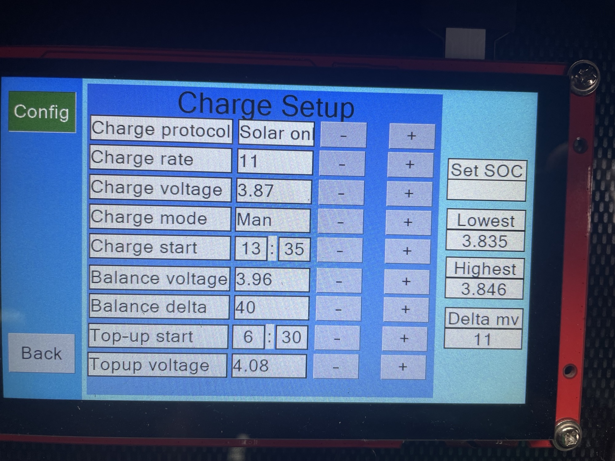

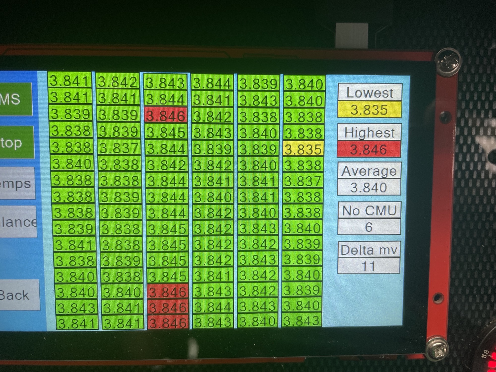

My delta is pretty large at the moment. 121mV. Most cells are around 3.87, I've got 1 full module of around 3.93V and 1 module in my second pack where the first 7 cells around 3.81 and the rest at 3.87. The delta at around 50% SoC drops to around 40mV.

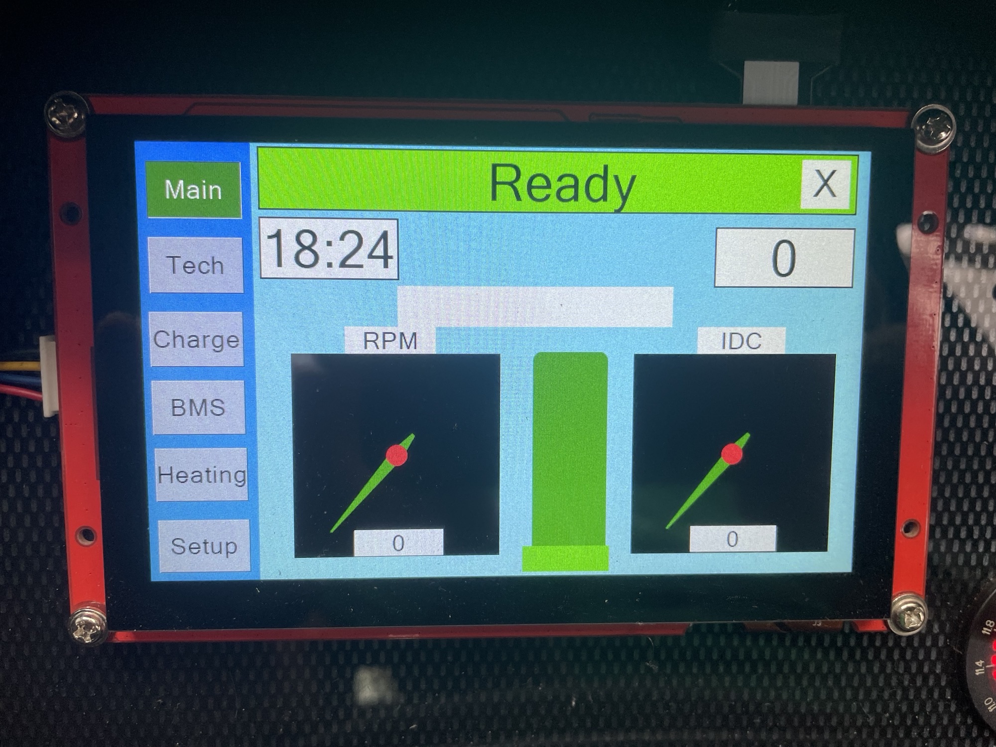

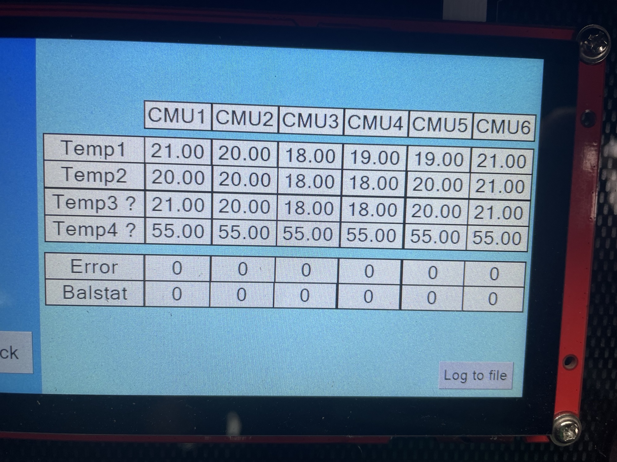

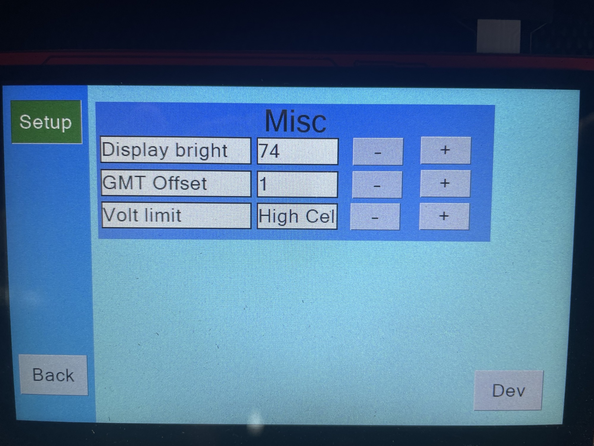

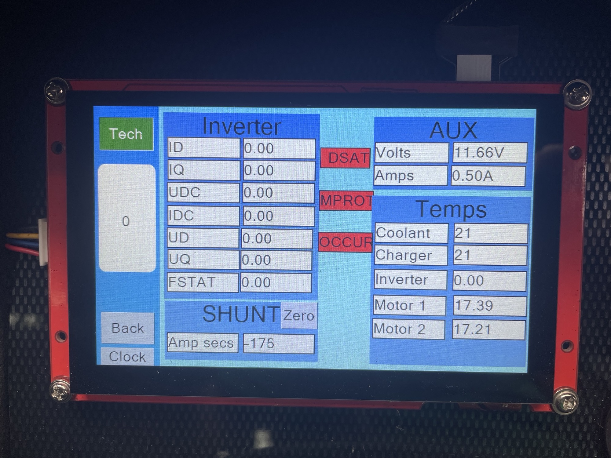

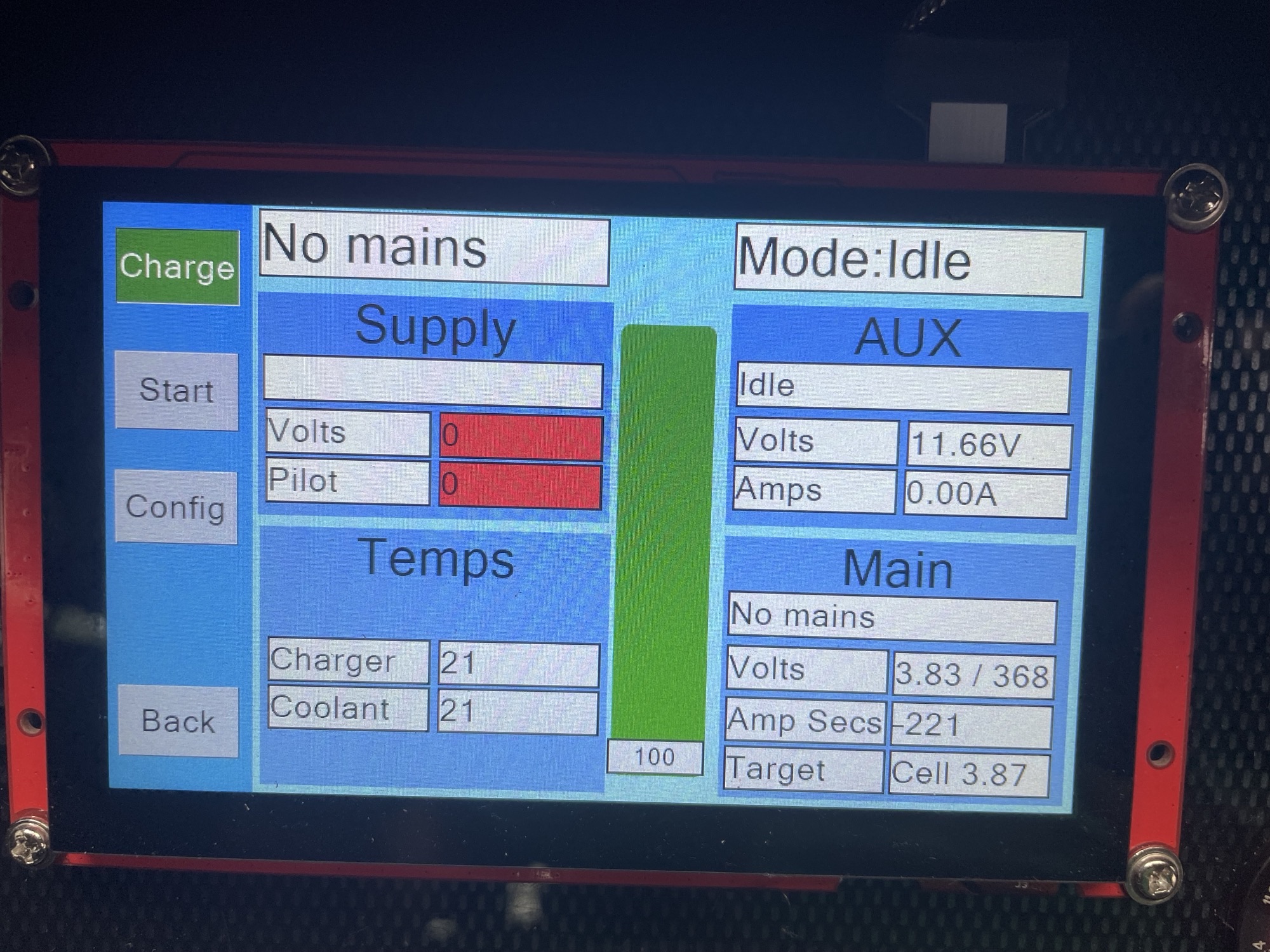

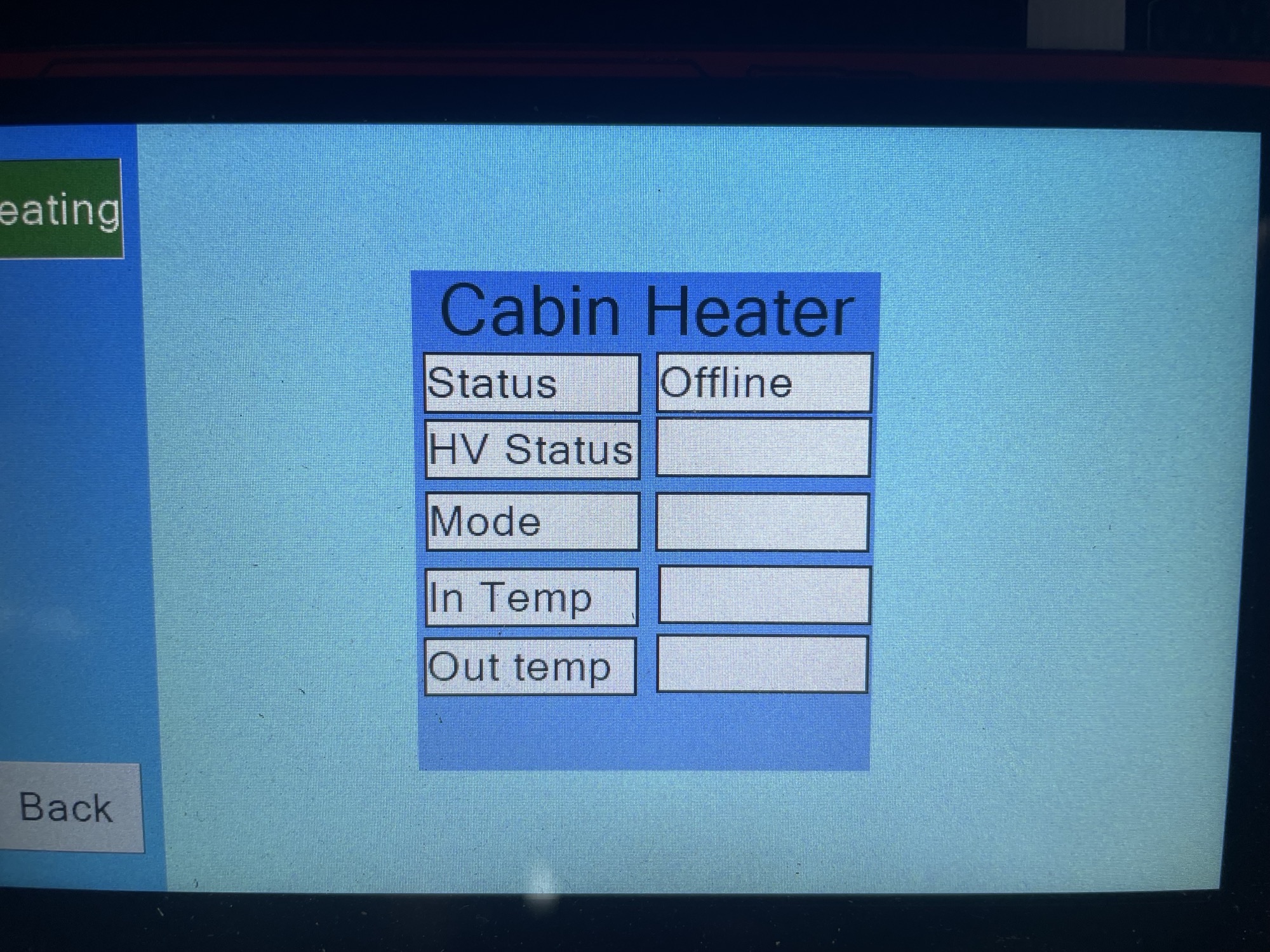

Just spending a little time refining the dash and charging etc. A few screen shots from my Arduino+nextion.

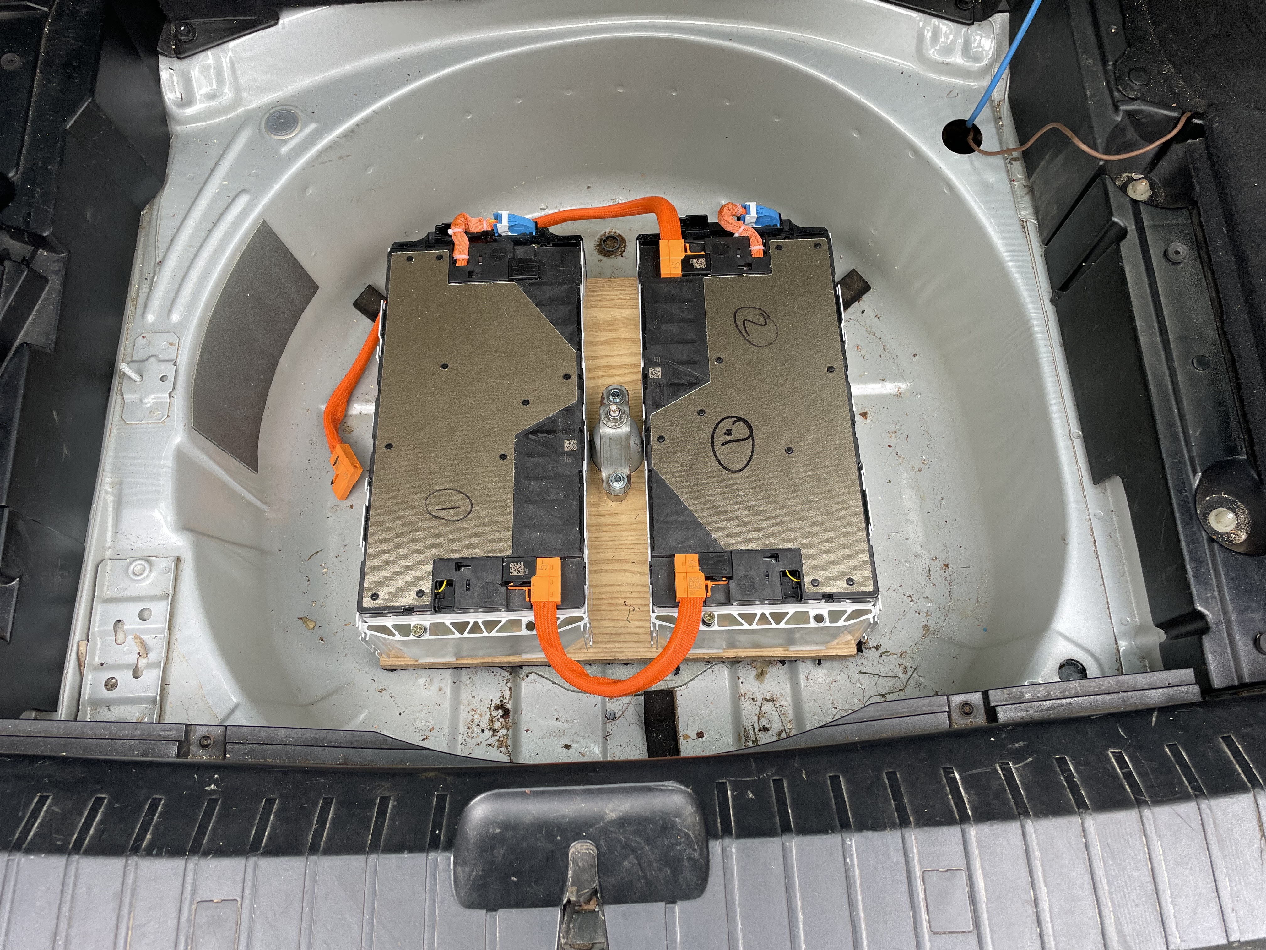

I'm very interested in the battery box you've built. Do you have any more photos/designs you could share? Right now I've got the battery taking up the whole back of the car and hoping to swap for a BMW pack that will fit in the engine bay.

i'll grab some pictures of the rear install this weekend as i have some more work to do n on that, but suffice to say, in the rear i have 2 x BMW 60v packs in the wheel well and 4 more above, which raise the boot floor 35mm.
I'll take some pictures of the front shortly as i have to have it all out to change the wiring and contactor setup for the 2nd pack install. But to say i have a 'ply' would platform just above the front ARB using the ARB mounts. On thet platform is 2 x 60v packs and the phev charger. Above that on a ply platform secured to the ledge formed by the monocoque are 4 x 60v packs, and over that on stilts is a light platform with the contactors and (at the moment) my arduino. Weather proofing at the moment is provide by a still but flexible plastic liner going round the front and 2 sides of the pack and ensures any water drains outside the pack area. The E46 drip tray the pollen filter sits in has the drain apertures extended to drain water below the motor.
when i say 'ply' i mean a type of laminated ply that is used in caravan construction. It is very strong, light and moisture resistant, and best of all doesn't conduct electricity. I get that it might be frowned upon, as i have seen some lovely metal work battery boxes but i think it is adequate and all batteries are within the crash structure, not underneath or outside any strong points.

The rear install just awaiting hv cable to run to front.

Re: [DRIVING] BMW Touring + prius + phev
Yep outlander heater and small pump with small expansion bottle.
Have programmed in a preheat mode so i can warm the car (which saves the battery when it's plugged in), but that requires i cut into the heater fan wires so i can run that in charge mode regardless of setting in the cabin, so that'll be next weekends job most likely. It's easy access from the bonnet on an e46.
