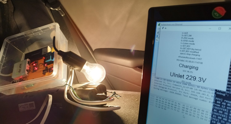

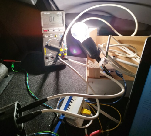

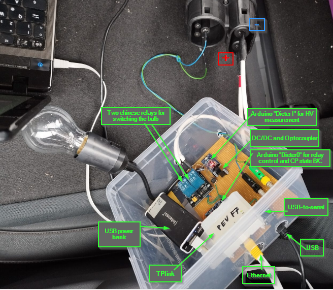

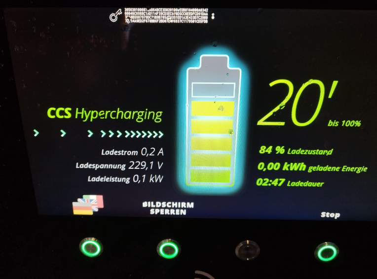

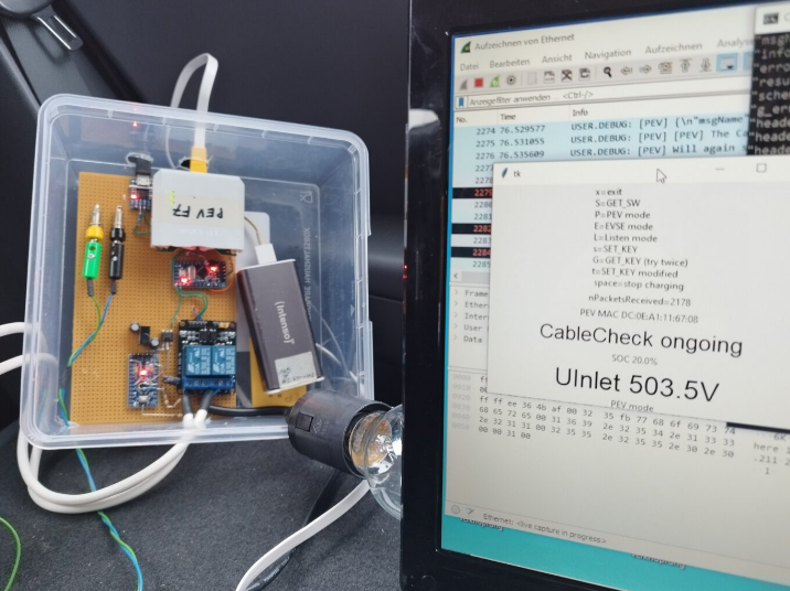

Today was the first time, when I was able to get some power from an Compleo 50kW triple charger. Used a 230V light bulb as load, the TPlink as modem, an arduino for switching the CP state, and the laptop as controller. The auto-ranging multimeter was not able to deal with the 400V DC, it shows "overload". But the bulb survived the voltage. The plan was, to NOT connect the bulb during the cable check, but by mistake it was turned-on already. Later, the PreCharge tries to rise the voltage, but this aborts at around 90V.
I would say: Milestone "Concept proof" is reached :-) Time to celebrate and concentrate on the xmas holidays :-)
PS: Version 0.4 released, see https://github.com/uhi22/pyPLC/releases/tag/v0.4

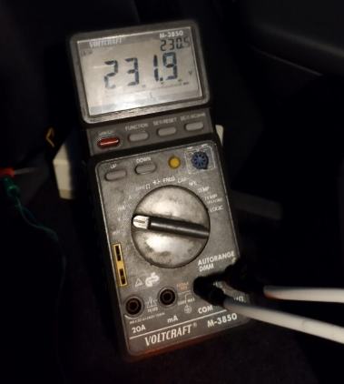

Post by uhi22 »

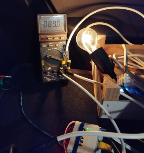

PS: Without the light bulb, the PreCharge reaches the intended 230V:

uhi22 wrote: Tue Dec 13, 2022 9:11 pm Today was the first time, when I was able to get some power from an Compleo 50kW triple charger. Used a 230V light bulb as load, the TPlink as modem, an arduino for switching the CP state, and the laptop as controller. The auto-ranging multimeter was not able to deal with the 400V DC, it shows "overload". But the bulb survived the voltage. The plan was, to NOT connect the bulb during the cable check, but by mistake it was turned-on already. Later, the PreCharge tries to rise the voltage, but this aborts at around 90V.
Charger release max HV during CableCheck, so your light bulk will be light up. Precharge will normally lower the voltage according to EV request.
As for the relay, as long as you control power draw from the charger (VxI) to be within rated spec of the relay and never open contact while there still current flow this should be fine. If somehow you fail this, depending on the current it will destroy contact.
I would suggest you run the complete session till the SessionStopReq, use stop session button on EVSE (not the emergency button). This should represent normal shutdown. I will help analyze the capture file.

Forgot to mention, I see in your pcap file, the last message is PreChargeRes which contain EVSEStatusCode = EVSE_EmergencyShutdown. Not sure why your setup trigger this emergency shutdown.
uhi22
Posts: 1143
Location: Ingolstadt/Germany
Has thanked: 231 times
Been thanked: 638 times
Post by uhi22 »
Thanks for this deep review. Yes, this is one of the open questions. Maybe the charger was irritated by the connected bulb during cable check and precharge. Or maybe I had an issue with the power bank (sometimes it seems to shortly drop), and so the CP changed to B and back to C due to restart of the Arduino. Will first make my setup more reliable, before hunting potential ghosts from software side.

Added the voltage measurement for the inlet voltage, with an arduino pro mini, supplied by a 5V-to-5V-DC/DC converter, and sending this via a PC900V optocoupler to the serial-to-USB. Also added relay control with a second arduino.
We see here, that the CableCheck applies 500 volts. Also the PreCharge voltage is correctly shown.
The actual questionmark is, why the charger rejects the CurrentDemandRequest with FAILED_SequenceError and EVSE_Shutdown. At the moment I did not find an obvious reason. Data in https://github.com/uhi22/pyPLC#2022-12- ... tage-works and https://github.com/uhi22/pyPLC/blob/mas ... ecoded.txt and https://github.com/uhi22/pyPLC/blob/mas ... own.pcapng
