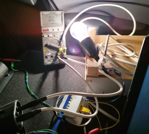

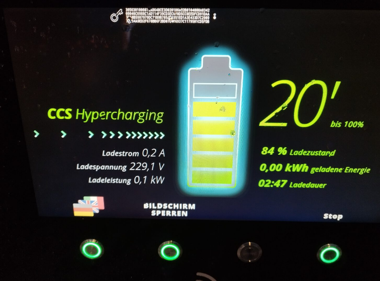

Today was the first time, when I was able to get some power from an Compleo 50kW triple charger. Used a 230V light bulb as load, the TPlink as modem, an arduino for switching the CP state, and the laptop as controller. The auto-ranging multimeter was not able to deal with the 400V DC, it shows "overload". But the bulb survived the voltage. The plan was, to NOT connect the bulb during the cable check, but by mistake it was turned-on already. Later, the PreCharge tries to rise the voltage, but this aborts at around 90V.
I would say: Milestone "Concept proof" is reached :-) Time to celebrate and concentrate on the xmas holidays :-)
PS: Version 0.4 released, see https://github.com/uhi22/pyPLC/releases/tag/v0.4

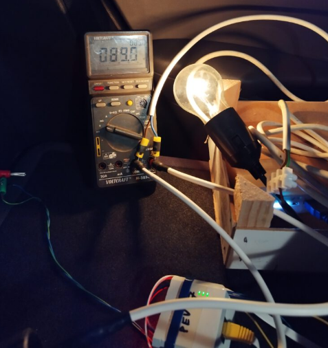

PS: Without the light bulb, the PreCharge reaches the intended 230V:

Just as a demo, I want to use a 230V/40W bulb, and disconnect it during the CableCheck and PreCharge phase (because the charger could be angry when seeing an ohmic load in this phase). After charger is finished with the PreCharge, I'd tell him a CurrentDemand with limits 230V and 2A, and then turn-on the relay for the bulb. And ramp the voltage down by terminating the charging session, before opening the relay. Means: The relay will see the inrush of bulb (no problem I think) and will not open while current is flowing. So, my cheap chinese blue relay (is rated only 10A/250VAC, not 16A as I originally guessed) has a chance to survive. But Murphy will be with me, and the relay will open while the bulb is on. And this will most likely lead to smoke. I will try. It will be outside, and the thing was cheap, so no really loss. A transparent housing would be nice to make a video :-) Thanks so far.

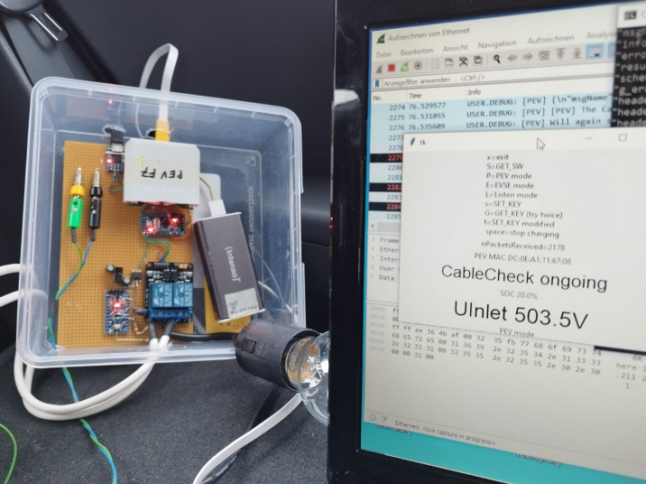

Added the voltage measurement for the inlet voltage, with an arduino pro mini, supplied by a 5V-to-5V-DC/DC converter, and sending this via a PC900V optocoupler to the serial-to-USB. Also added relay control with a second arduino.
We see here, that the CableCheck applies 500 volts. Also the PreCharge voltage is correctly shown.
The actual questionmark is, why the charger rejects the CurrentDemandRequest with FAILED_SequenceError and EVSE_Shutdown. At the moment I did not find an obvious reason. Data in https://github.com/uhi22/pyPLC#2022-12- ... tage-works and https://github.com/uhi22/pyPLC/blob/mas ... ecoded.txt and https://github.com/uhi22/pyPLC/blob/mas ... own.pcapng

After fixing the above mentioned issue, the bulb-demo-charging works on 3 of 4 charger models. Version 0.5 released.
