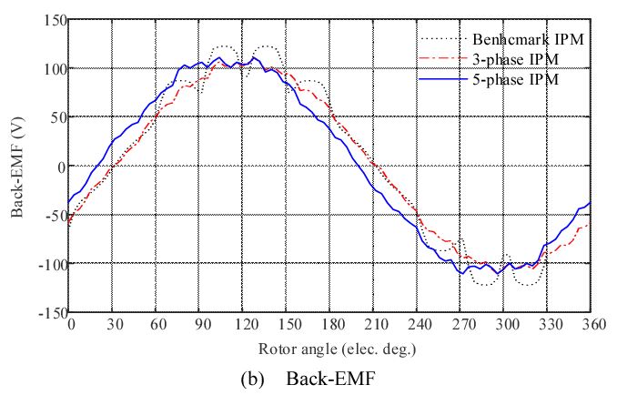

The Leaf's bEMF is the "Benchmark IPM":
It is a little difficult to see, but there is no obvious asymmetry - and I would be very surprised if there was any intentional asymmetry.

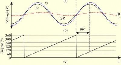

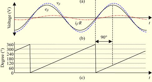

The resolver rotor/stator must be aligned with the emag rotor/stator. This can be done by having a resolver rotor fixed to the emag rotor, and the resolver stator has adjustment. Then on motor assembly, the resolver stator is adjusted to get the correct position vs the bEMF waveform, usually at the bEMF zero-crossing - such as this:
Alternatively, the resolver stator can have no adjustment, and instead an 'offset' is applied in software to account for any variation due to stack-up tolerance.
If you cannot adjust the resolver mechanically, then the offset must bet done in software. If it is not done, then Id & Iq calculations will be incorrect.
(Sorry if this is known/obvious)

I have run a gen2 Leaf motor in both directions using a Lebowski controller and in either direction the no load rpm was the same which leads me to the conclusion that there is no asymmetry in Kv or Kt. Certainly the photos I have of the Leaf rotor show no asymmetry in its construction but it is possible to introduce asymmetry into the magnets and I believe that adds expense to the magnet manufacturing process.johu wrote: ↑Sat Jul 13, 2019 9:20 am
Ok, contradiction
kiwifiat: do you KNOW that there is no asymmetry or do you not deem it possible? Have you run the motor at full speed&power in both directions with another controller?
arber: what exactly did you oberserve?
I can software-swap sin/cos, phase 1/2 and i1/i2. And I can rotate syncoffset by 180°. It seems none of the combinations change the fact that the motor spins better in one direction than in the other. Will keep trying.
EDIT: asymmetric rotors have been investigated: https://www.researchgate.net/publicatio ... b/download
It doesn't state a preferred spinning direction (I only skimmed the document) but looking at the rotor structure I could imagine there is one
