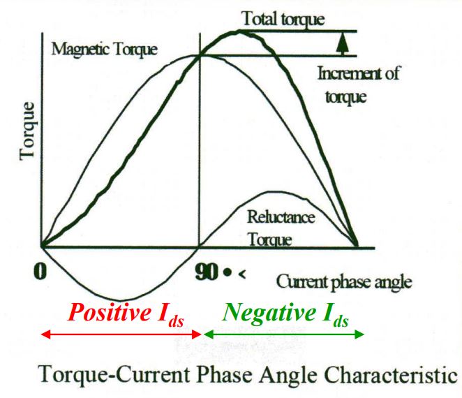

Re: Testing FOC for synchronous motor
With normal FOC control, Iq's sign is direction of torque production.
Consider the 4-quadrant operation:
Motor direction = forward; Positive Iq = motoring torque.
Motor direction = forward; Negative Iq = regeneration torque.
Motor direction = reverse; Negative Iq = motoring torque.
Motor direction = reverse; Positive Iq = regeneration torque.
An IPM will always want negative Id:

Ok, thats very interesting. So motoring in forward works out to regen in backward and vice versa. id always negative, understood.
Any idea why regen became more pronounced with rising speed? Some phase lag perhaps?
Thats a good sign. I have a limited experience of 3 devices that have been running for quite a while and never failed. As opposed to noname Chinese ones you get on ebay. They failed after 3 months because the main inductor lost its coating
If the regen increased, you should see the Iq change accordingly...
On regen, the leg voltages are phase delayed compared to motoring. So, if you have lagging leg voltages as RPMs rise, then that will reducing motoring effort (when motoring is desired), and increase regen effort (when regen is desired).
