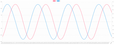

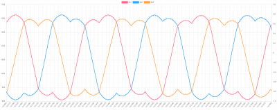

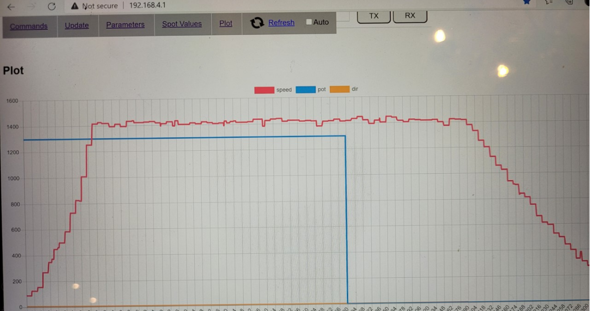

So today I whacked the formulas found on wikipedia into the firmware to see what happens. Well, what does happen is a little *blip* on the motor and then over current shutdown, just like expected really. So I guess I have a couple of misconceptions about using FOC, maybe somebody can take a look: https://github.com/jsphuebner/stm32-sine/tree/foc-test
I should add, before I did the full loop I ran the motor with V/Hz to see if iq and id looked sane. So when I went up the driveway iq became positive, id negative. When going down, both id and iq were negative. So nothing strange so far.
And I should add that I plotted the generated duty cycles and they sit nicely at 1024 (mid-value for 18kHz PWM) when idle and spread off in different directions with increase in throttle.

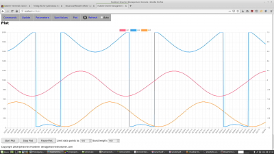

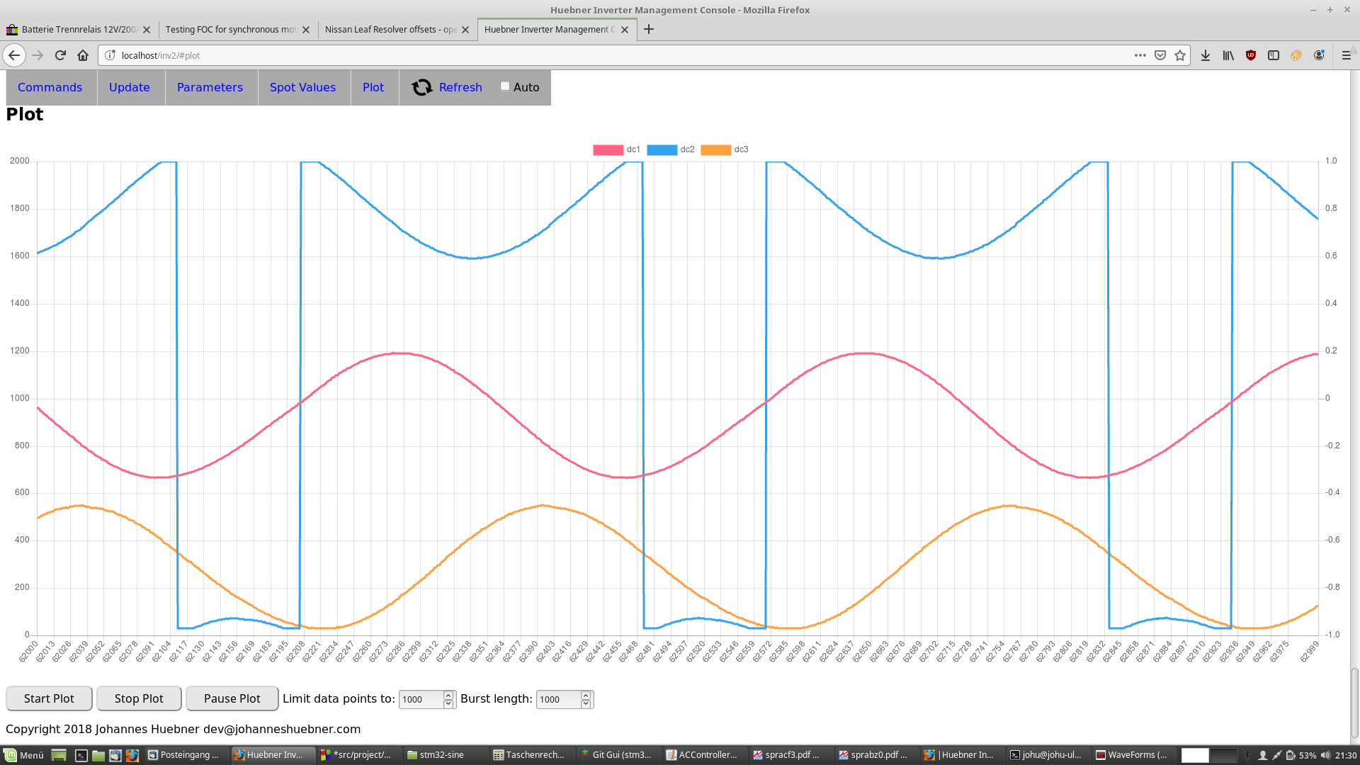

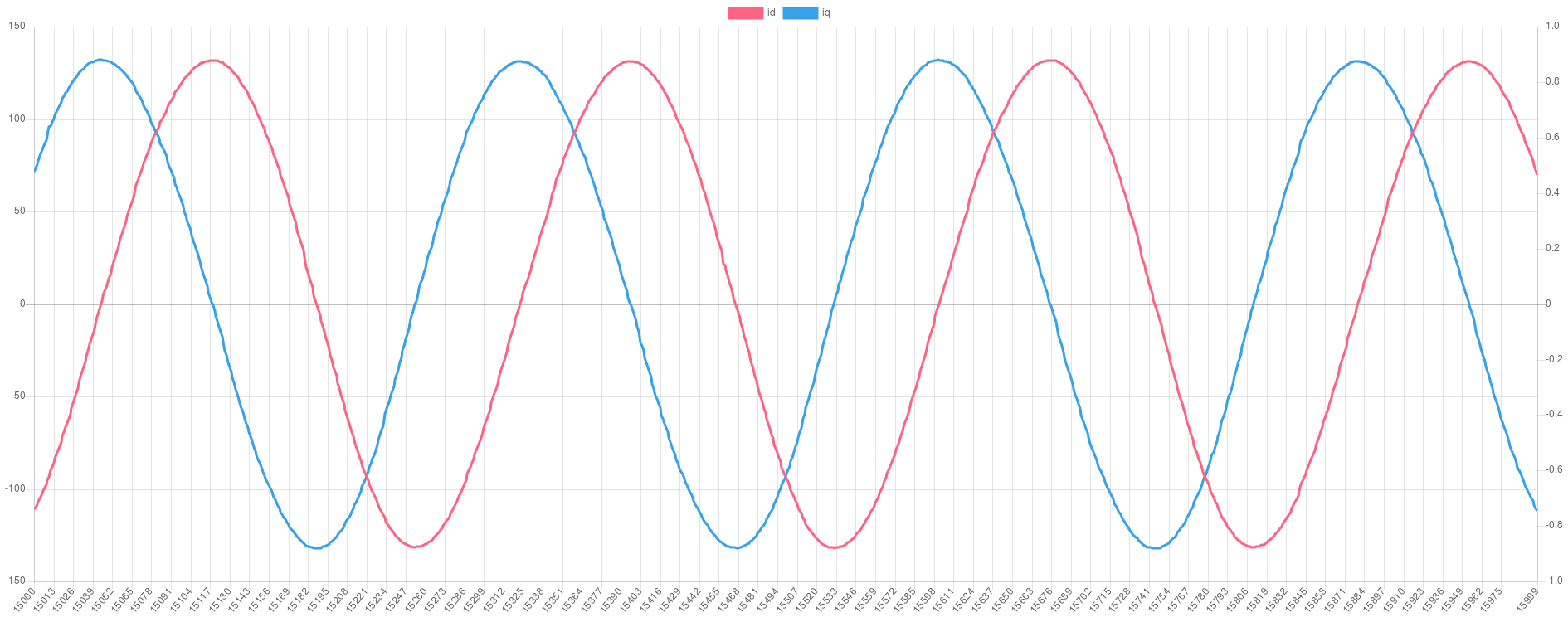

Yes there is a glitch...
Fixed frequency to 10Hz and feeding the current sensors 10Hz. Thats what it outputs.

In the latest commit all Clarke, Park, Inverse Park and Inverse Clarke operations look nice.
So you fed 10 Hz to the current sensors, did you give a 10 Hz angle as well or only some random angle? Our fixed-point data type here is only 5 bit fraction so it shouldn't overflow at these values easily.
Edit: In the foc.cpp line 35
could you please try int32_t instead of uint32_t here? I'm aware the duty cycles are always positive but after the Inverse Clarke you are probably ending up with negative values, which are then biased by +32768 in pwmgeneration.cpp. I think this is where the glitch happens.
Yes, the data type might be overflowing but I cannot tell off the top of my head why. Actually, it could be better if we scaled all the currents down to per-unit to avoid such things. In other words, we can simply divide everything to say 600 and let the current stay always between -1 and 1. That's how TI implements the FOC. But TI does it with 18 bit fraction fixed-point, so it would take some time to implement that with our 5 bit fraction fixed-point math.

Yes, that looks better. See changes on github.
Basically set iackp to 0.5 (was 10 yesterday) and simulated 90A rms current with the same frequency as fstat. The phase is probably pretty random due to clock skew. setpoint for id=0, iq=10A.
Will test in Touran now.
Of course now handling field weakening becomes less straight forward. Amplitude will just keep increasing until you end up with 6-step modulation.

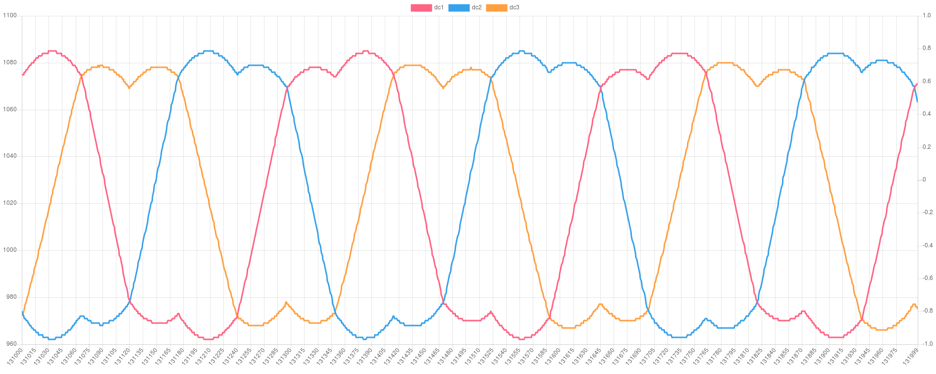

No improvent in Touran... But now for above test case I plotted id and iq. Pretty sinusoidal for a DC quantity...
Edit: when I swap phase currents it becomes DC.

It works!!
I had to swap pretty much every input
Swap il1 and il2, make ilXgain negative, swap resolver sin and cos. I think that was it
I think I will make a swap parameter with flags: swap forward/reverse, swap pwm phases, swap resolver phases, swap current sensors.. Anything else?
So good news first: the car drives and regens very smooth
Neutral news: setpoints for id and iq aren't always obeyed, maybe I have to use PI instead of P controller
Not so good news: Motor still draws too much current for doing relatively little
I'm not sure if I found the right syncofs. at around 20000 the motor stops producing torque despite supposedly sending 150A iq. Around 7000 seemed right. Not quite sure if syncadv is still needed to compensate for tracking delay? Maybe scoping resolver and phase voltage is not a bad idea after all.
If anyone with a Leaf motor would like to try, the firmware and parameters are attached.
