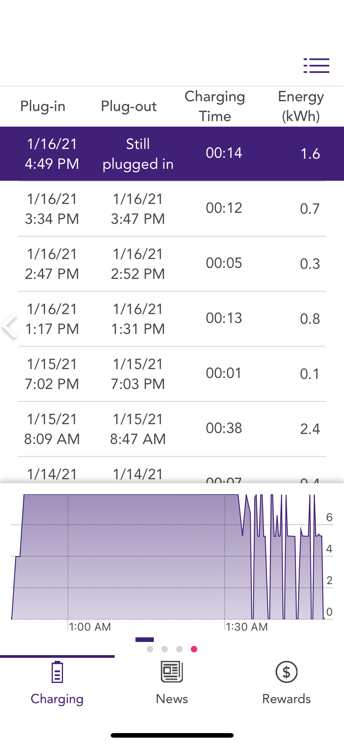

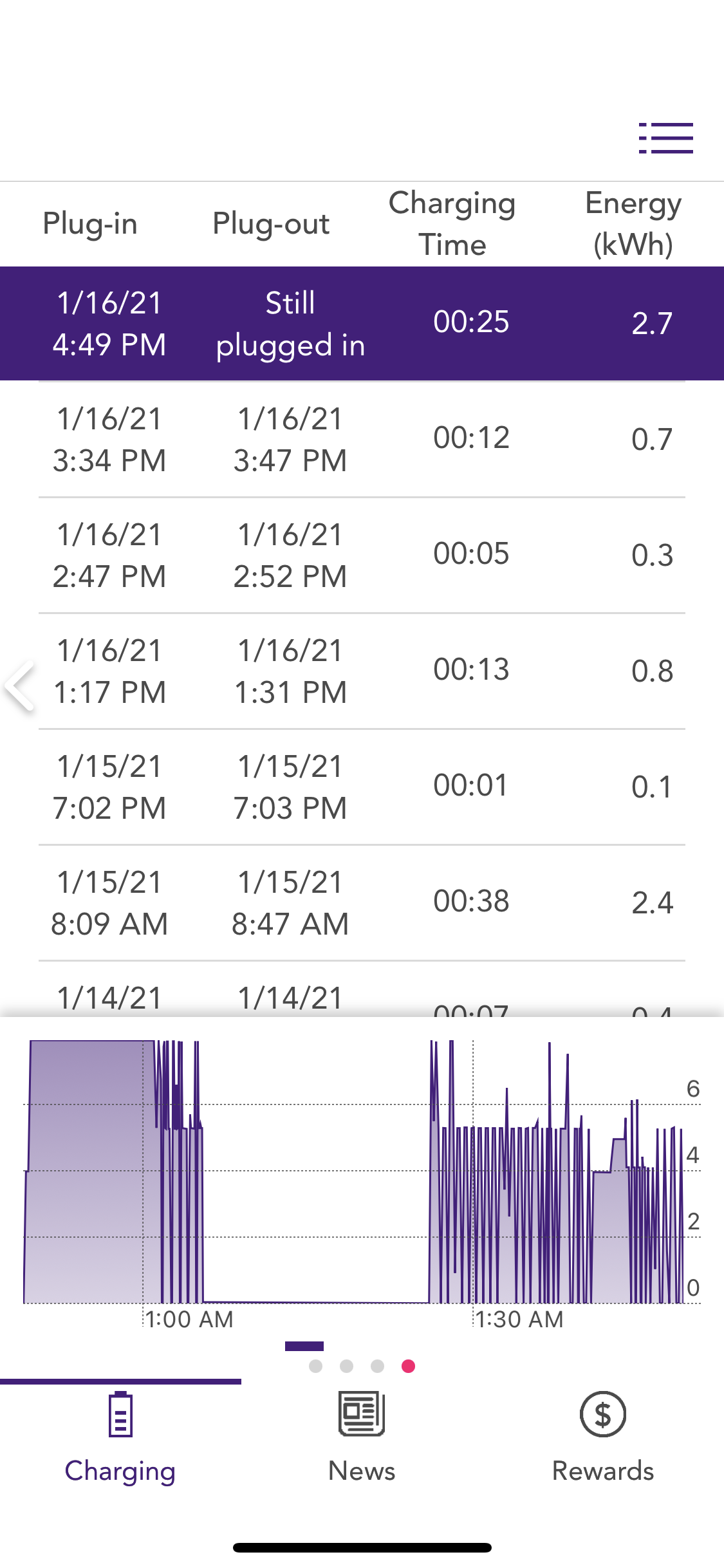

Spoke too soon, I’m getting similar behavior to the CAN dropout bug: In the middle-end of the session here you can see I lowered iaclim until I got a stable charge (16A
, then went to 20A stable, then 25 and the bug kicked in again:

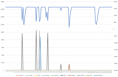

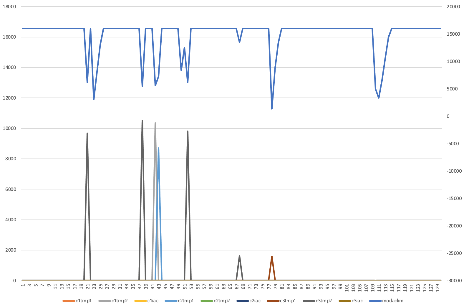

Plugged in the cold charger this morning and the issue started immediately. Attached is a log of the session sampled every 500ms. I can sample more frequently if that's useful.
Phase temps seem to go totally wild, into the thousands (are these supposed to be degrees?)

Re: Tesla Charger alternative firmware
They're degrees. So indeed modaclim seems to actually drop, maybe to 0. This is most likely caused by the charger dropping out of run mode. And that would happen if some error is detected with one of the chargers. Possible errors are loss of CAN comms from the charger for more than 2s or a fault flag being raised.

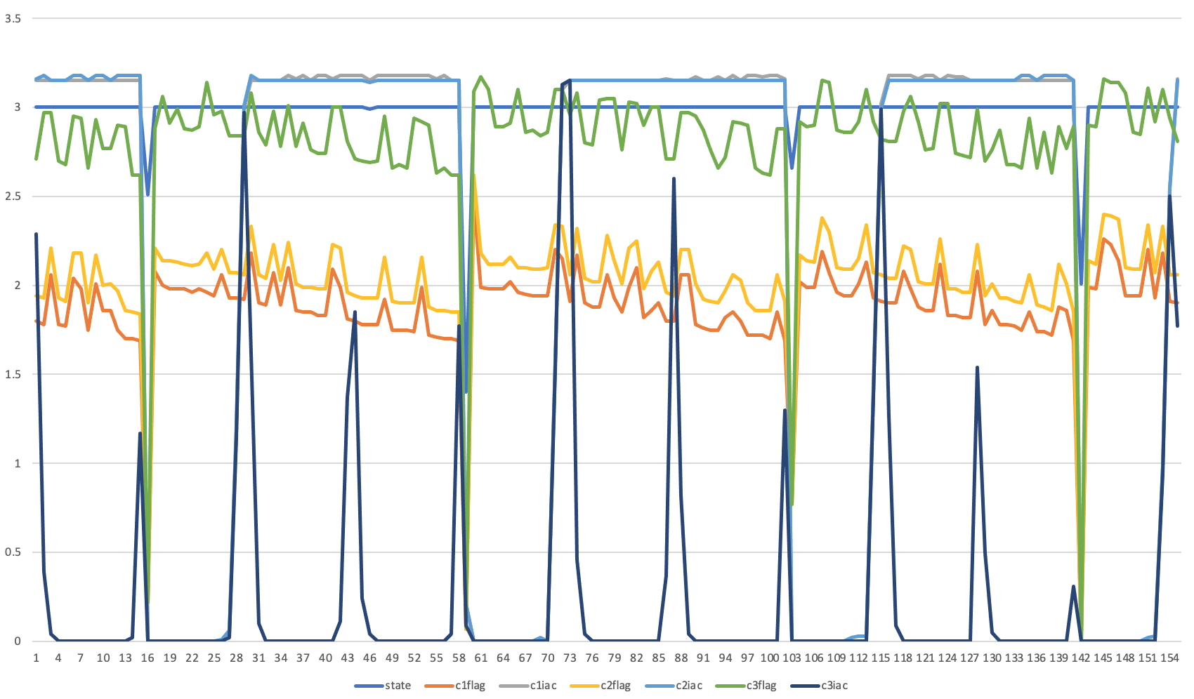

Ok, it definitely cycles off. Can you use the plot function from web interface, because averaging on flags=no good
I do suspect for some reason the charger modules assert an error flag which makes the software restart them.

I haven’t been able to capture the transition but here’s an odd behavior I’ve consistently seen.
My charge enable input is driven by a relay controlled by my BMS. Turns off at the desired charge voltage and turns back on when it dips below a set hysteresis level. Everything works as you’d expect, however, if I leave the j1772 cable plugged in, after one charge cycle, (I.e. was fully charged, dips below hysteresis, and re-enables charging) my idclim changes itself from 45 to 0. I’ve checked the values both before and after a successful charge cycle and the value still shows as 45. It seems to be something about the transition state back to charge without unplugging the EVSE that causes this change. I’ve witnessed this at least 3 times so far. The first, I thought I didn’t save a setting to flash but something else seems to be going on.

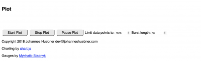

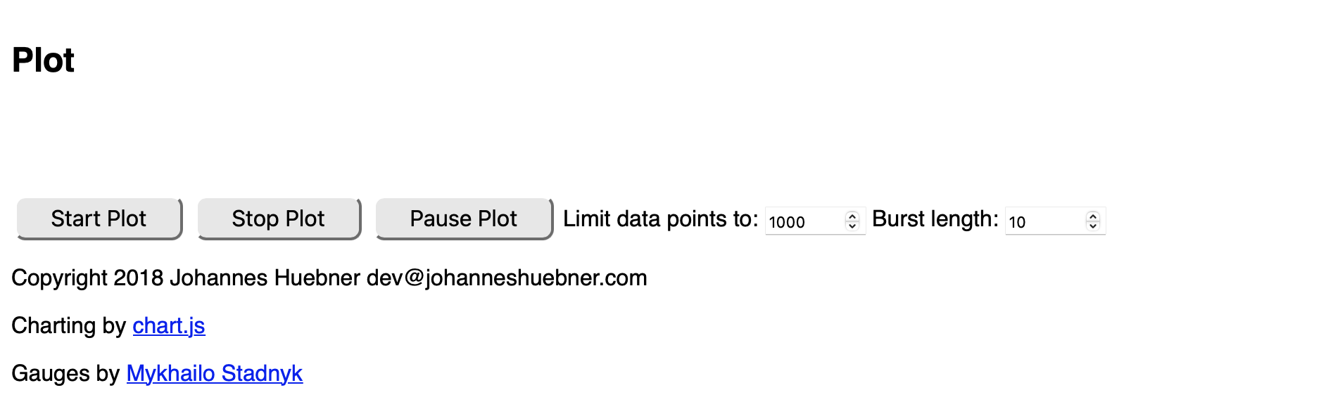

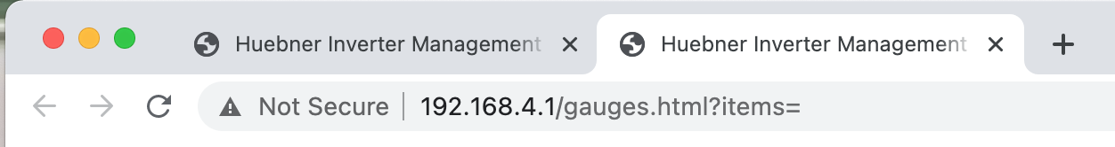

I just tried the plot function, and the buttons don't appear to do anything for me. The gauges don't work either, so I tried reloading SPIFFS via curl also without any luck. Any tips here? Using Safari browser if that makes a difference.
- Posts: 6740
- Has thanked: 380 times
- Been thanked: 1562 times
Can you check that 192.168.4.1/chart.min.js.gz is present? And try another browser?
- Posts: 179
- Location: California
- Been thanked: 4 times
Navigating to 192.168.4.1/chart.min.js.gz downloaded the file, so it seems that it is indeed present. I also gave Chrome a shot and no go on that either. For plotting, the buttons were non-responsive, and for gauges I got a blank white screen at the address below. It looks like it’s not passing the items through, from my layman’s view. I’m using the latest from your git repository.
- Posts: 6740
I use the same source files. It must be something with the javascript, the plot loads regardless of anything else. Even if you open index.html locally from your hard drive you should see the plot. Well, provided you unpack chart.min.js.gz and make the capital C lowercase. Strange...
Ok, try unpacking chart.min.js.gz , rename Chart.min.js to chart.min.js and repack to chart.min.js.gz . Then upload that to your ESP and check if you see the plot.
