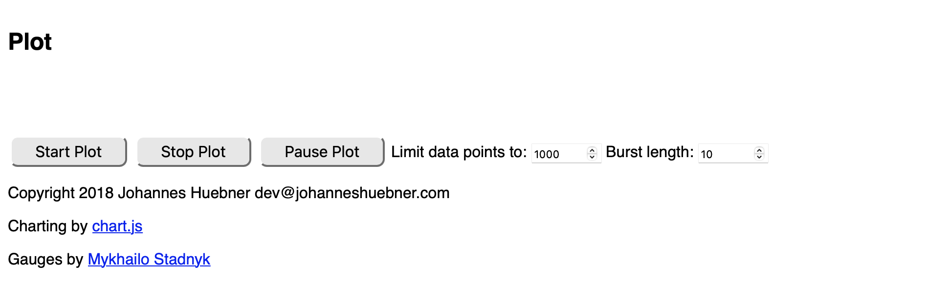

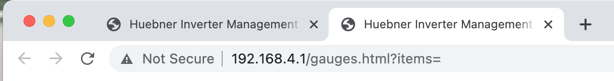

I just tried the plot function, and the buttons don't appear to do anything for me. The gauges don't work either, so I tried reloading SPIFFS via curl also without any luck. Any tips here? Using Safari browser if that makes a difference.
- Been thanked: 1913 times
Re: Tesla Charger alternative firmware
Can you check that 192.168.4.1/chart.min.js.gz is present? And try another browser?
Navigating to 192.168.4.1/chart.min.js.gz downloaded the file, so it seems that it is indeed present. I also gave Chrome a shot and no go on that either. For plotting, the buttons were non-responsive, and for gauges I got a blank white screen at the address below. It looks like it’s not passing the items through, from my layman’s view. I’m using the latest from your git repository.
I use the same source files. It must be something with the javascript, the plot loads regardless of anything else. Even if you open index.html locally from your hard drive you should see the plot. Well, provided you unpack chart.min.js.gz and make the capital C lowercase. Strange...
Ok, try unpacking chart.min.js.gz , rename Chart.min.js to chart.min.js and repack to chart.min.js.gz . Then upload that to your ESP and check if you see the plot.
