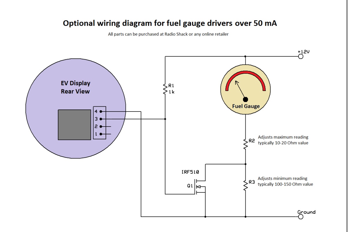

Re: Controlling an analog dash
I found an old schematic for my Mazda dial. It worked... I have to find one mosfet to tesxt this here...
See if you can get it to work.

arber333 wrote: Sun Jan 10, 2021 3:53 pm I found an old schematic for my Mazda dial. It worked... I have to find one mosfet to tesxt this here...
My gauge has +12V, GND and sender input, how should i interpret your diagram, should i assume the GND is a given, and connect it that way?
Is Q1 the mosfet?

Greenbeast wrote: Sun Jan 10, 2021 8:27 pm My gauge has +12V, GND and sender input, how should i interpret your diagram, should i assume the GND is a given, and connect it that way?
Is Q1 the mosfet?
GND is anywhere on the car i think. But you need 1K pullup for gate to invert signal and resistance toward GND so mosfet will pull signal down and release it in between pulses. What is your dial resistance on full and on empty?
