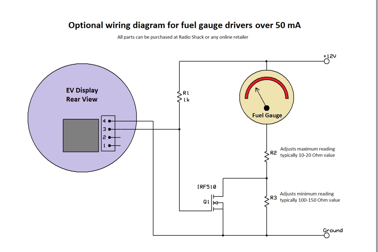

With the power on, but the gauge input disconnected, try putting a 1k pull-up resistor between the gauge input terminal and +12v.
Does the gauge then return to zero?

Re: Controlling an analog dash
I found an old schematic for my Mazda dial. It worked... I have to find one mosfet to tesxt this here...
See if you can get it to work.
Sorry, this does not appear to work.
My gauge has +12V, GND and sender input, how should i interpret your diagram, should i assume the GND is a given, and connect it that way?
Is Q1 the mosfet?
GND is anywhere on the car i think. But you need 1K pullup for gate to invert signal and resistance toward GND so mosfet will pull signal down and release it in between pulses. What is your dial resistance on full and on empty?Greenbeast wrote: ↑Sun Jan 10, 2021 8:27 pm My gauge has +12V, GND and sender input, how should i interpret your diagram, should i assume the GND is a given, and connect it that way?
Is Q1 the mosfet?
OK that doesn't mean much to me (I'm a relative novice).arber333 wrote: ↑Sun Jan 10, 2021 10:11 pmGND is anywhere on the car i think. But you need 1K pullup for gate to invert signal and resistance toward GND so mosfet will pull signal down and release it in between pulses. What is your dial resistance on full and on empty?Greenbeast wrote: ↑Sun Jan 10, 2021 8:27 pm My gauge has +12V, GND and sender input, how should i interpret your diagram, should i assume the GND is a given, and connect it that way?
Is Q1 the mosfet?
A
I will check the service manual tomorrow to see if it details that. It shows the sender as 1-5Ohm full 104-117Ohm half full but oddly doesn't show the empty value, unless there's been a misprint (check my post on page 1)
Hm... maybe there is damage to its internal circuit. Can you take the dash out and try to use the dial as ammeter? To confirm it still works?
What car is this? European cars usualy have value somewhere around 10R(empty) 190R(full); US 240(empty) 30(full).Greenbeast wrote: ↑Sun Jan 10, 2021 10:40 pm OK that doesn't mean much to me (I'm a relative novice).
That is entirely possible, i may have been a bit slap dash in my connecting and trying things out. Some of my warning lights don't work either now.
I have Mazda mx3 and it is in reverse of my EU Peugeot 406.
You should get a reaction if you connect 150R from signal towards GND.
Also verify if there is a fuse in that circuit. Maybe it is blown?
Ah, the mazda would be likely to match it i guess.
I can't see a fuse on the 'board', so unless it's inside the cluster i don't know.
Didn't have 150R, only a 91R, which did nothing. I need to get a few more components into stock
I tested the resistance across the terminals as suggested by the service manual and it reads higher than it should (70-80R, as opposed to 55R), the temp gauge reads correctly.
