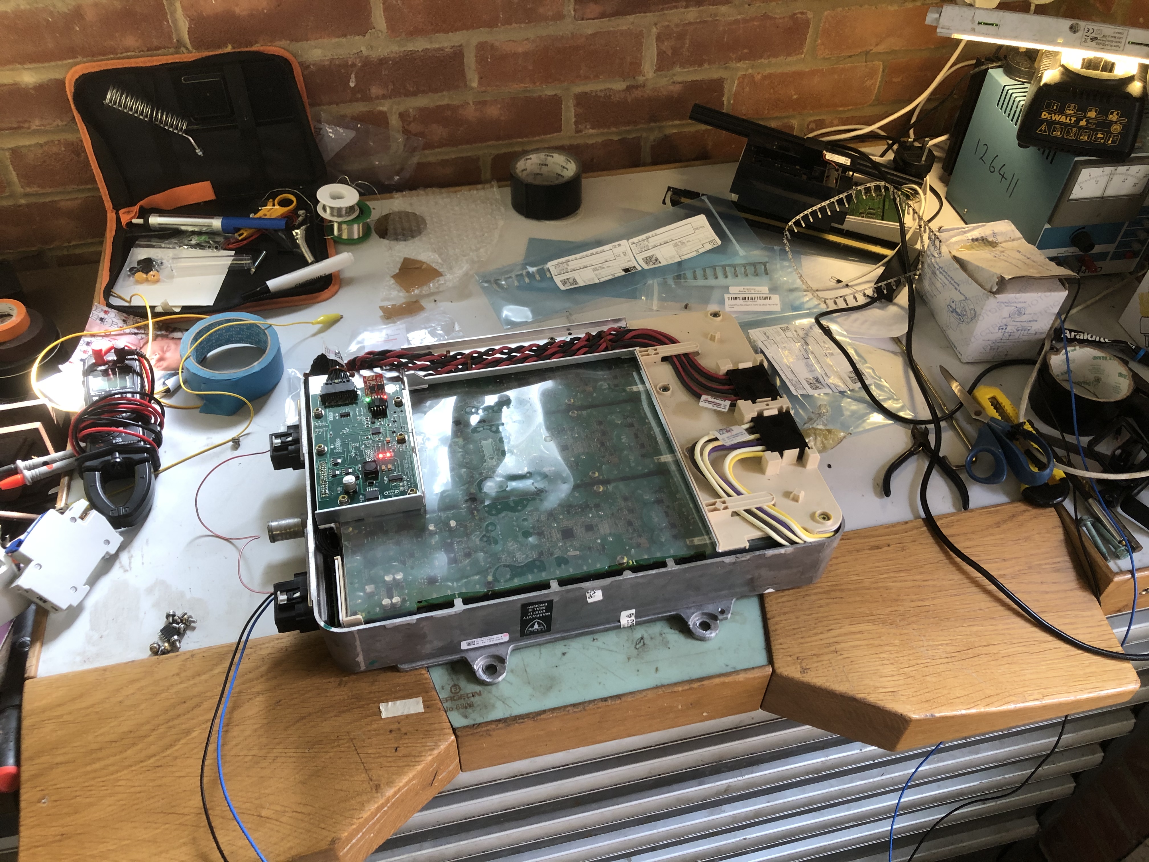

Hey all,
I realise time has moved on a bit but just thought I'd report back on my Gen 2 charger (USA Rev G slave) with a V4 logic board, that I'm using in a Honda Insight conversion.
It's working reasonably, I did make a few changes to get it how I wanted it - the beauty of open source. I'll describe these here and post the source / diagram if anyone is interested.

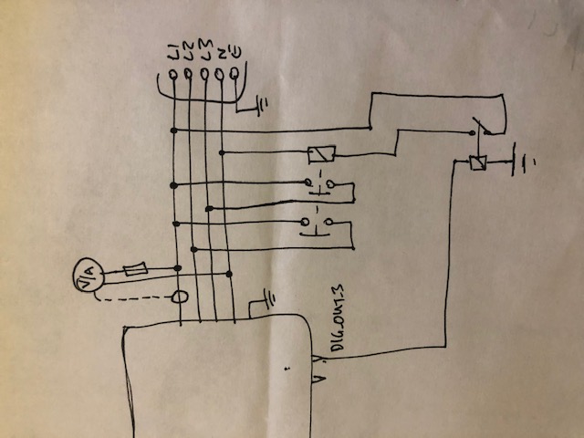

1) Automatic switching between 1-phase and 3-phase charging using an external contactor. It starts off in 3 phase, but if voltage is detected on phase 1 ONLY, the contactor is turned on which connects all the modules in parallel (via DIG_OUT_3). I use this to allow 6kW charging (or higher) at home or other 1 phase locations, but still access 10kW from public fast charge points which have 3 phase.
2) Charge termination. I wanted the charger to charge to the set voltage of 350 at constant current, then hold at that voltage as the current reduces (CV), then stop once the current falls below a threshold. How it's described in the battery datasheet.
I couldn't figure out how to do this with the standard software, so I added a parameter to the menu, you can set e.g. 3A taper current.
3) Manual mode. To allow ad hoc charging without an EVSE, I added a potentiometer with an "on-off" switch (like a radio volume control) and a cheap ebay volt/ammeter module. It uses ANA_IN and DIG_IN_2. Then if I want to charge from a random power supply at a custom rate (e.g. 5A at a campsite, 10A on a long extension cable, 20A from a commando socket) I just plug it in and dial in the amount I want, and back off if the breaker trips or the voltage looks too low. No need to bring a laptop or portable EVSE. Attended use only of course!
I do have one remaining issue, maybe someone can comment if they know what causes this:
When I'm using a real EVSE, the current occasionally seems to drop to zero and then immediately ramp back up to the set point. Haven't debugged it yet but I did see mention in another thread of noise affecting the pilot signal - could that be the culprit and how are people solving this?
Many thanks to Damien and co for the project!

Hey Joromy!

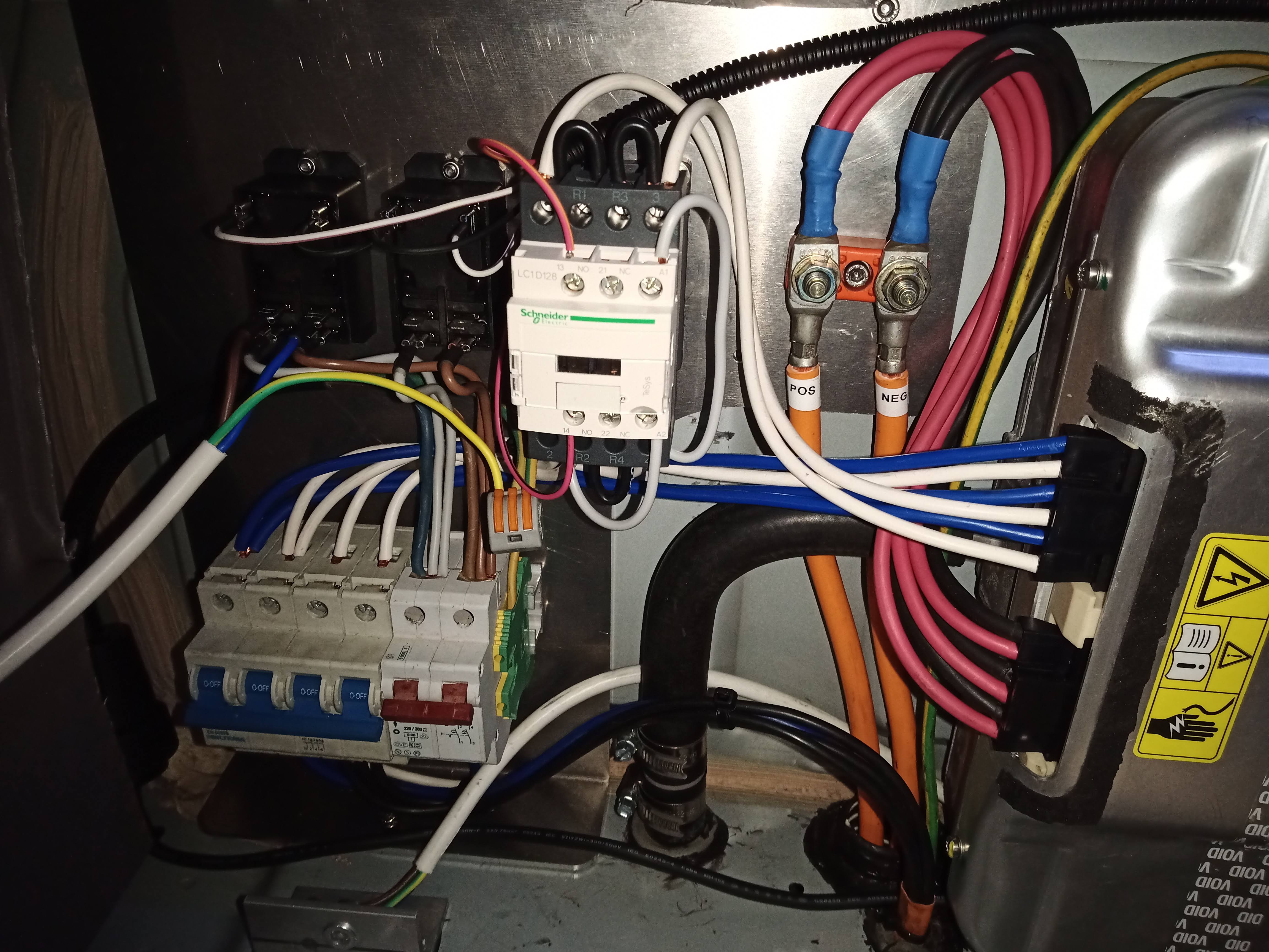

Ahh I wish I had seen your topic :) I used a 2PNO contactor because I had one lying around.
Your solution is definitely the better one because it's fail safe. Mine has the possibility to short live phases together if the controller malfunctions, which I don't think would be dangerous but would definitely be a nuisance.
I might re-do it with a 3PCO like you have...

joromy
Posts: 371
Post by joromy »
Puhh, good to know, that mine is better :)
It have worked great for long time now.

Post by et0 »
Nice job! Yeah I will relocate the charger to under the hood at some point, so I will redo it then, but it's working for now.
Just need to fix that pilot signal noise now, or whatever is causing that flakiness...

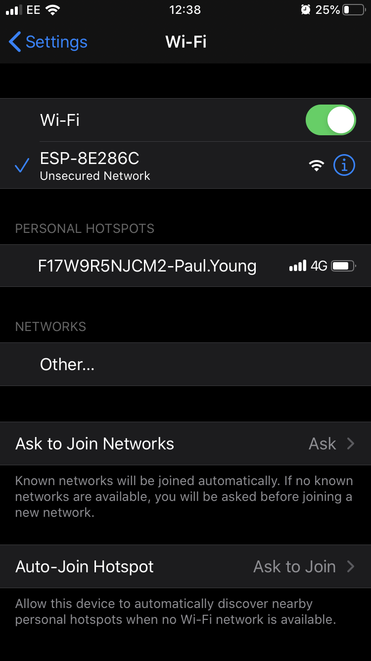

Post by Boxster EV »
I’m very tentatively starting the install on my Gen 2 with V5 logic board. Still waiting for a few parts so not pressing ahead too quickly. However, I powered the unit up on the bench and got the following.
Expected outcome for just applying 12v? I was thinking the menu would appear - but then cant remember whether the boards come preloaded. Grateful for someone’s pearls.
Posts: 4003
Been thanked: 1122 times
Yes the board is pre loaded. There is no menu just a display when on charge.

Thatguyoverthere
Posts: 34
Joined: Fri Jun 28, 2019 5:04 am
Location: California, USA
Post by Thatguyoverthere »

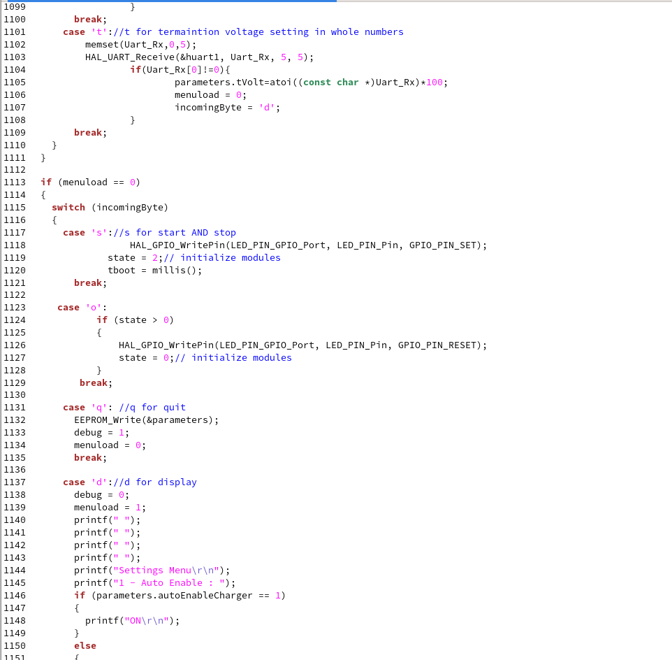

Looking over the manual and the source code, have you tried sending "s" through the serial? Since you're using it in no EVSE mode. Worth a shot

FJ3422
Posts: 122
Location: Netherlands
Has thanked: 13 times
Post by FJ3422 »

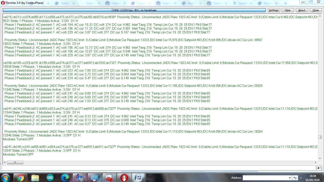

Boxster EV wrote: Sat Sep 05, 2020 4:21 pm BAD2CD29-D619-4340-9FF4-49BB0AFE451E.jpeg
It looks like your AC-voltage drops to 186V before it shuts off. Might be an undervoltage-switchoff ?
If I see it correctly, you connected the charger through a long (thin) mains cable. Try with something thicker (2,5mm²) for less voltage drop.
Separate from that; clean build !!
