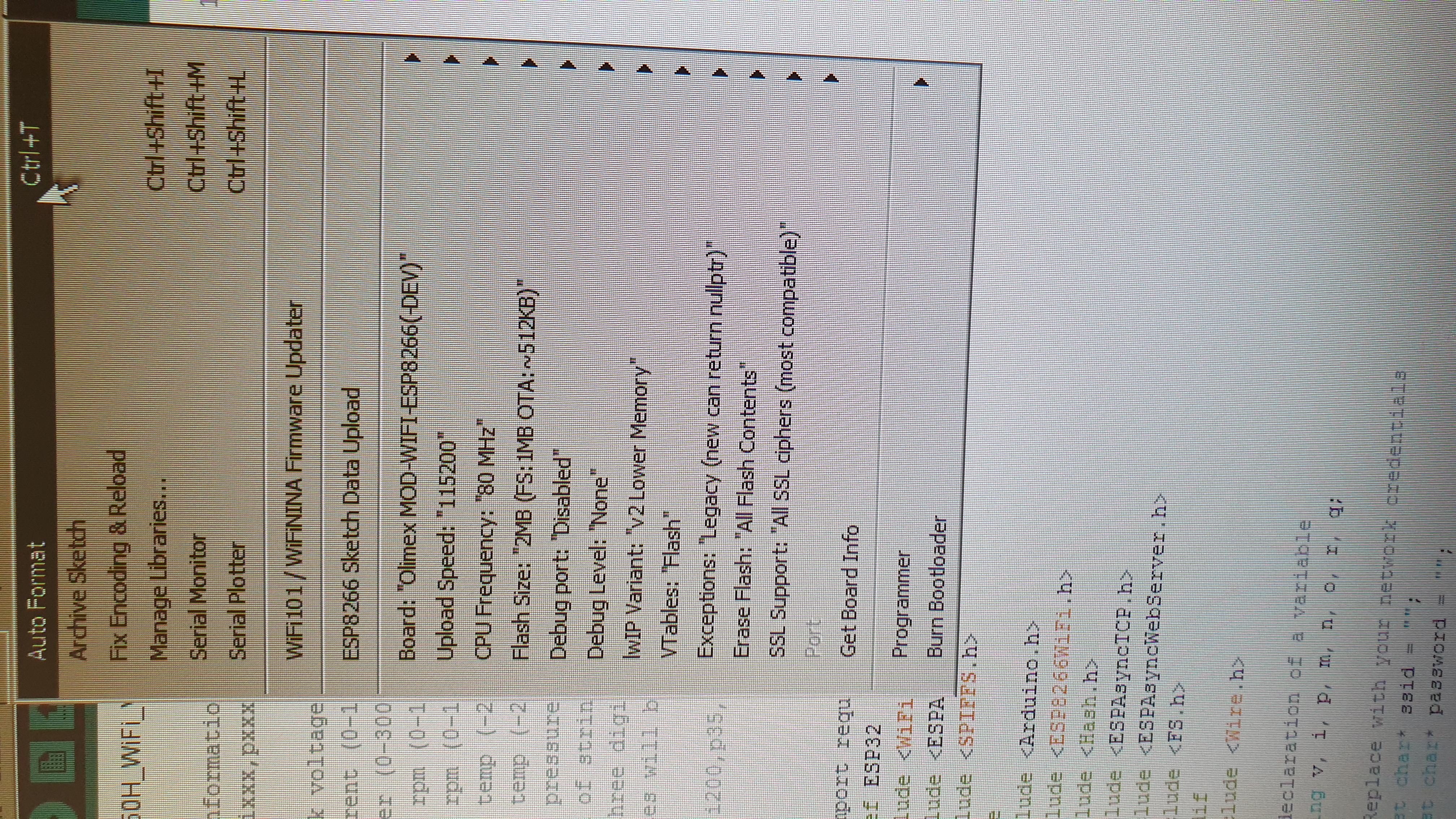

Next up go to tools and setup your board exactly as shown in the picture.
Close and reopen arduino then hit the tick box to compile. If you did everything right it will just compile.

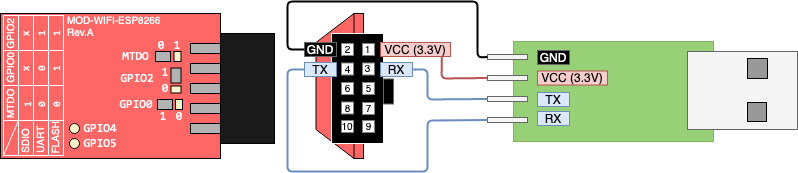

Part 2 : Lets all use the same programming method.
You will need a 3v3 level ftdi cable :
https://www.mouser.ie/ProductDetail/FTD ... FcejHp0Q==
Yes you can use others, no I have no idea if they will work. This is the one I use.
Wire it as per the the attached diagram.
Now, to program the module you need to desolder the GPIO0 jumper and move it to the "0" position.
Back to tools and select your com port.
Click the upload icon (right facing arrow).
When upload is done, unplug and replug the wifi module from the ftdi cable but do not unplug the usb end from the computer.
BAck to tools and click "esp8266 sketch data upload".
when done remove the module and resolder the GPIO0 jumper back to position "1".
Congratulations its now programmed.

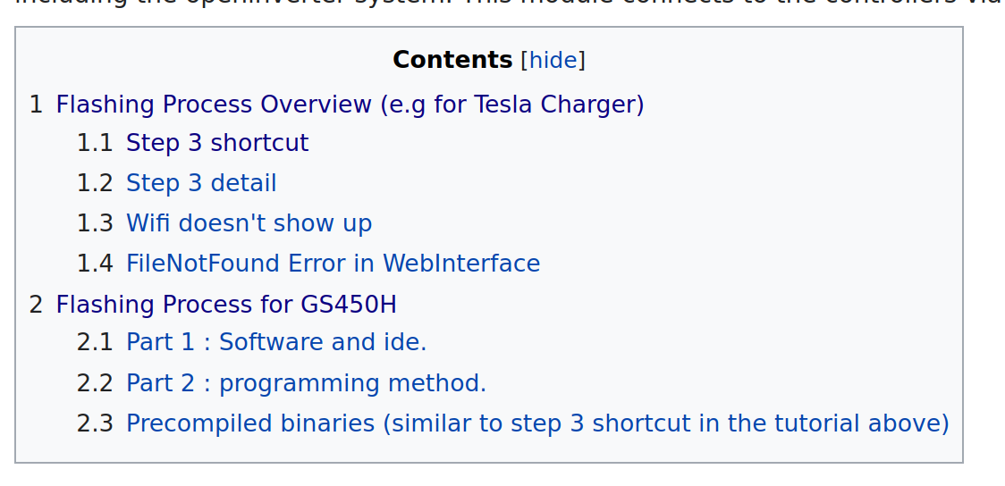

Hello,
people seemed to struggle with programming the Wifi modules. I copied instructions from a bunch of forum posts together and added them to the Olimex wifi page. That way they can be edited in the future.
https://openinverter.org/wiki/Olimex_MOD-WIFI-ESP8266
The page has two sections, at the top what worked for me with the Tesla boards, at the bottom I copied damiens post.
Please feel free to add stuff & correct mistakes.
I added the binaries that Basshunter made for the GS450H path, and added my binaries to the Tesla/Generic webinterface path.
