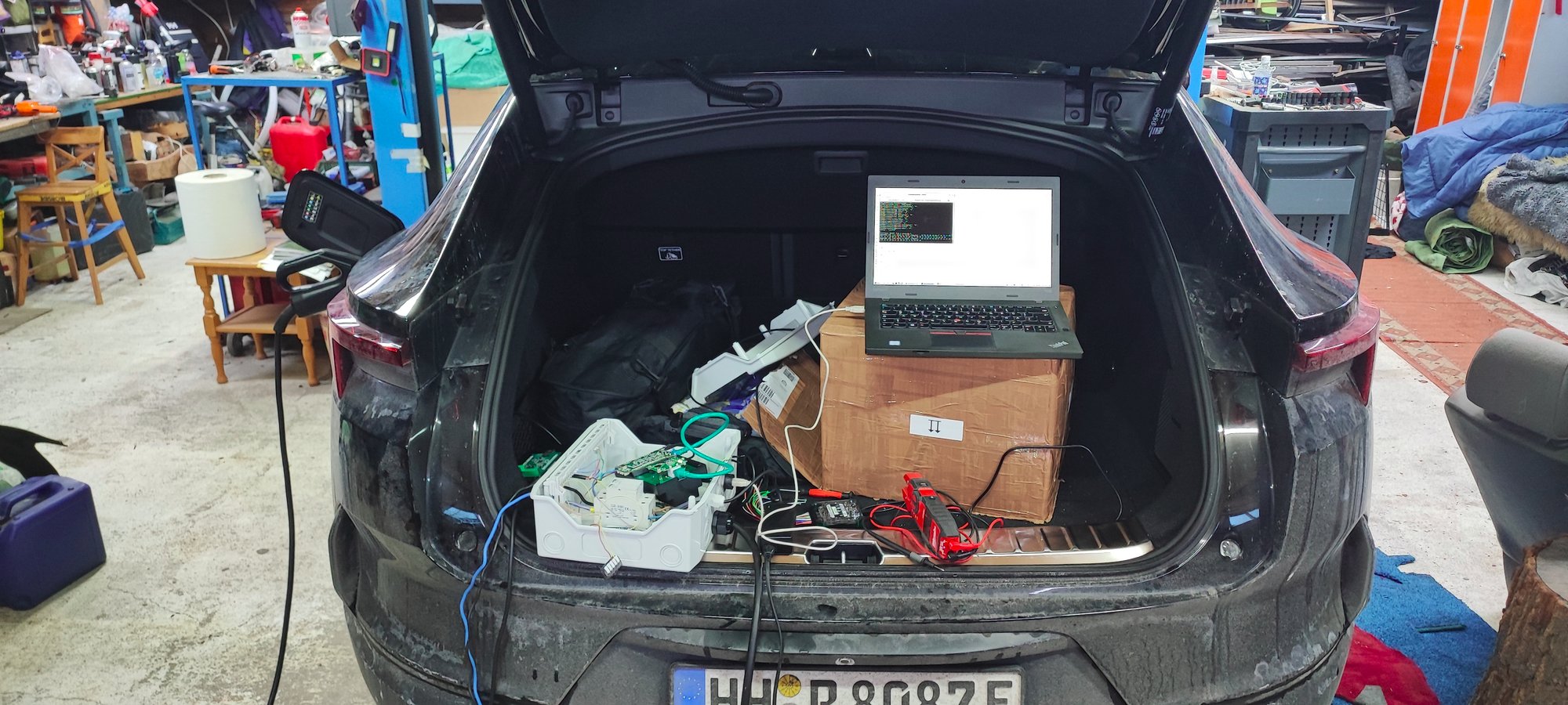

- Posts: 6974
- Has thanked: 457 times
- Been thanked: 1774 times
I did another test with the Audi Q4 (aka MEB) yesterday but again didn't get past cable check. It simply stops communicating
The PWM should now conform to the standard so I wonder does it also expect some voltage on the power pins during CableCheck?
starting in EVSE_MODE

- uhi22
- Posts: 1145
- Has thanked: 231 times
- Been thanked: 639 times
You could check this hypothesis by connecting the Q4 to a public charger with just CP, PP and PE, and measure the DC voltage on charger side to find out whether it ends in cablecheck or precharge or even reaches the currentdemand.
- Posts: 6974
Yeah but then how do I know? The chargers don't display the exact state they're in.
I hope next time Mr. Q4 has more time, then I can also try applying some voltage during CableCheck
