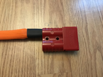

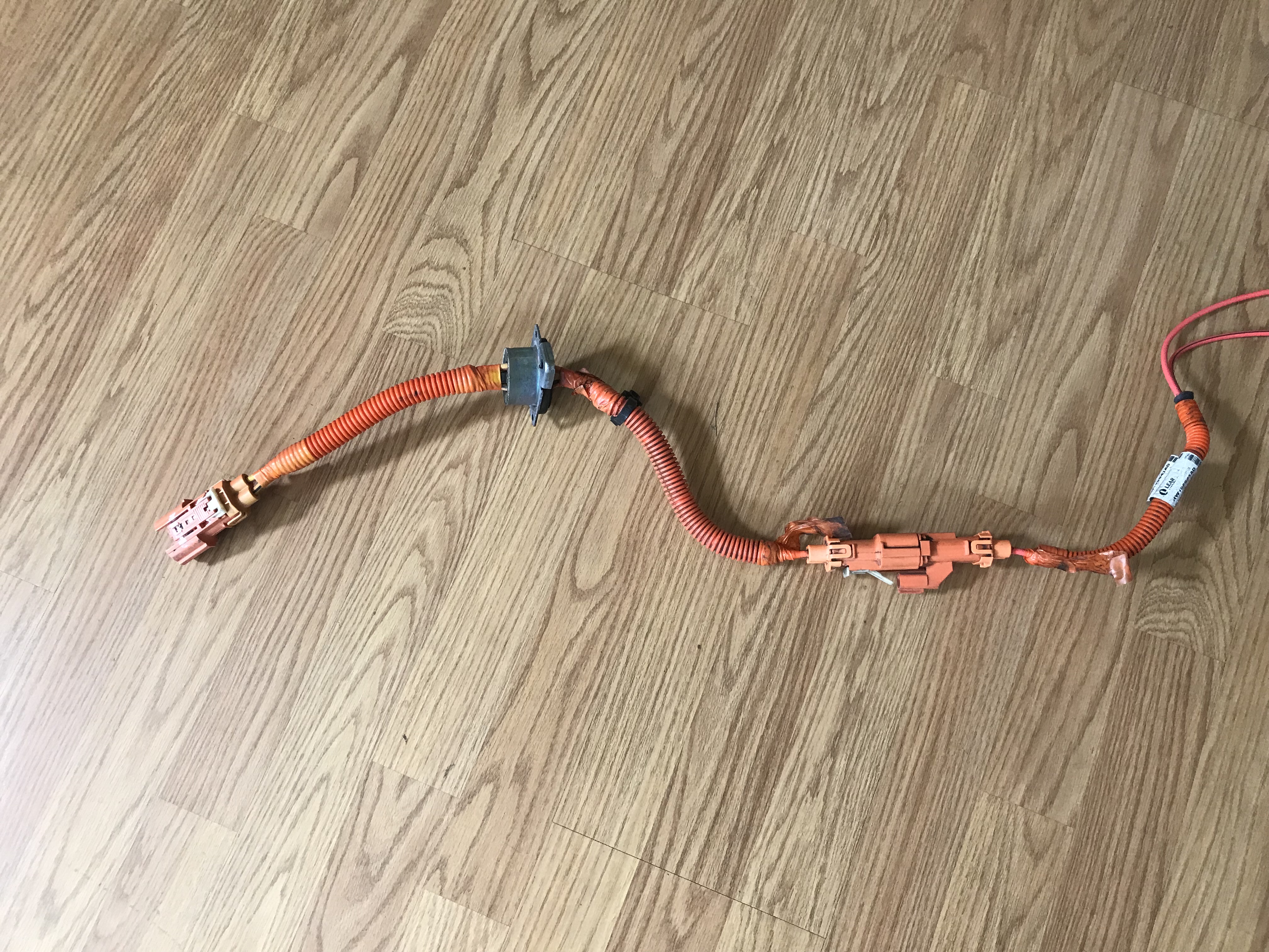

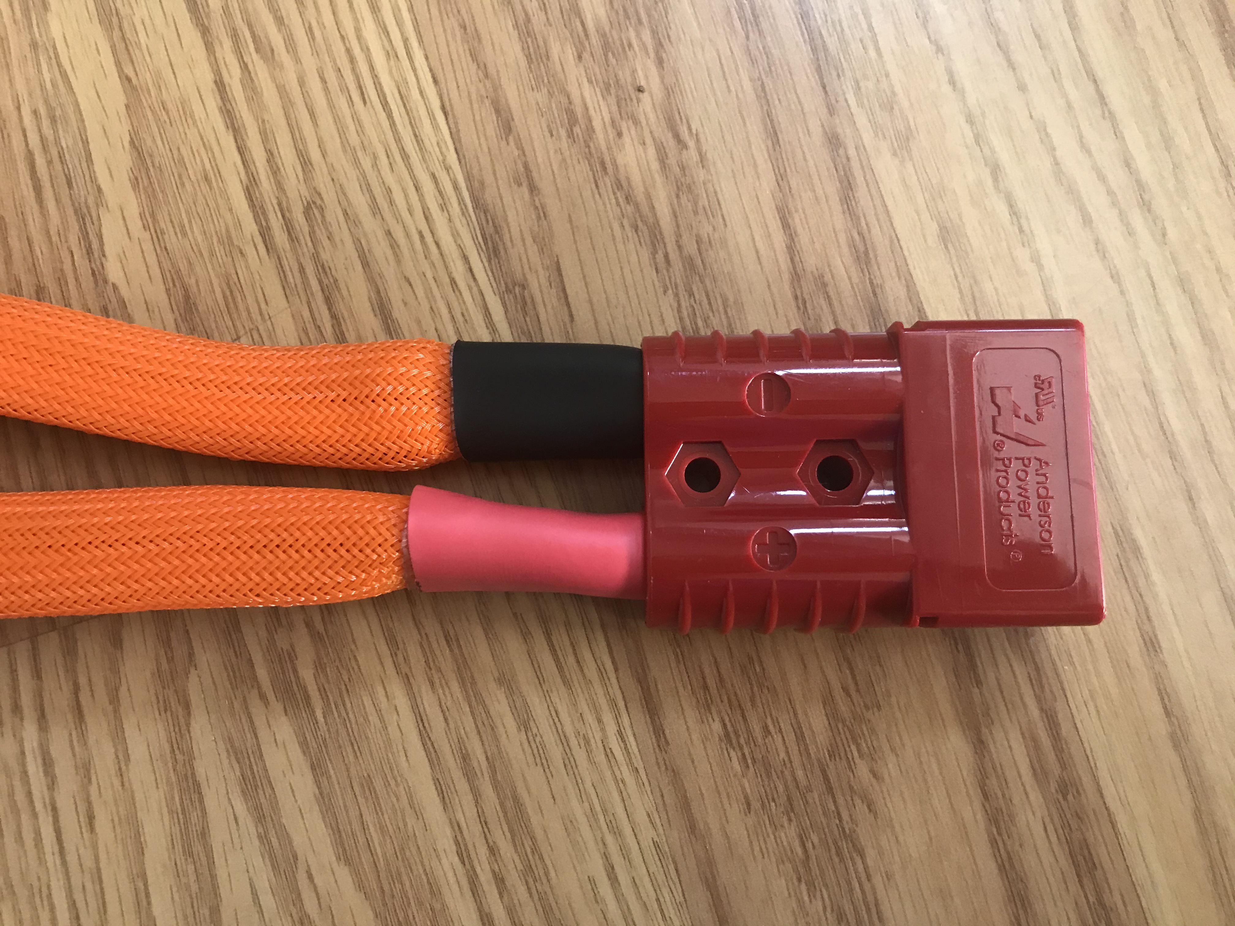

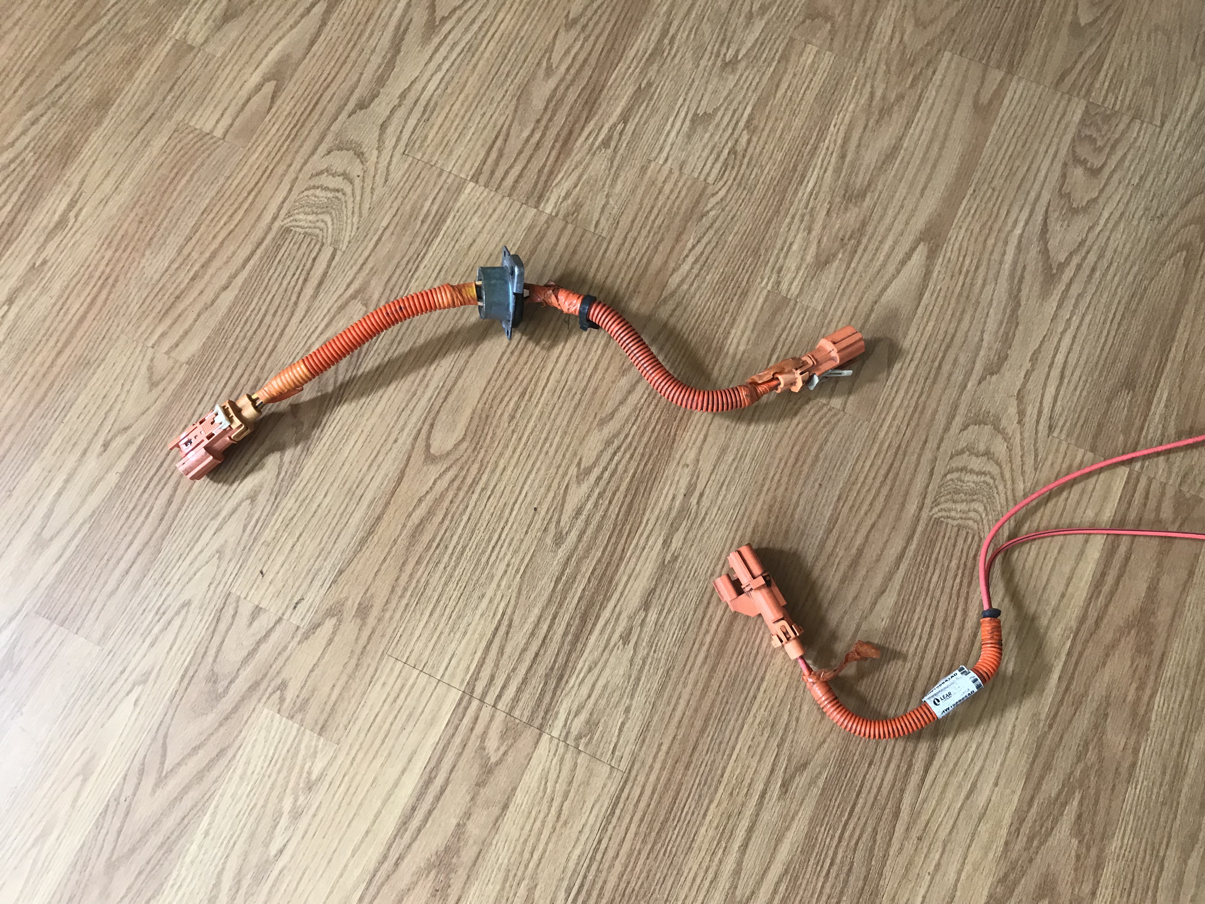

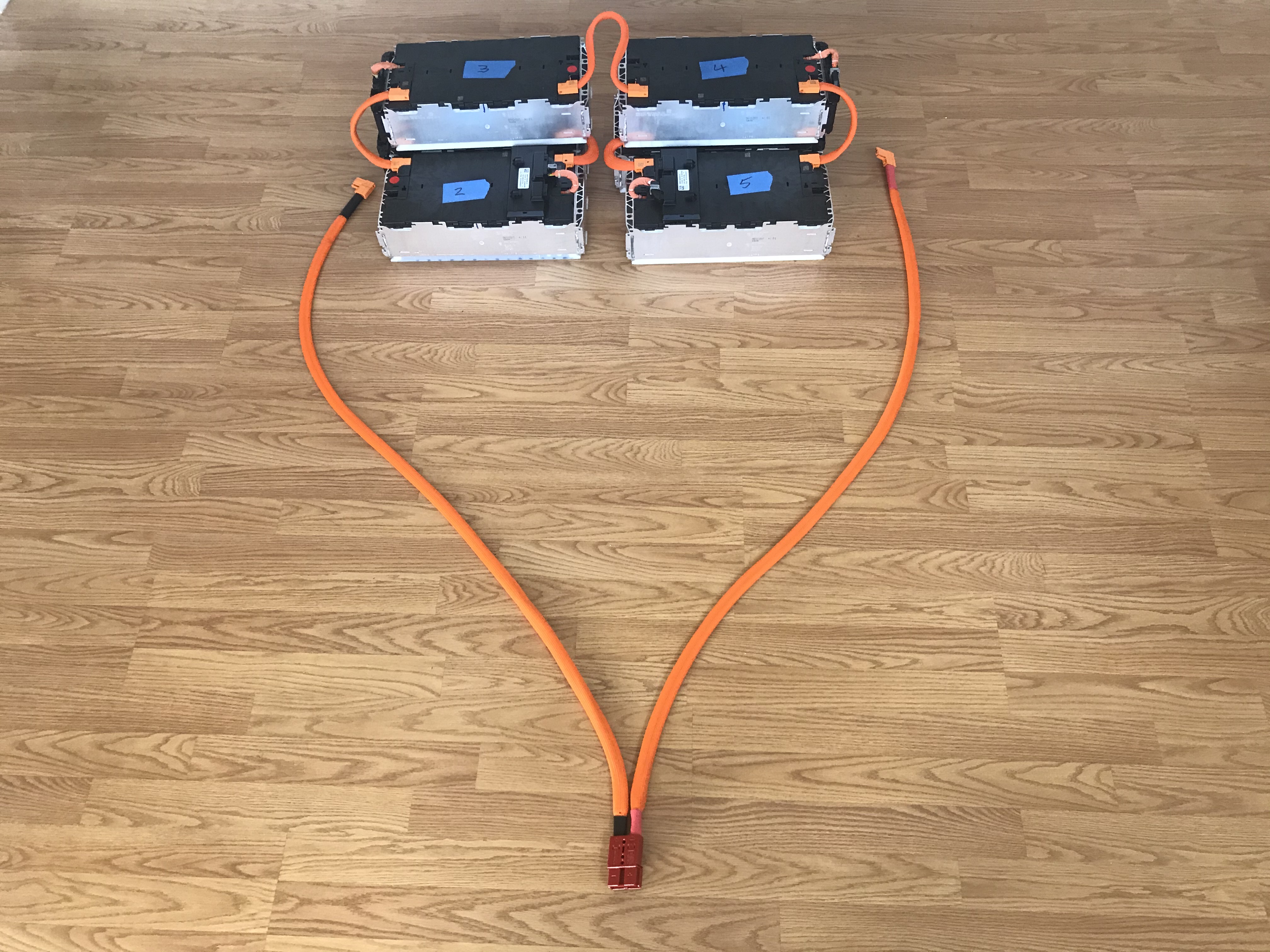

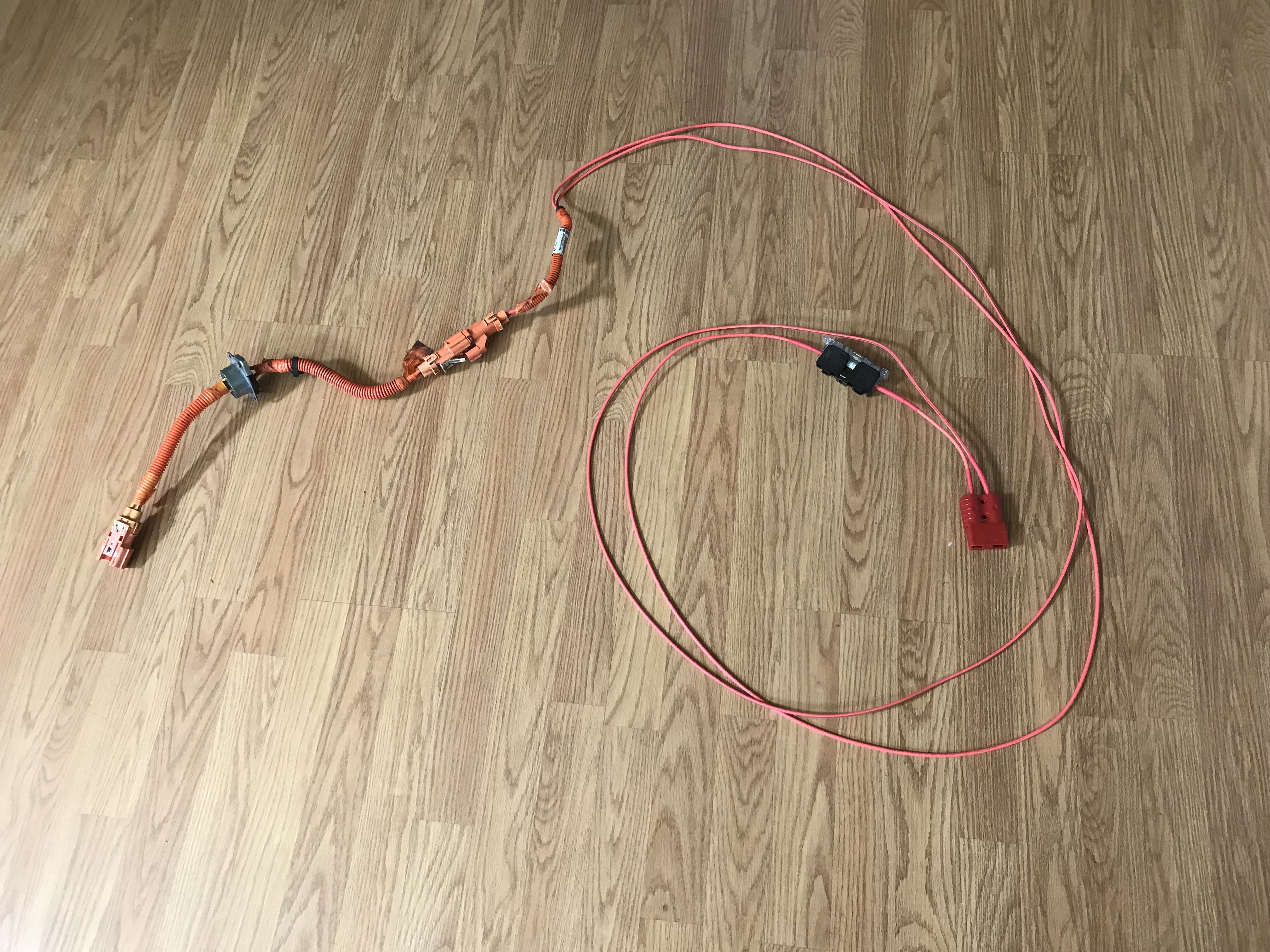

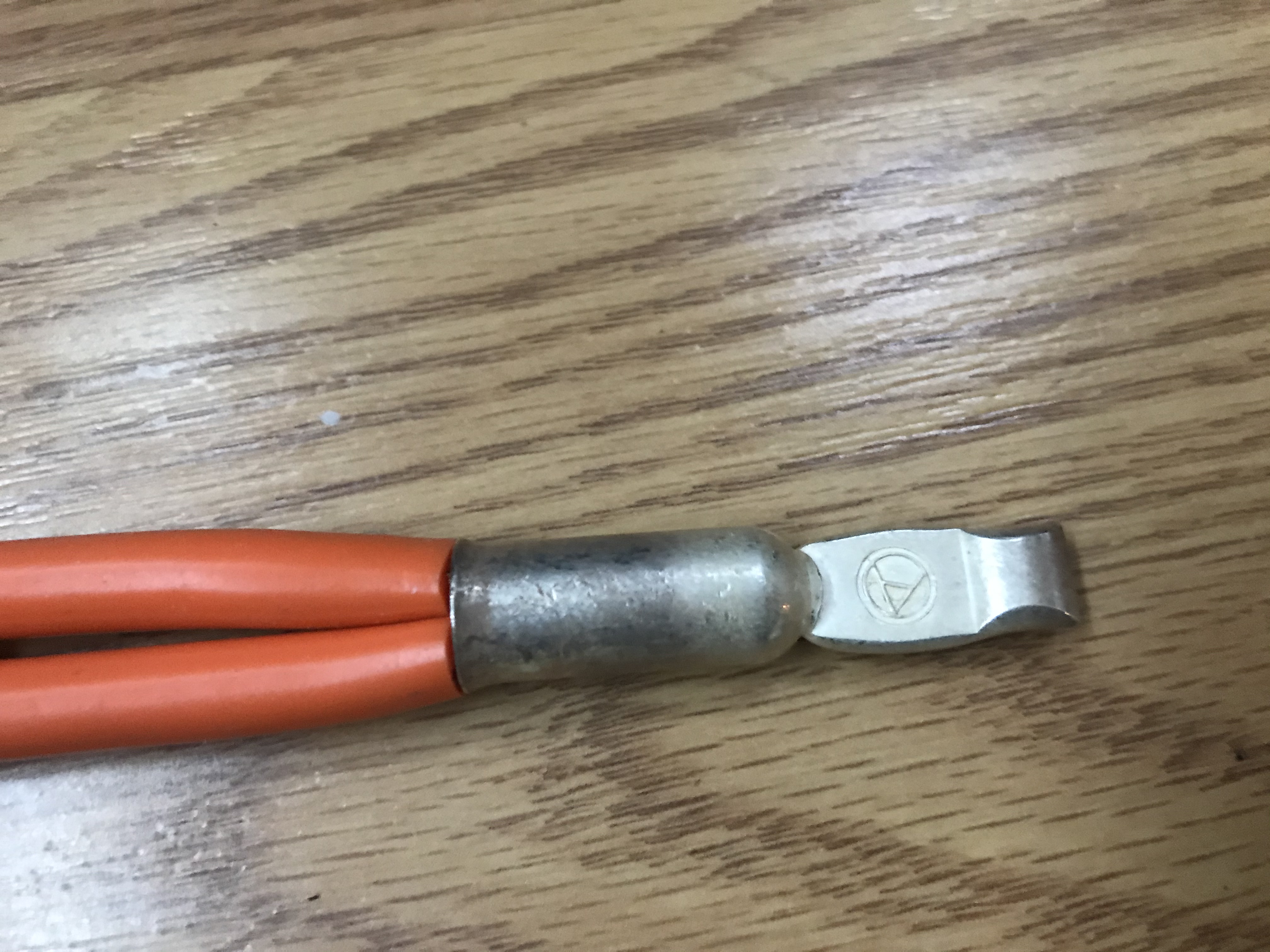

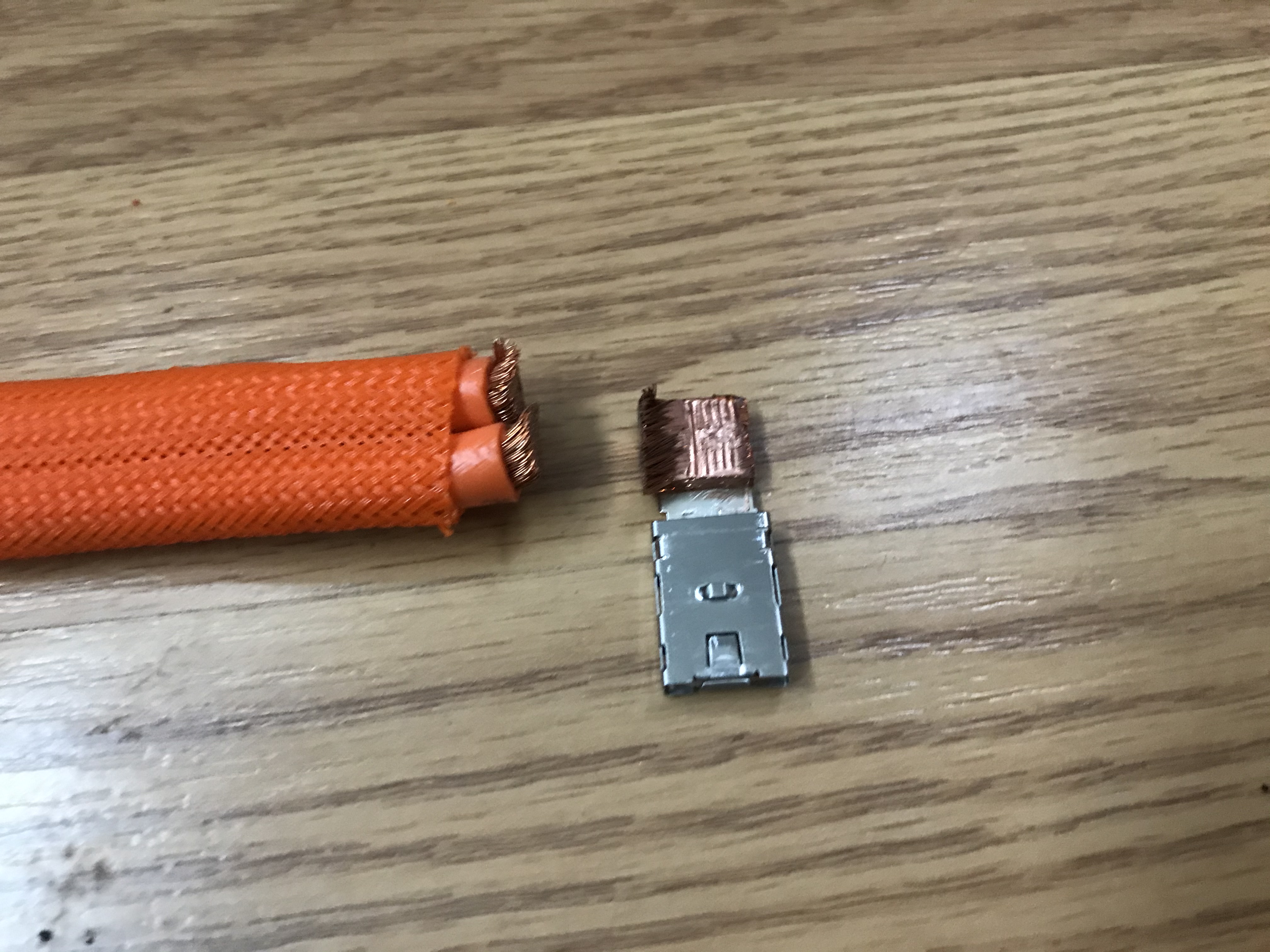

Maybe you cut the OEM cables in the middle, fit a copper ferrule on each end and crimp the extensions to it. Of course you need to put the joints in sleeves and orange tubing...
Or you could take a rigid copper tube and bend it to shape. Then crimp the OEM cables to it directly.
Gregski
Posts: 3158
Has thanked: 630 times
Been thanked: 1607 times
Post by Gregski »
arber333 wrote: Wed May 04, 2022 6:36 am Maybe you cut the OEM cables in the middle, fit a copper ferrule on each end and crimp the extensions to it. Of course you need to put the joints in sleeves and orange tubing...
thank you for that suggestion, I have a second battery pack I am about to open so I can harvest some cables from there also, and for the time being for testing purposes I tried the Anderson connectors but not for cell module to cell module connections but for battery pack to charger or battery pack to converter type of temp hook em ups

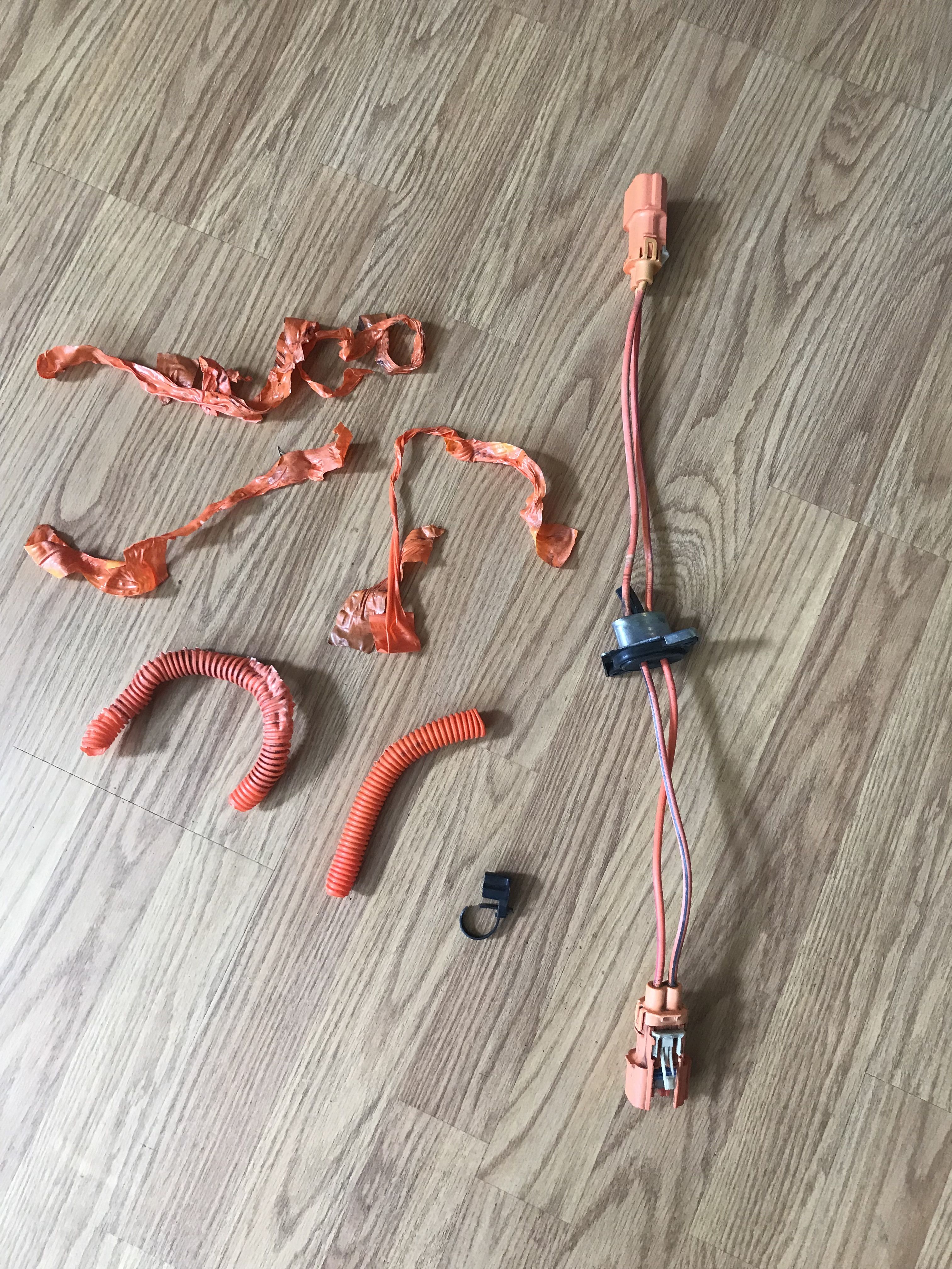

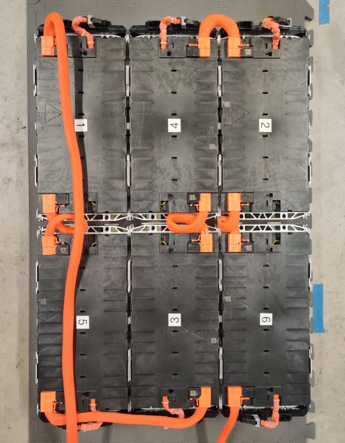

and as you may have heard my SSD (computer hard drive) failed last month and i LOST all of my EV pics and Notes but somehow today on Google Drive I found this pic from Sir Artur my EV blood brother and mentor on this project, and here is how he pulled it off with one OEM set of orange twizzlers
the boy is smart, that's for damn sure

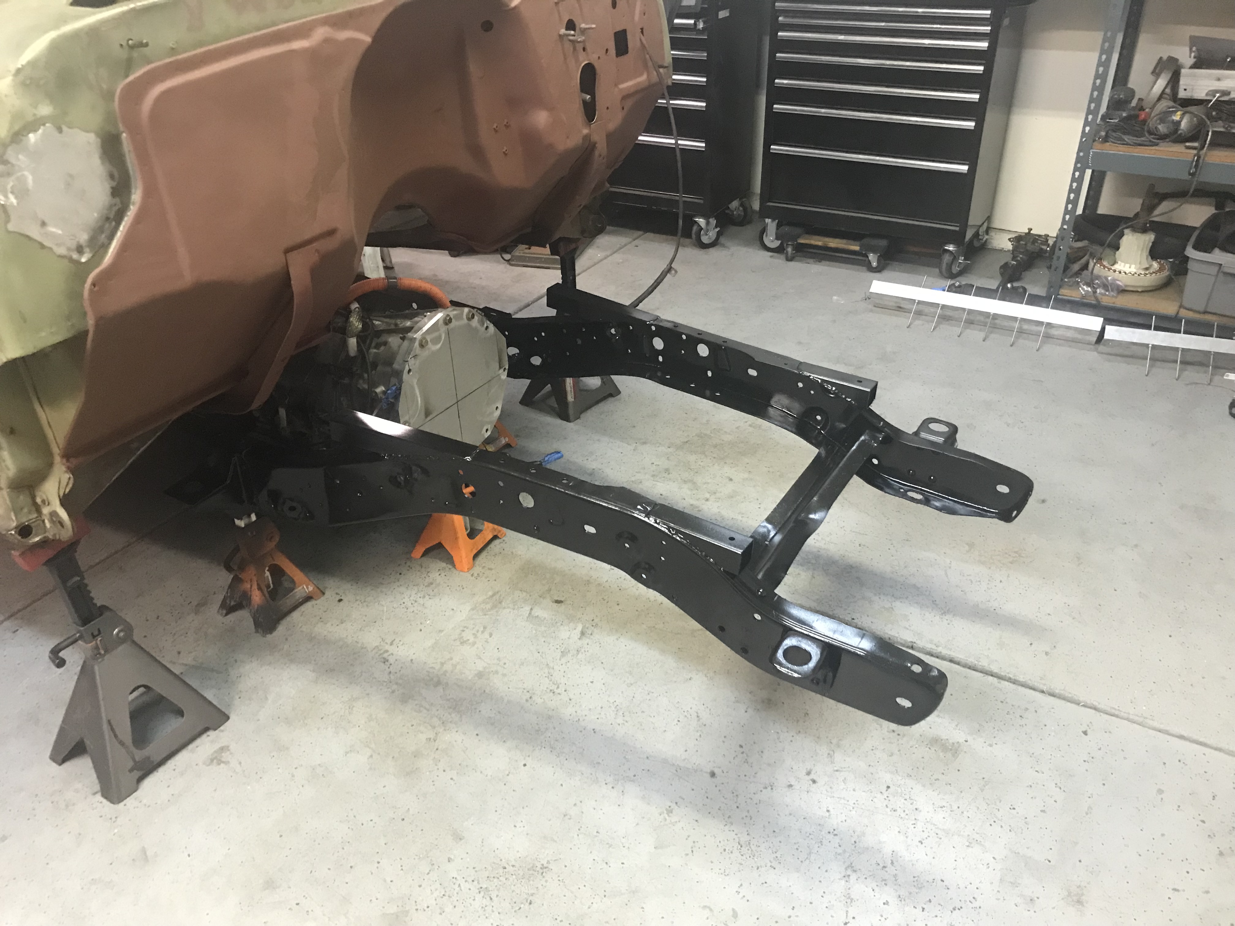

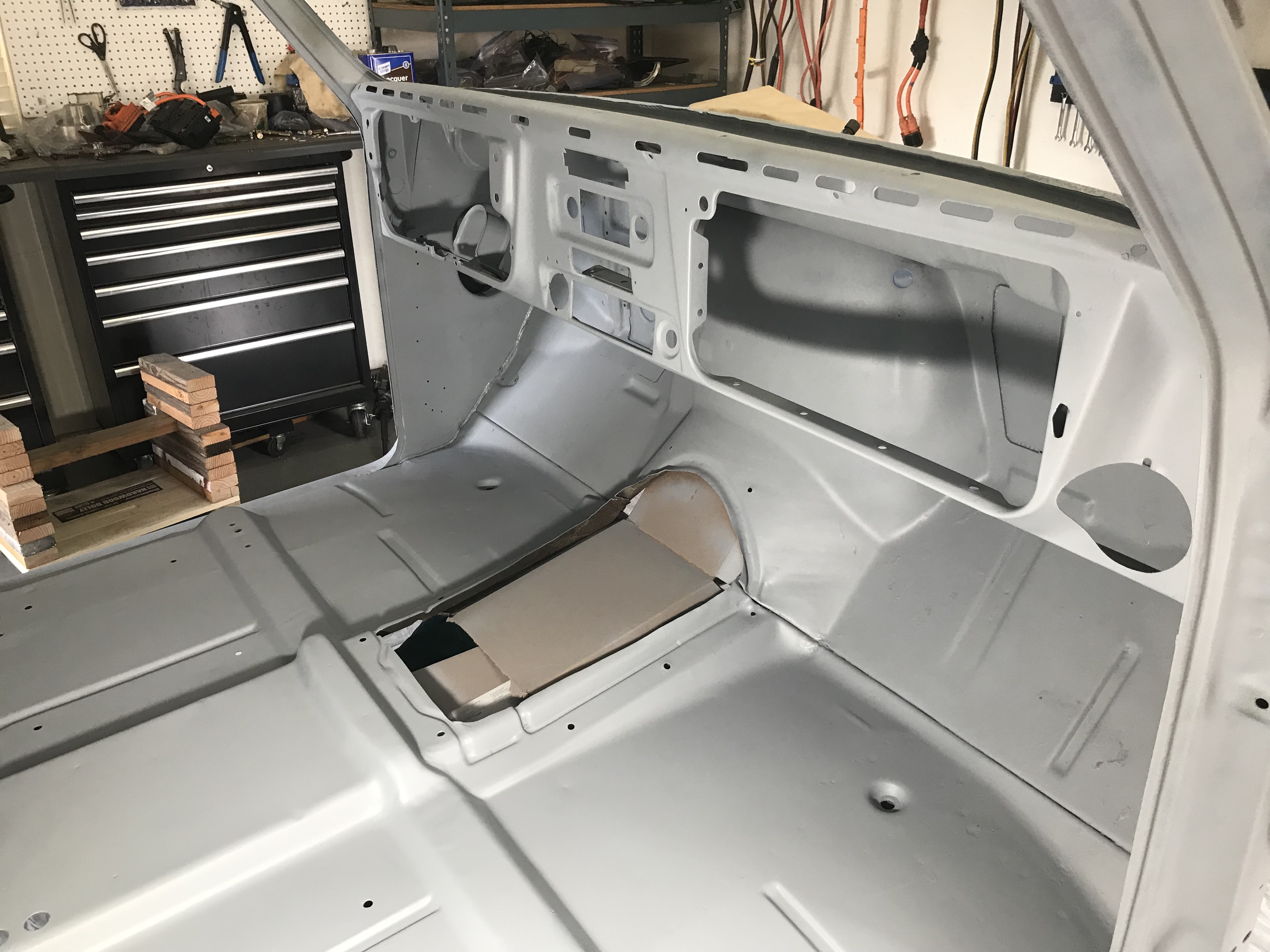

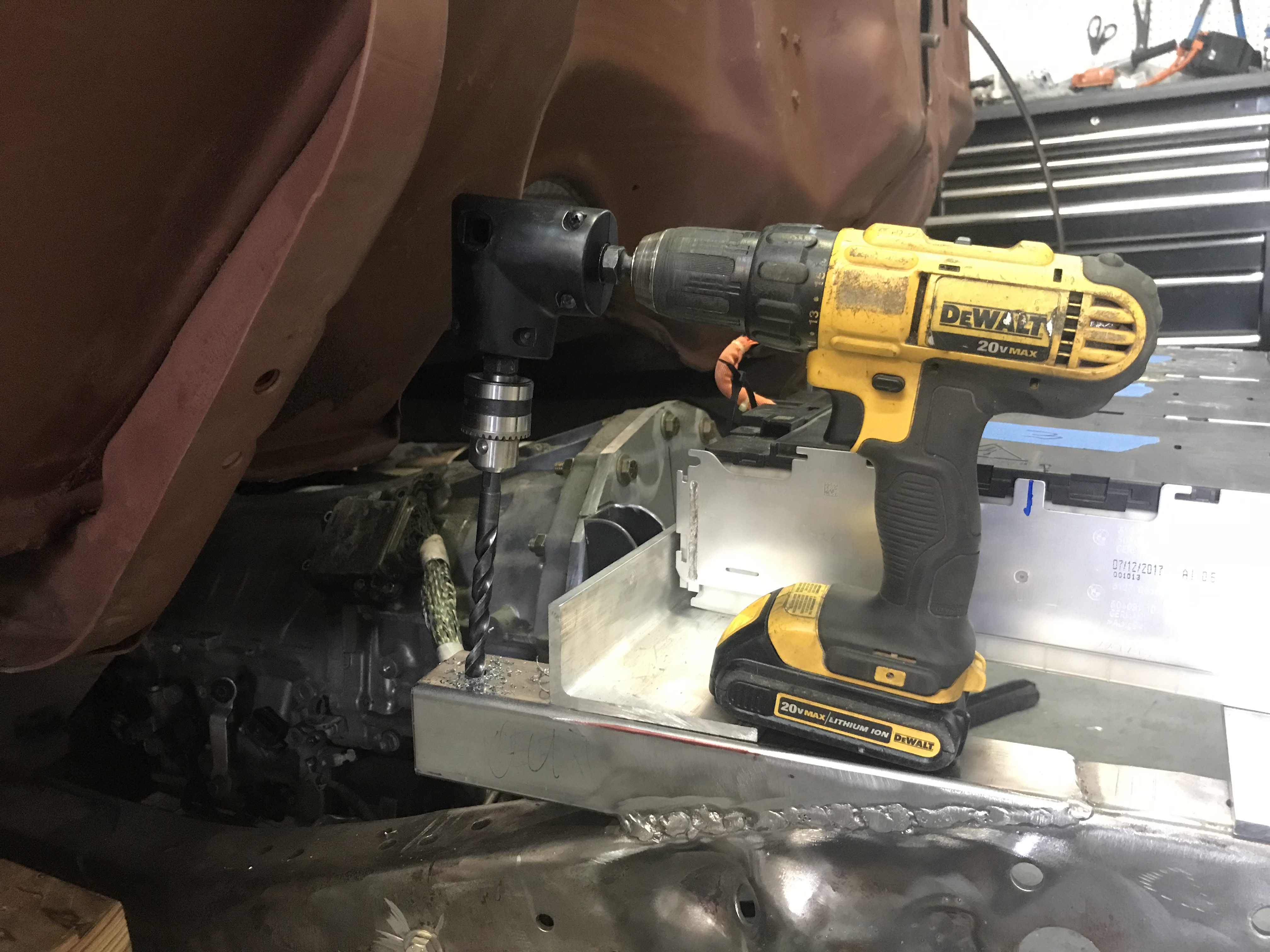

no I didn't just spend 4 hours drilling two holes in the most unreachable of places, who in their right mind designed these silly frame extensions?!?!

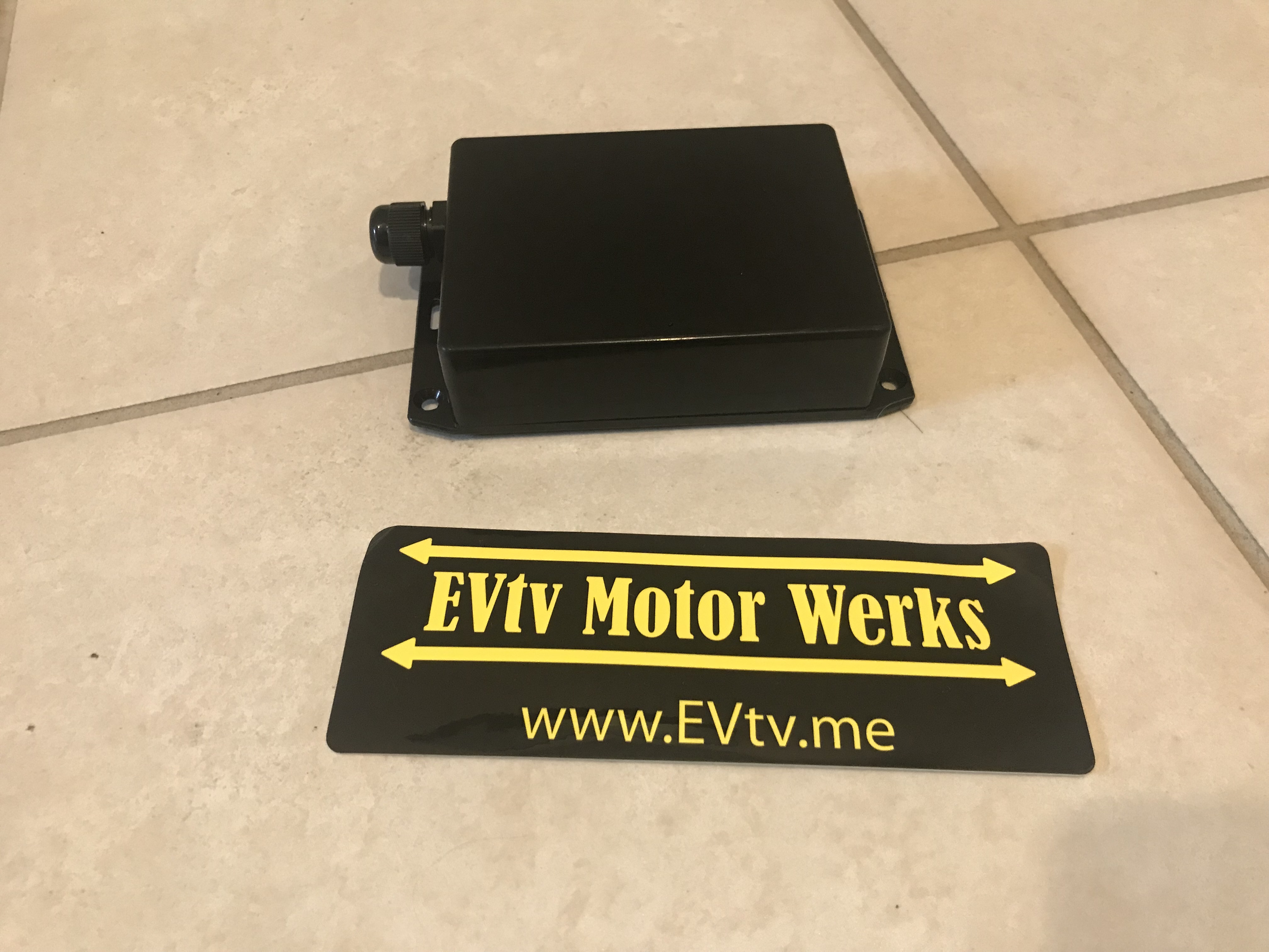

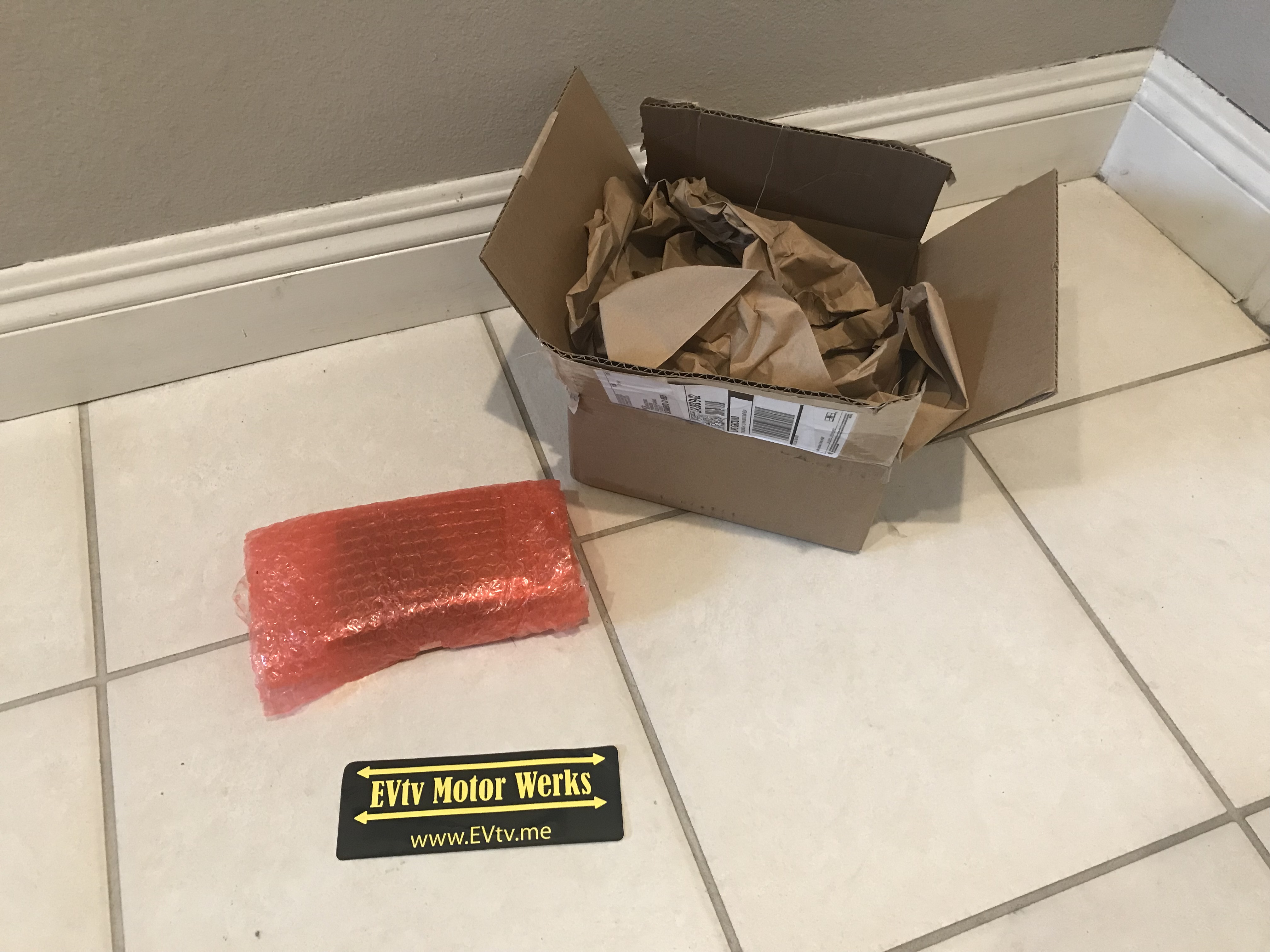

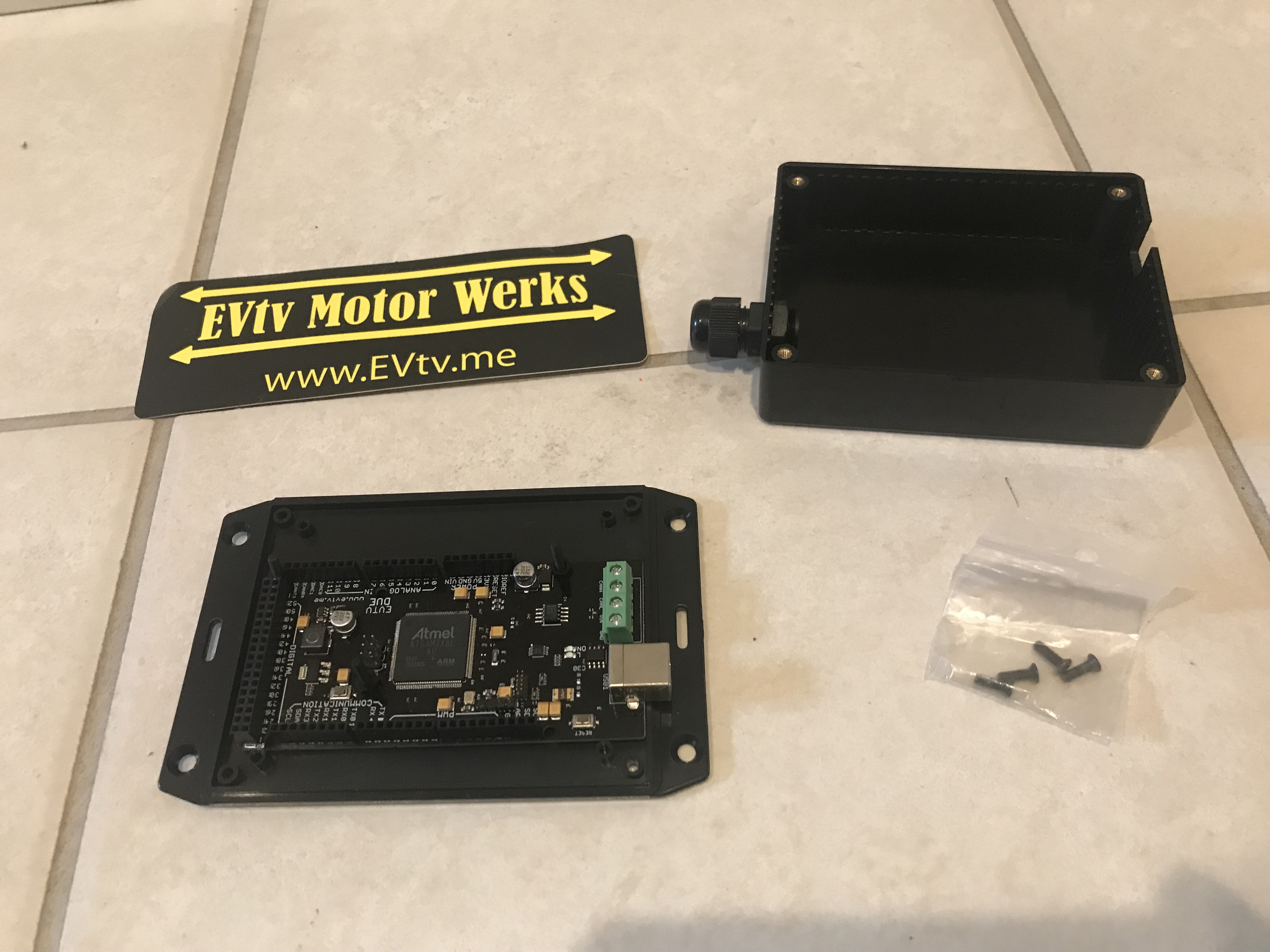

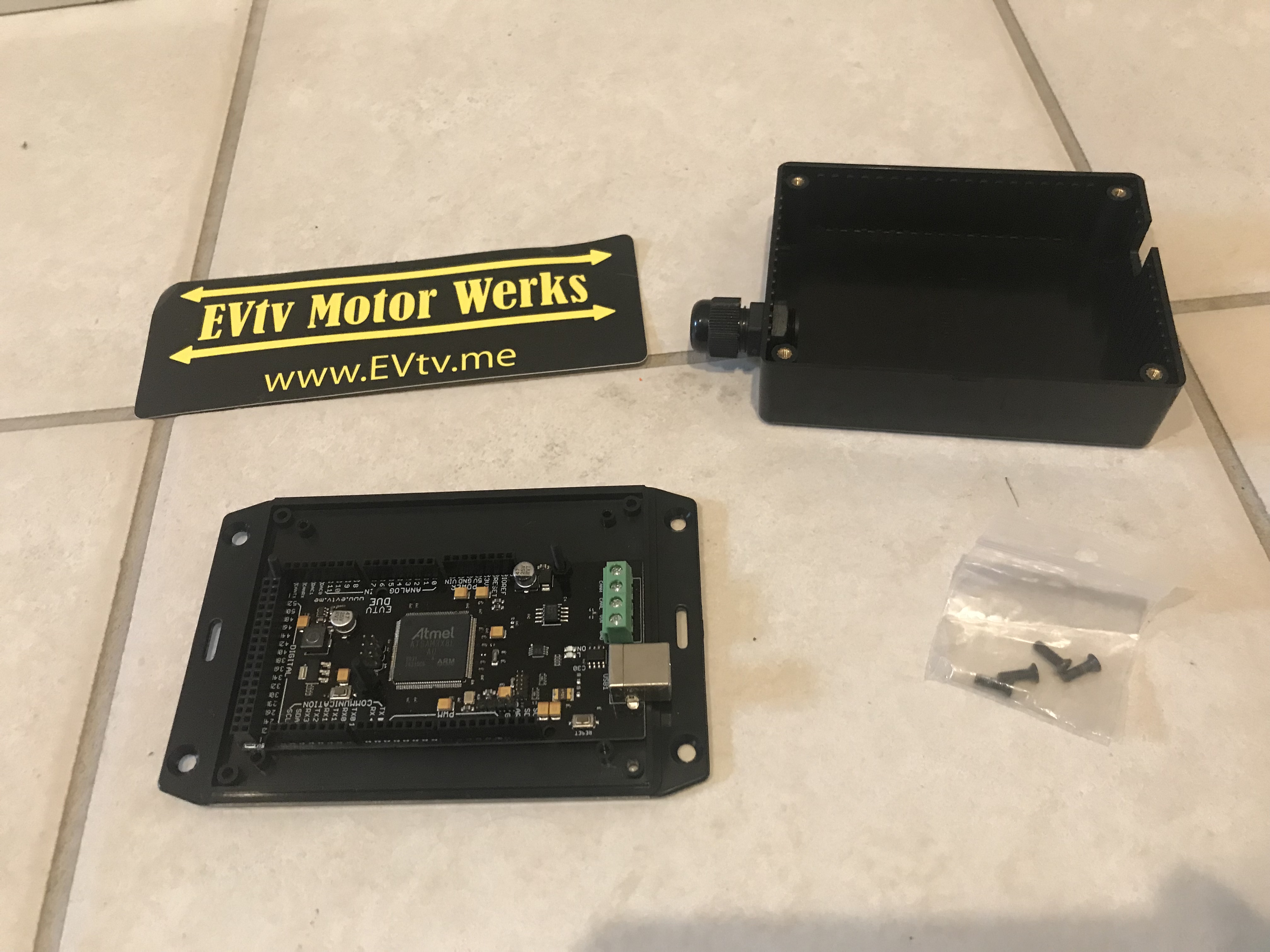

I was going a bit crazy toggling between Arduino codes for this and Arduino codes for that on my lonely Arduino Due board, so I decided to buy one dedicated to CAN bus(ing) from EVTV
Posts: 3795
Been thanked: 411 times
Gregski wrote: Fri May 06, 2022 12:50 pm I was going a bit crazy toggling between Arduino codes for this and Arduino codes for that on my lonely Arduino Due board, so I decided to buy one dedicated to CAN bus(ing) from EVTV
For CANbus DUEing you can use the code here... I developed it from EVTV Collins code.
There should be the code for Volt gen1 charger and DCDC. Note DCDC code starts when you apply Enable (ignition) pin. For simplicity you could make that pin pullup and provide rela to invert signal from ignition. So when you provide 12V signal you get GND signal on Enable pin. That way digital pins are protected from 12V!
DCDC_Volt.zip
(6.42 KiB) Downloaded 198 times
Then this should be the last code i made for my DUE. It has multiple chargers as well as AC compressor and heater from outlander. This should work for you if you replace the CAN IDs and byte values. I even tried to implement watchdog... Note that there is an option of using several chargers in turn. They just need to have different IDs.
DCDC_pug_eltek.zip
(8.78 KiB) Downloaded 273 times

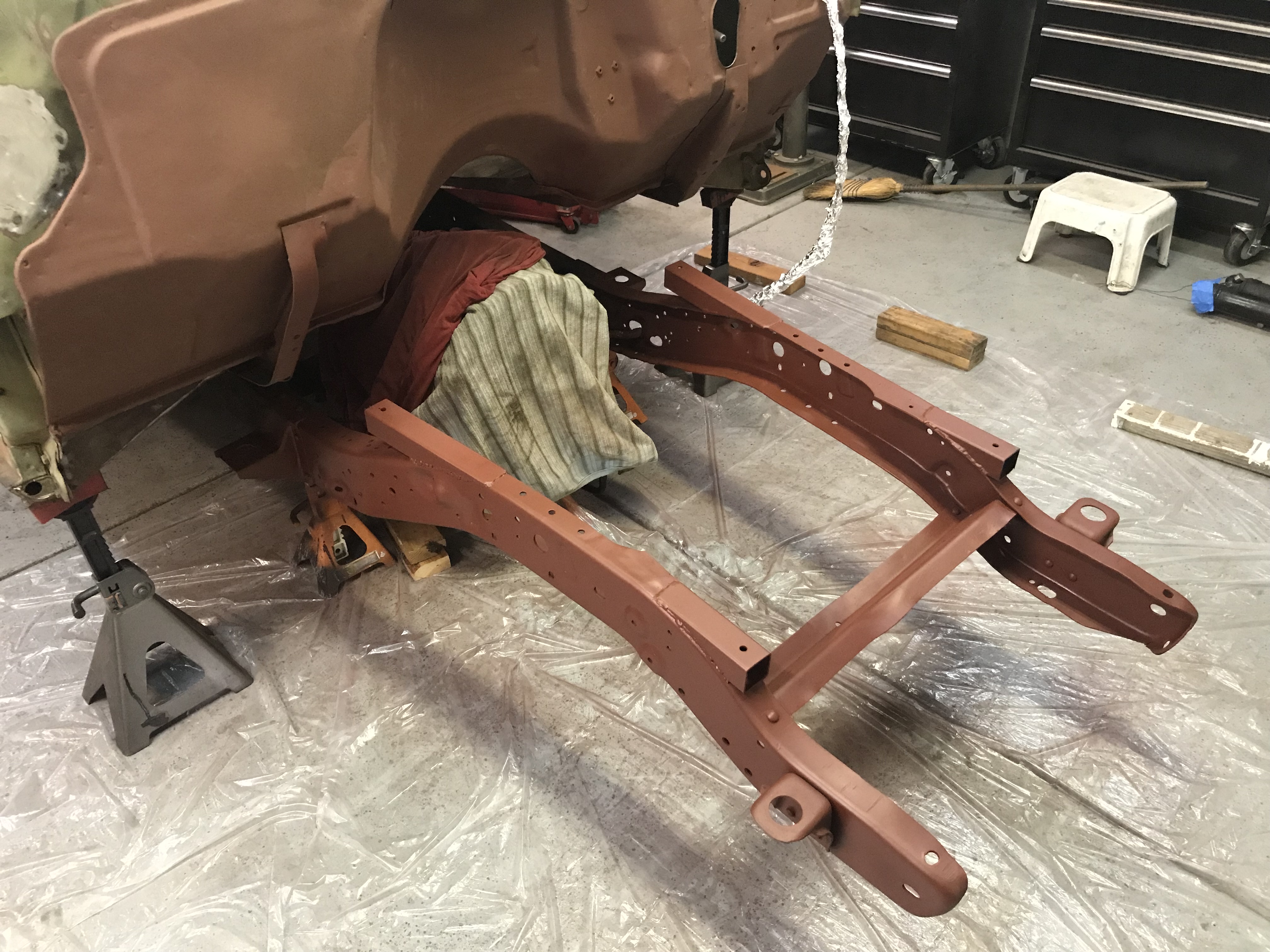

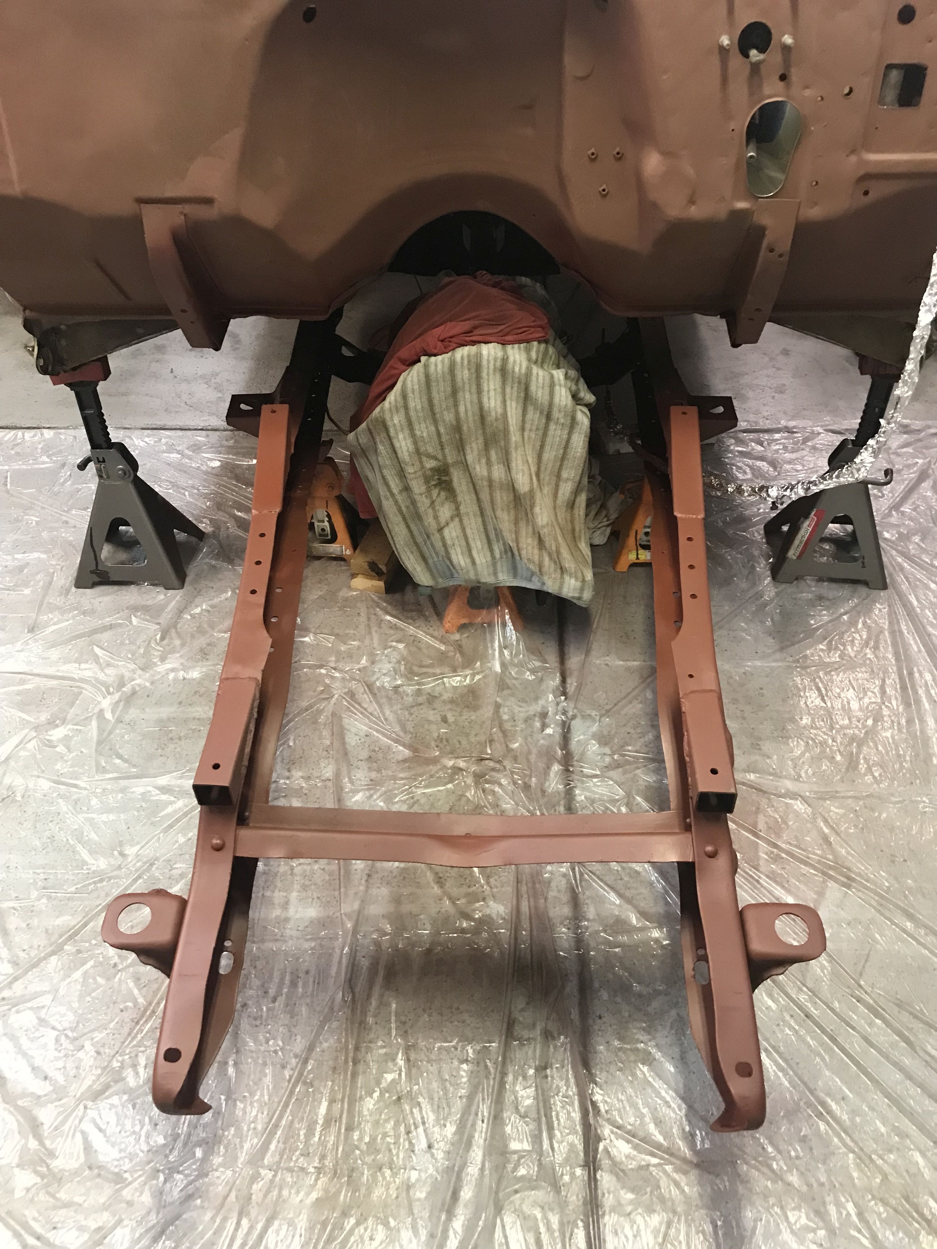

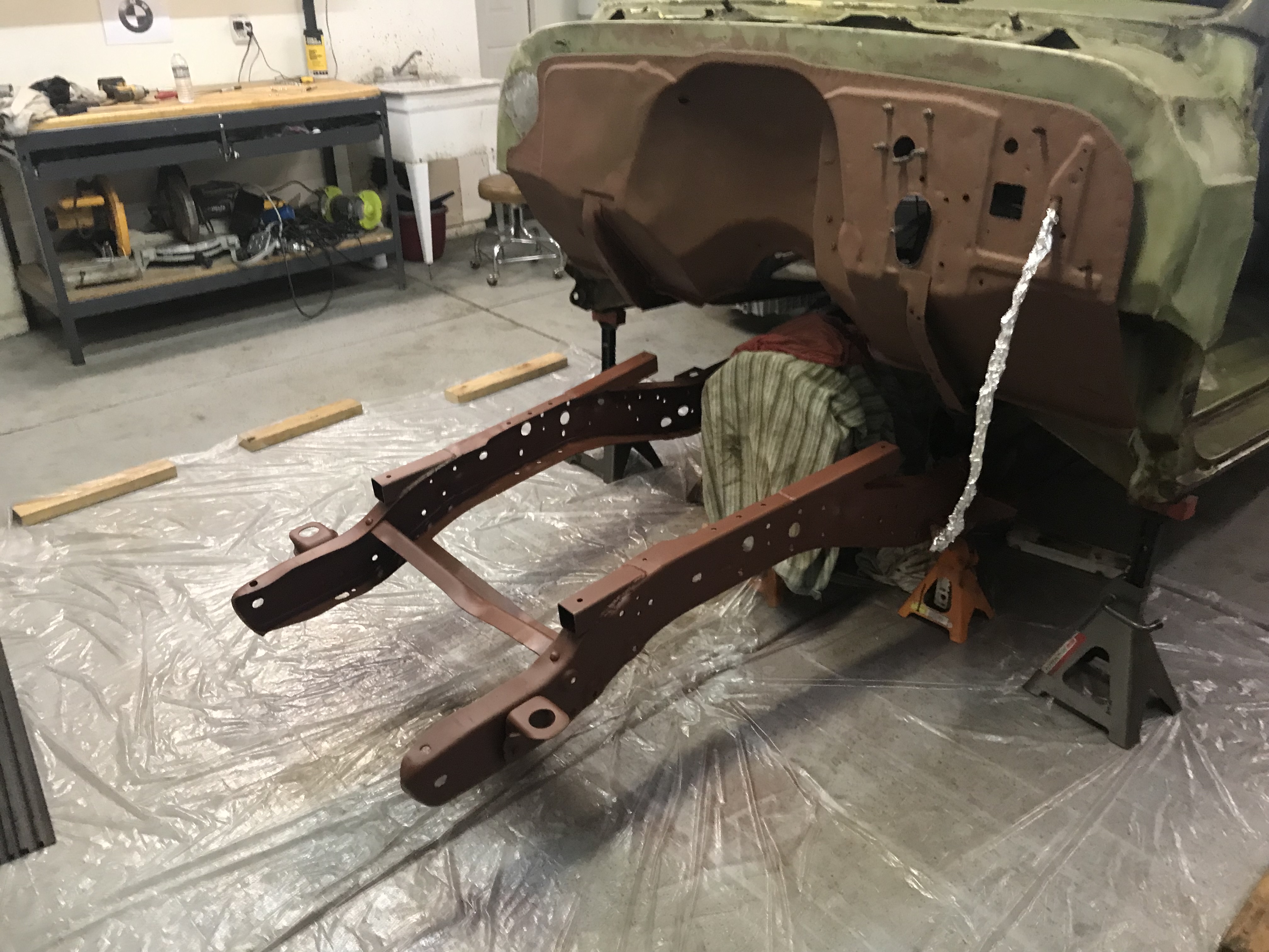

Gregski
Posts: 3158

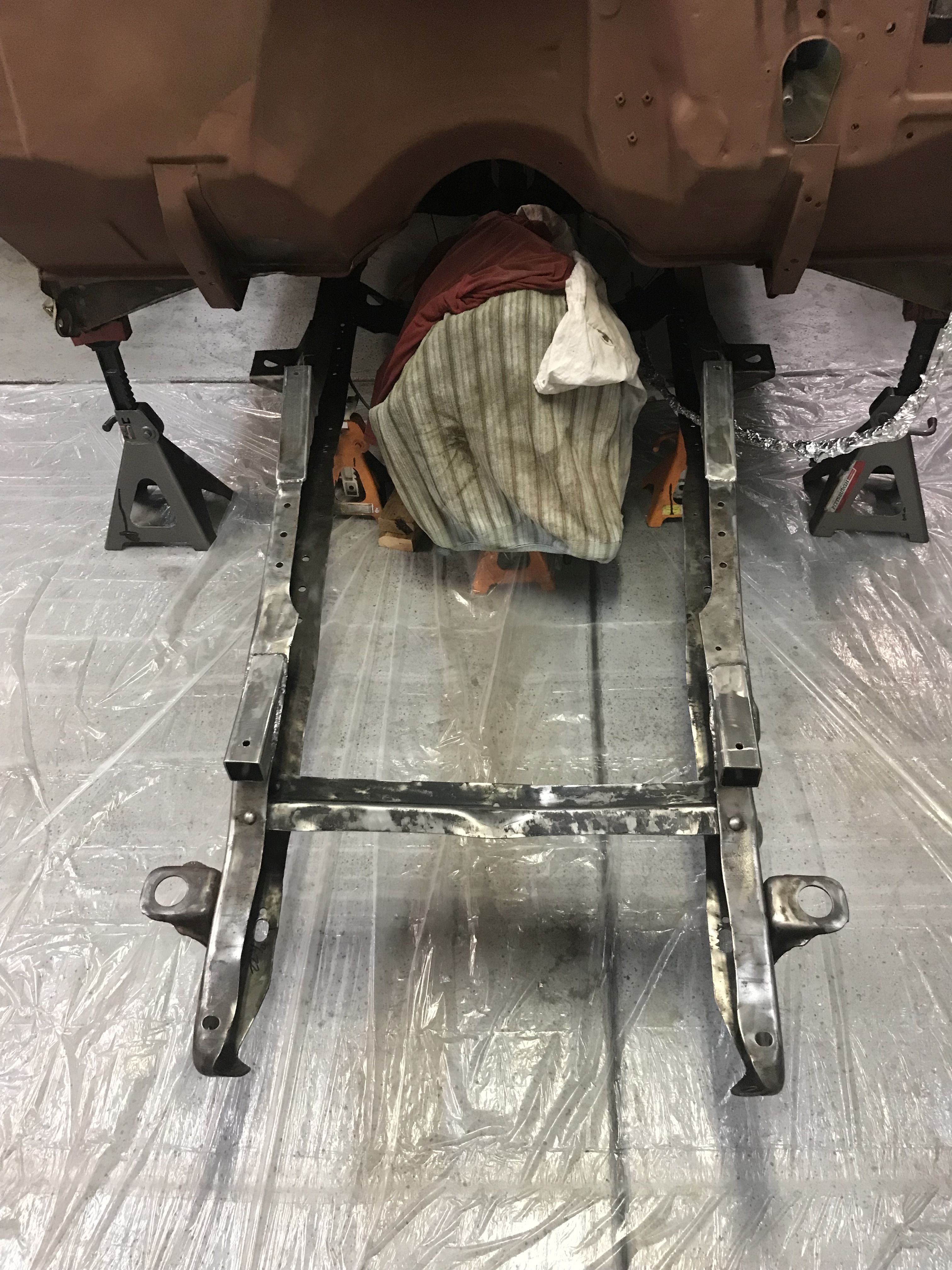

Post by Gregski »

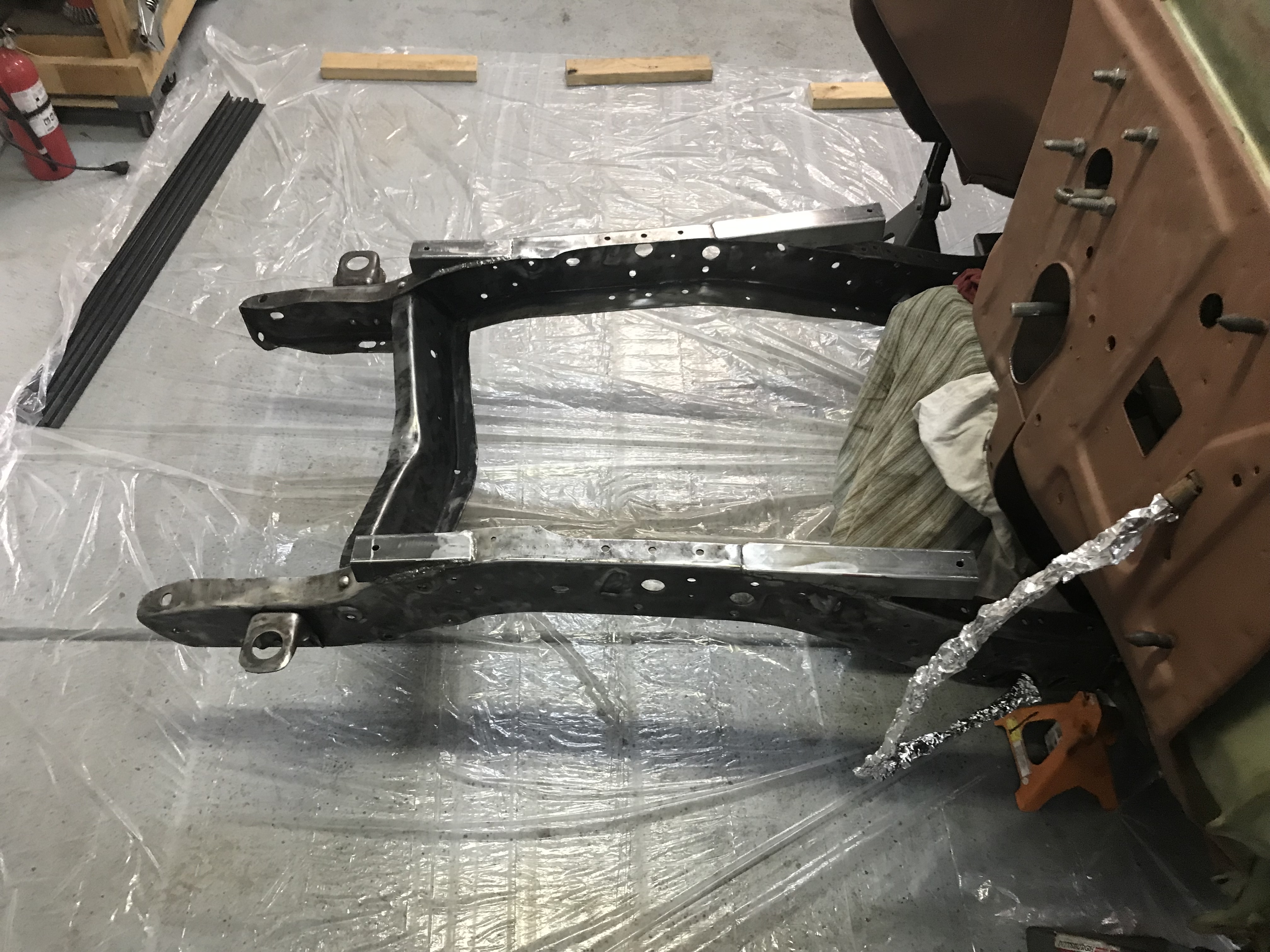

finally... no more Purple (sorry Prince, R.I.P.)
Gregski
Posts: 3158

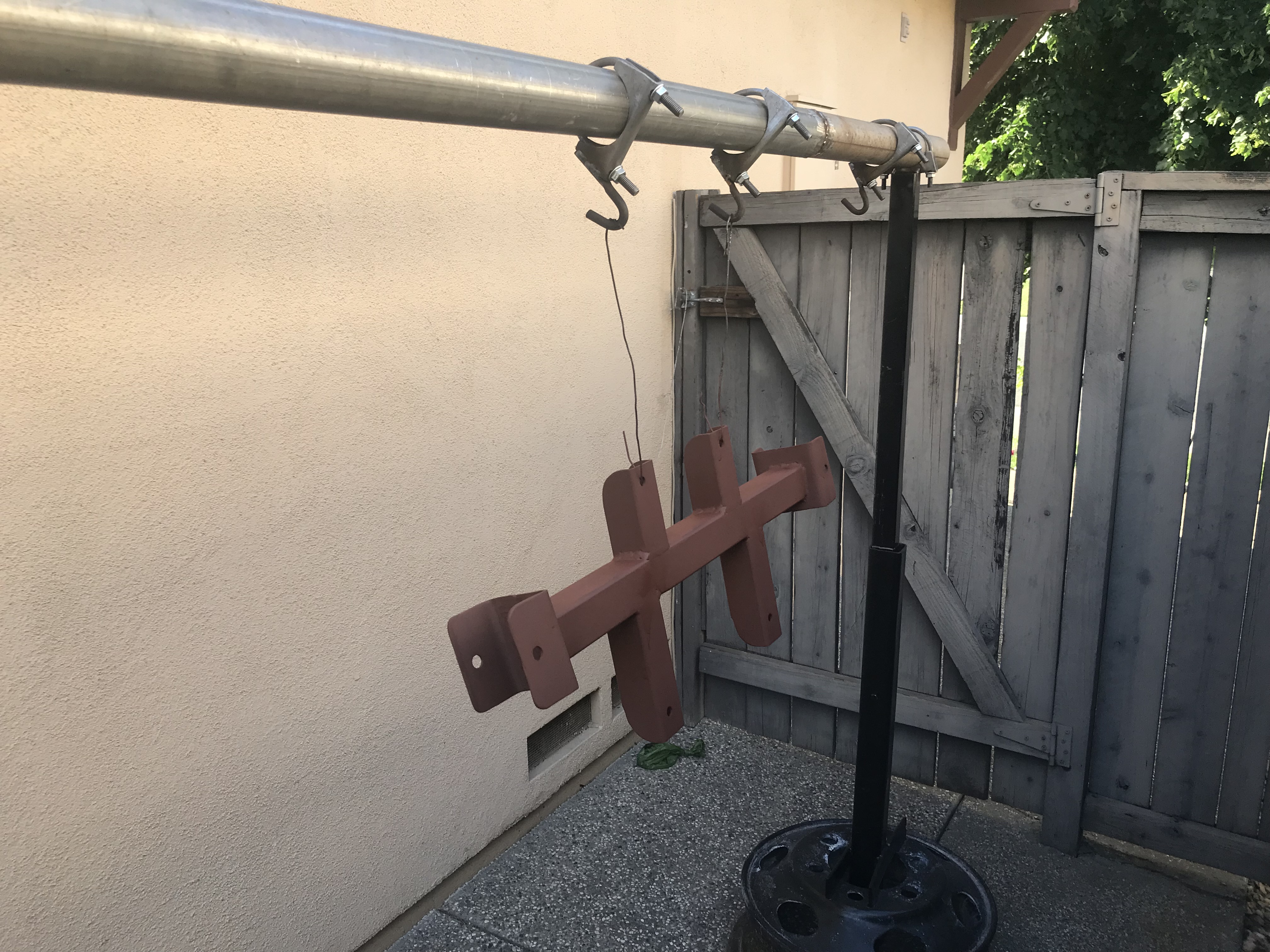

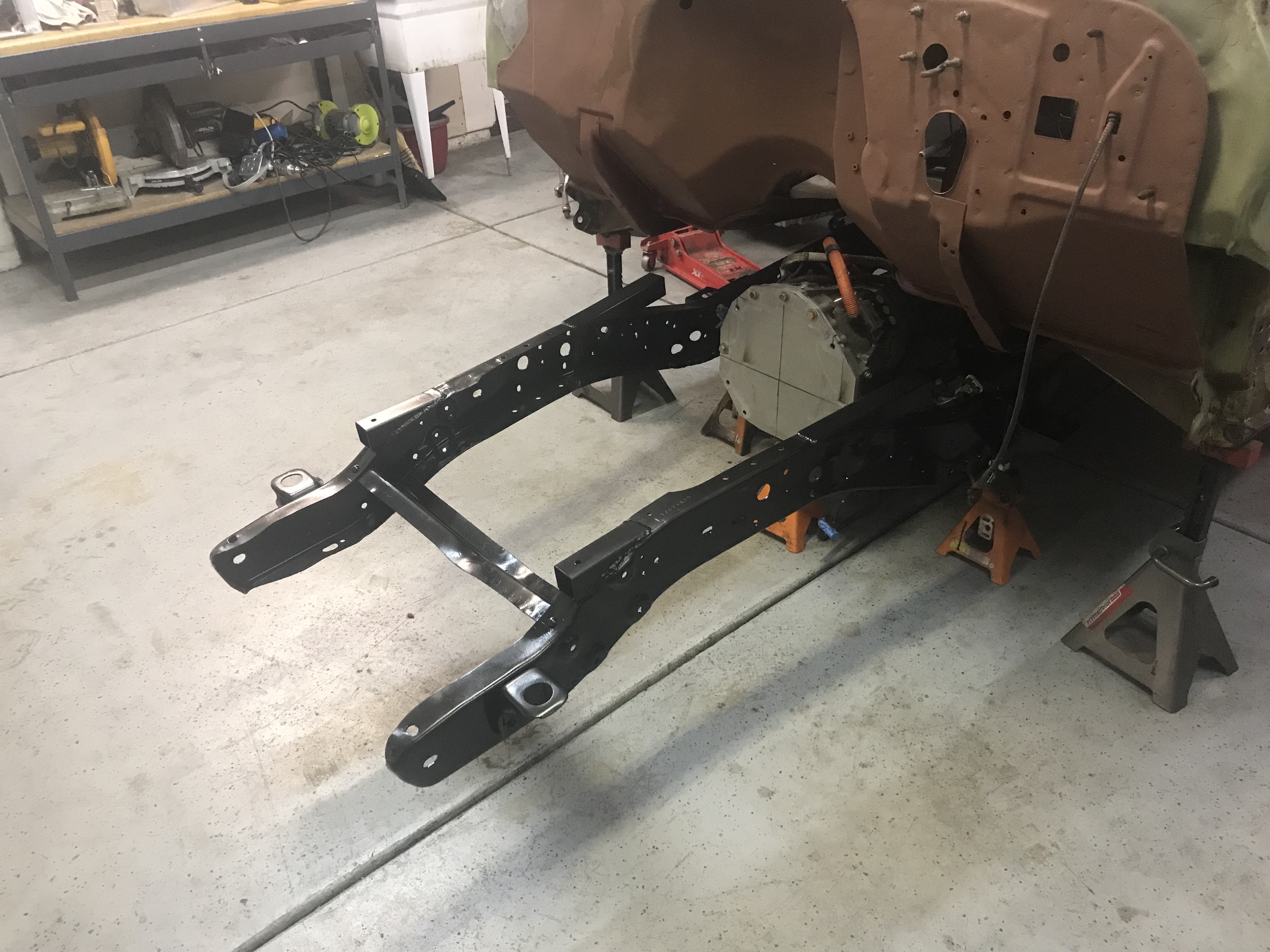

Post by Gregski »

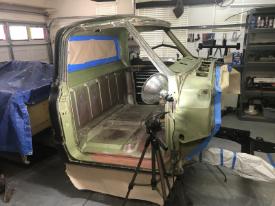

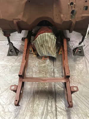

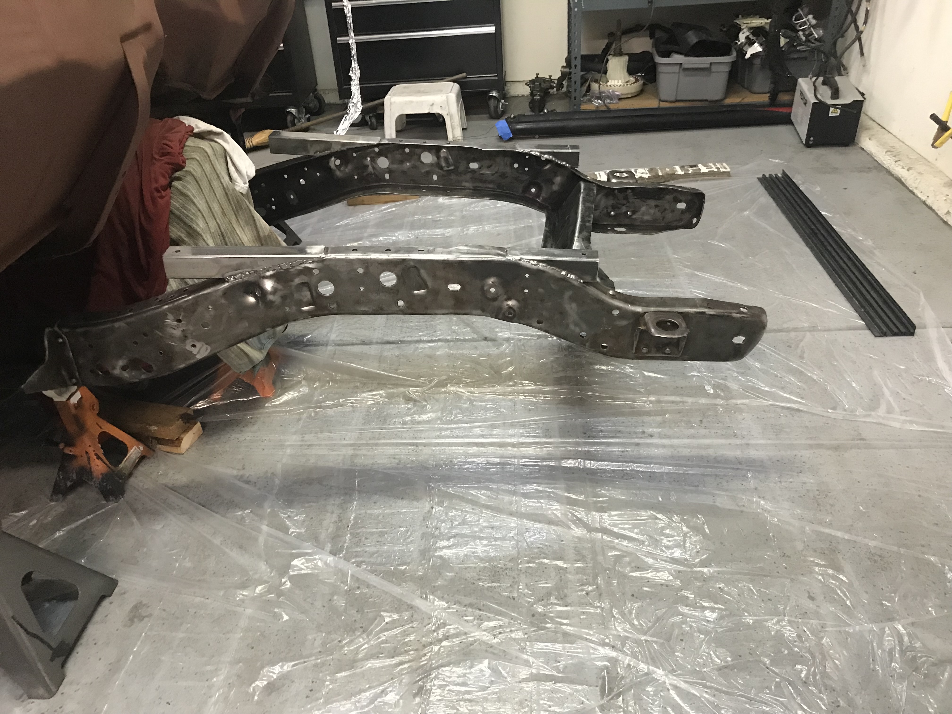

the transmission crossmember also got sum red luv in our outdoor free range organic make shift paint booth
Bonus Points for clever use of not only exhaust pipes but exhaust U clamps, not like we're going to be needing them again

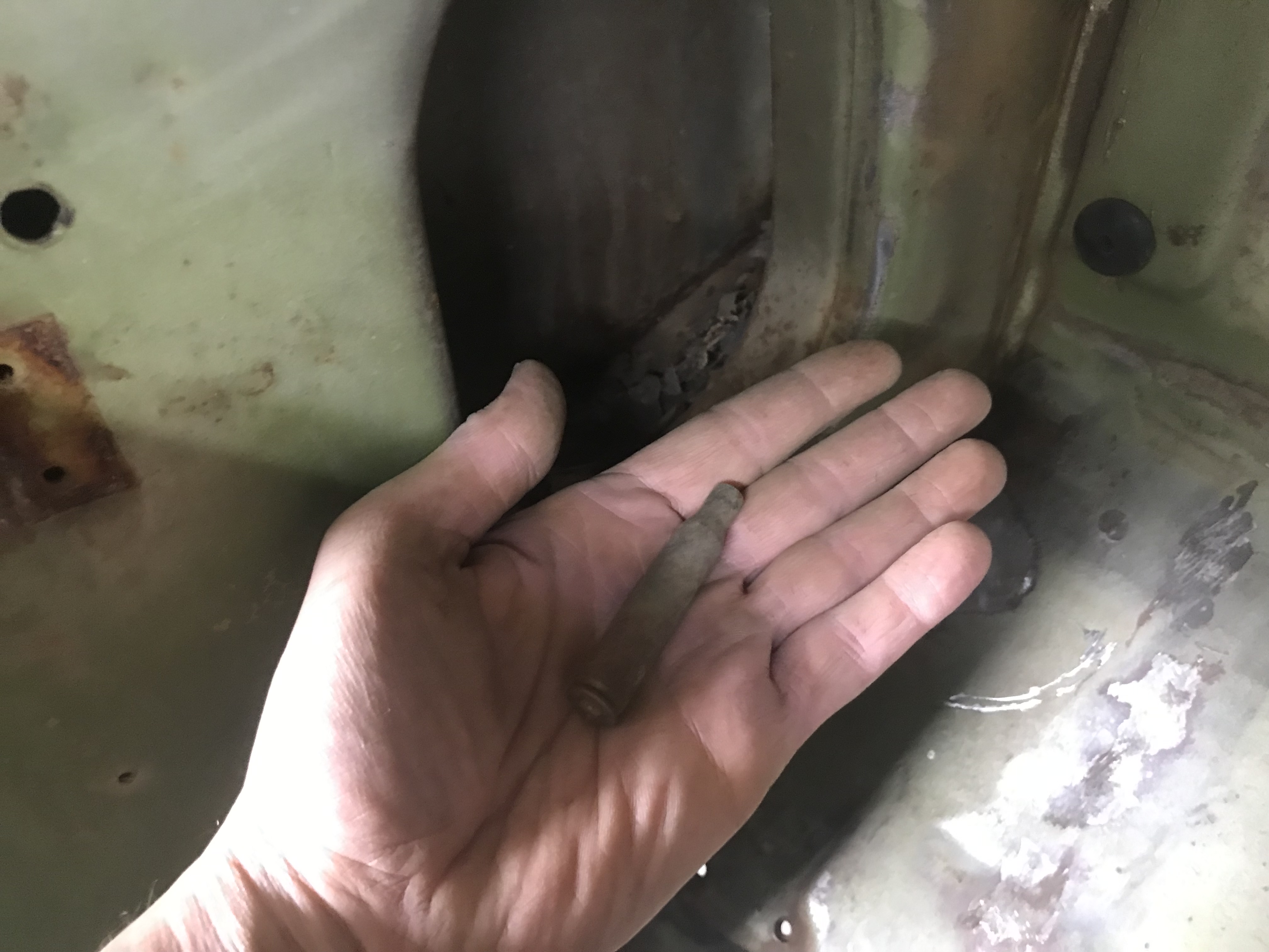

Post by Gregski »
Nobody: What caliber is it?
Me: .270 Winchester cartridge first introduced as early as 1925 so it's going on a 100 years and it's still in production

Gregski wrote: Wed May 11, 2022 3:13 pm Nobody: What caliber is it?
Did you find the bullet in the rear seats too? :twisted:
Here in the EU we mainly joke about finding rotten sandwiches between the seats not ammo...

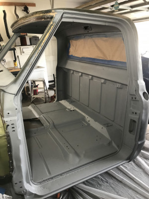

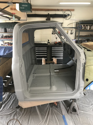

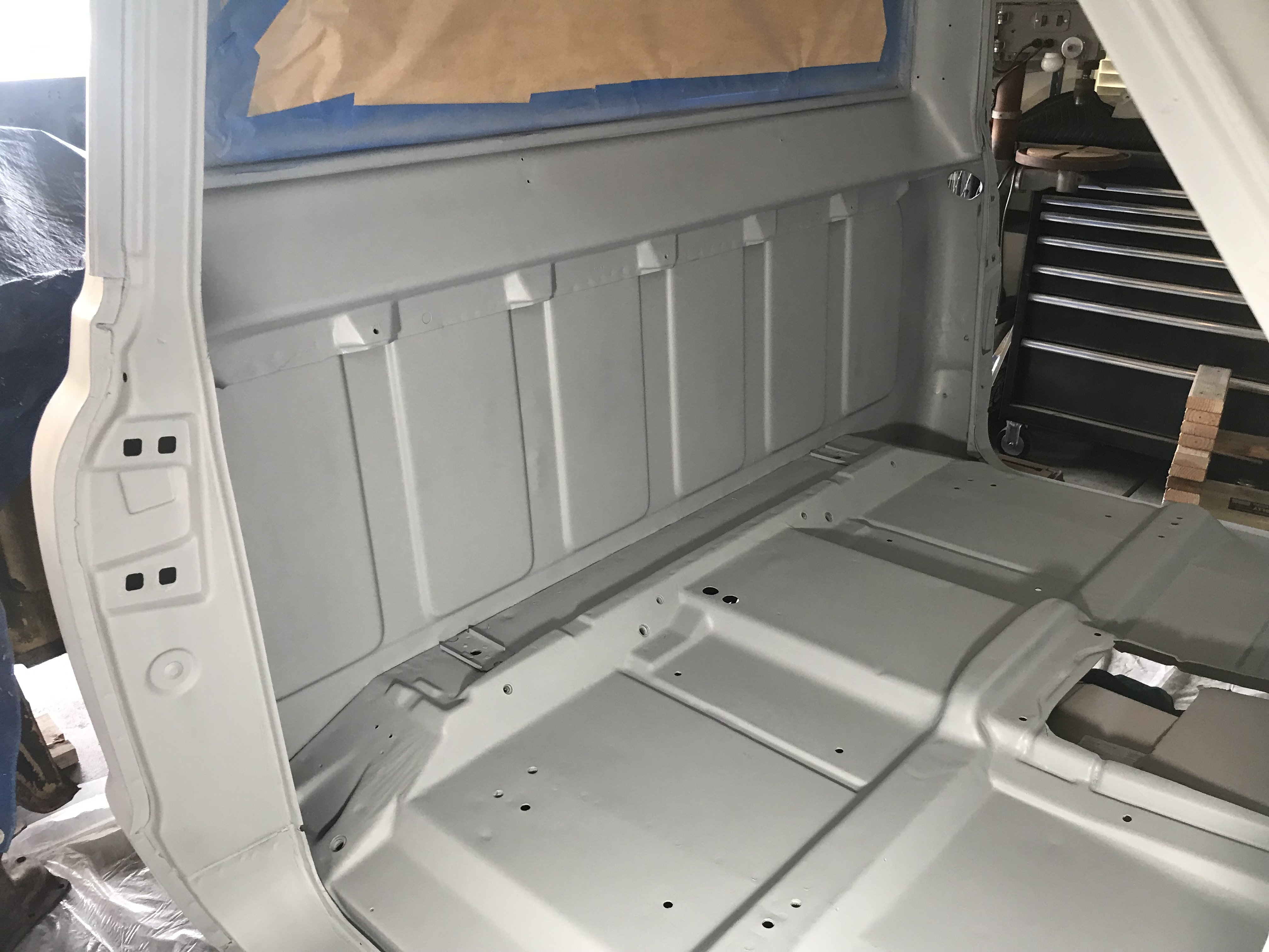

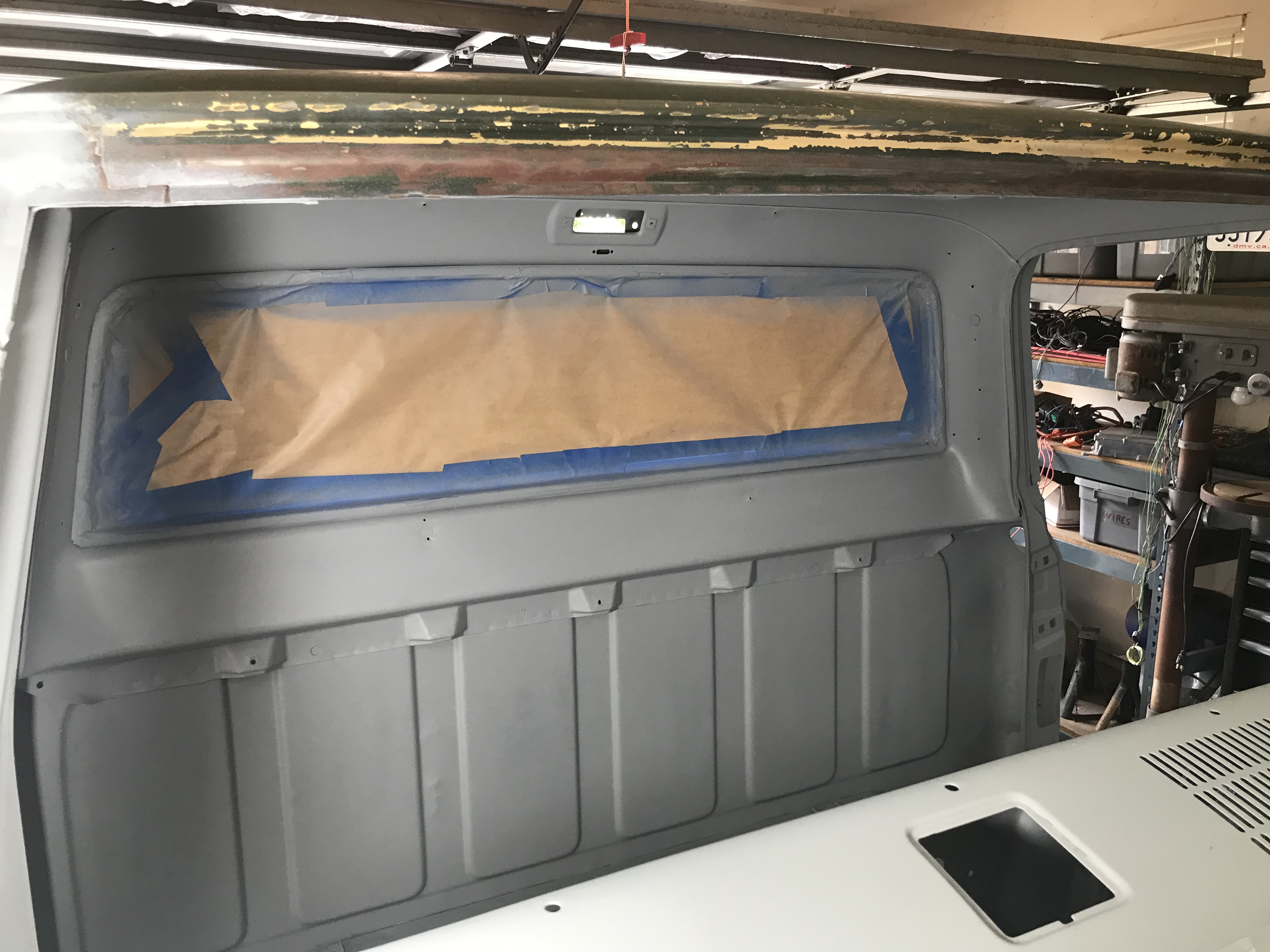

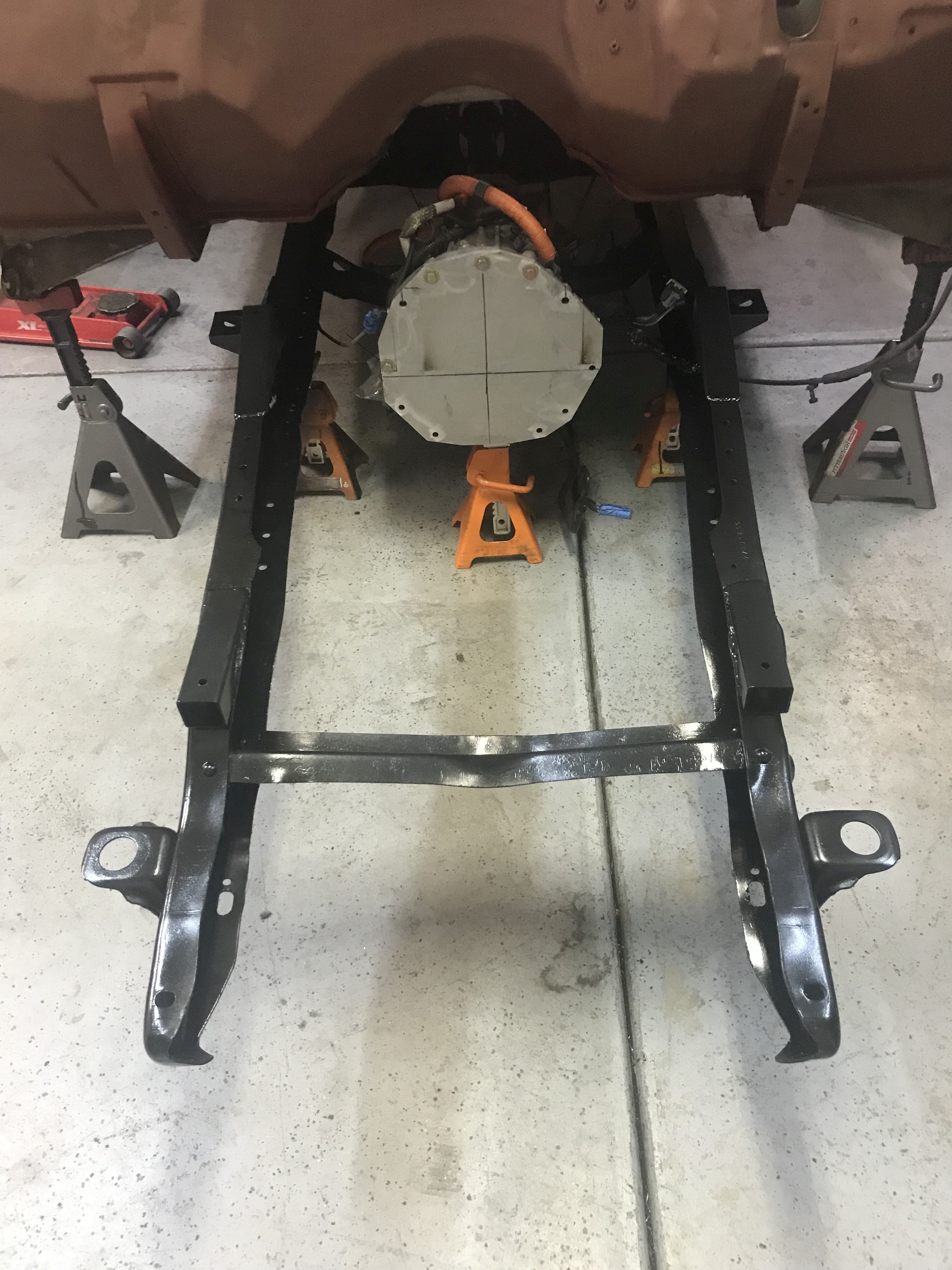

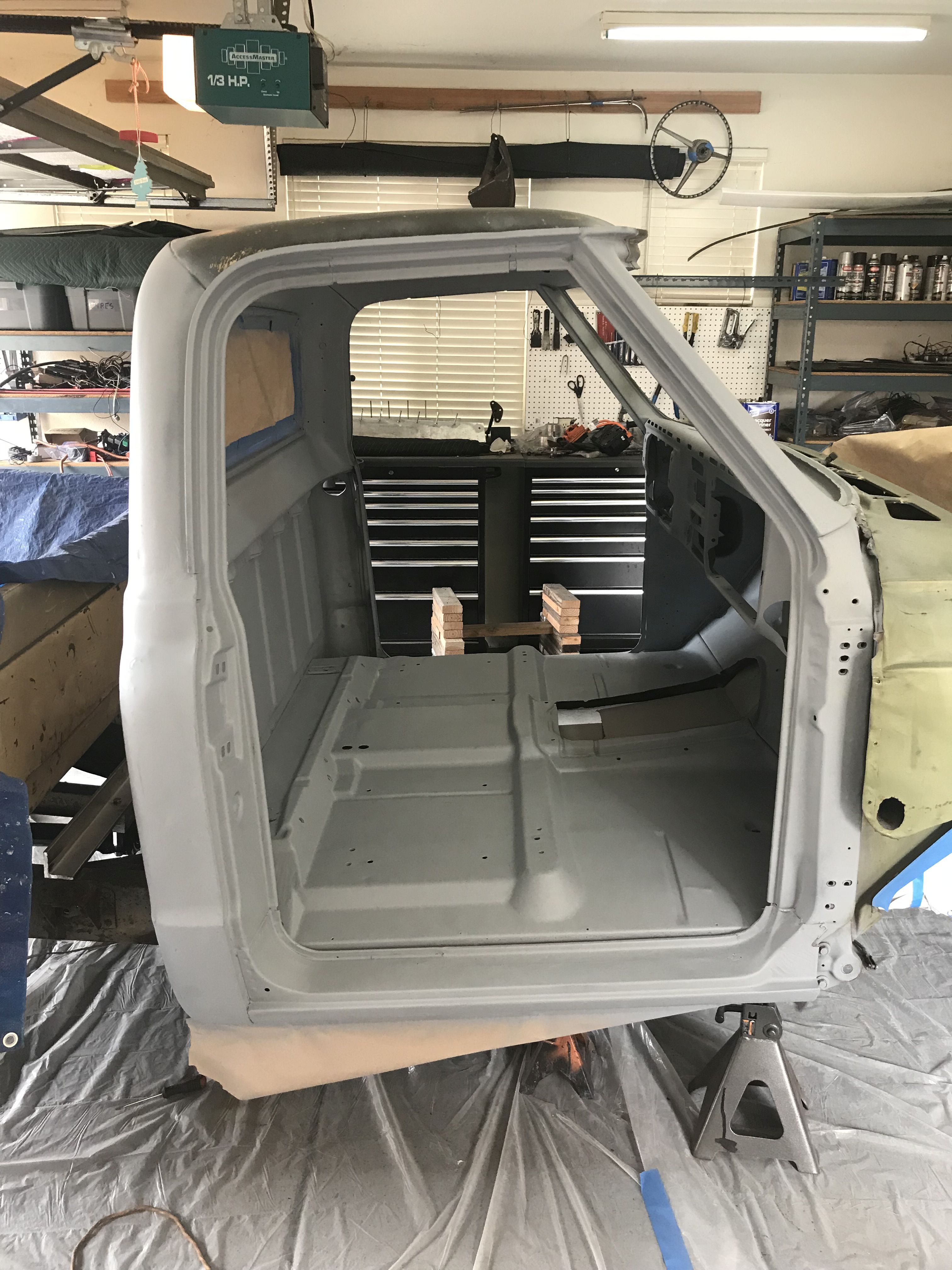

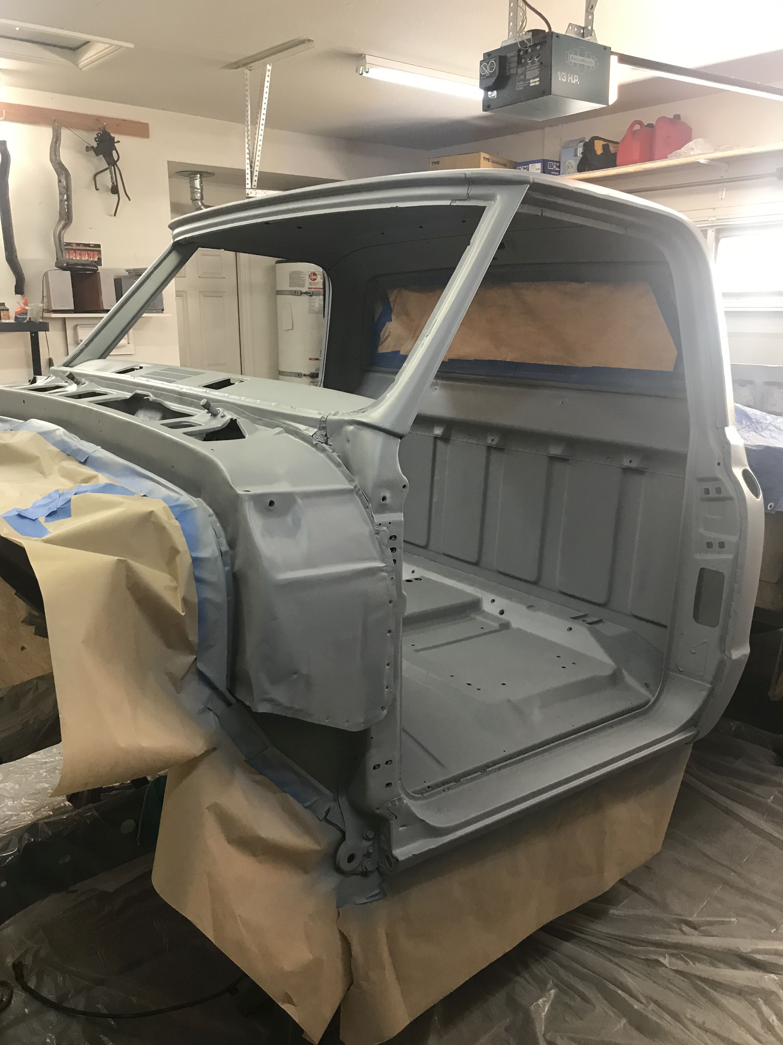

so I made the frame black and I love how it turned out and how clean and shinny it is
TheSilverBuick
Posts: 187
Post by TheSilverBuick »
Factory fresh.
Gregski
Posts: 3158
Post by Gregski »
fiddy shades of gray
muehlpower
Posts: 807
Has thanked: 18 times
Been thanked: 186 times
Post by muehlpower »

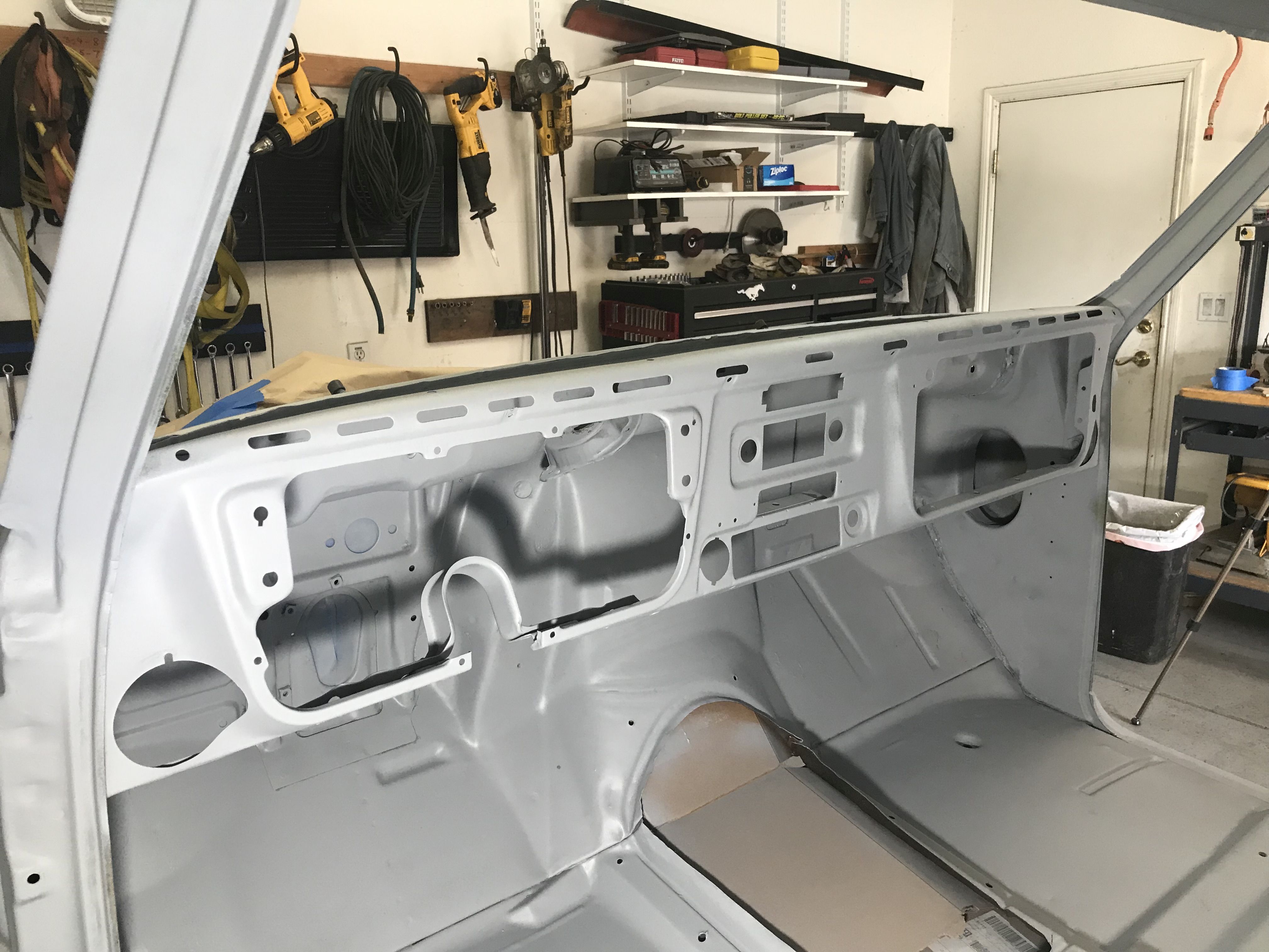

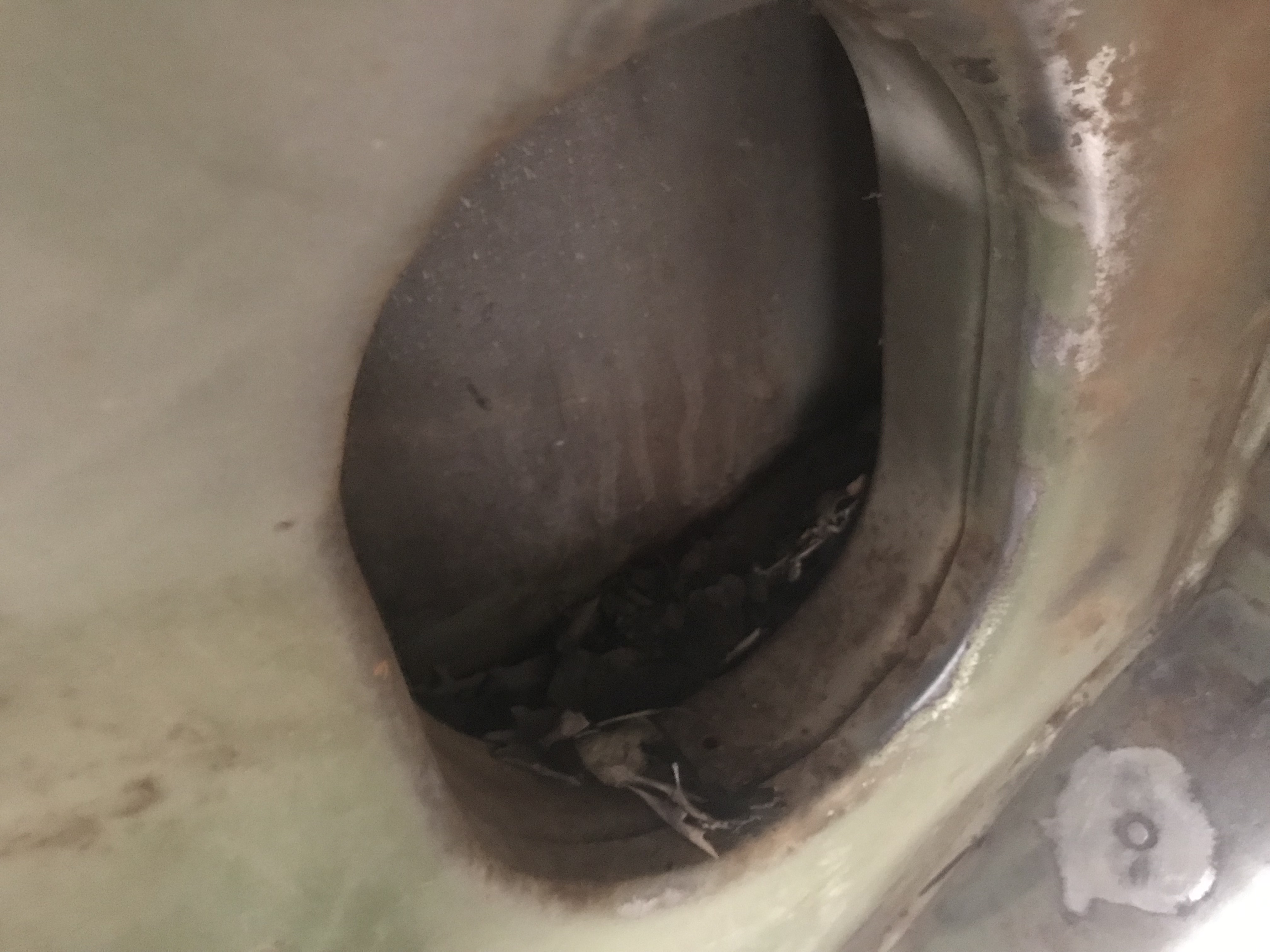

What do you want to do with the gas filling opening and the space for the gastank?
Gregski
Posts: 3158
Post by Gregski »
muehlpower wrote: Sun May 15, 2022 9:05 amWhat do you want to do with the gas filling opening and the space for the gastank?
at 5'11" and a half, I like to pretend that I'm tall so I sit further back, therefor I am installing custom bucket seats and not going with the original bench seat that this truck came with, so the space behind the seats where the fuel tank hung will be used up with the seats and maybe some storage for a banana or two
as far as the fuel filler inlet hole, I still haven't decided if I will weld that up or actually use it as a charge port
did you have some ideas?

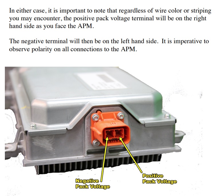

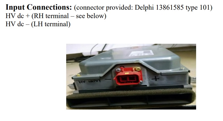

so let me tell you about my First Setback and you tell me if I am entirely at fault. I may have broken my Chevy Volt first gen DC-DC converter.
I know I looked up the input connection to make sure I had the positive and negative correct, I have the PDFs to prove it

observing the polarity from above I installed a 20 amp fuse on the positive wire, or what I thought was the positive wire
but look what GM did to the intermediate wire that runs from the Converter to the high voltage Battery Pack
