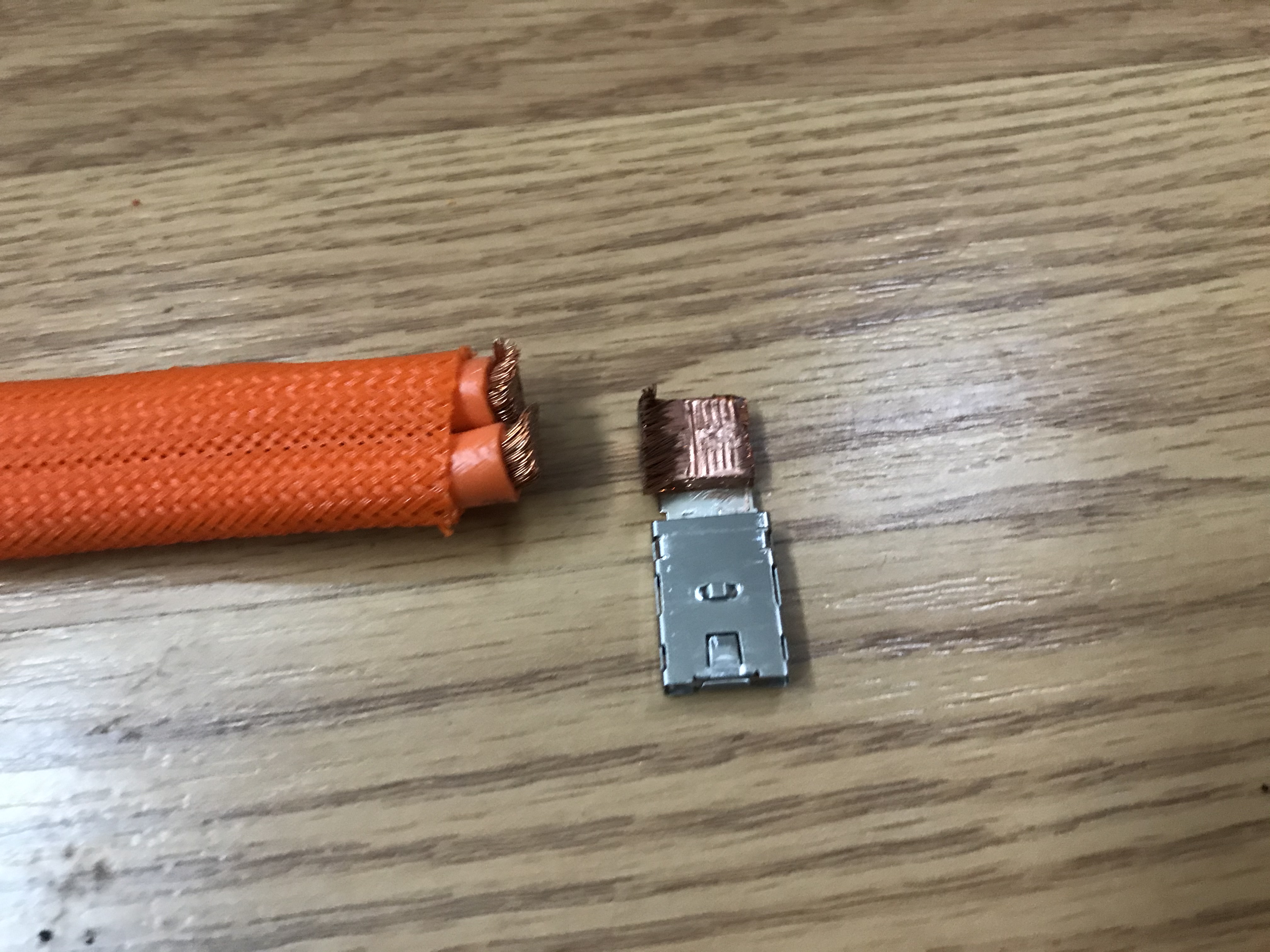

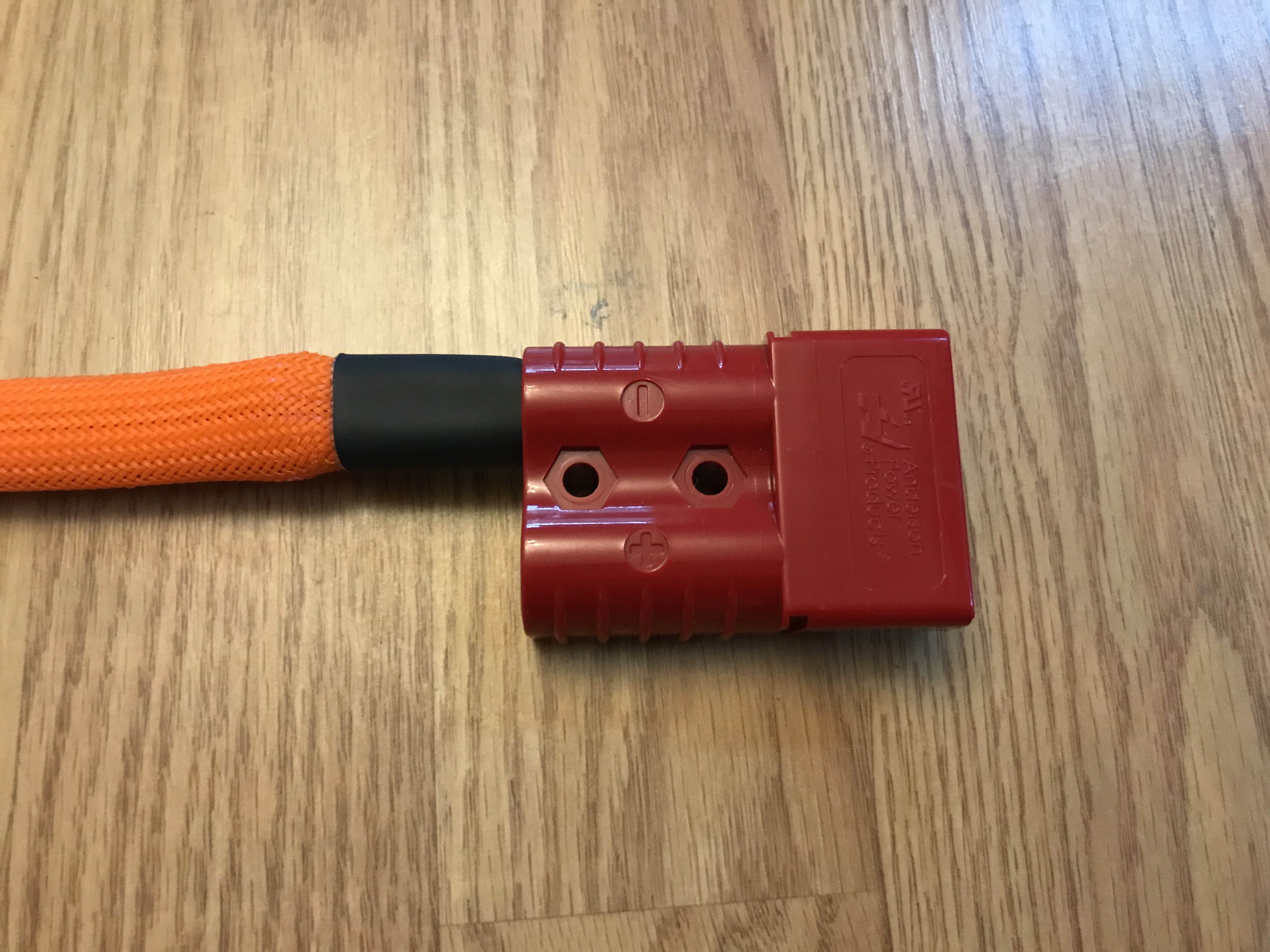

Maybe you cut the OEM cables in the middle, fit a copper ferrule on each end and crimp the extensions to it. Of course you need to put the joints in sleeves and orange tubing...
Or you could take a rigid copper tube and bend it to shape. Then crimp the OEM cables to it directly.
Gregski
Posts: 2720
Has thanked: 499 times
Been thanked: 945 times
Post by Gregski »
arber333 wrote: Wed May 04, 2022 6:36 am Maybe you cut the OEM cables in the middle, fit a copper ferrule on each end and crimp the extensions to it. Of course you need to put the joints in sleeves and orange tubing...
thank you for that suggestion, I have a second battery pack I am about to open so I can harvest some cables from there also, and for the time being for testing purposes I tried the Anderson connectors but not for cell module to cell module connections but for battery pack to charger or battery pack to converter type of temp hook em ups

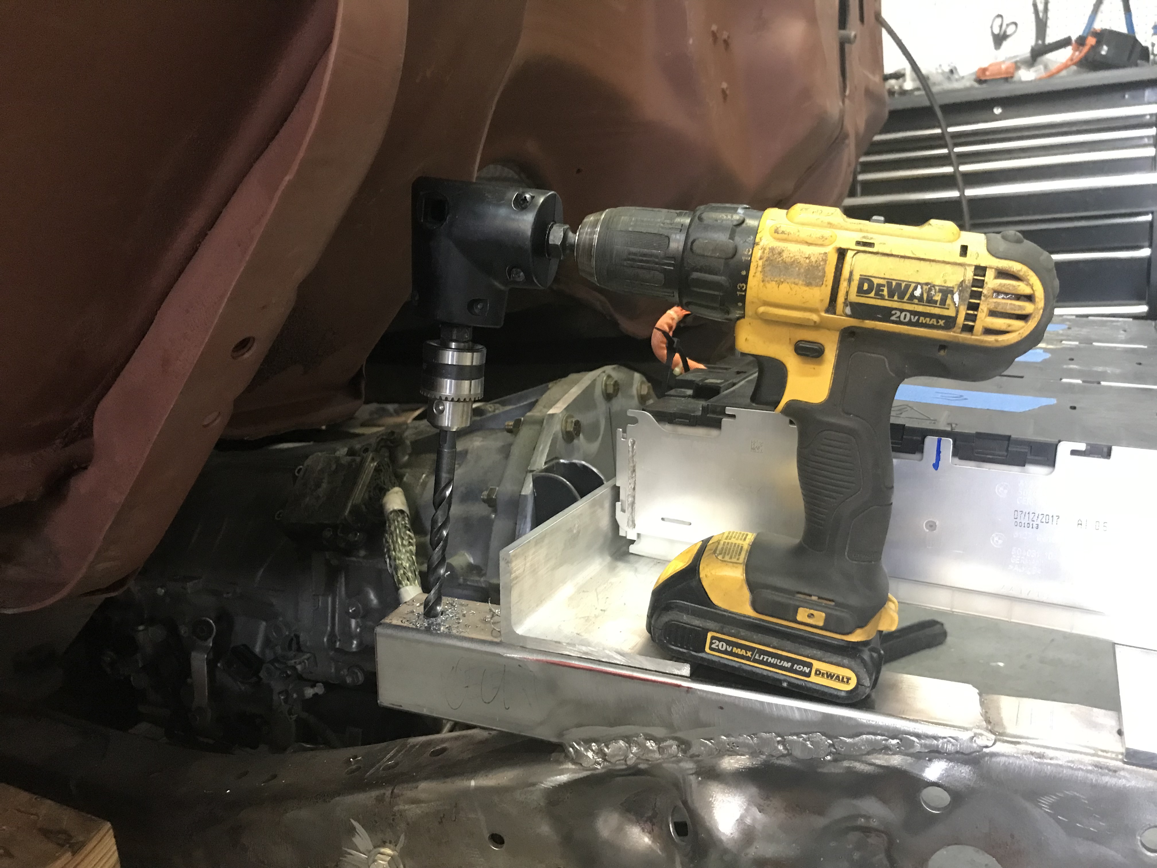

no I didn't just spend 4 hours drilling two holes in the most unreachable of places, who in their right mind designed these silly frame extensions?!?!

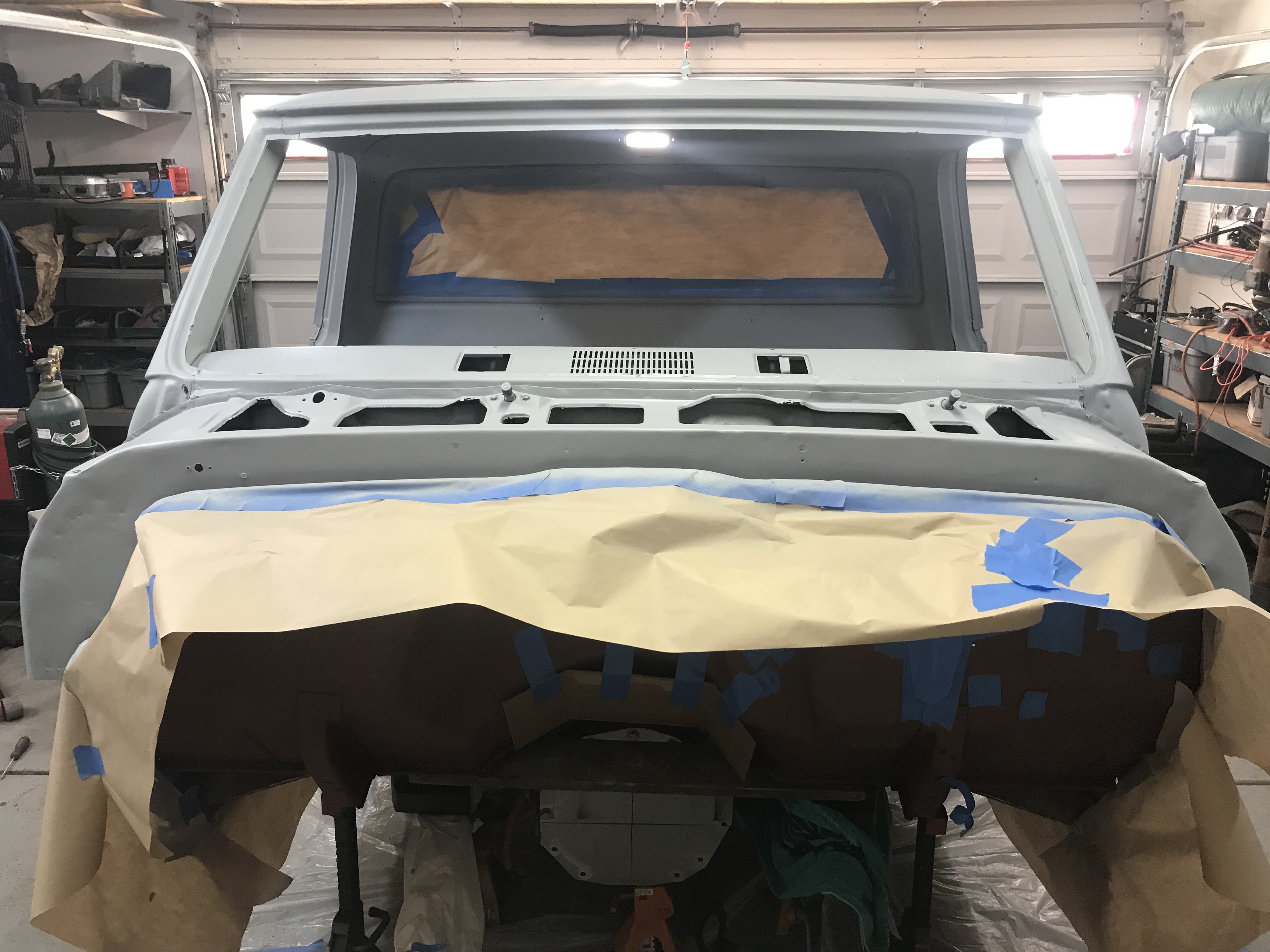

Post by Gregski »

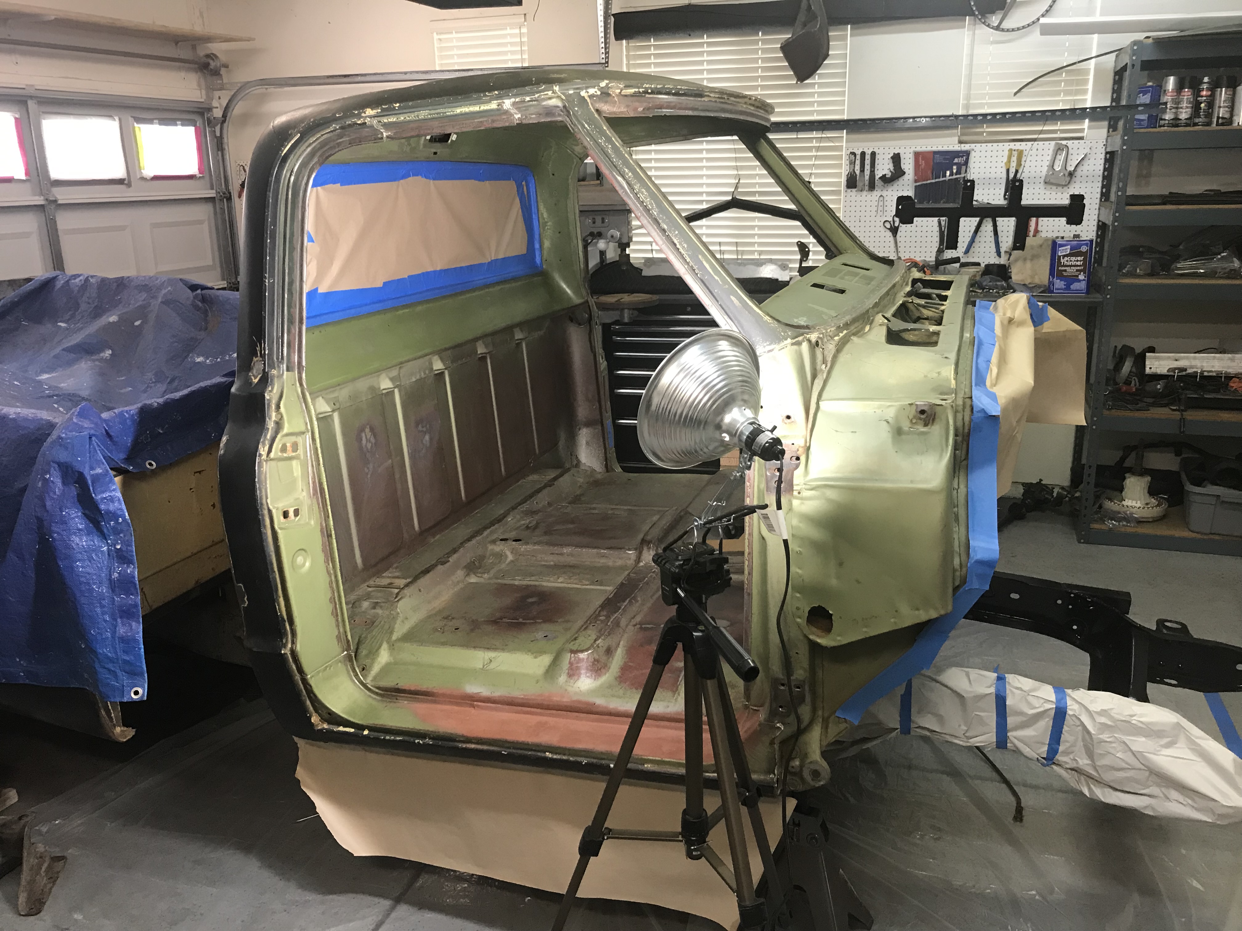

the transmission crossmember also got sum red luv in our outdoor free range organic make shift paint booth
Bonus Points for clever use of not only exhaust pipes but exhaust U clamps, not like we're going to be needing them again

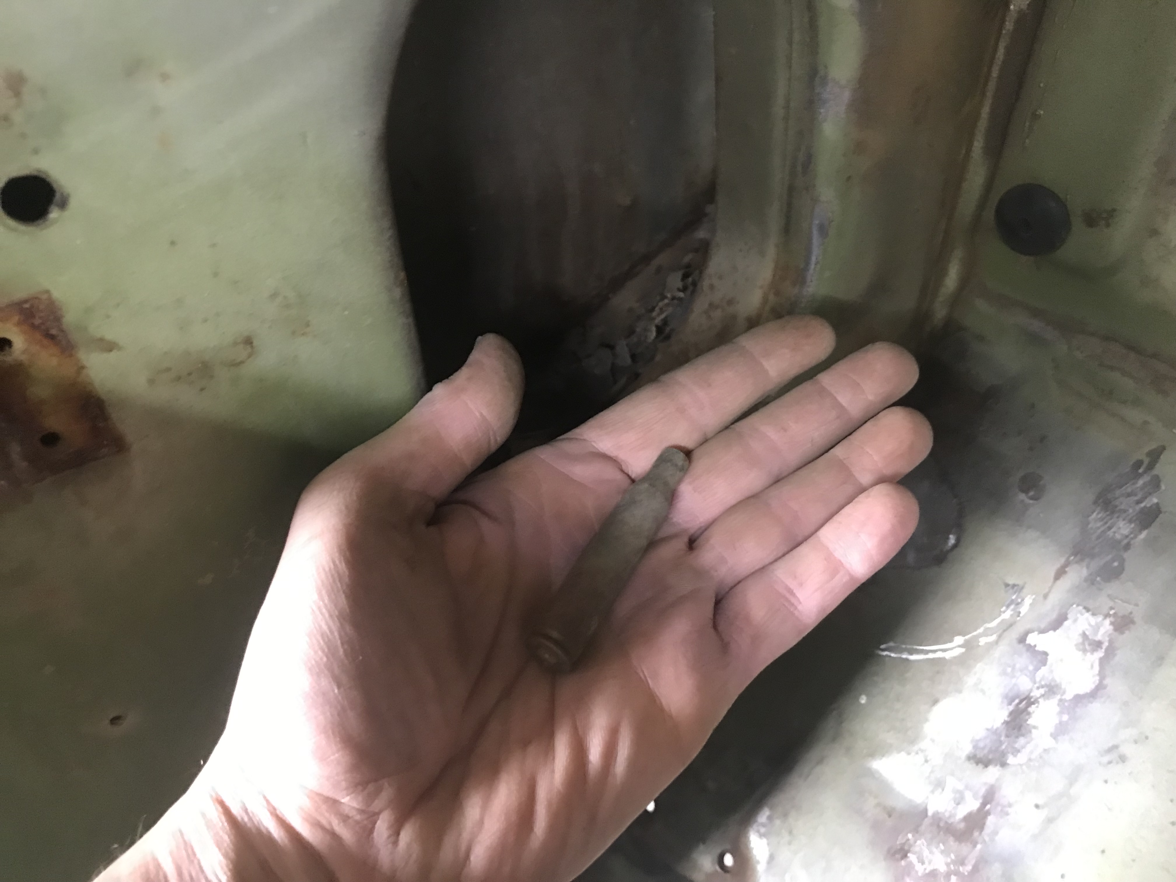

Nobody: What caliber is it?
Me: .270 Winchester cartridge first introduced as early as 1925 so it's going on a 100 years and it's still in production
TheSilverBuick
Posts: 187
Post by TheSilverBuick »
Have you checked behind the seat for the rifle?
Posts: 3563
Has thanked: 134 times
Been thanked: 335 times
Gregski wrote: Wed May 11, 2022 3:13 pm Nobody: What caliber is it?
Did you find the bullet in the rear seats too? :twisted:
Here in the EU we mainly joke about finding rotten sandwiches between the seats not ammo...

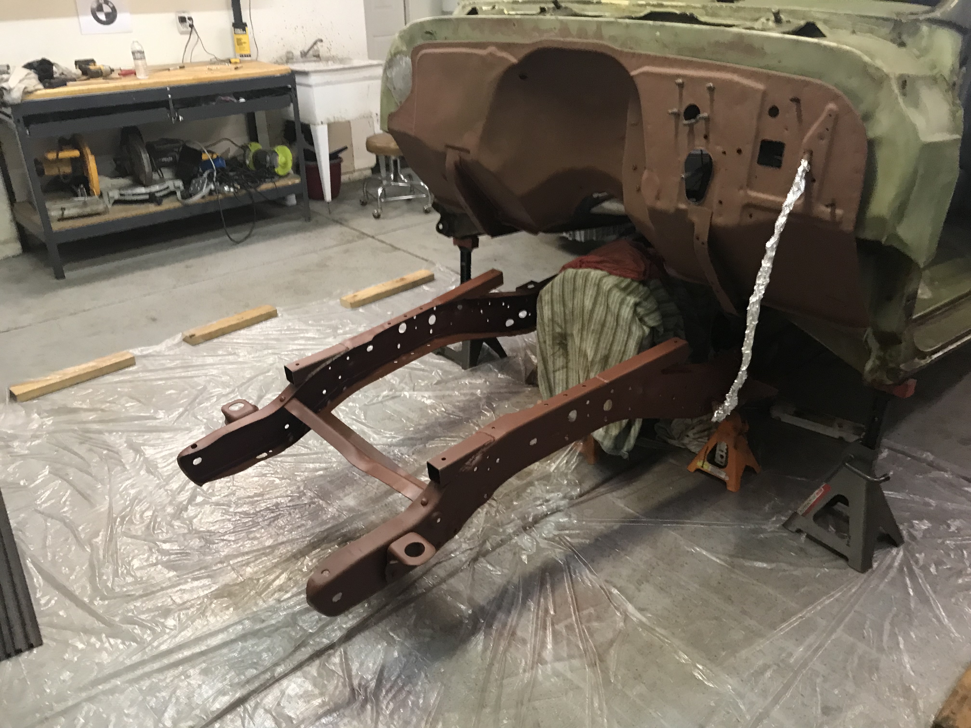

so I made the frame black and I love how it turned out and how clean and shinny it is
TheSilverBuick
Posts: 187
Factory fresh.

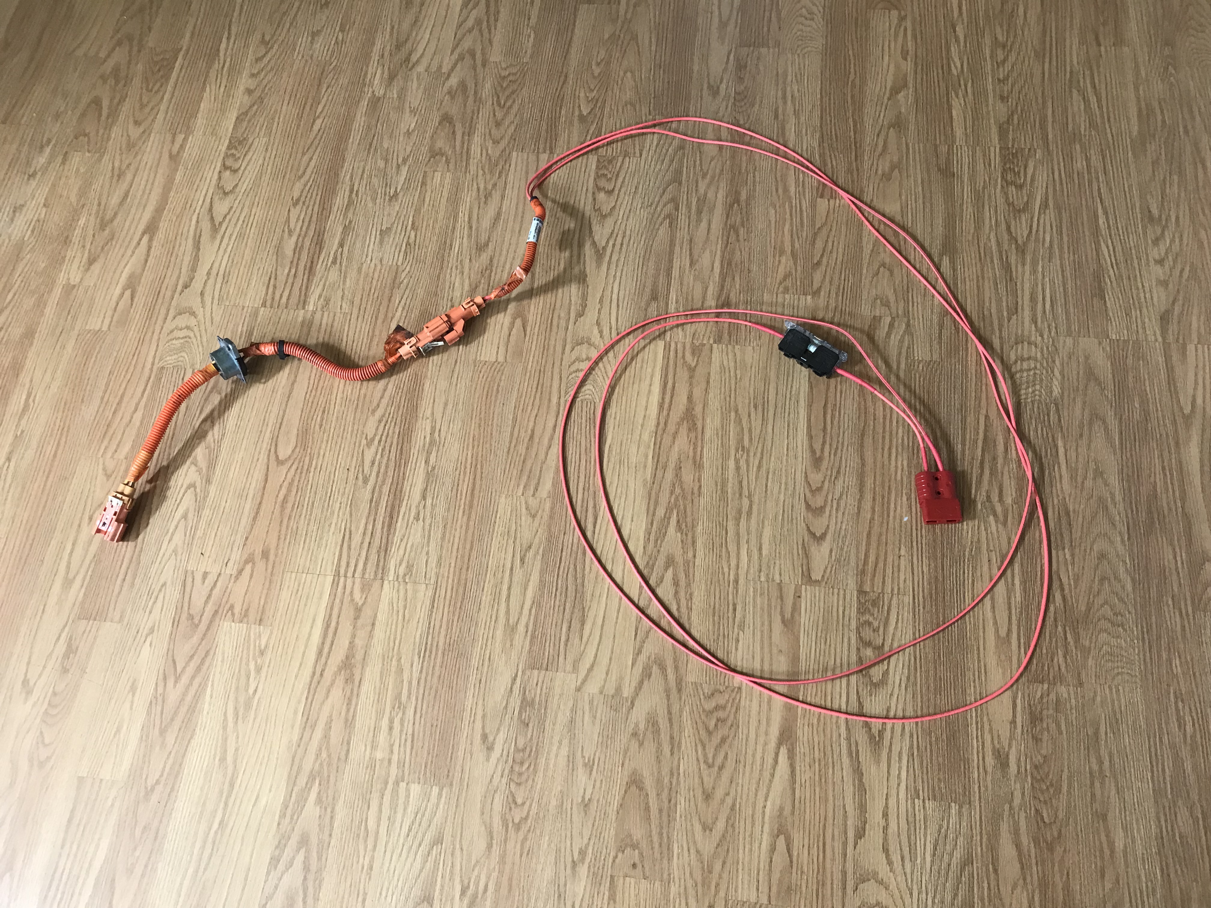

so let me tell you about my First Setback and you tell me if I am entirely at fault. I may have broken my Chevy Volt first gen DC-DC converter.
I know I looked up the input connection to make sure I had the positive and negative correct, I have the PDFs to prove it
Gregski
Posts: 2720
Post by Gregski »
observing the polarity from above I installed a 20 amp fuse on the positive wire, or what I thought was the positive wire
but look what GM did to the intermediate wire that runs from the Converter to the high voltage Battery Pack
