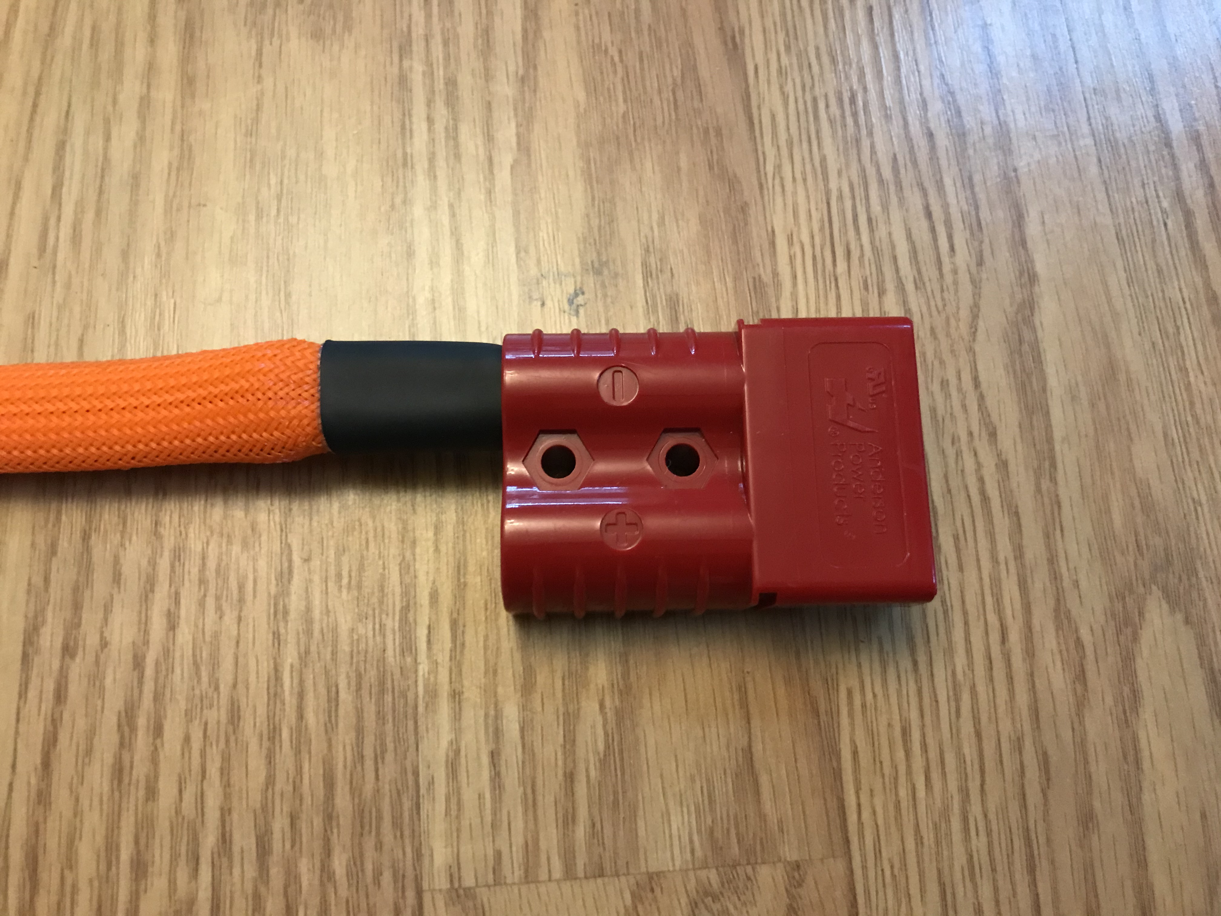

Maybe you cut the OEM cables in the middle, fit a copper ferrule on each end and crimp the extensions to it. Of course you need to put the joints in sleeves and orange tubing...
Or you could take a rigid copper tube and bend it to shape. Then crimp the OEM cables to it directly.
Gregski
Posts: 2873
Has thanked: 530 times
Been thanked: 1189 times
Post by Gregski »
arber333 wrote: Wed May 04, 2022 6:36 am Maybe you cut the OEM cables in the middle, fit a copper ferrule on each end and crimp the extensions to it. Of course you need to put the joints in sleeves and orange tubing...
thank you for that suggestion, I have a second battery pack I am about to open so I can harvest some cables from there also, and for the time being for testing purposes I tried the Anderson connectors but not for cell module to cell module connections but for battery pack to charger or battery pack to converter type of temp hook em ups

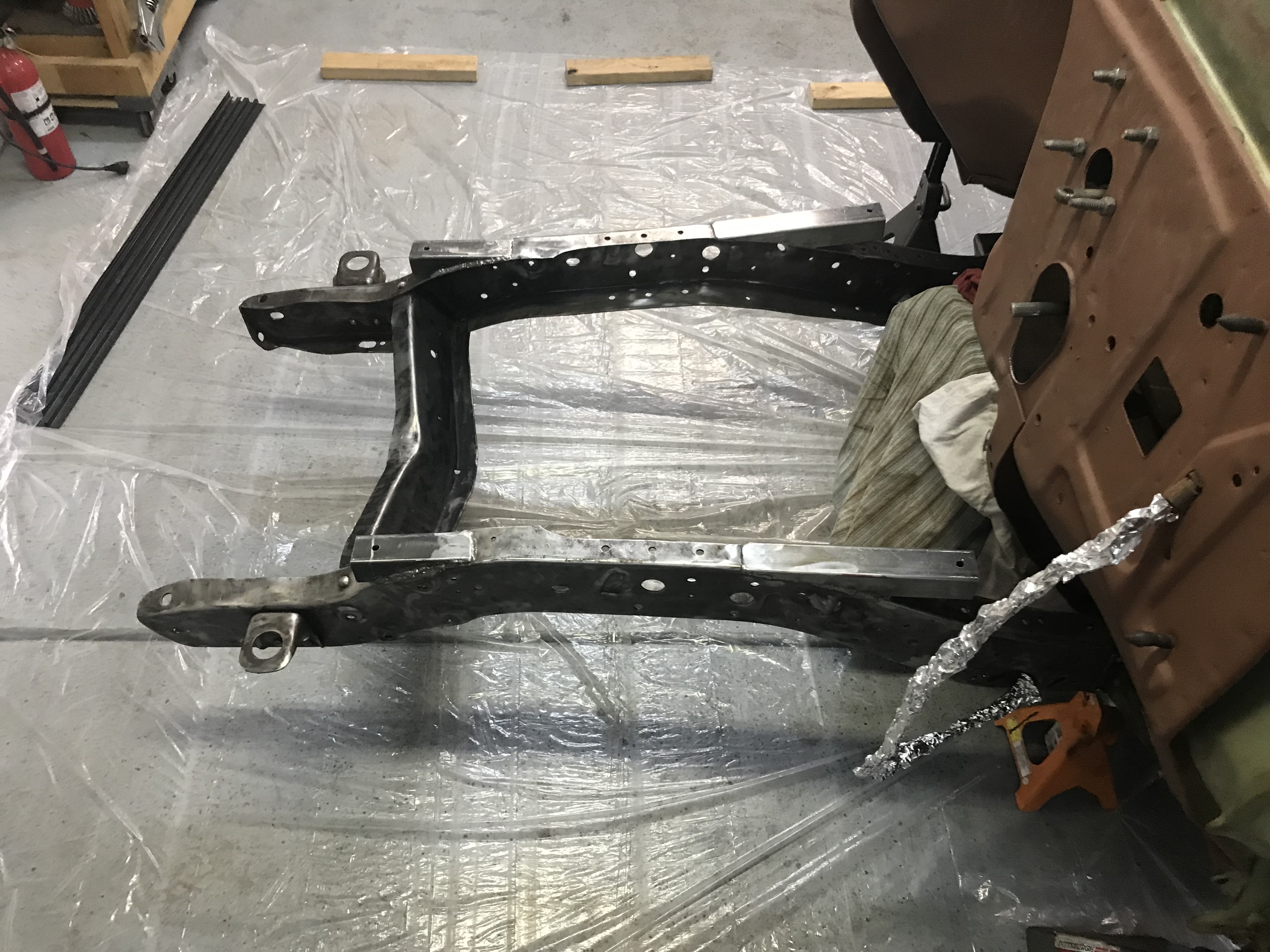

no I didn't just spend 4 hours drilling two holes in the most unreachable of places, who in their right mind designed these silly frame extensions?!?!

tell me you're done with Fab without telling me you're done with Fab
Gregski
Posts: 2873
Post by Gregski »
finally... no more Purple (sorry Prince, R.I.P.)

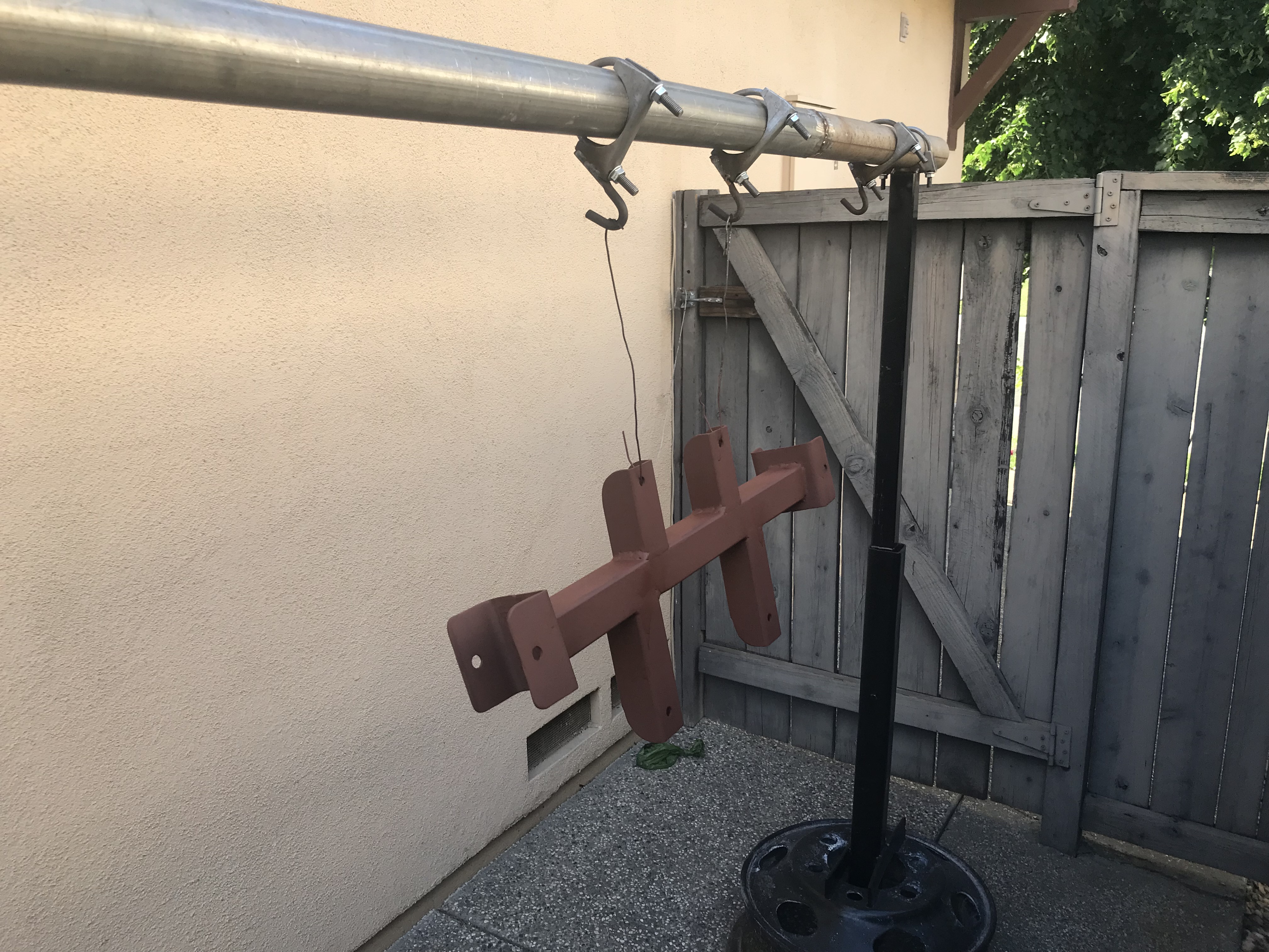

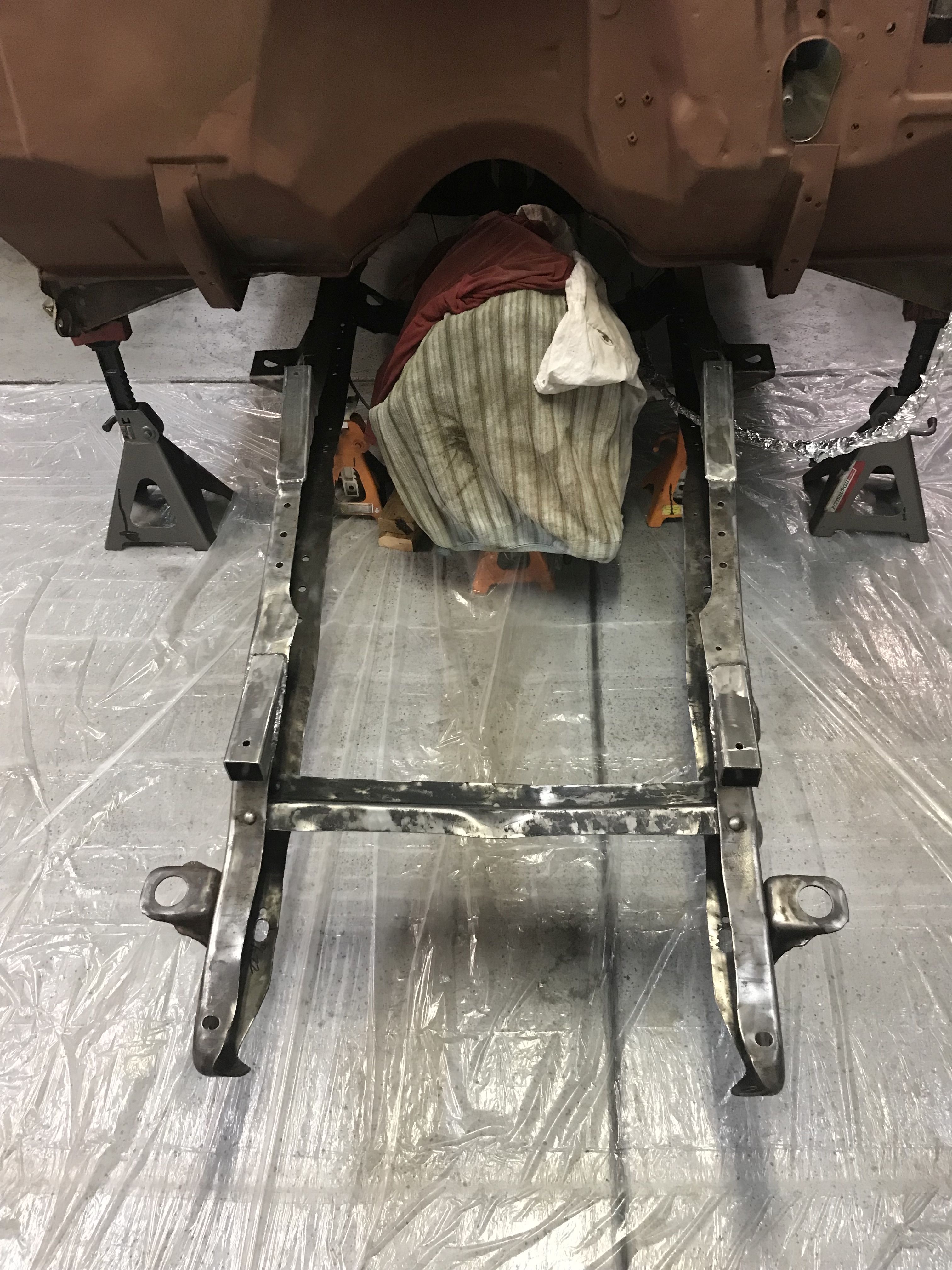

the transmission crossmember also got sum red luv in our outdoor free range organic make shift paint booth
Bonus Points for clever use of not only exhaust pipes but exhaust U clamps, not like we're going to be needing them again

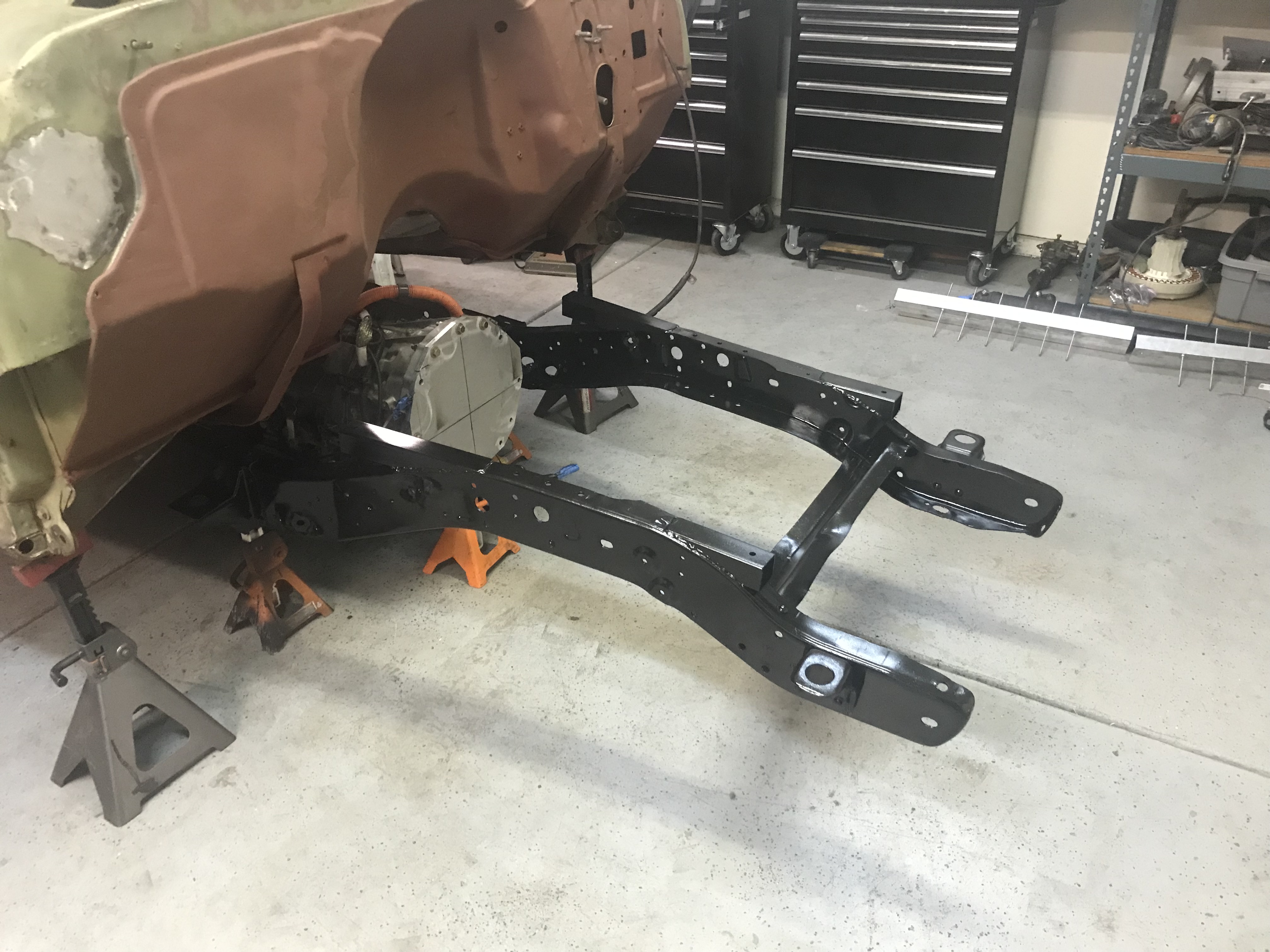

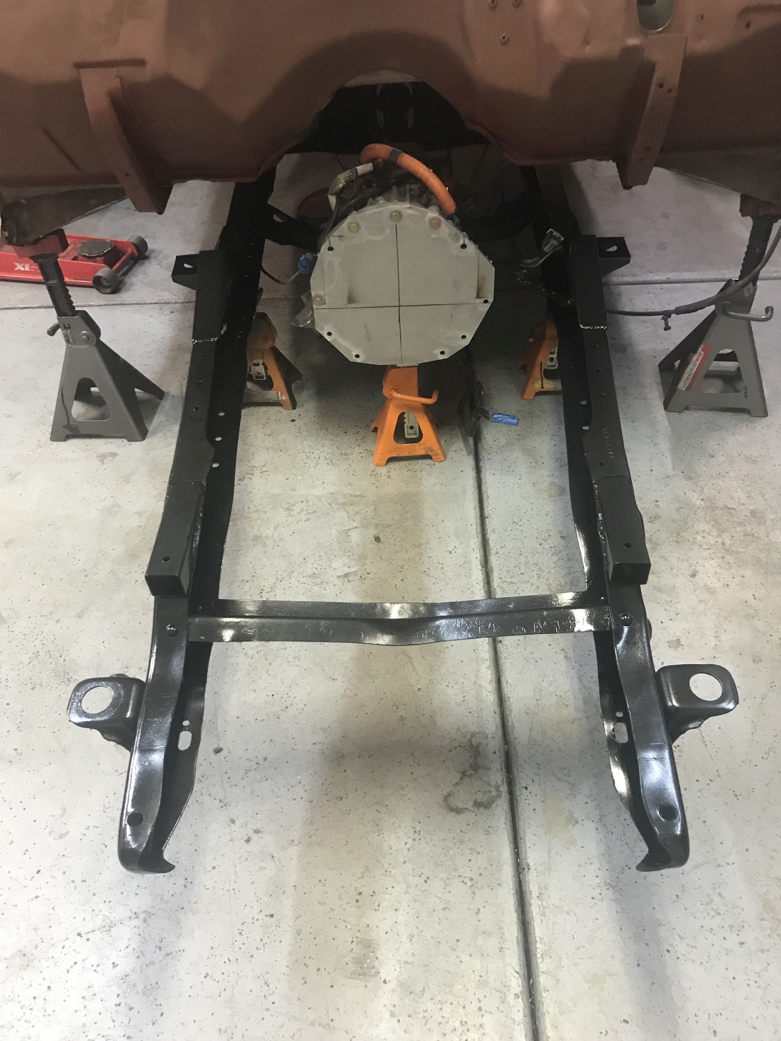

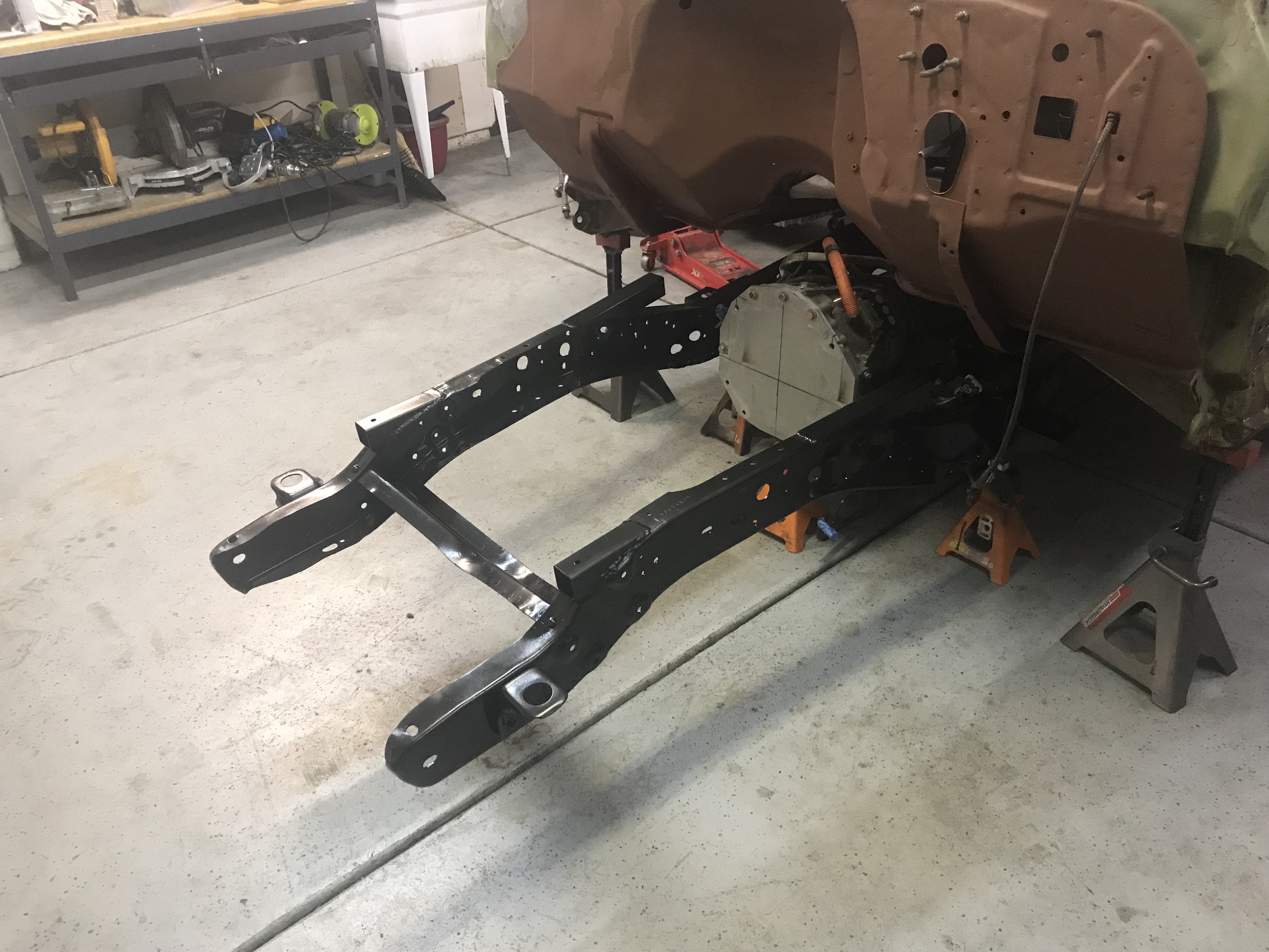

so I made the frame black and I love how it turned out and how clean and shinny it is

Post by muehlpower »
What do you want to do with the gas filling opening and the space for the gastank?
Gregski
Posts: 2873
Post by Gregski »
muehlpower wrote: Sun May 15, 2022 9:05 amWhat do you want to do with the gas filling opening and the space for the gastank?
at 5'11" and a half, I like to pretend that I'm tall so I sit further back, therefor I am installing custom bucket seats and not going with the original bench seat that this truck came with, so the space behind the seats where the fuel tank hung will be used up with the seats and maybe some storage for a banana or two
as far as the fuel filler inlet hole, I still haven't decided if I will weld that up or actually use it as a charge port
did you have some ideas?

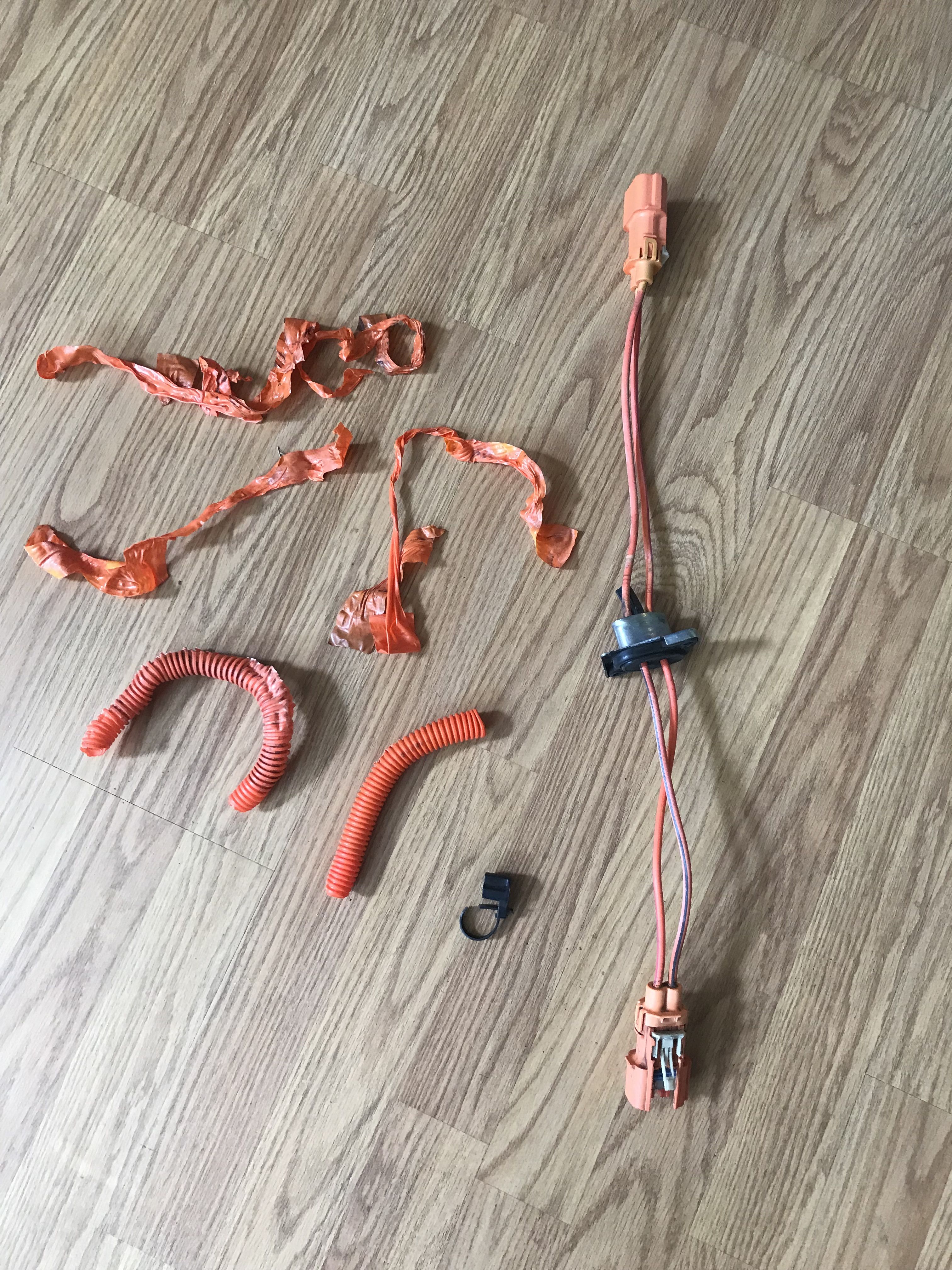

so let me tell you about my First Setback and you tell me if I am entirely at fault. I may have broken my Chevy Volt first gen DC-DC converter.
I know I looked up the input connection to make sure I had the positive and negative correct, I have the PDFs to prove it
Gregski
Posts: 2873
Post by Gregski »
observing the polarity from above I installed a 20 amp fuse on the positive wire, or what I thought was the positive wire
but look what GM did to the intermediate wire that runs from the Converter to the high voltage Battery Pack
