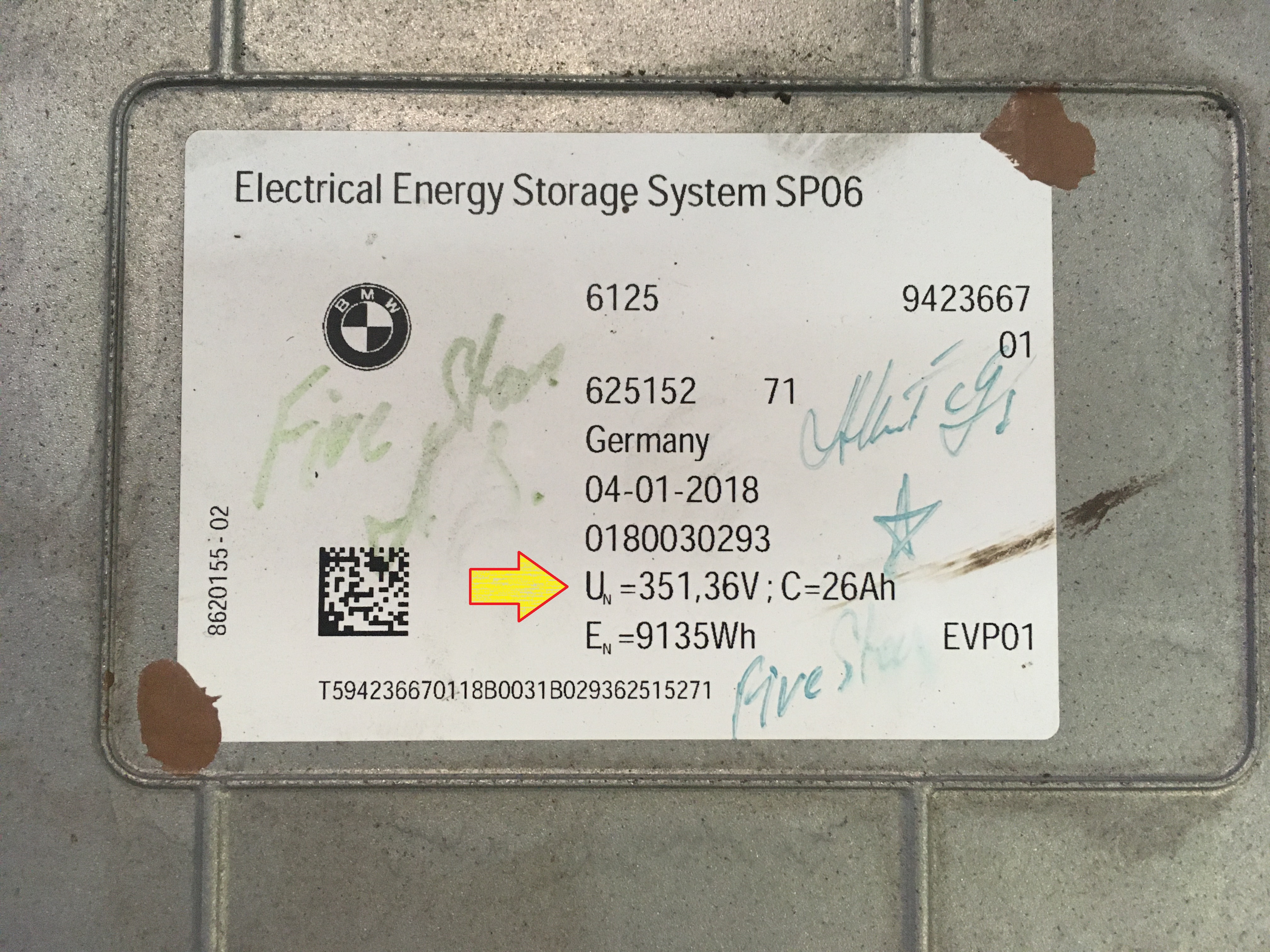

this is a 2018 BMW 530e hybrid battery pack
why the hell does that say U=
The letter "U", often used to denote voltage supply, is said to be derived from the German word "Unterschied" which means "difference". This loosely implies "voltage difference" which may be used to help understand the meaning of the use of the letter "U" for the power supply to these types of electrical equipment.

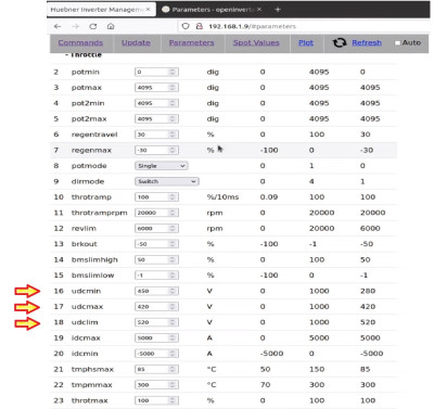

Oh, I will...

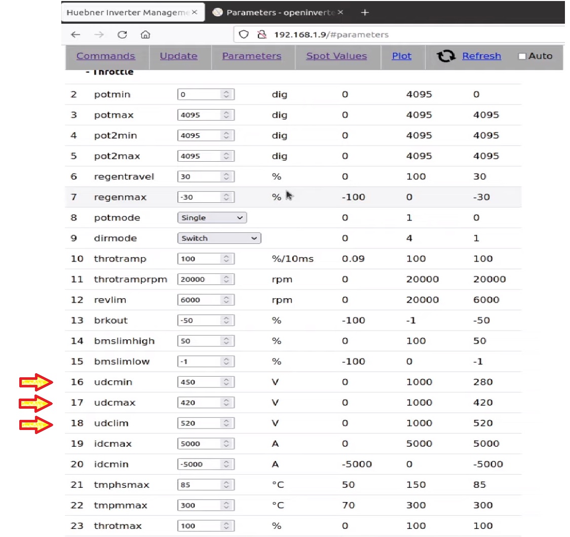

The "Us" further manifest themselves throughout the Open Inverter web interface software
udcmin - [pronounced: fuel tank is empty] battery pack minimum voltage the VCU will still request torque at
udcmax - [pronounced: stop over squeezing, the gas pump has clicked already and your fuel tank is full] battery pack maximum voltage the VCU will allow the battery to be regened or charged to
udclim - [pronouced: Oh Shit!] the VCU will perform a Hard Shutdown of all systems to prevent badness

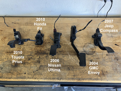

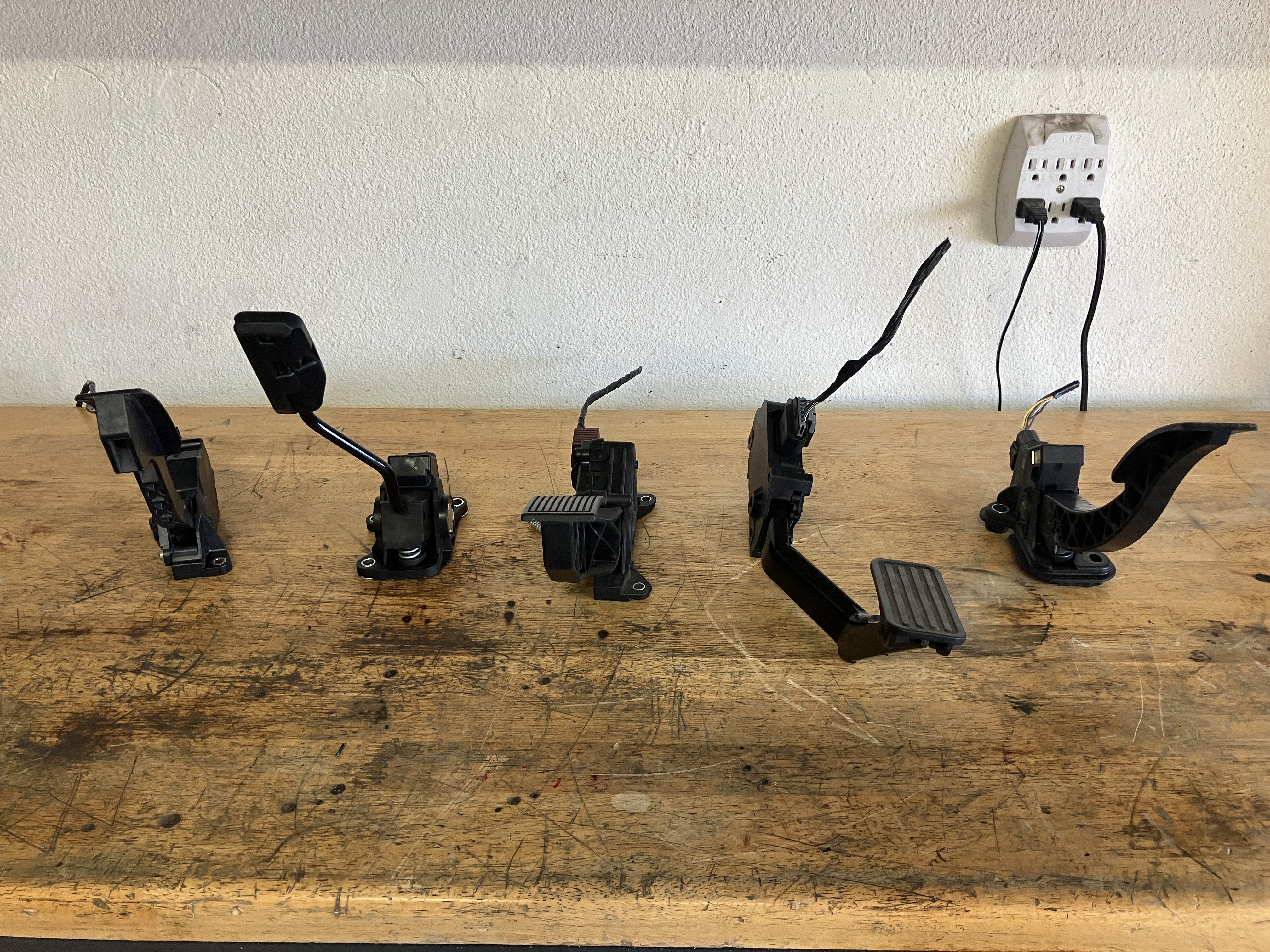

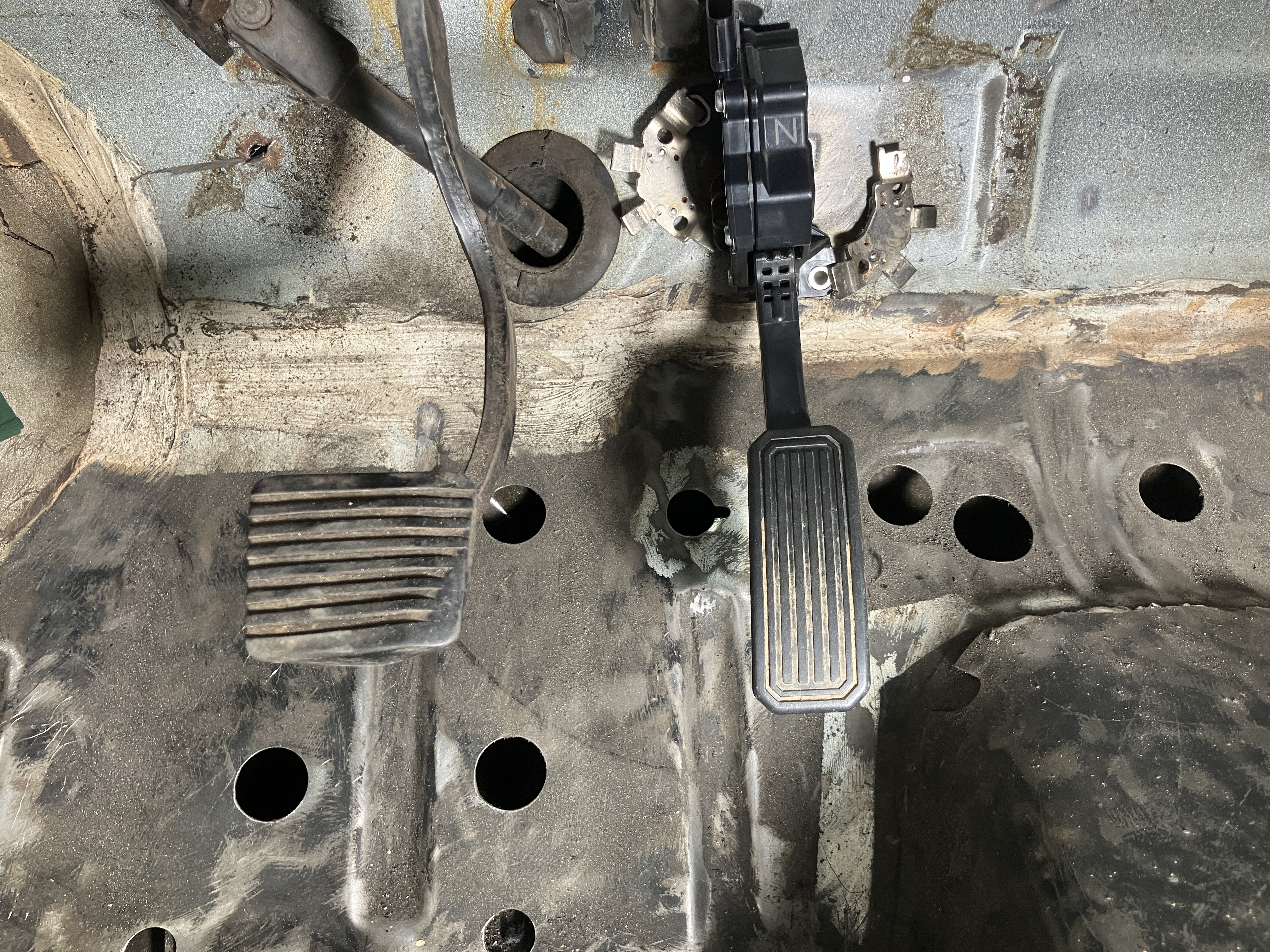

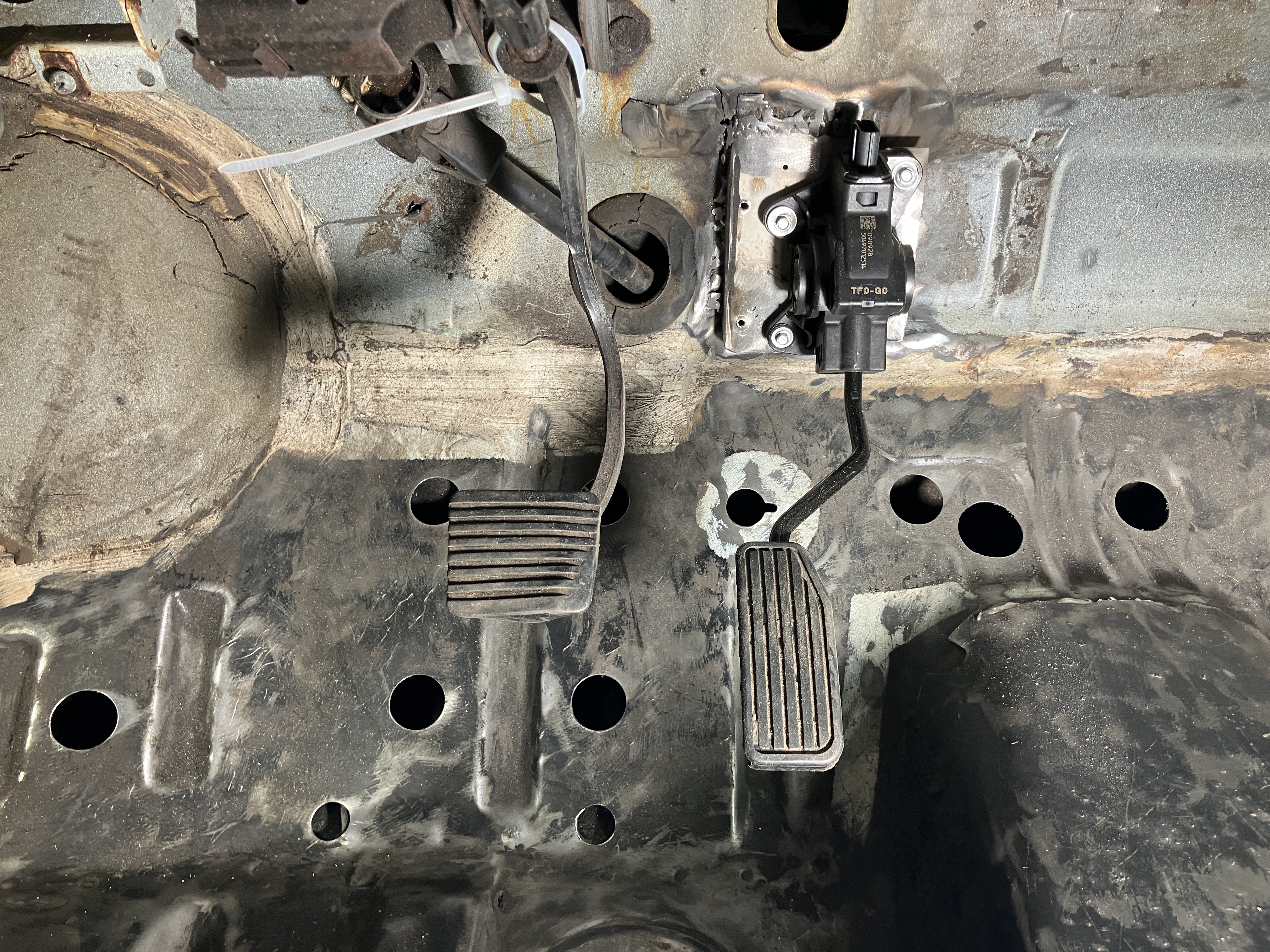

VW MK1 Rabbit Electric Throttle Install
- Gregski
- Posts: 3164
- Has thanked: 635 times
- Been thanked: 1610 times

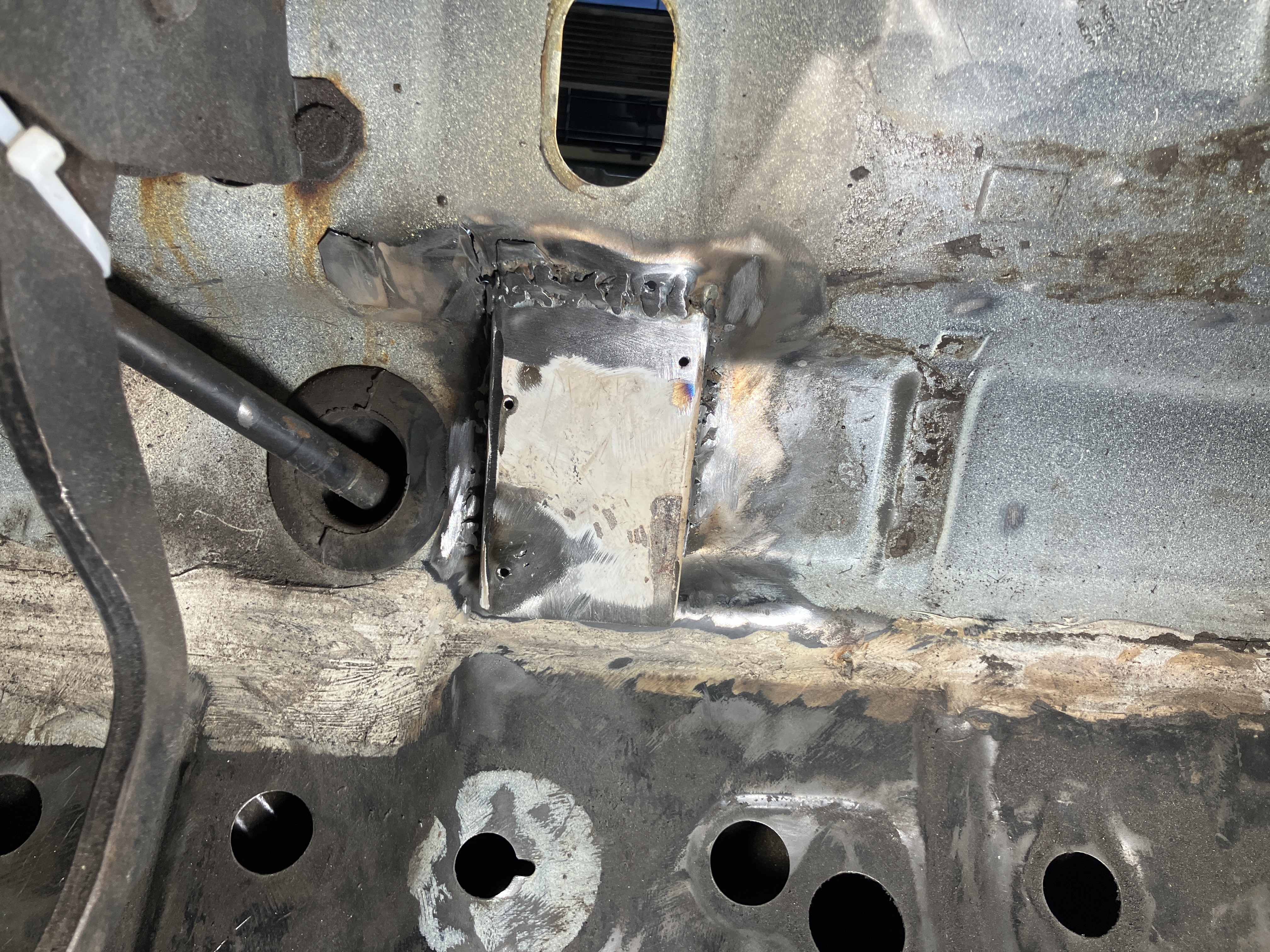

first we tried a 2010 Toyota Prius pedal to keep it in the family

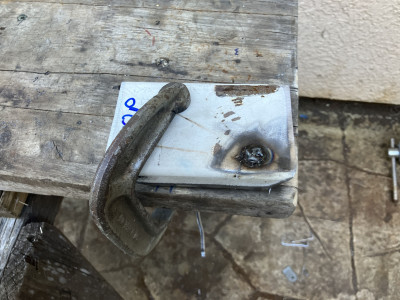

because of the wiggliness in the Rabbit firewall I had to make a block for an offset
nice thing about metal is that you can weld up the holes you don't want
- Gregski
- Posts: 3164
and then I decided to go with one that [ahem] fit, as in 2010 Honda Fit
- Posts: 1084
- Has thanked: 479 times
- Been thanked: 314 times
The first part of this video is solid gold. I hadn't considered that you didn't just pick a bunch of pedals, you chose ones that were all different. Maybe even on purpose!
I'm going to try to get around to adding that info to the wiki somewhere, I think a lot of people could benefit from it.

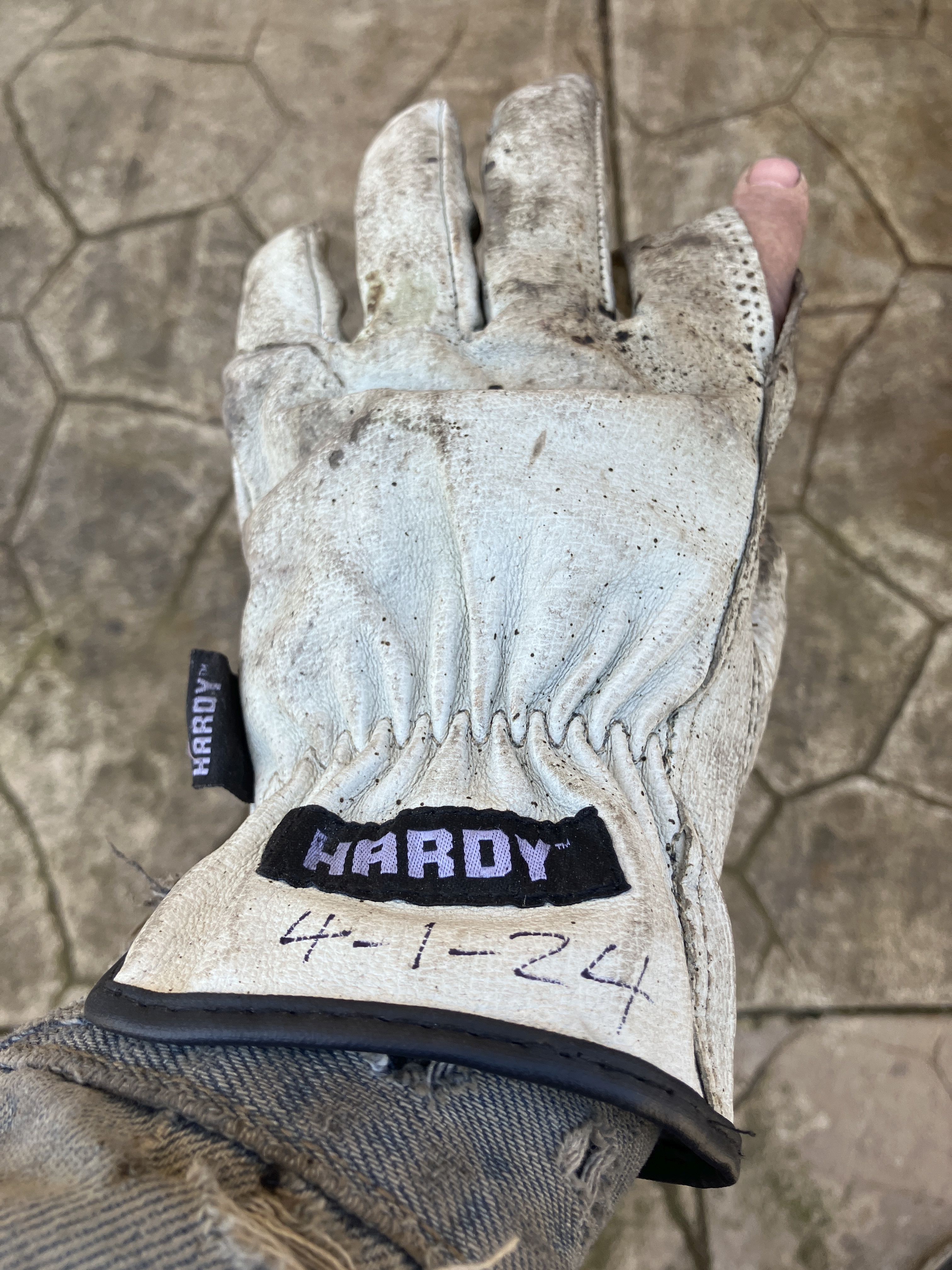

[rant]
last time my new leather gloves fell apart I knew something was off, I could have sworn I just bought them, so this time, I wrote the Born On Date on the new pair and check this out, they fell apart only one week later, or am I just working too hard and they can't keep up with my Chuck Norris like pace? what are your thoughts on parts and materials in current times ?
4-1-24 (that's Freedom format, so April 1st, 2024)
[/rant]
[/rant]

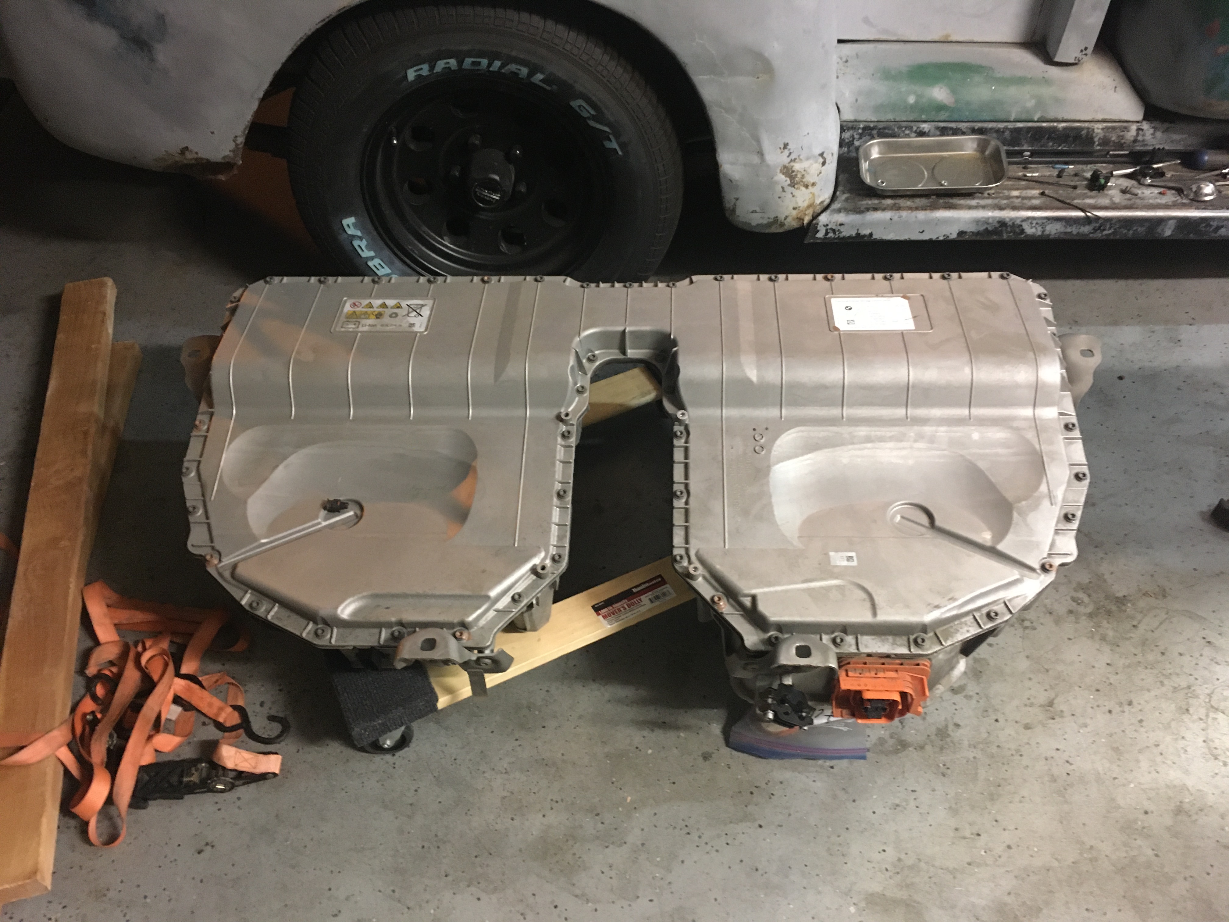

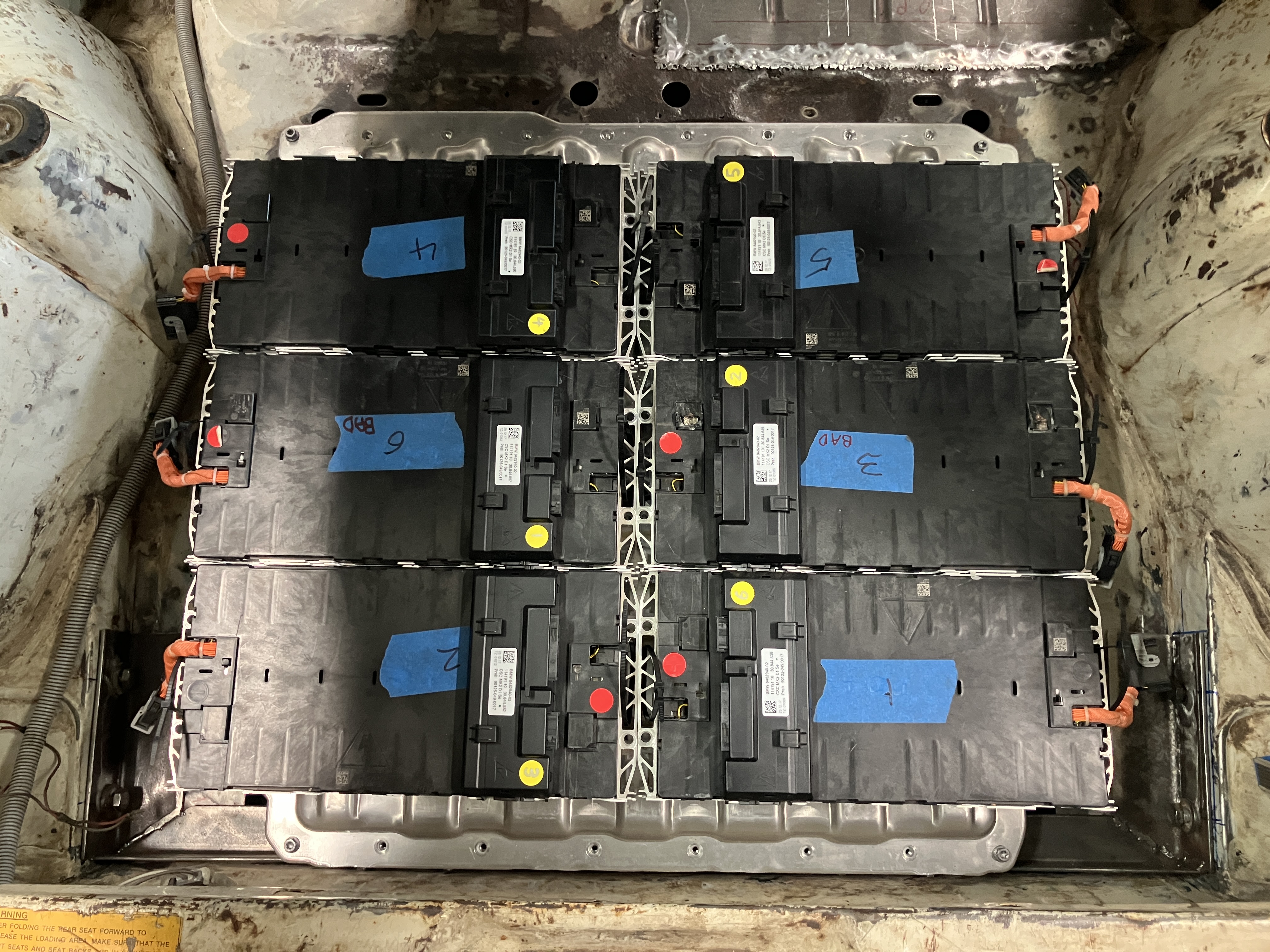

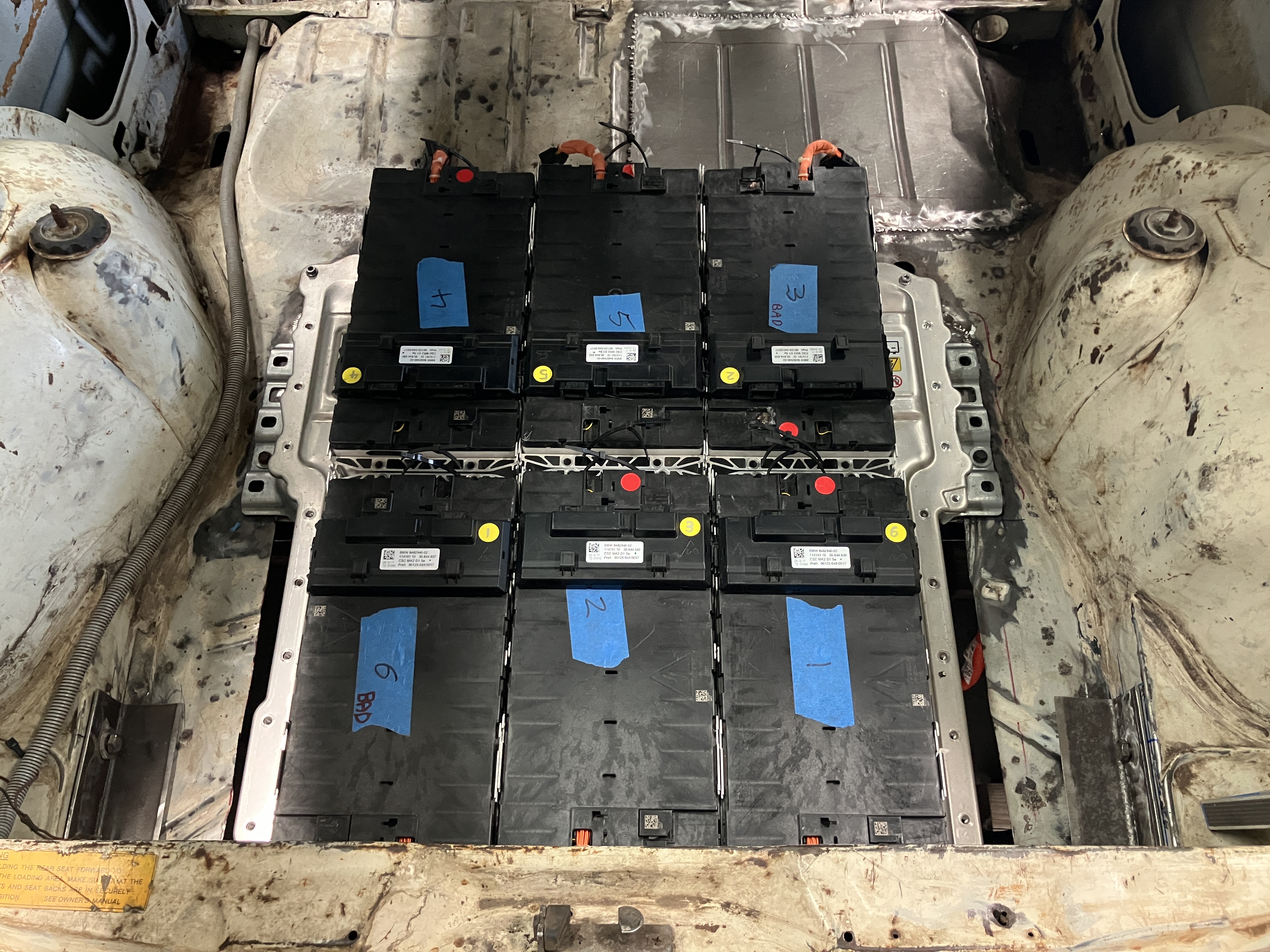

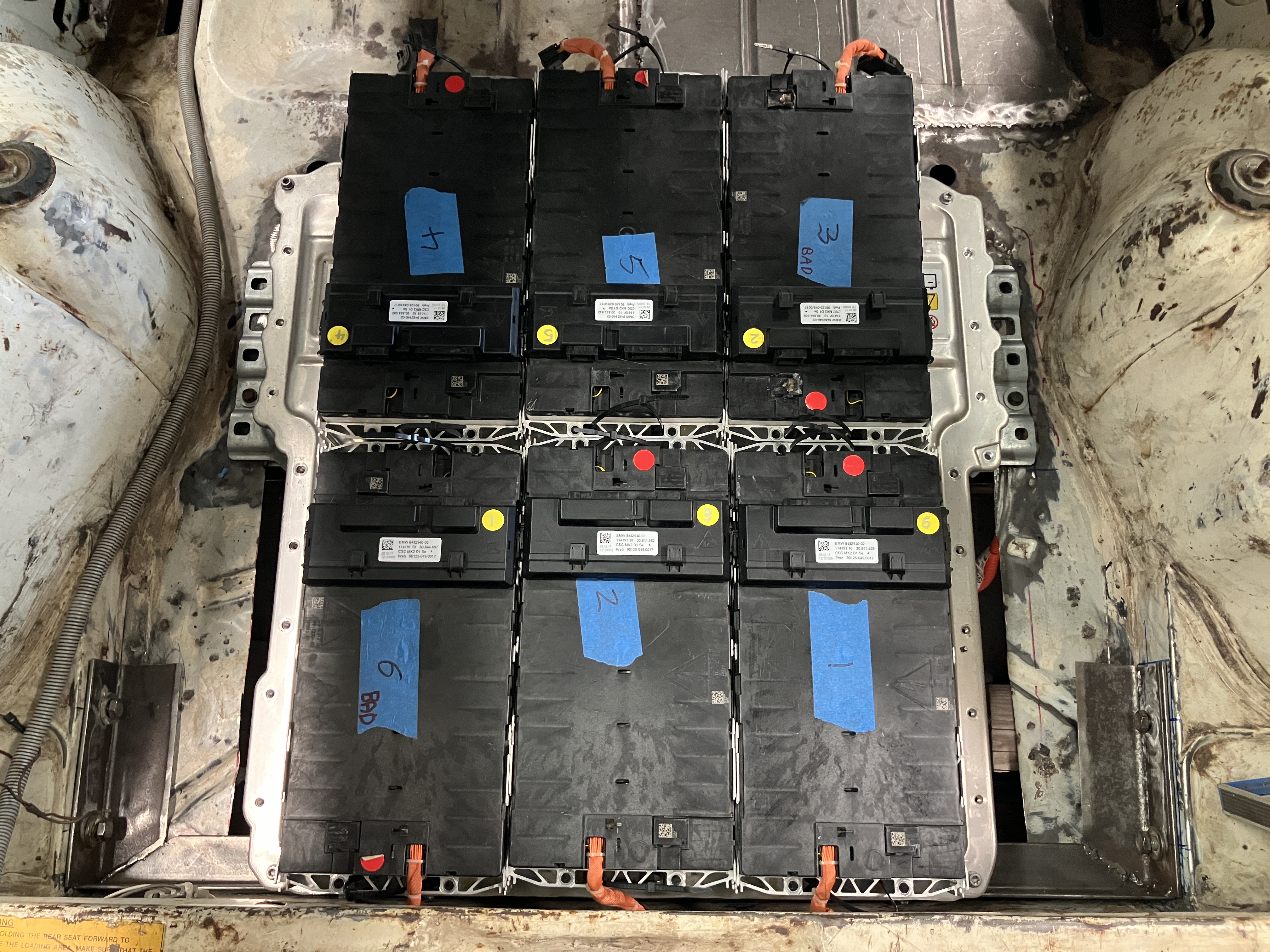

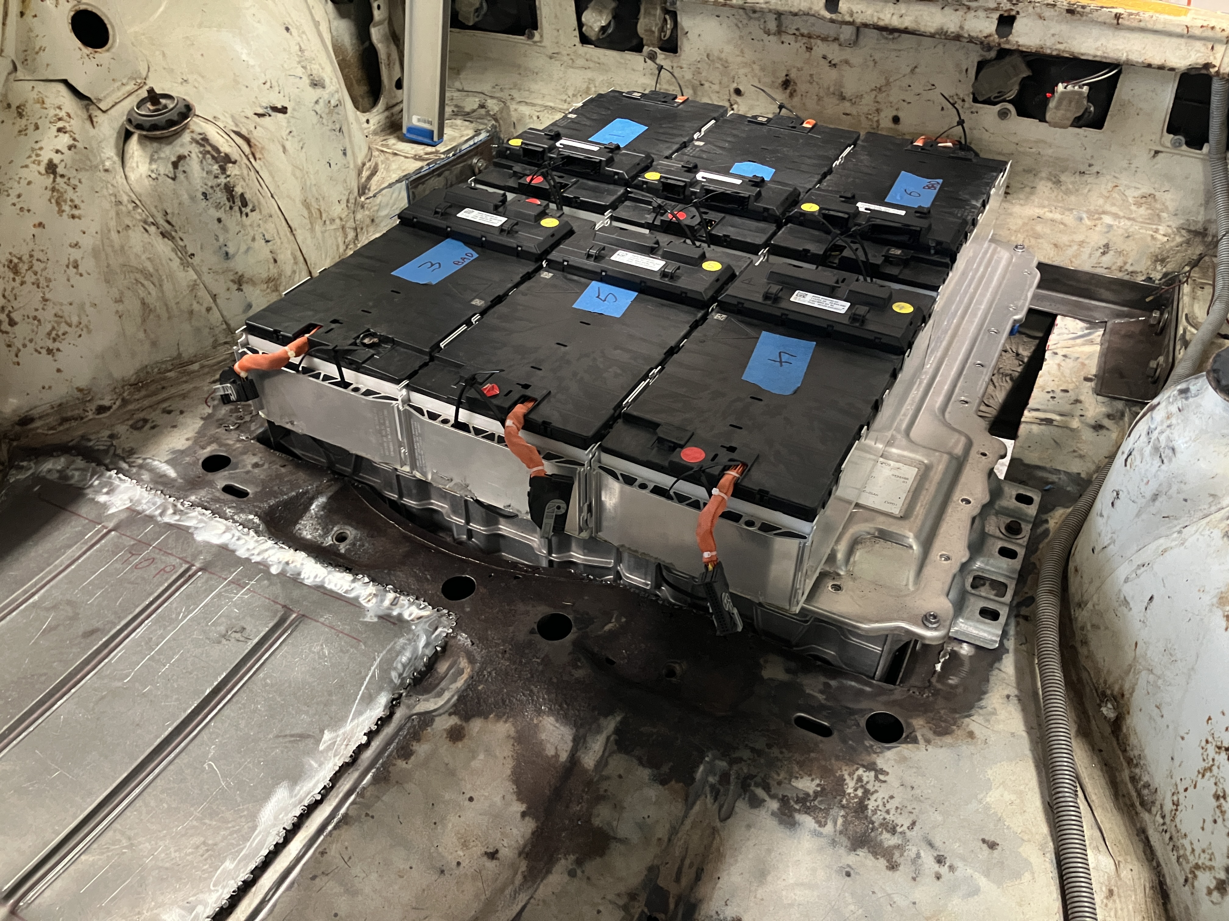

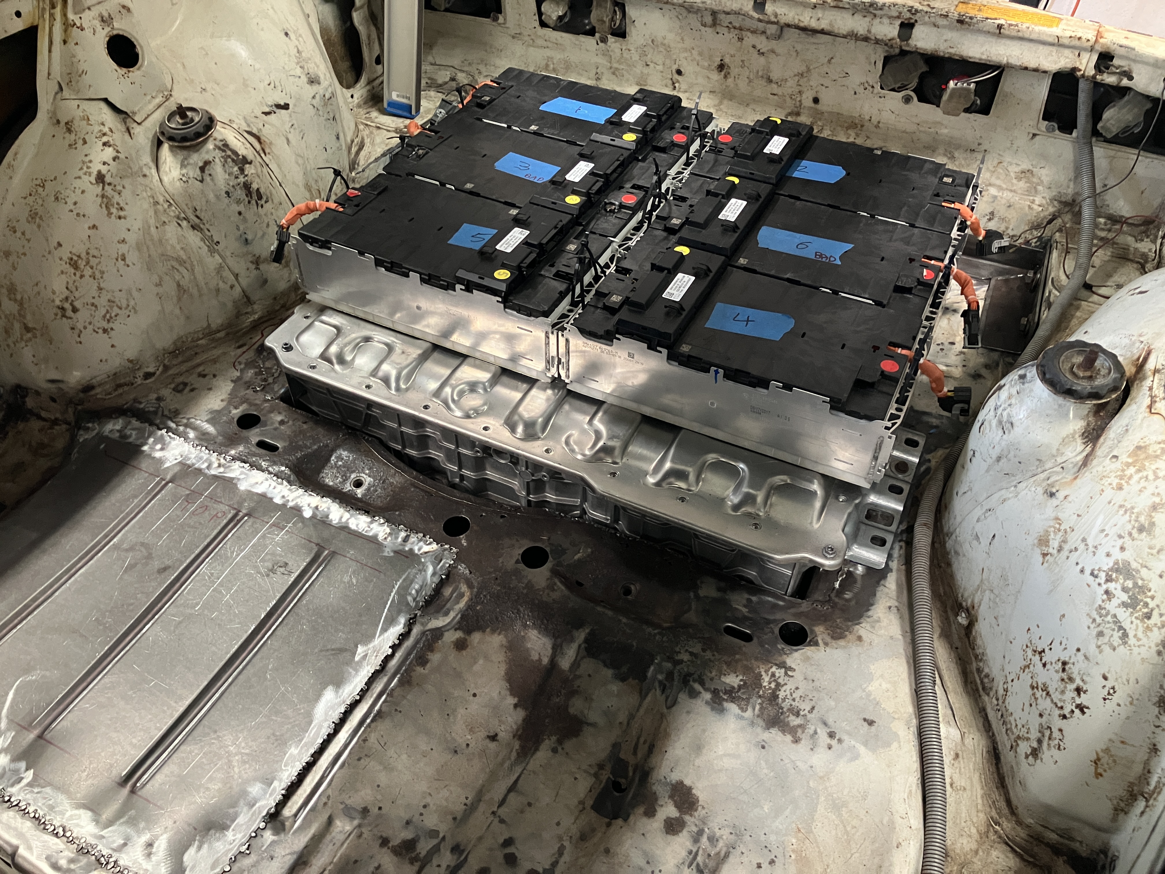

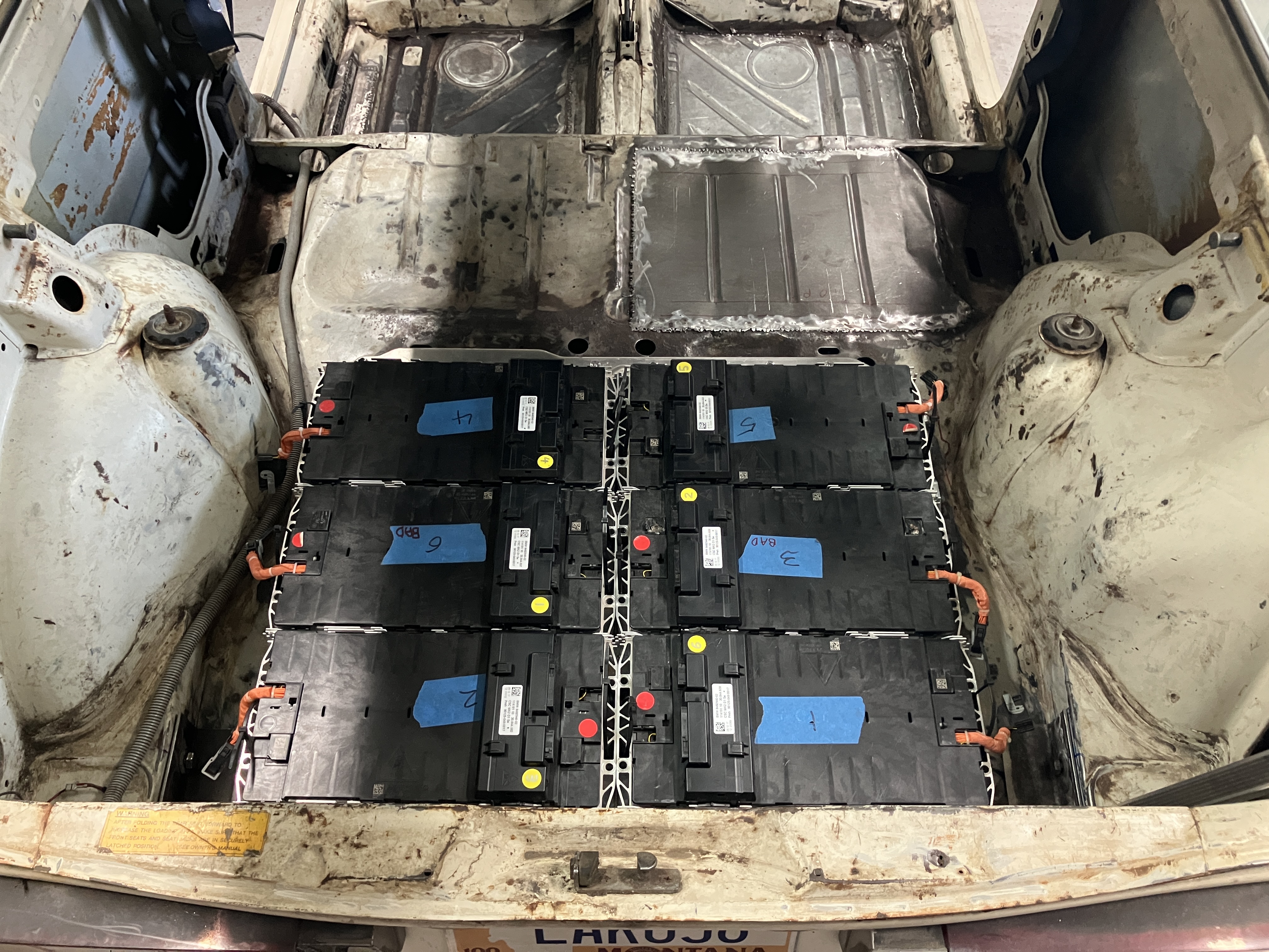

never too early to plan your next battery pack upgrade
so if we were to go to the 6 modules from the BMW 530e which would be 12 killer whales instead of the current 7 (provide we get one from July 2019 and up) this vertical formation would not fit behind the rear seat horizontal frame rail
- Gregski
- Posts: 3164
but if we were to fandangle them sideways like so, they fit with room to spare, and whom ever cut this current hole out got it almost nearly perfect [clairvoyant he is]

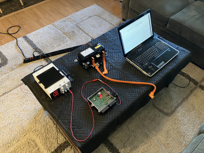

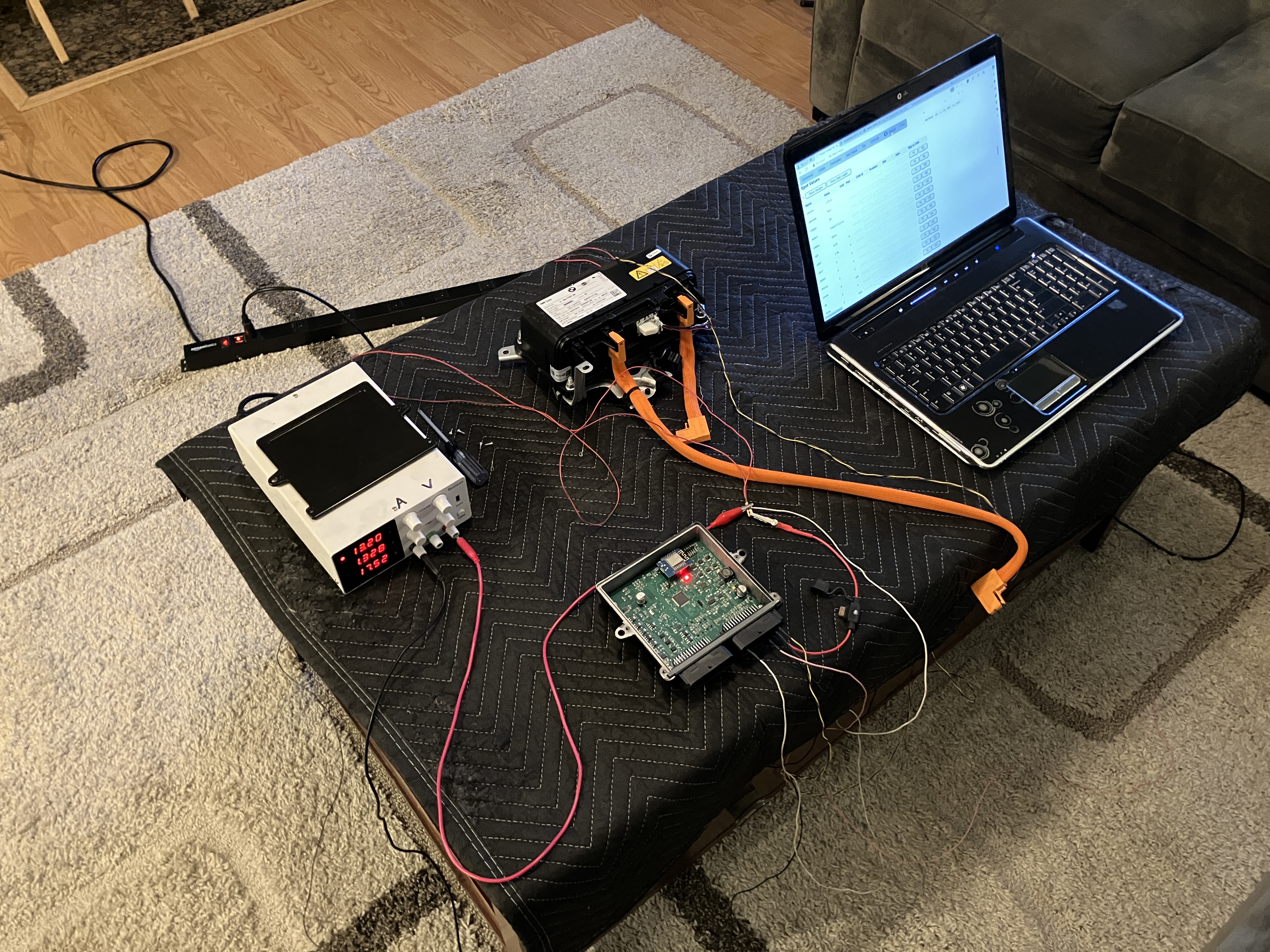

while I'm literally waiting on the paint to dry I decided to have at the Zombie controlling the BMW Safety Box
things weren't working, so T-Bone my trusty assistant, suggested we plug more skinny wires into the Zombie
and that did the trick

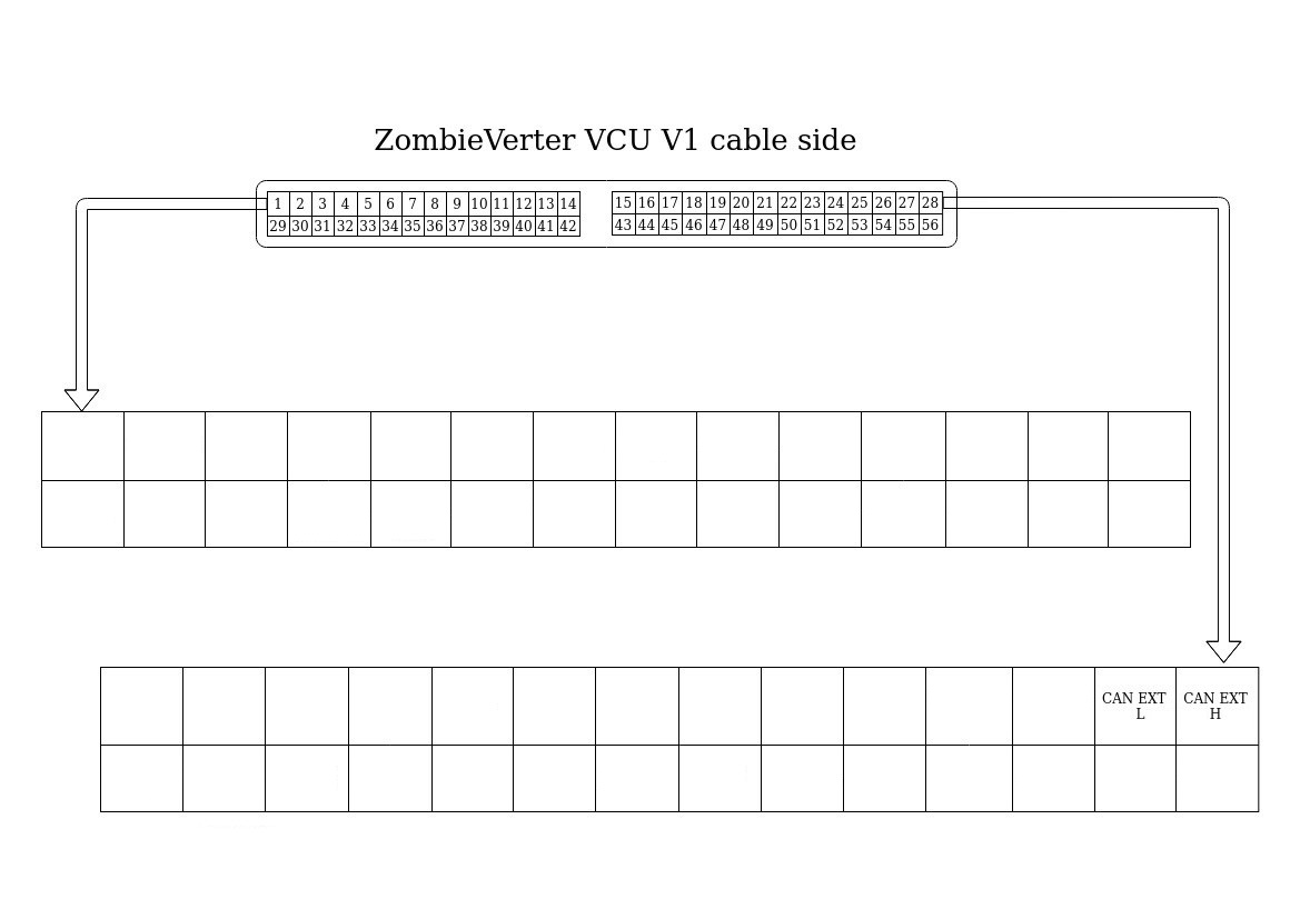

ZombieVerter VCU BMW Safety Box Control Part II
- Gregski
- Posts: 3164

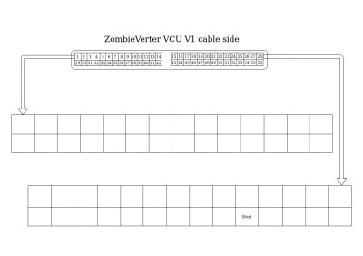

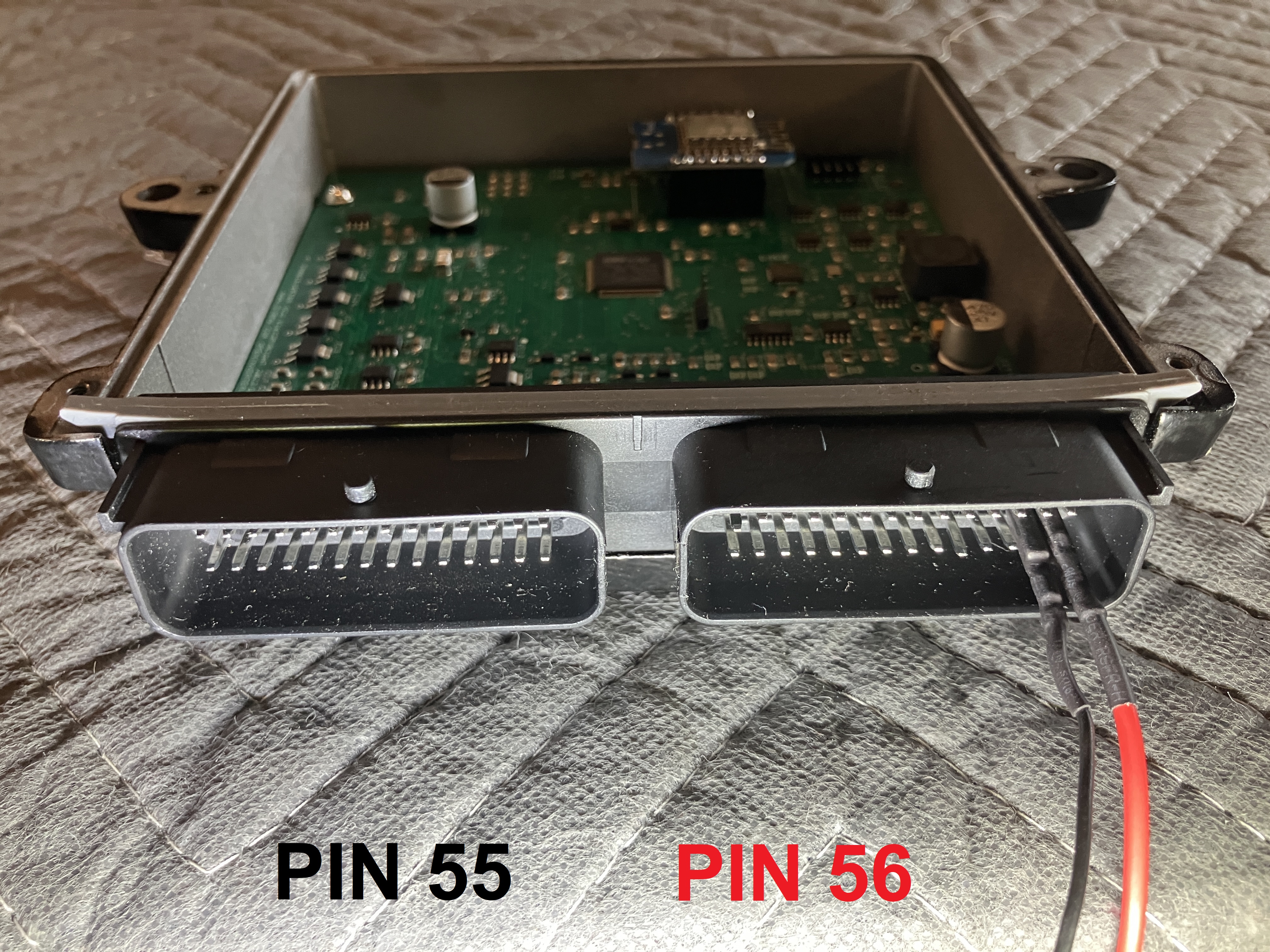

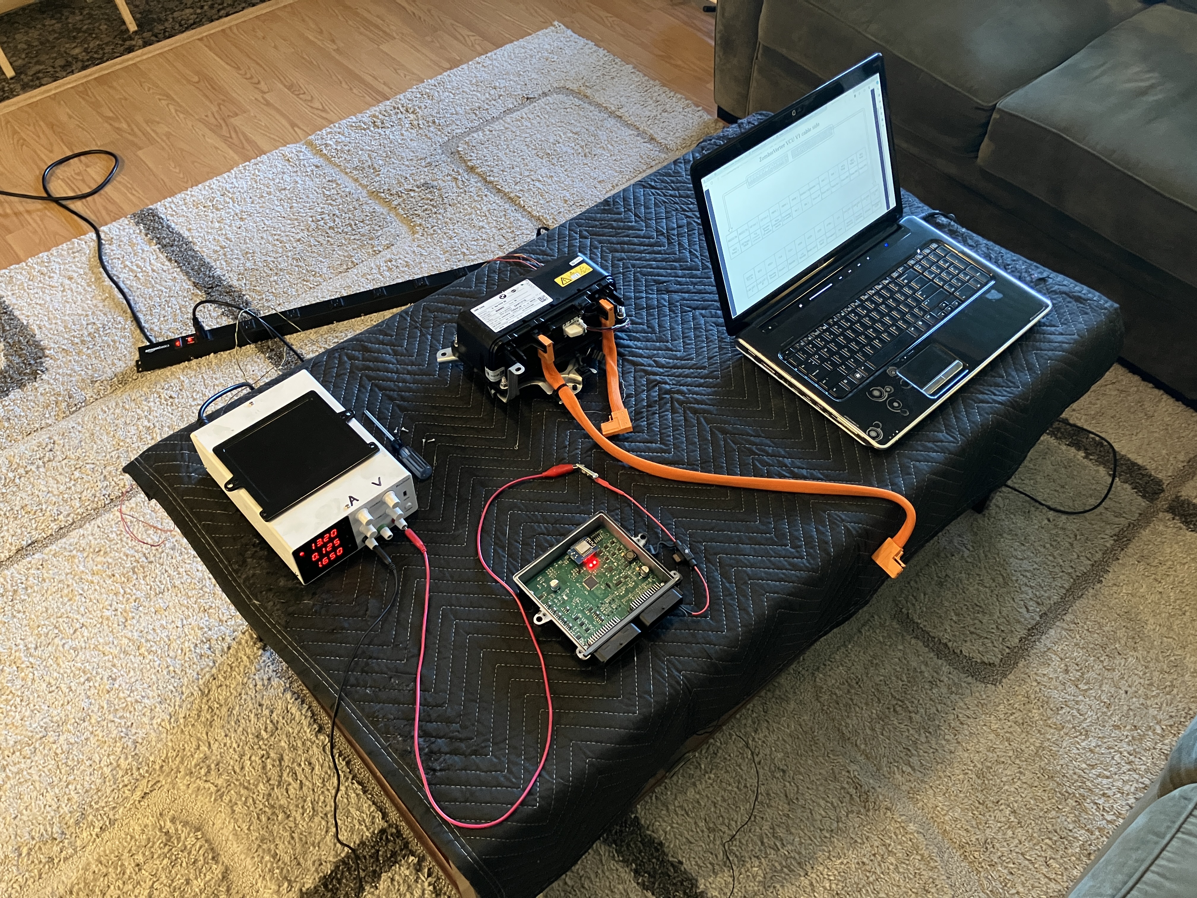

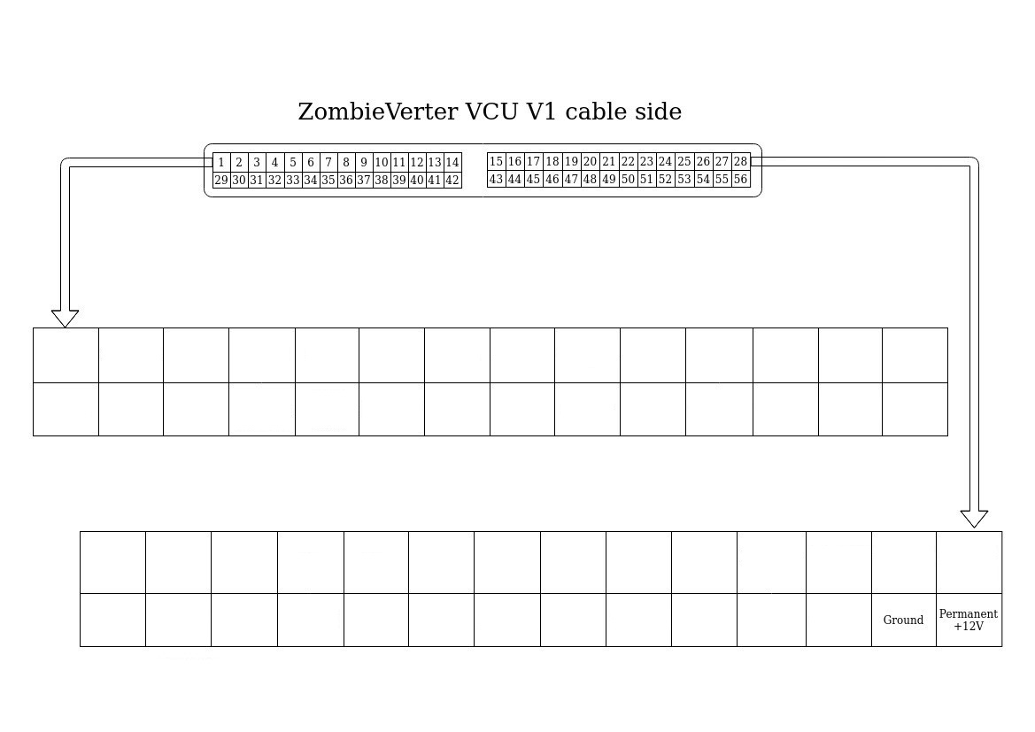

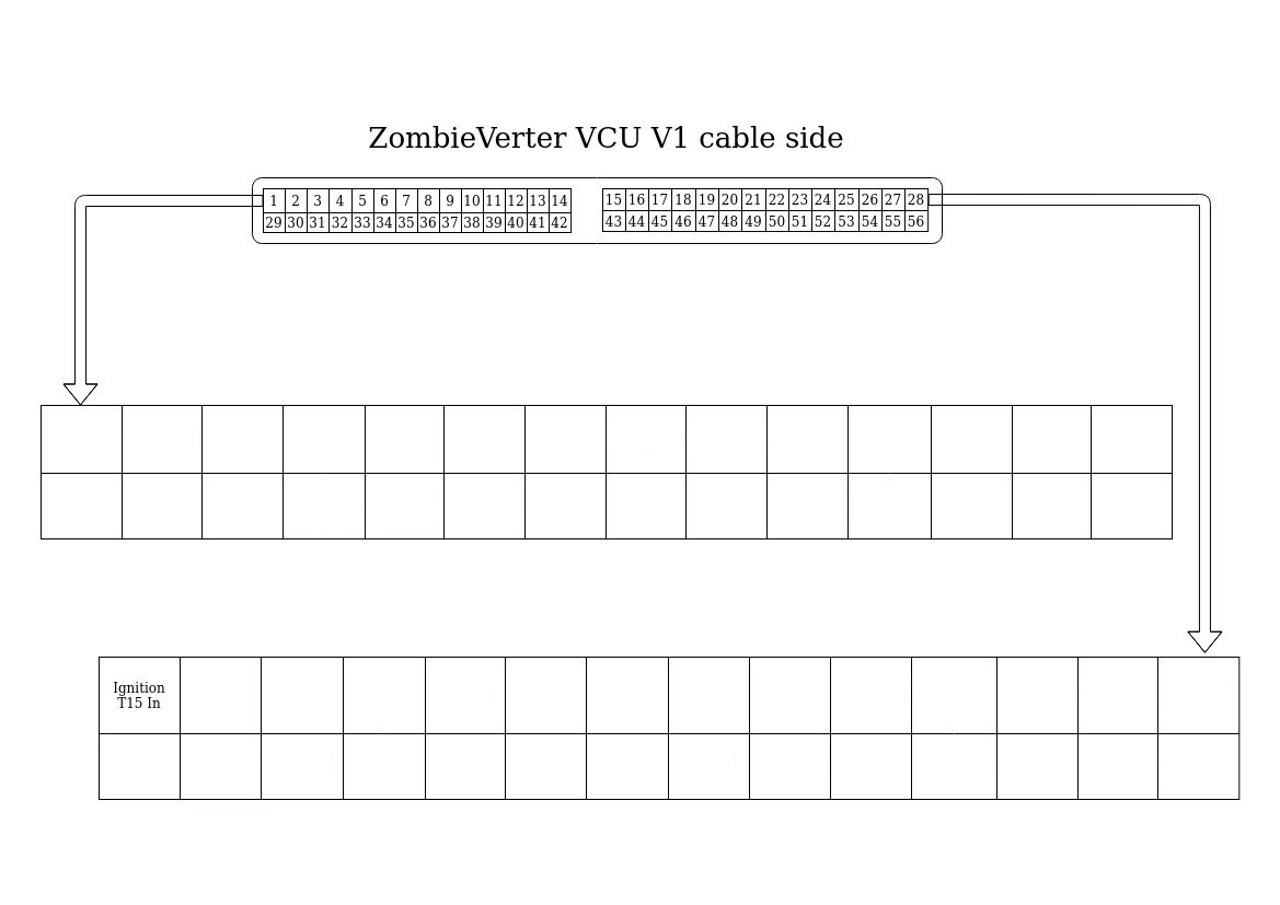

ZombieVerter VCU - Permanent Power Connection
This is the minimum wiring required to access the Zombie via it's Web Interface. Requires two pins. The Zombie is always "on" maybe a better term would be enabled, this is required to detect charge mode and facilitate timers.
Pin #55 - negative / ground
Pin #56 - positive / 12 volts (fuse recommended)
- Gregski
- Posts: 3164

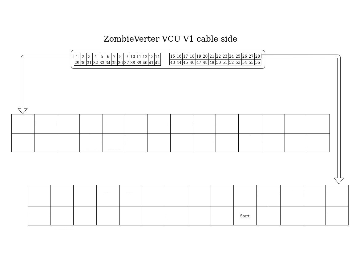

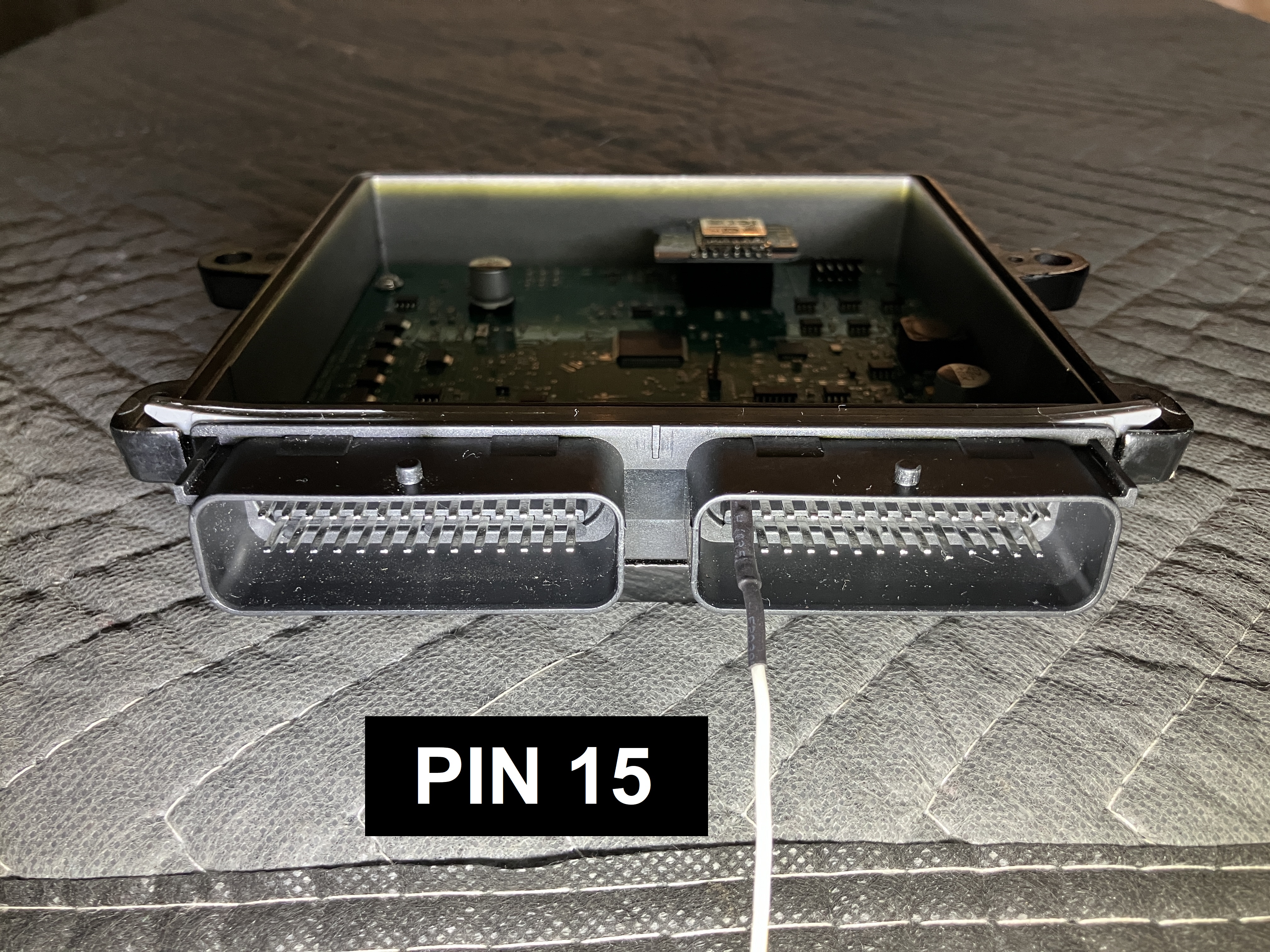

ZombieVerter VCU - Ignition Connection
In addition to the two wires above, we need a third wire, this wire when disconnected turns the Zombie OFF. However when connected it does NOT change the mode at all, for that to change see Start Connection below.
Pin #15 - positive / 12 volts (fuse recommended)
- Gregski
- Posts: 3164

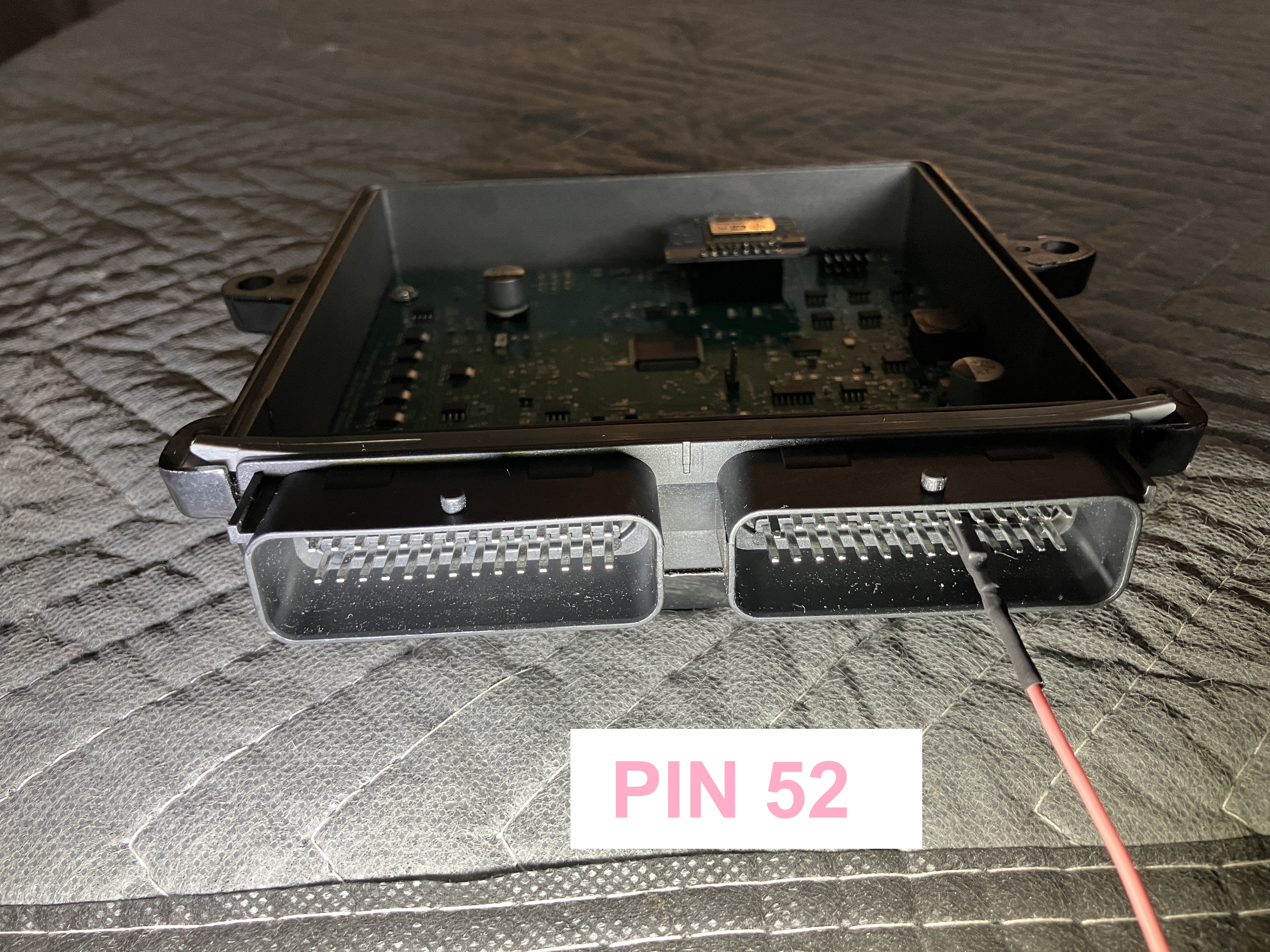

ZombieVerter VCU - Start Connection
In addition to the three wires above a fourth wire is needed to put the Zombie in RUN mode. This requires a momentary switch, think of turning the key in the ignition switch to the Start position and have it automatically spring back after the starter starts the engine.
Pin #52 - positive / 12 volts (fuse recommended) momentary only
- Gregski
- Posts: 3164

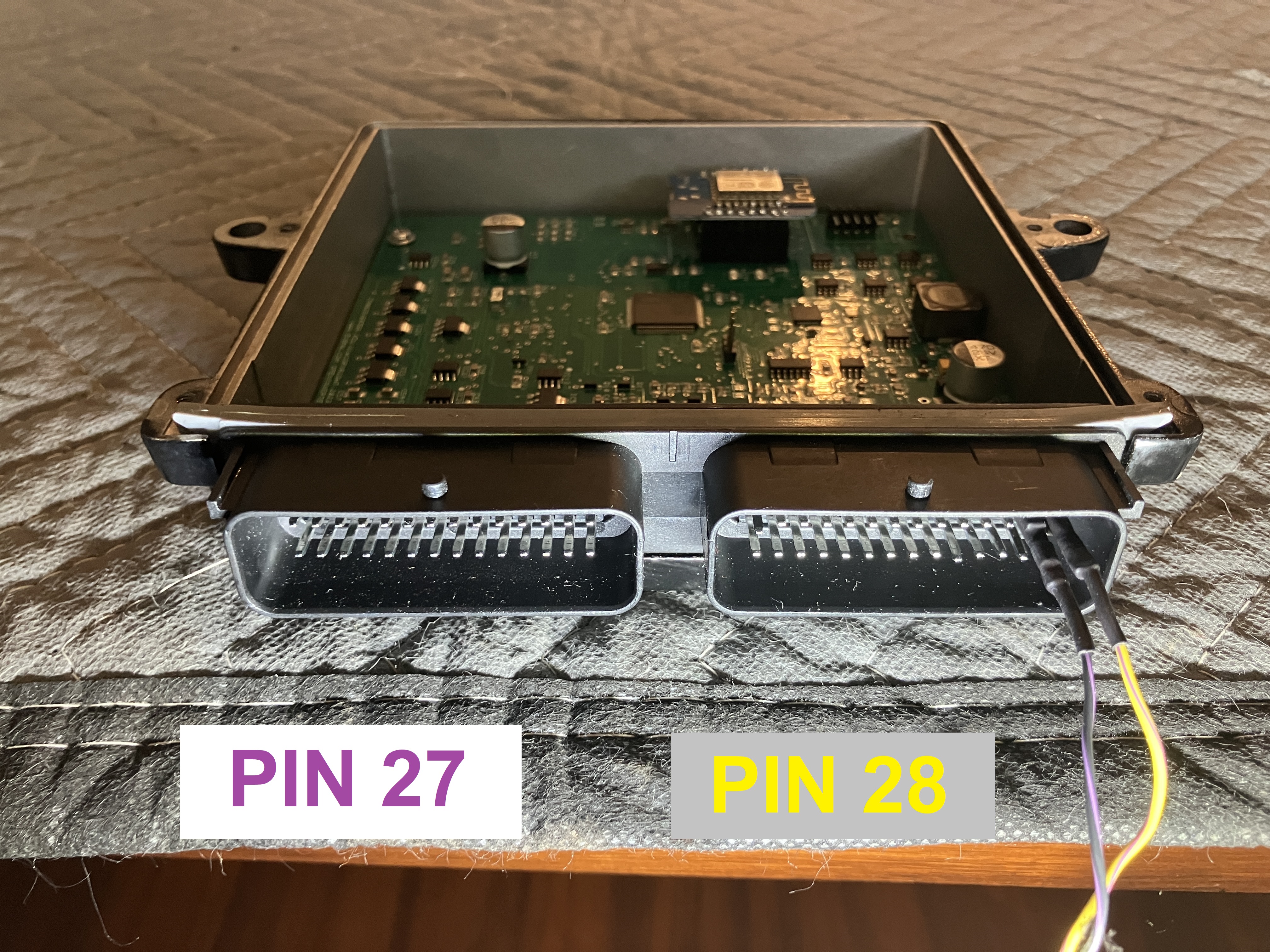

ZombieVerter VCU - CAN1 Connection
The Zombie supports three different CAN channels, this is the first one. It requires two wires one for CAN High signal and a second for CAN Low signal. Usually this two wire pair is twisted together aka a twisted pair. This requires two pins.
Pin #27 - CAN Low will run from the Zombie to some CAN device (Charger, Safety Box, etc.)
Pin #28 - CAN High will run from the Zombie to some CAN device (Charger, Safety Box, etc.)
