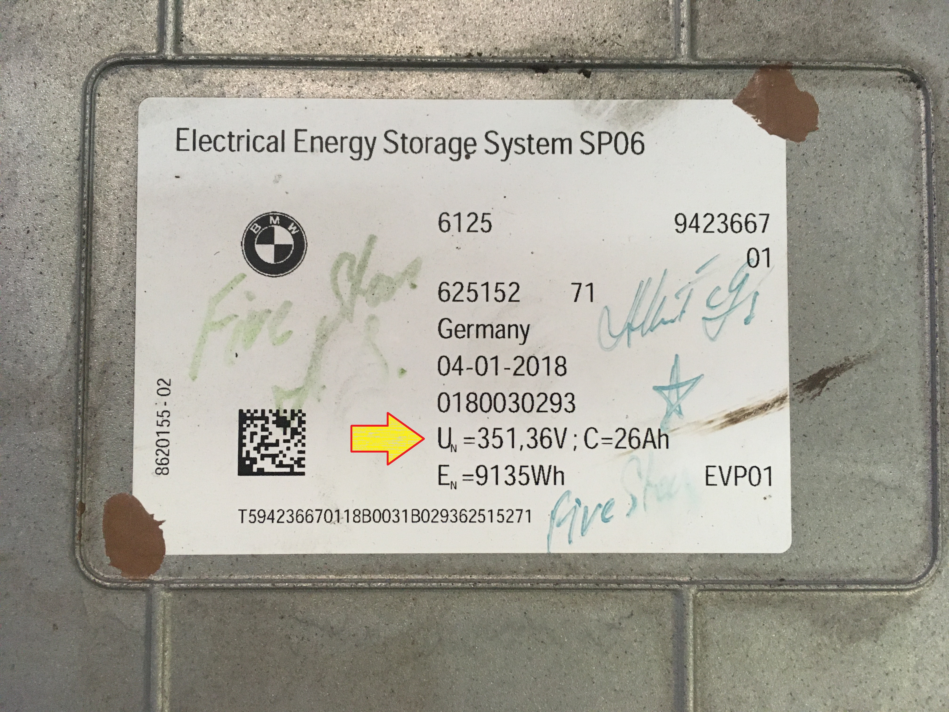

and now a lesson on German Electronics from the guy who should not be giving a lesson on anything let alone German Electronics
this is a 2018 BMW 530e hybrid battery pack
why the hell does that say U=
The letter "U", often used to denote voltage supply, is said to be derived from the German word "Unterschied" which means "difference". This loosely implies "voltage difference" which may be used to help understand the meaning of the use of the letter "U" for the power supply to these types of electrical equipment.

Gregski wrote: Sun Apr 07, 2024 5:38 pm why the hell does that say U=
The symbol for voltage is U - derived from the Latin urgere (to urge, drive, push). The SI unit is the volt, named after Alessandro Volta.

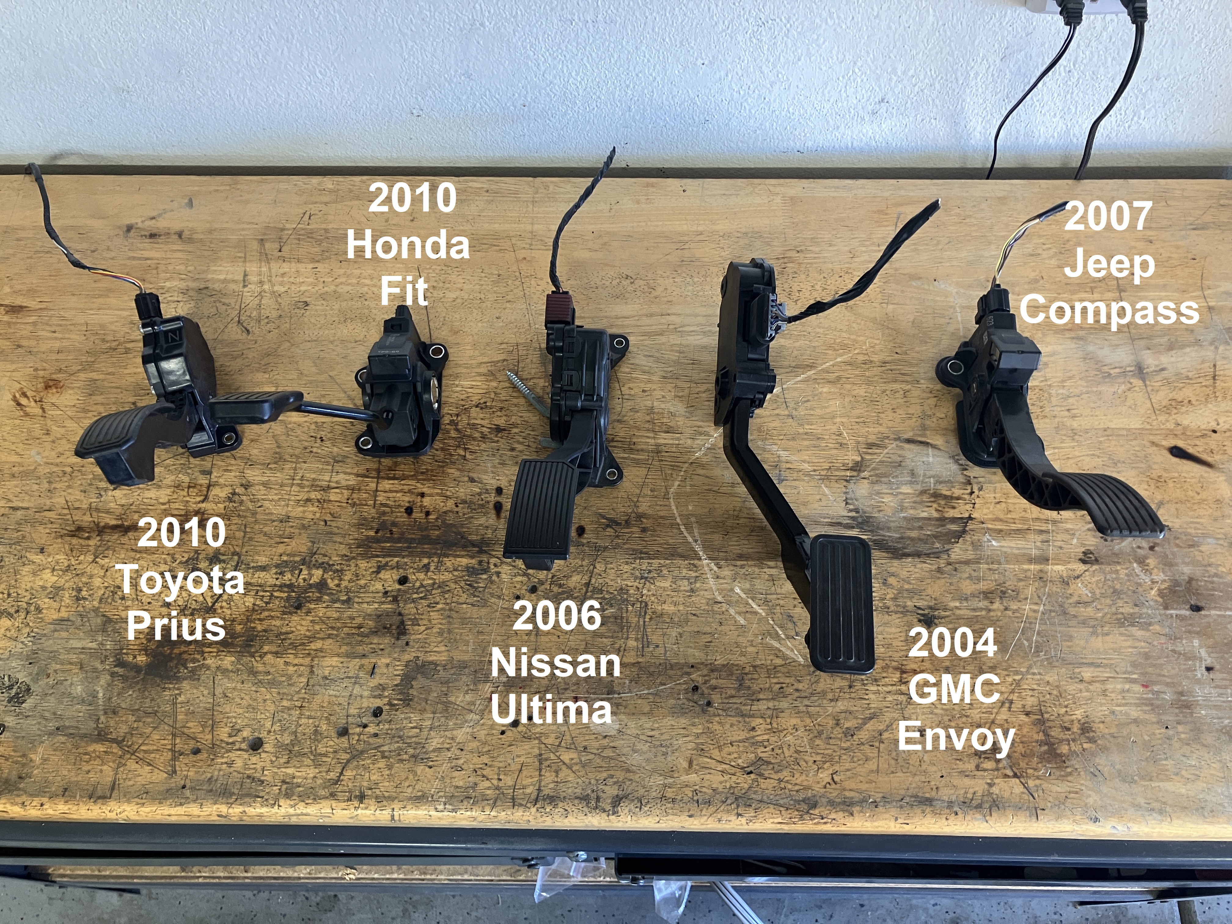

VW MK1 Rabbit Electric Throttle Install
Gregski
Posts: 3161
Has thanked: 631 times
Been thanked: 1607 times
Post by Gregski »

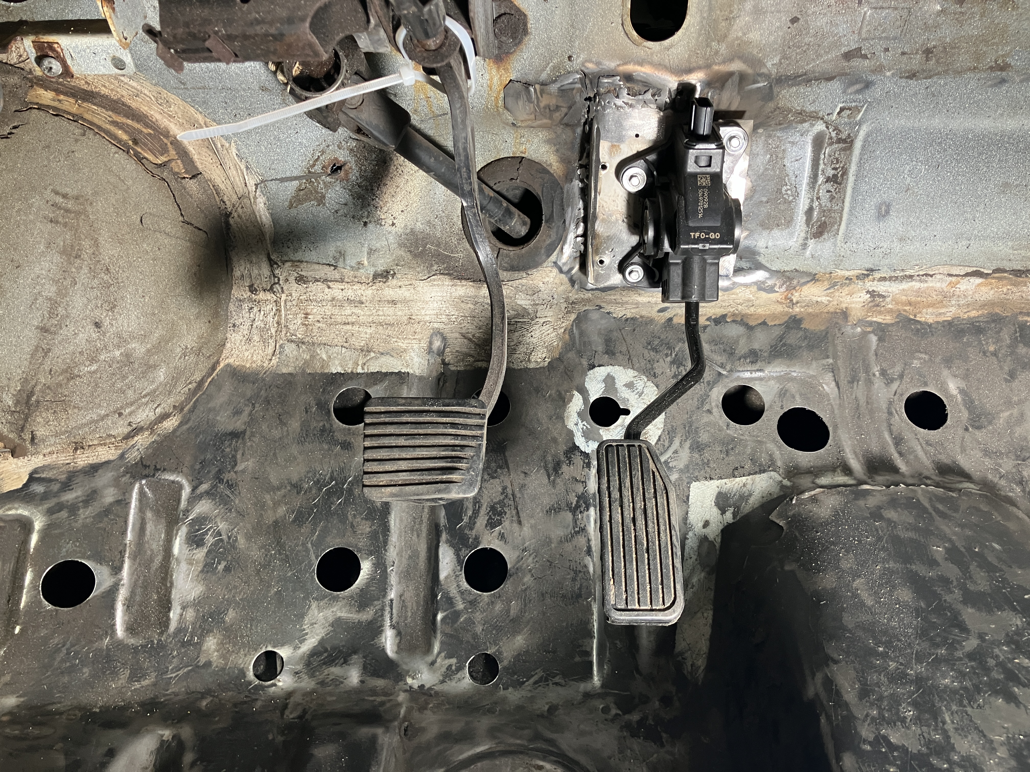

first we tried a 2010 Toyota Prius pedal to keep it in the family
because of the wiggliness in the Rabbit firewall I had to make a block for an offset
nice thing about metal is that you can weld up the holes you don't want

and then I decided to go with one that [ahem] fit, as in 2010 Honda Fit

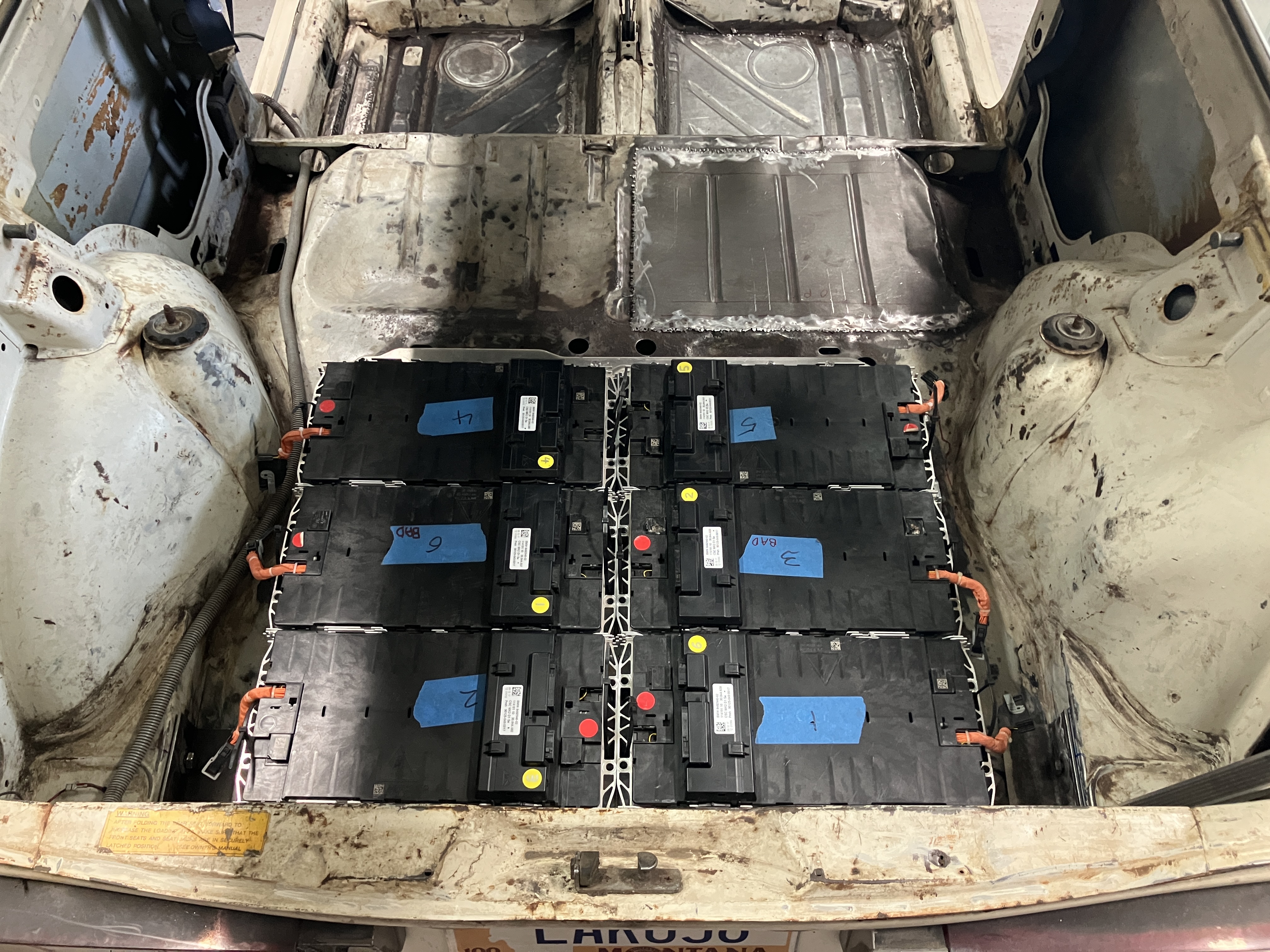

never too early to plan your next battery pack upgrade
so if we were to go to the 6 modules from the BMW 530e which would be 12 killer whales instead of the current 7 (provide we get one from July 2019 and up) this vertical formation would not fit behind the rear seat horizontal frame rail
Gregski
Posts: 3161
Post by Gregski »
but if we were to fandangle them sideways like so, they fit with room to spare, and whom ever cut this current hole out got it almost nearly perfect [clairvoyant he is]
