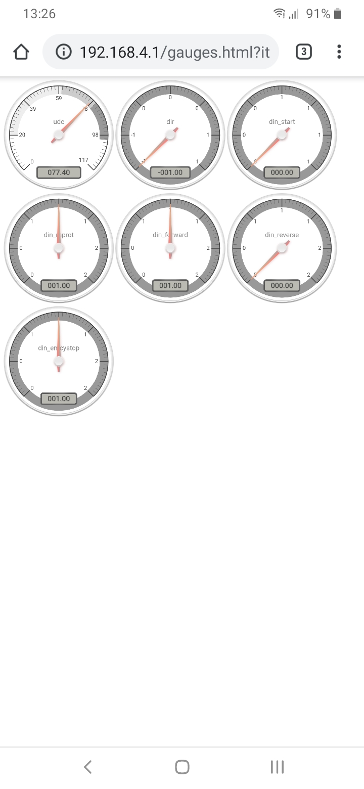

I've found out why "forward" remains stuck. After I switch it off, there is still some voltage on it. 4 or so volts. When I hook up voltmeter to it it drains out and switches off. The is no such issue with any other pin. Only with "forward".

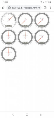

Btw, there is what I see when I power up the board. din_mprot and din_emcystop are both 1. So that means there are no stop errors? So why it not closing main?

About stuck "din_forward" pin. After it is switched off, thre is still 4 volts, which drops to zero in about one or two minutes. There are 1uF capacitors hooked to pins. I've measured their resistance with a multimeter. At other pins it is something around 10kOm, but at forward pin resistance of C9 capacitor is more then 2MOm, does that means that capacitor is dead?
UPDATE: problem was in dead C9 capacitor.

I don't think that is supposed to happen...konstantin8818 wrote: ↑Sat Jul 04, 2020 6:16 pm The most interesting thing with this board that it doesn't control "MG shutdown" pin of inverter... As soon as you switch the board on, but didn't pushed "start" botton yet, you can select direction and press pedal, unfortunately insteard of moving you'll burn precharge wiring...![]()
PWM output is only supposed to be possible in opmode 1 or 2 (normal or manual mode).
Can you try looking at the opmode with board switched on but not started? Maybe you have a wire crossed somewhere.
-Isaac

Re: Toyota Prius Gen 2 Inverter Controller
OK, I checked it and all works fine. When logic board is switched ON, opmode is "0" and it doesn't react to direction switch and pedal. Inverter start botton is momentary - as soon as it was pressed, opmode is "1" and it only swithes OFF when logic board is switched OFF.
MAIN didn't closed because of no contact on blue pill board
