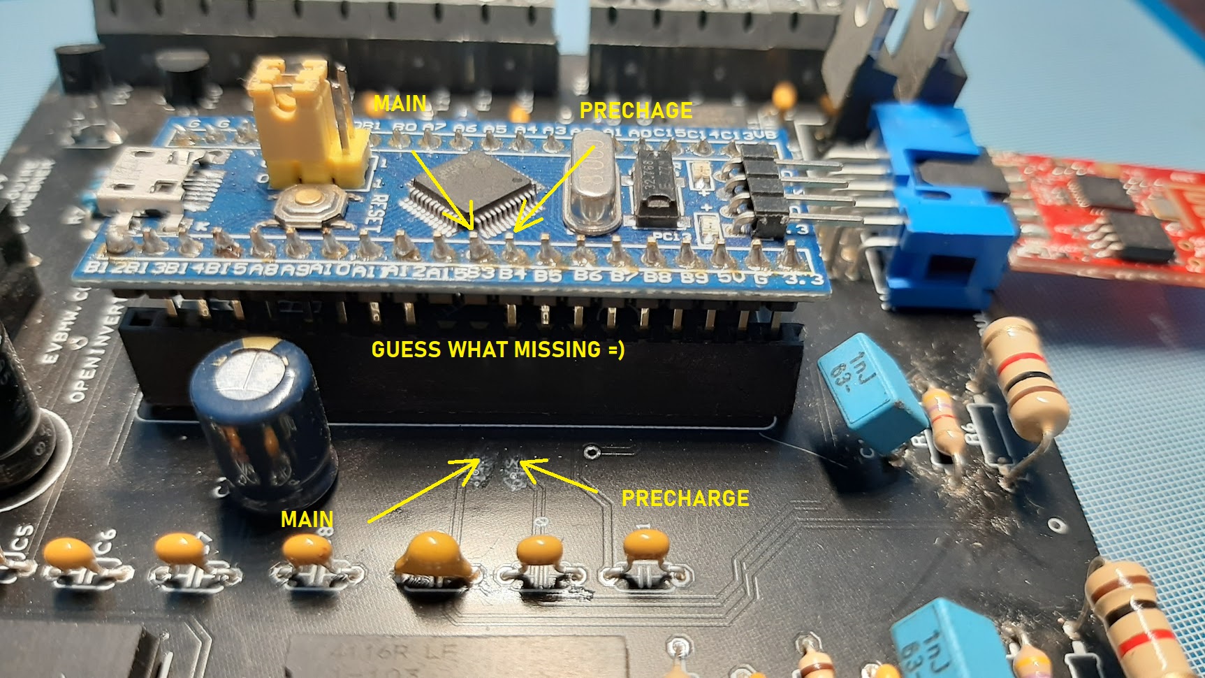

OK. I've got it about inverter is active despite "STR" pin is not activated. Stupid me, I believed that picture on wiki, that is 50% wrong. I've just connected inverter shutdown pin to 12 volts....=( So why there is a "STR" pin in a first place? What is it doing, except shutting down precharge contactor?
Can please someone tell me if this board is compatible with latest sine firmware? Or it is not because bluepill pins are different from those STM32 chips on latest boards? If so, which version of sine is compatible with bluepill?

I've found out why "forward" remains stuck. After I switch it off, there is still some voltage on it. 4 or so volts. When I hook up voltmeter to it it drains out and switches off. The is no such issue with any other pin. Only with "forward".
Btw, there is what I see when I power up the board. din_mprot and din_emcystop are both 1. So that means there are no stop errors? So why it not closing main?

About stuck "din_forward" pin. After it is switched off, thre is still 4 volts, which drops to zero in about one or two minutes. There are 1uF capacitors hooked to pins. I've measured their resistance with a multimeter. At other pins it is something around 10kOm, but at forward pin resistance of C9 capacitor is more then 2MOm, does that means that capacitor is dead?
UPDATE: problem was in dead C9 capacitor.

I've encountered strange and dangerous bug with this board.
Unexpectedly car starts to accelerate on its own. "Pot" is below "potmin" but "potnom" is 100%. On neutral it doesn't do anything, but as soon as I choose direction is starts to go there.
I still don't know what triggers this bug. Last time it happened when I was playing with "ampnmin" and "throtramp" parameters, while the car was on steep heel.
The only thing that resets this bug is logic board reset.
All signal wires and board itself are not screened yet, and problem occurs when inverter is hot.
In a few days i'll get coolant pump and will execute long test drive.

OK, I checked it and all works fine. When logic board is switched ON, opmode is "0" and it doesn't react to direction switch and pedal. Inverter start botton is momentary - as soon as it was pressed, opmode is "1" and it only swithes OFF when logic board is switched OFF.
MAIN didn't closed because of no contact on blue pill board
- konstantin8818
- Posts: 290
- Location: Minsk, Belarus
- Has thanked: 2 times
- Been thanked: 10 times
Re: Toyota Prius Gen 2 Inverter Controller
Damien is a true 80 lvl troll
Also for some reason FLT pin missing as well. Damien can you please tell why?
