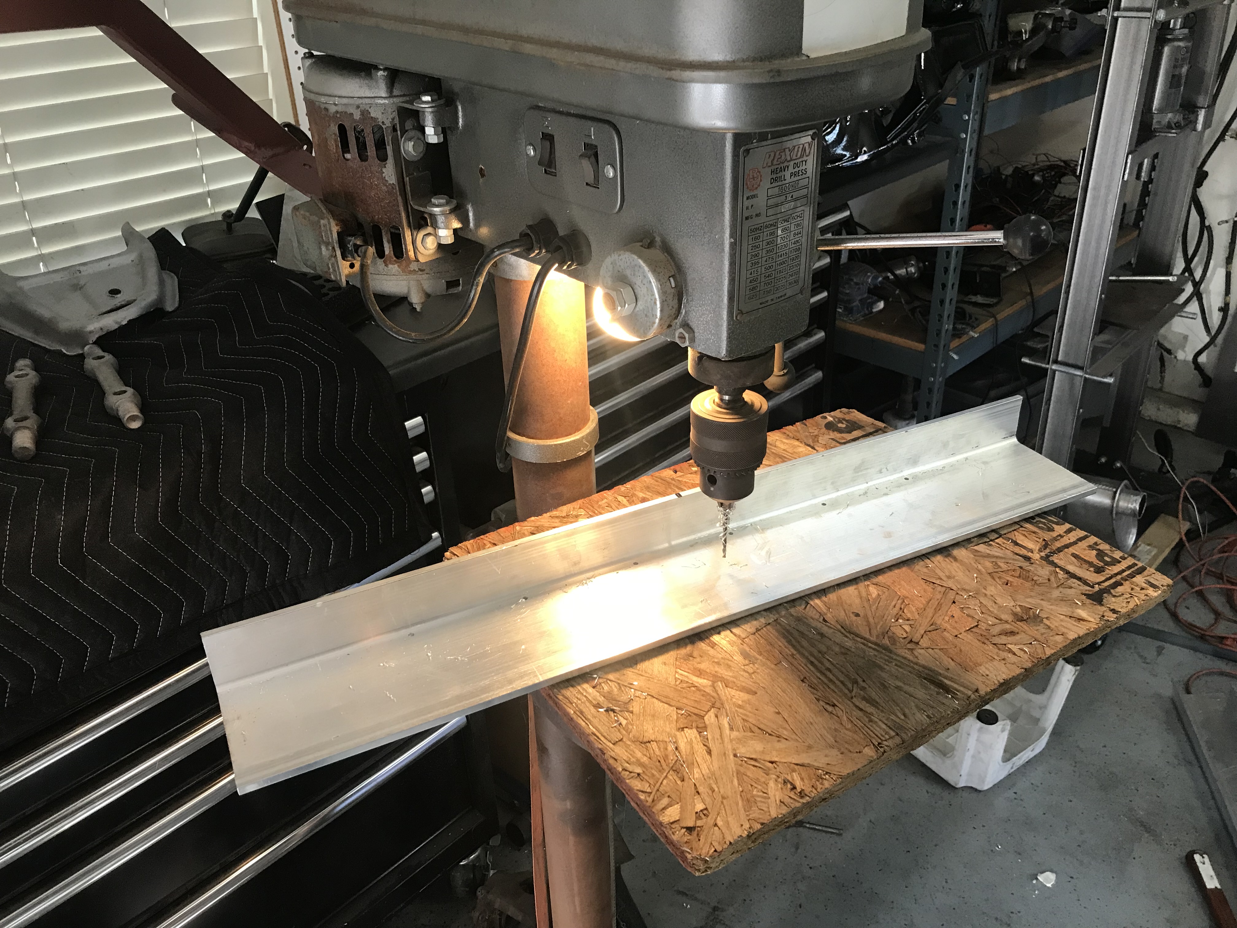

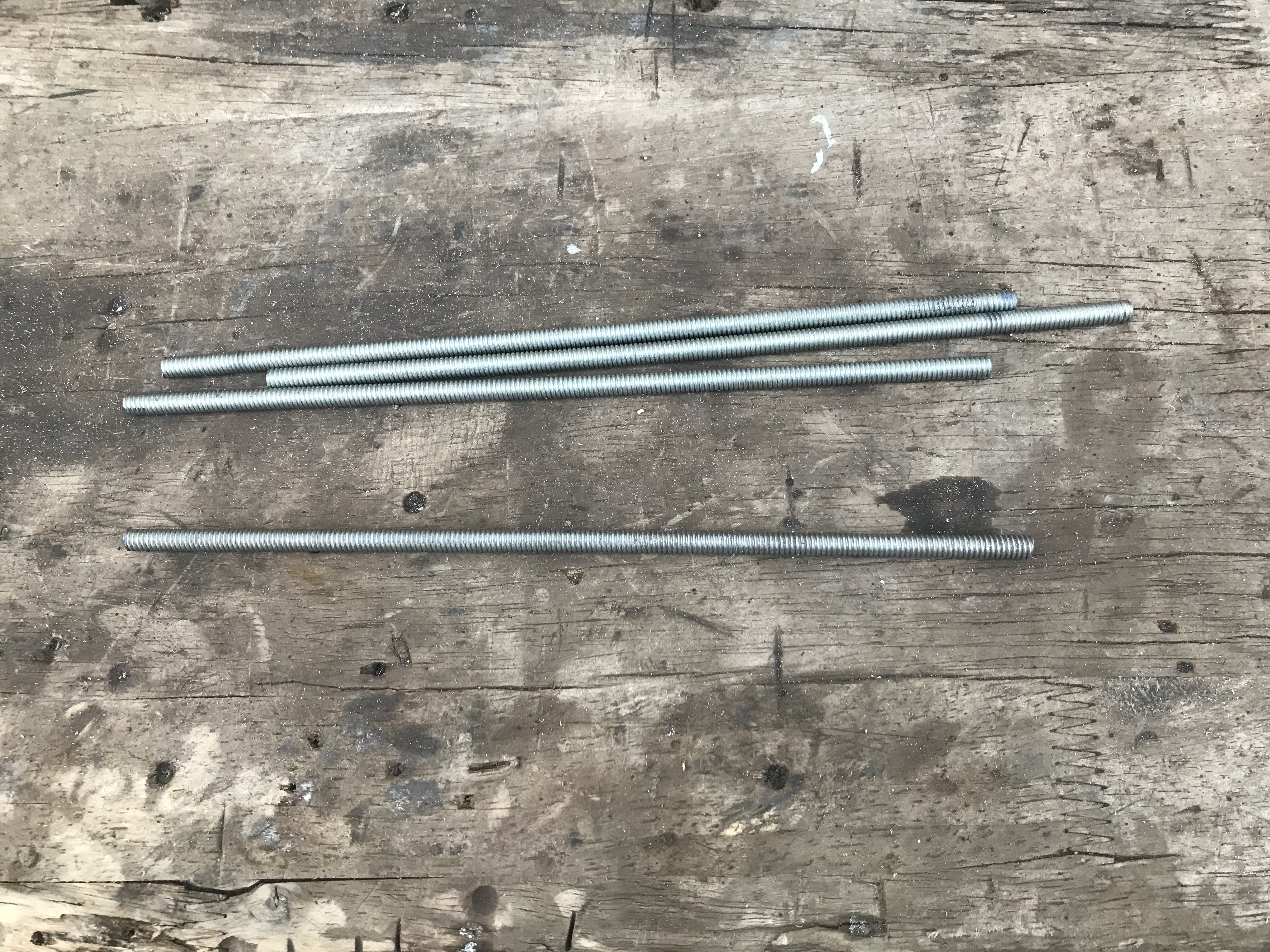

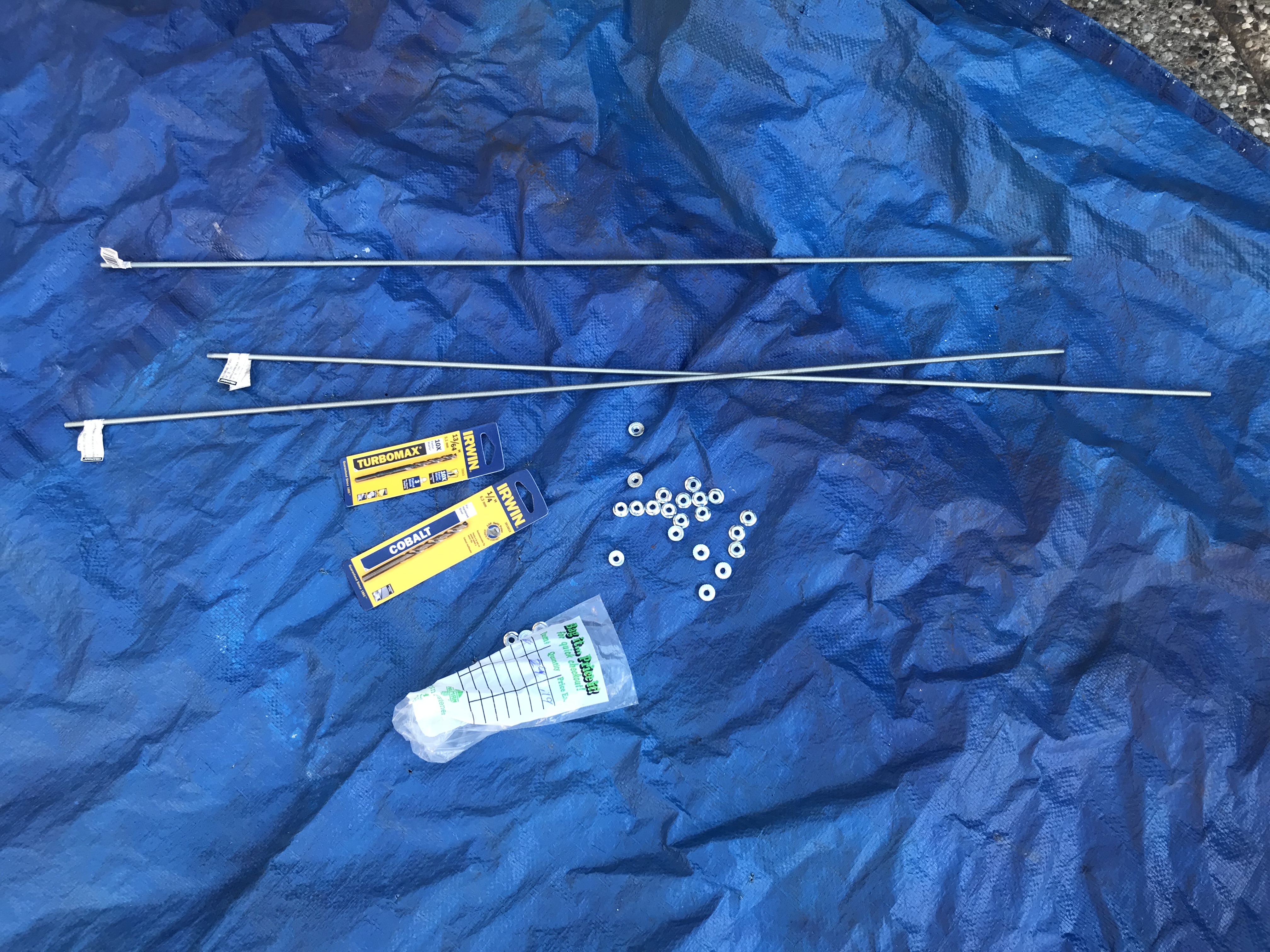

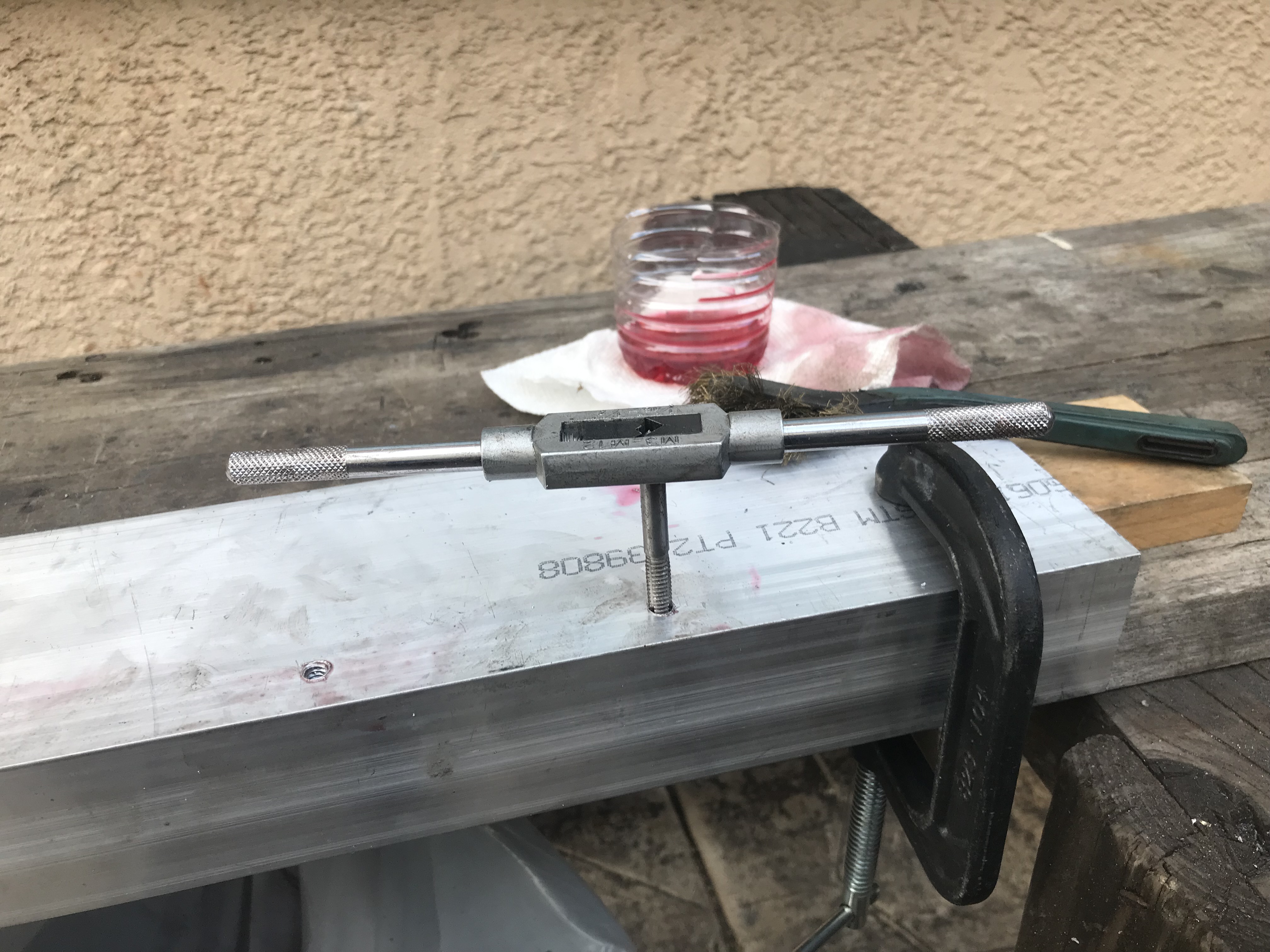

then it was off to Ace Hardware (where they treat me like Norm on Cheers since I'm there every day) for some [ahem] hardware
- Gregski
- Posts: 2873
- Has thanked: 530 times
- Been thanked: 1189 times
I love these ALMOST on center every time punches

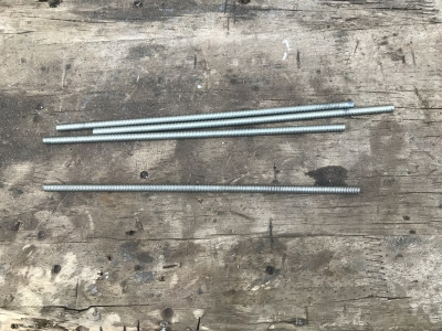

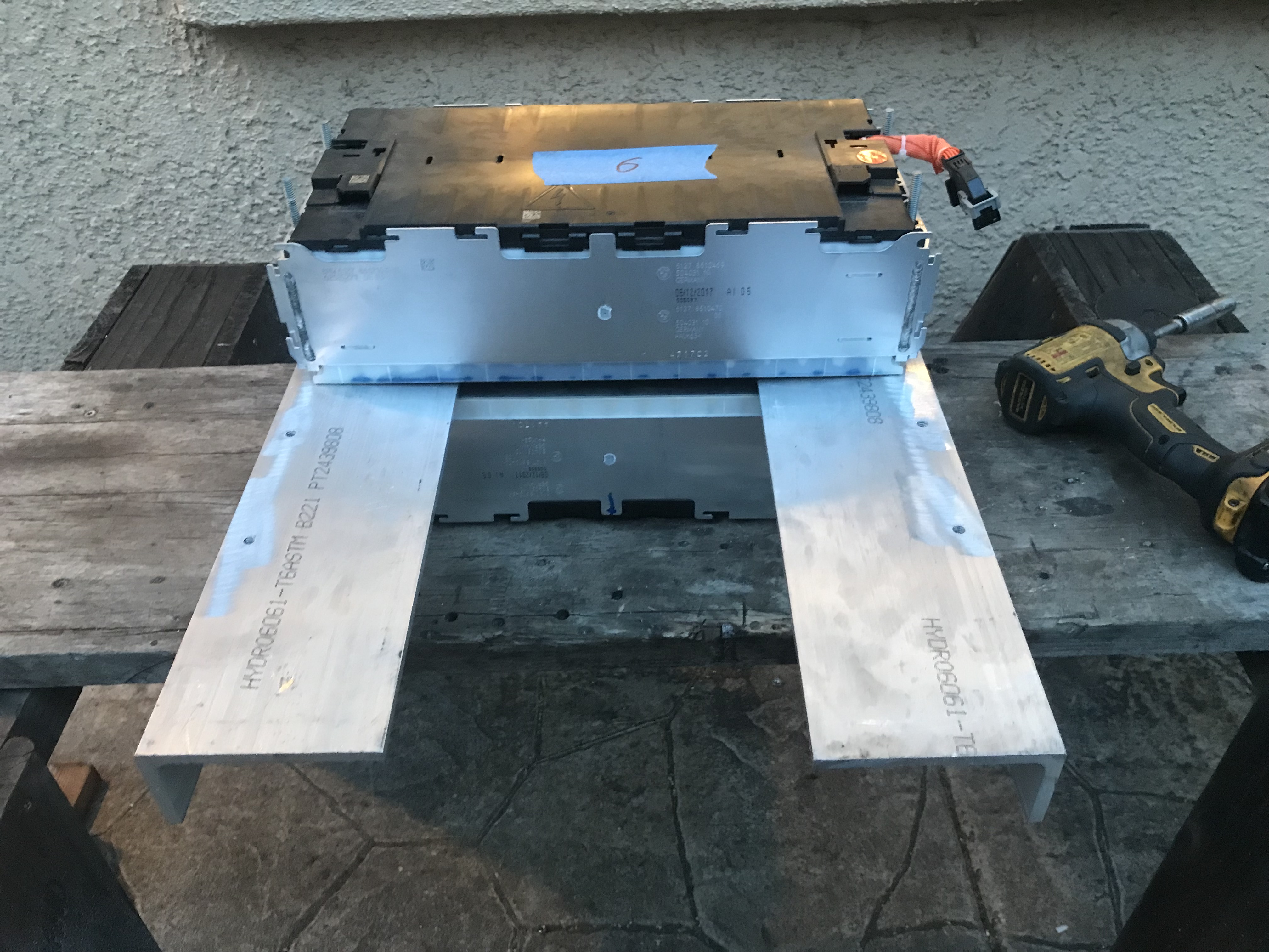

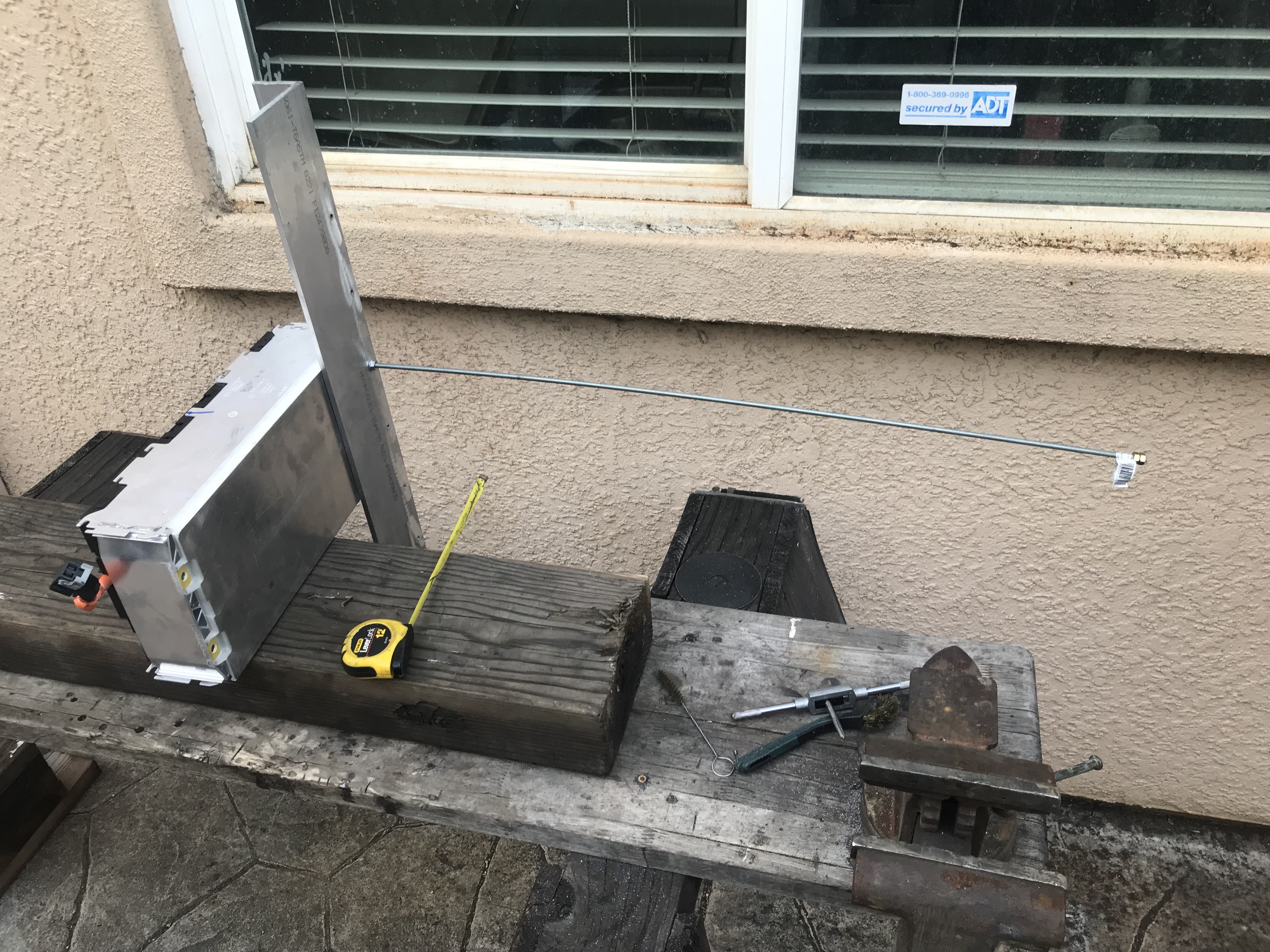

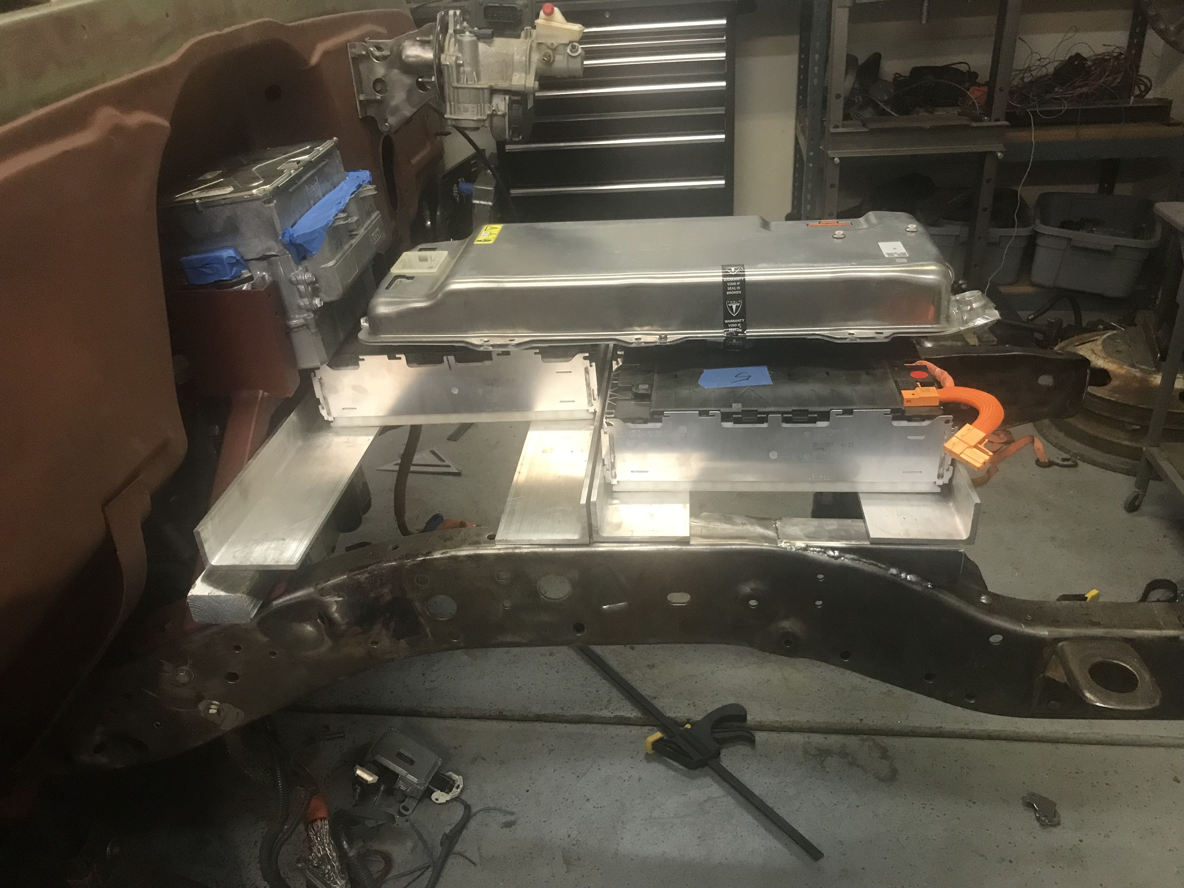

so this is what we are going for
- Gregski
- Posts: 2873

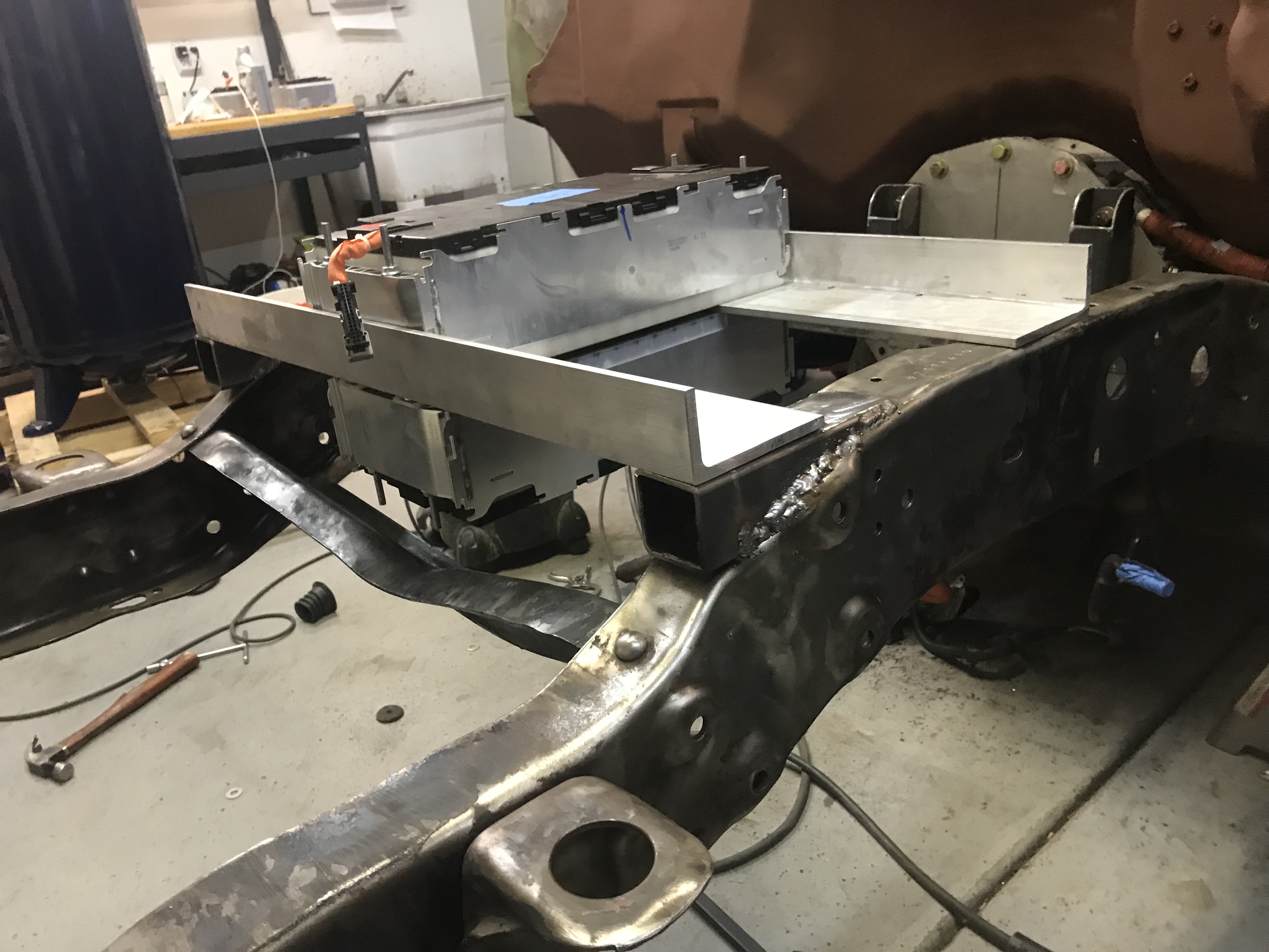

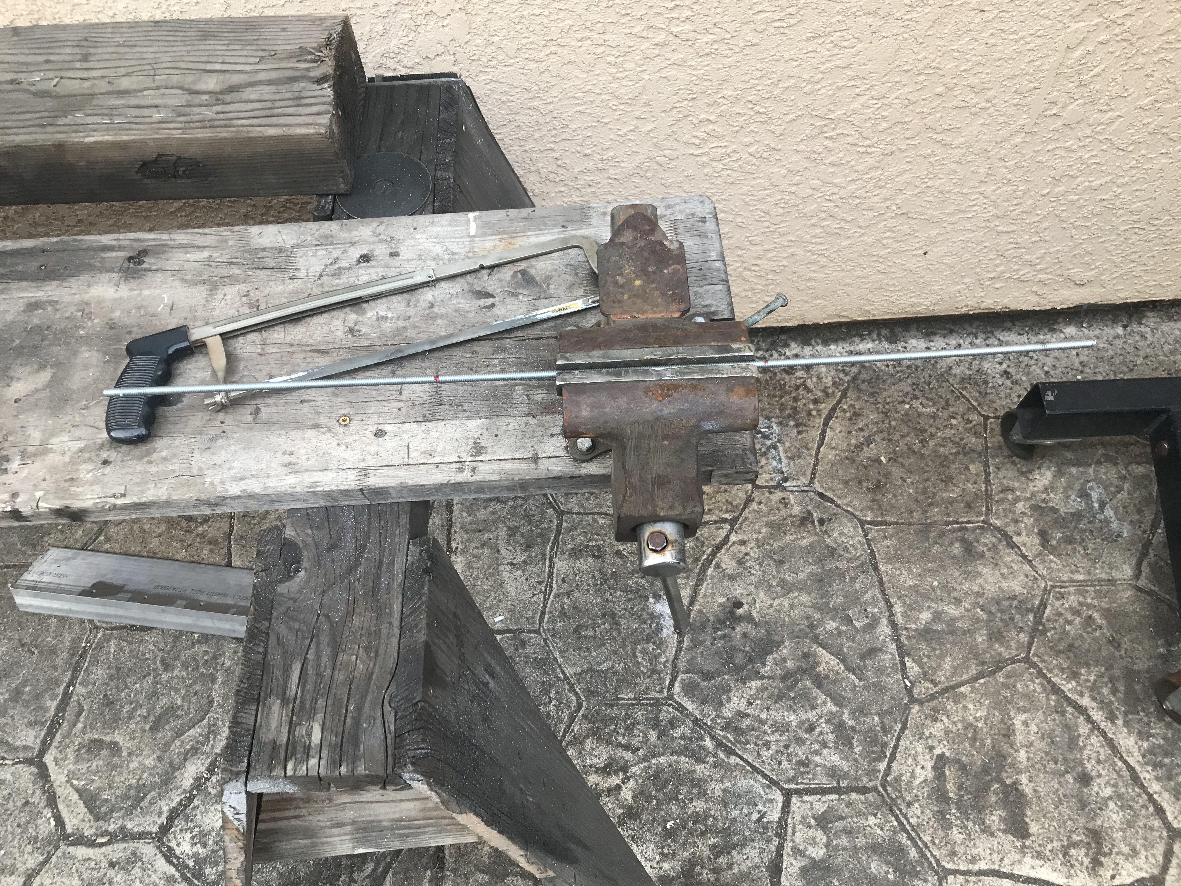

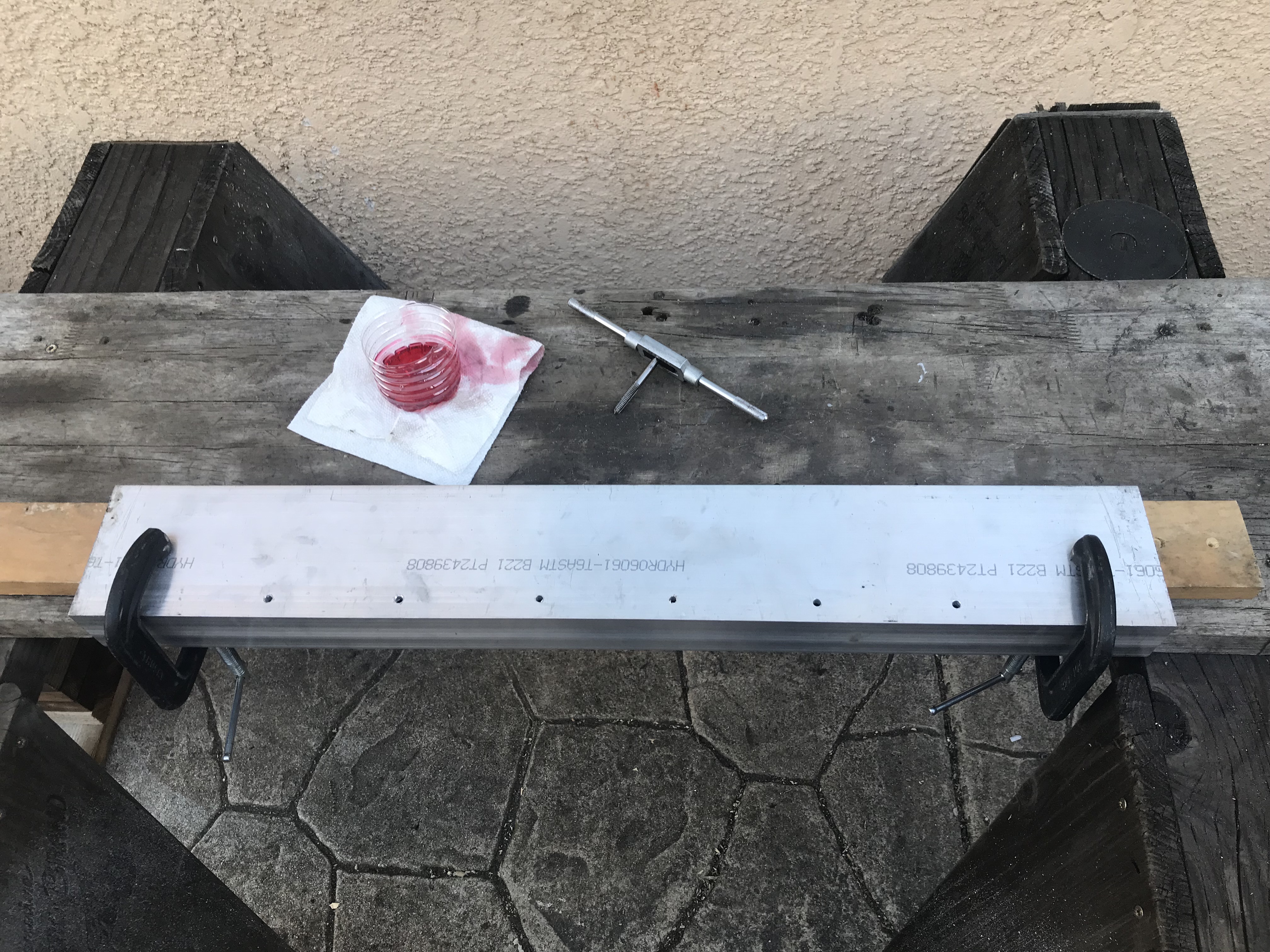

Fun Level = 0
36" divided by 4 equals enuff sticks for 2 battery modules
- Gregski
- Posts: 2873

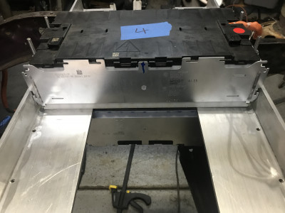

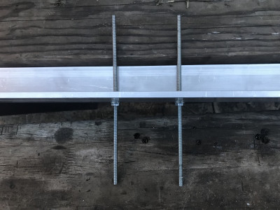

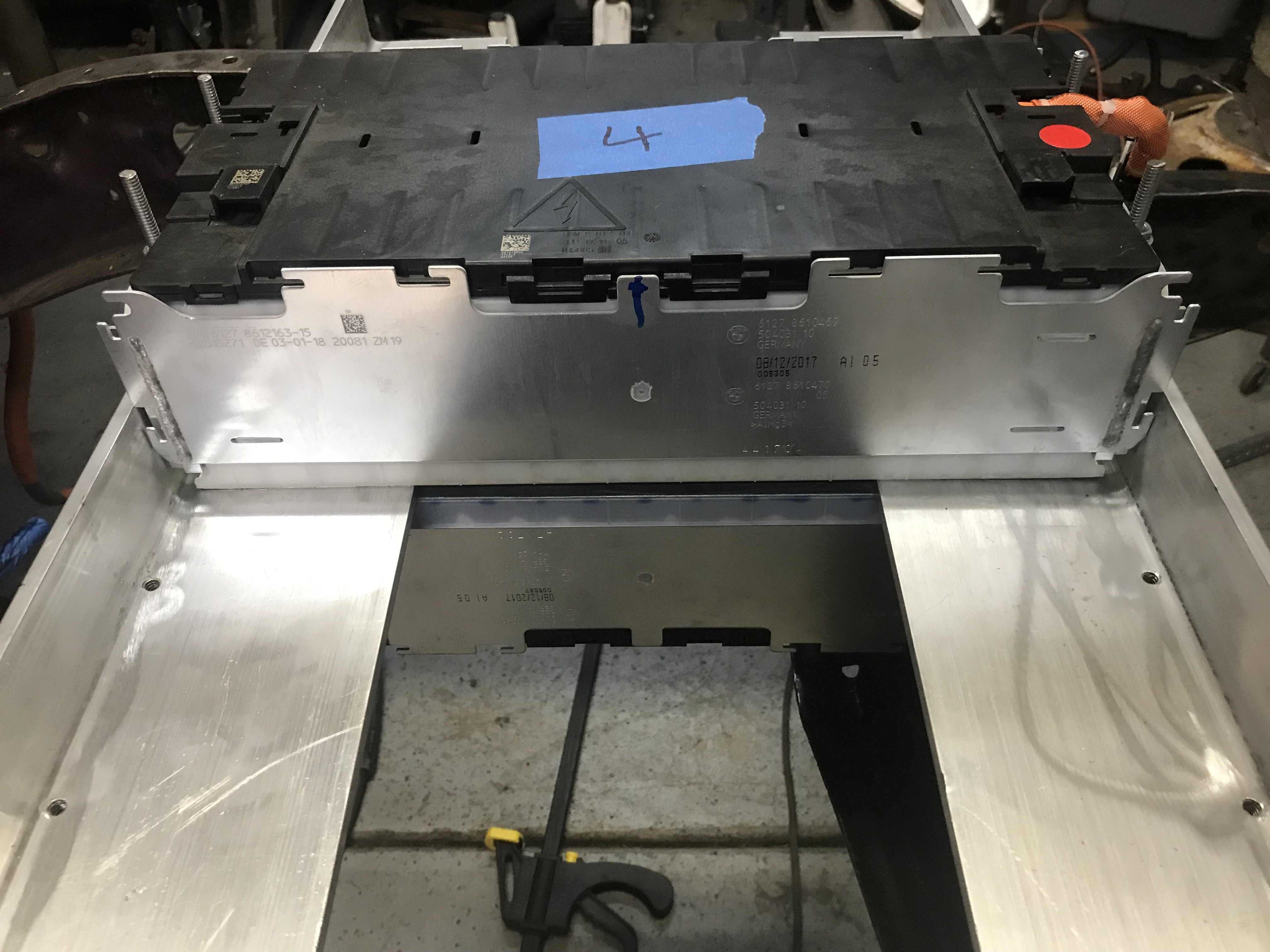

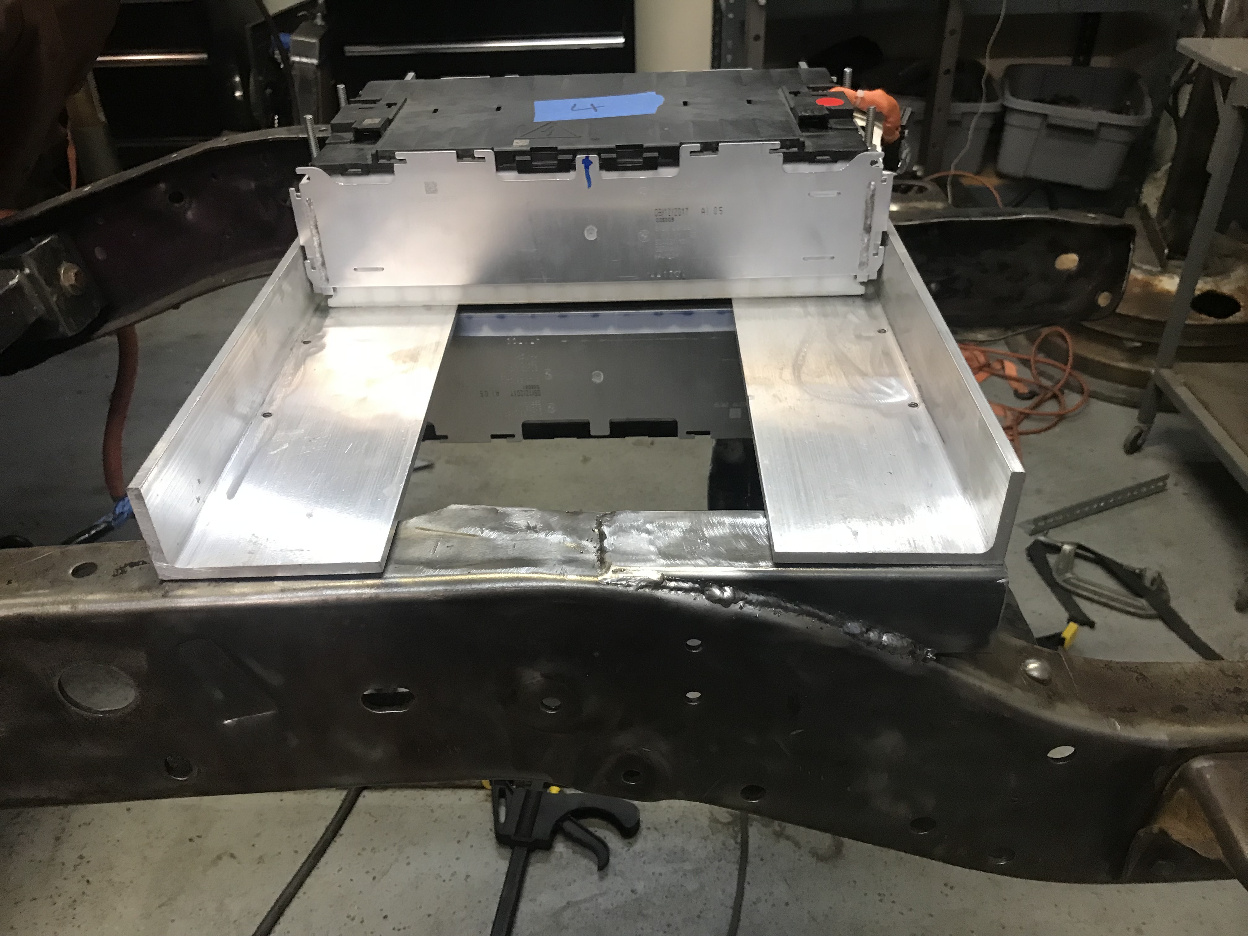

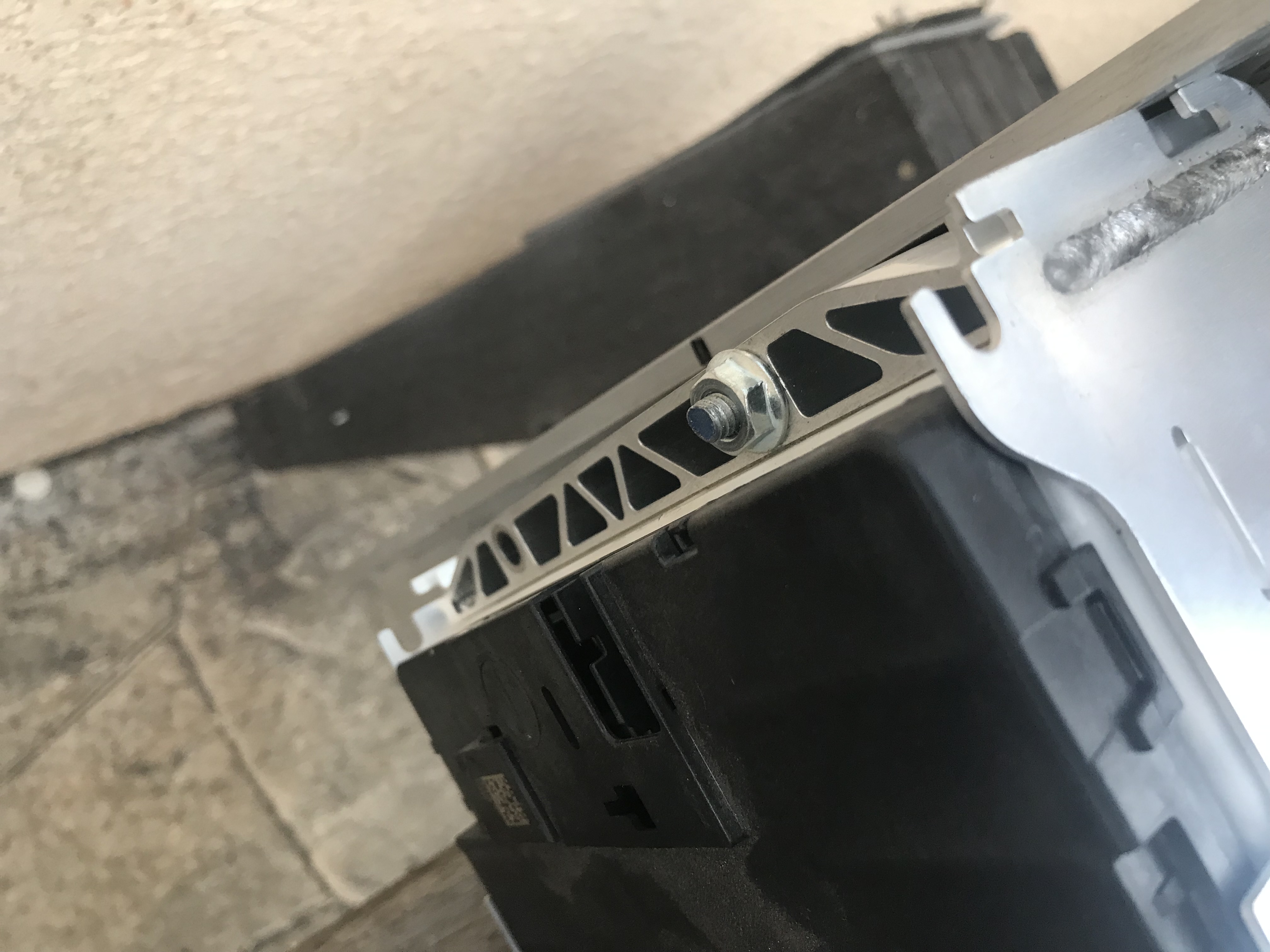

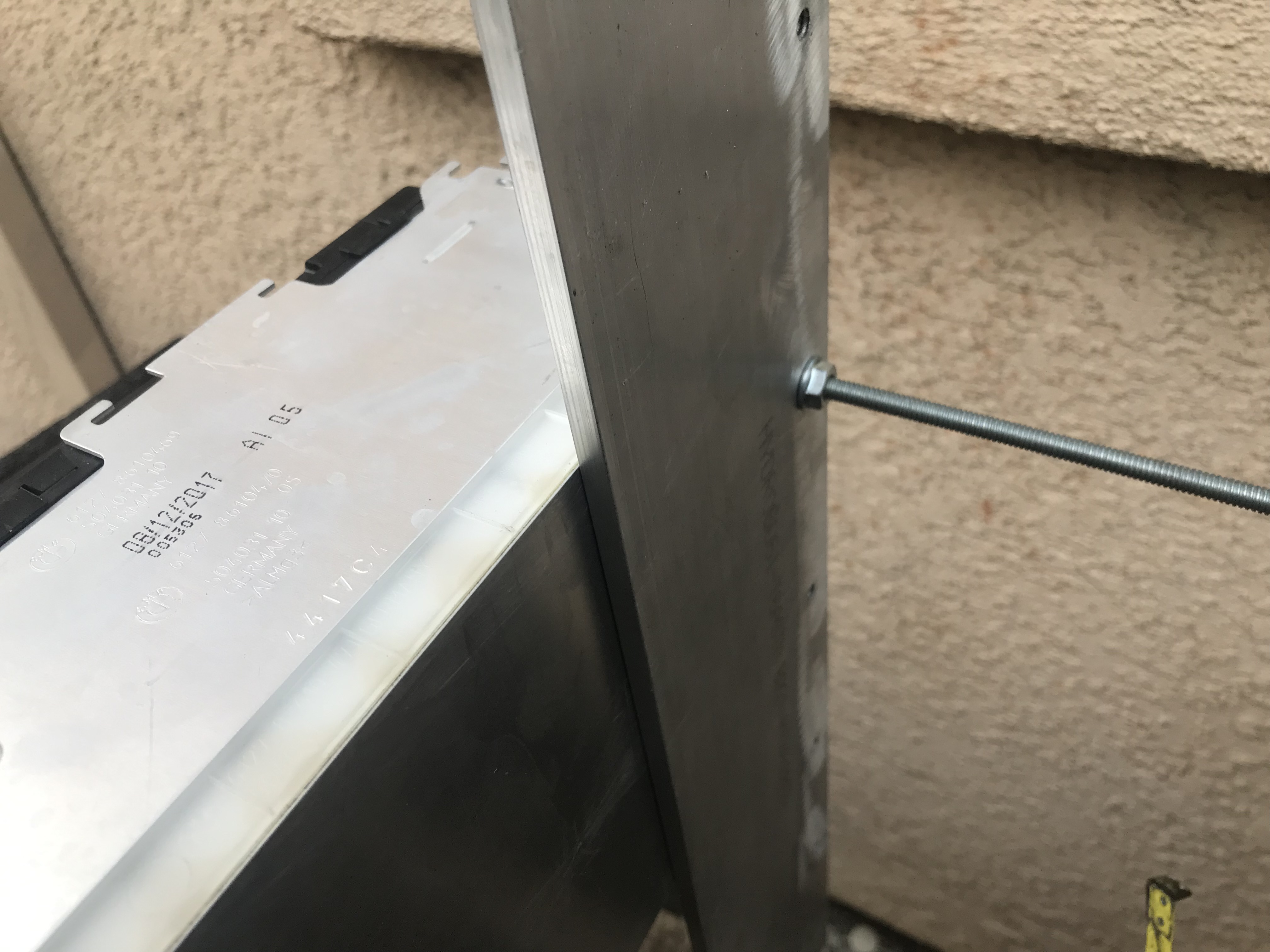

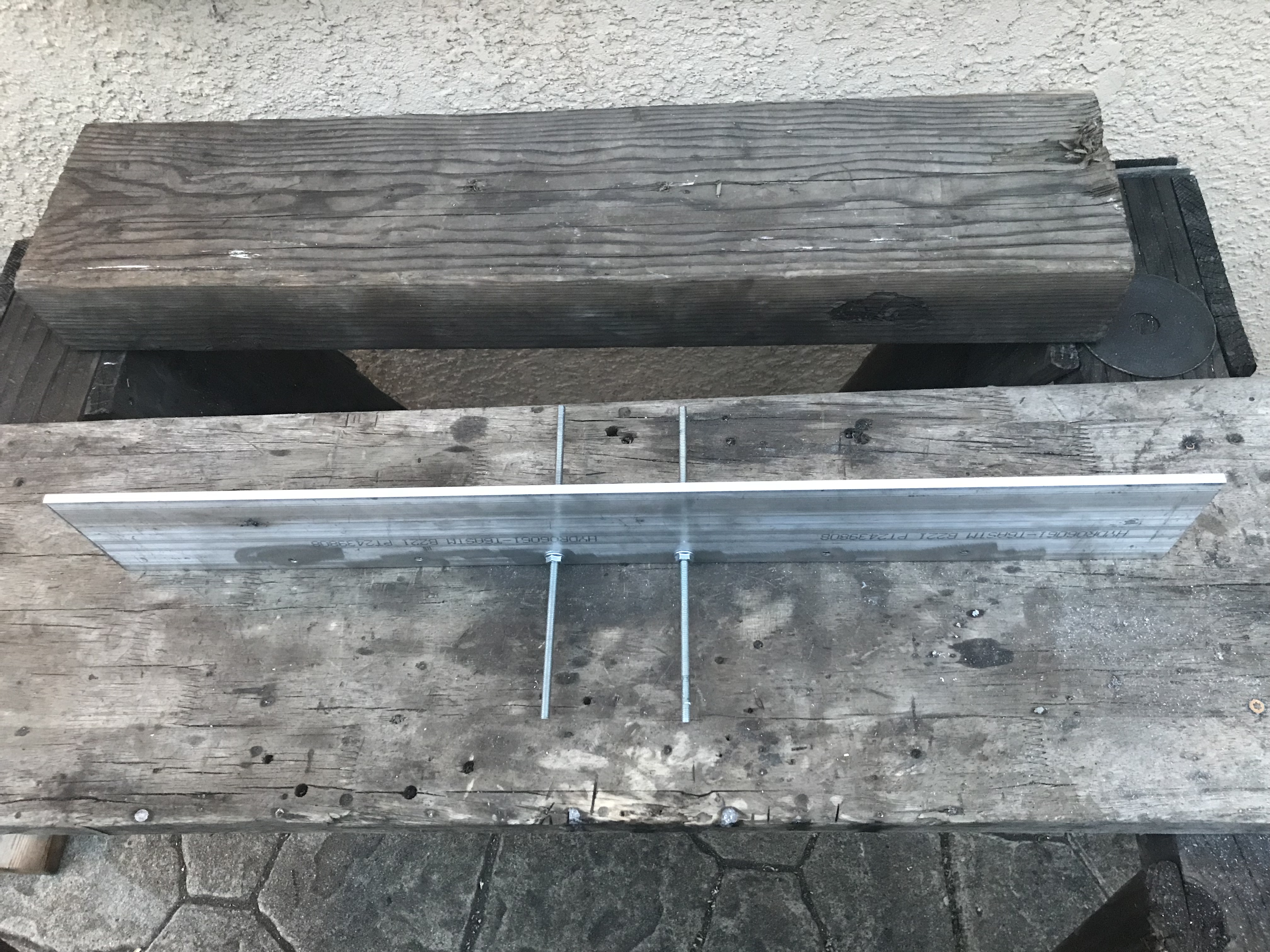

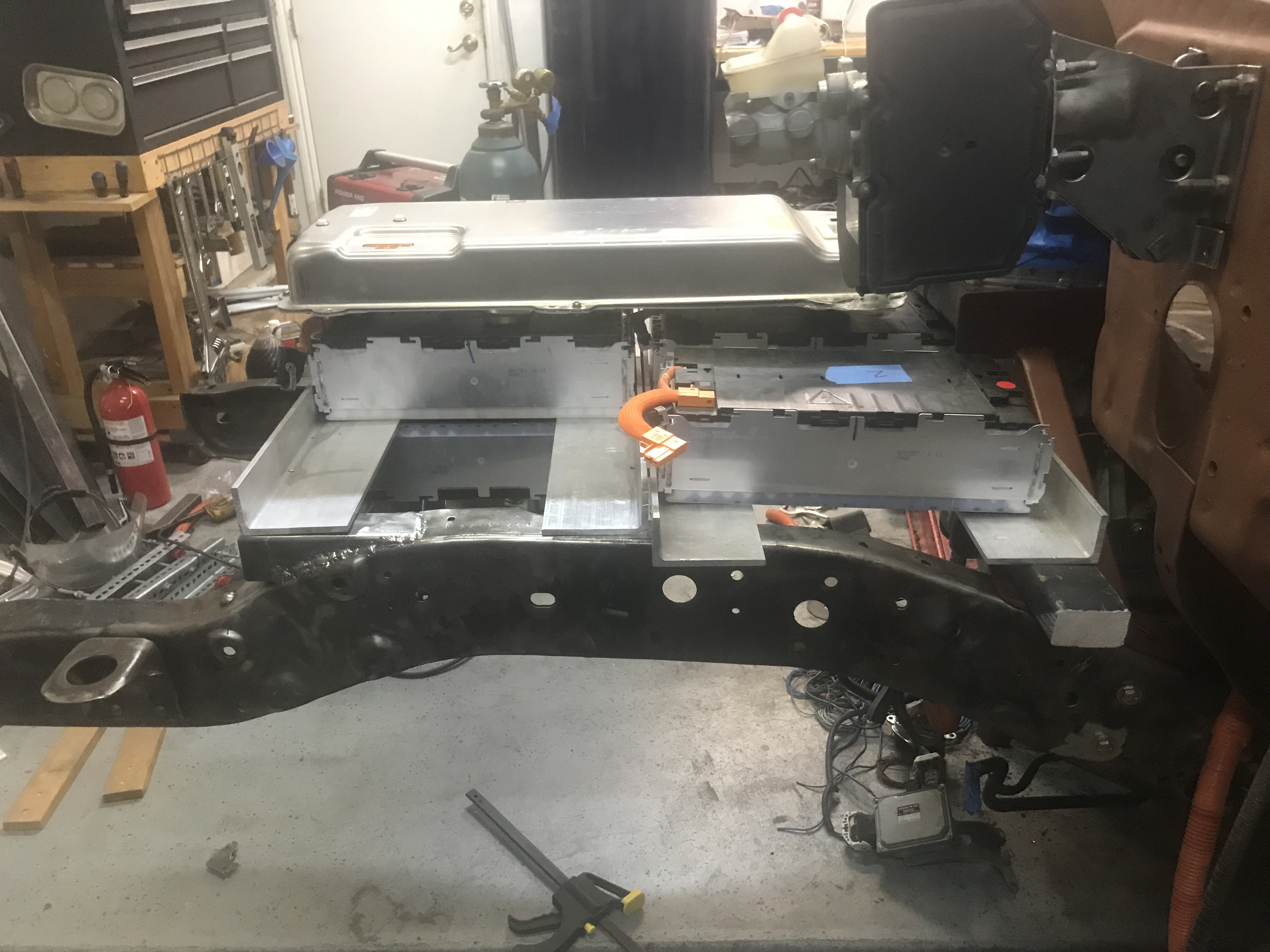

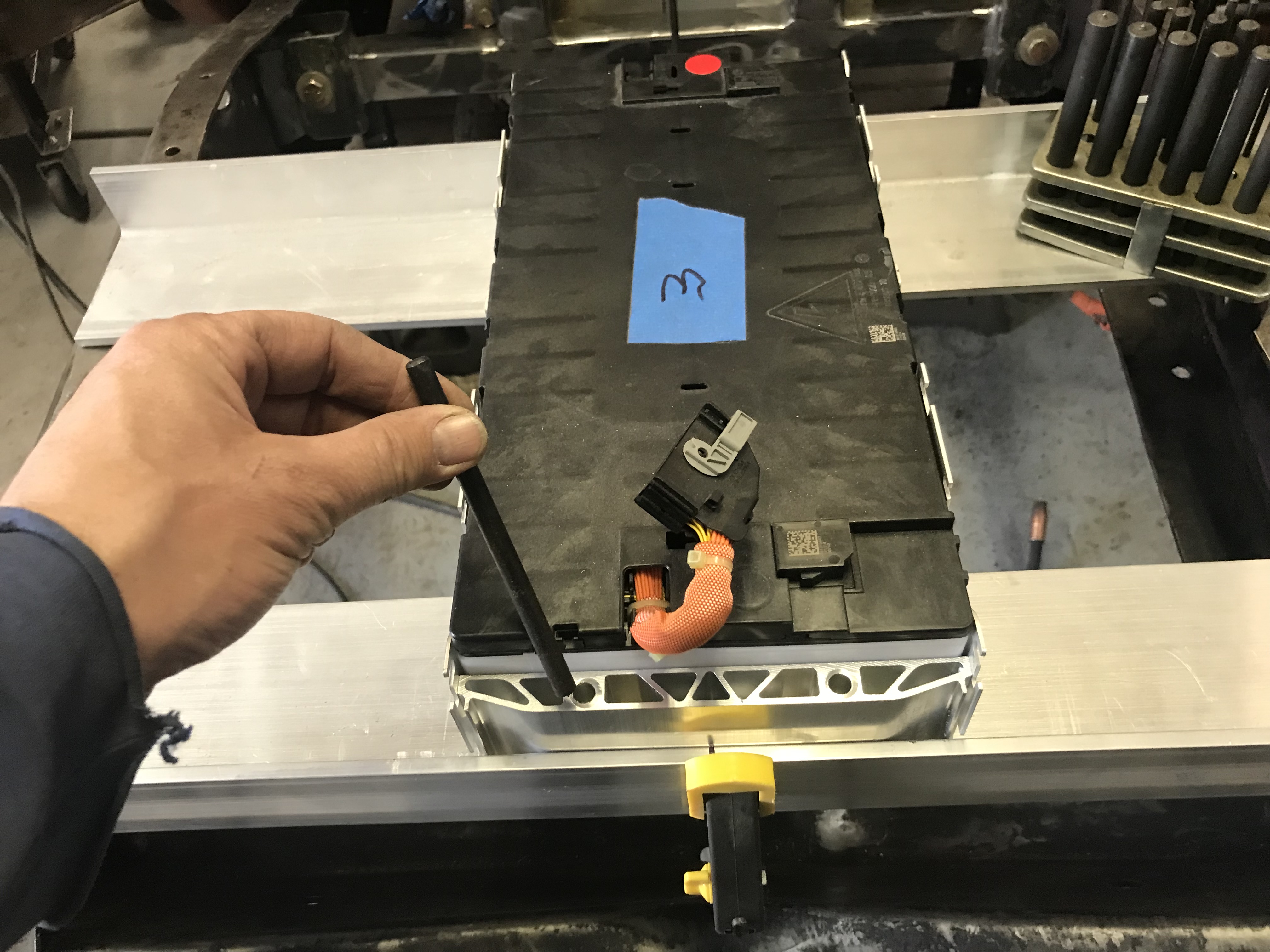

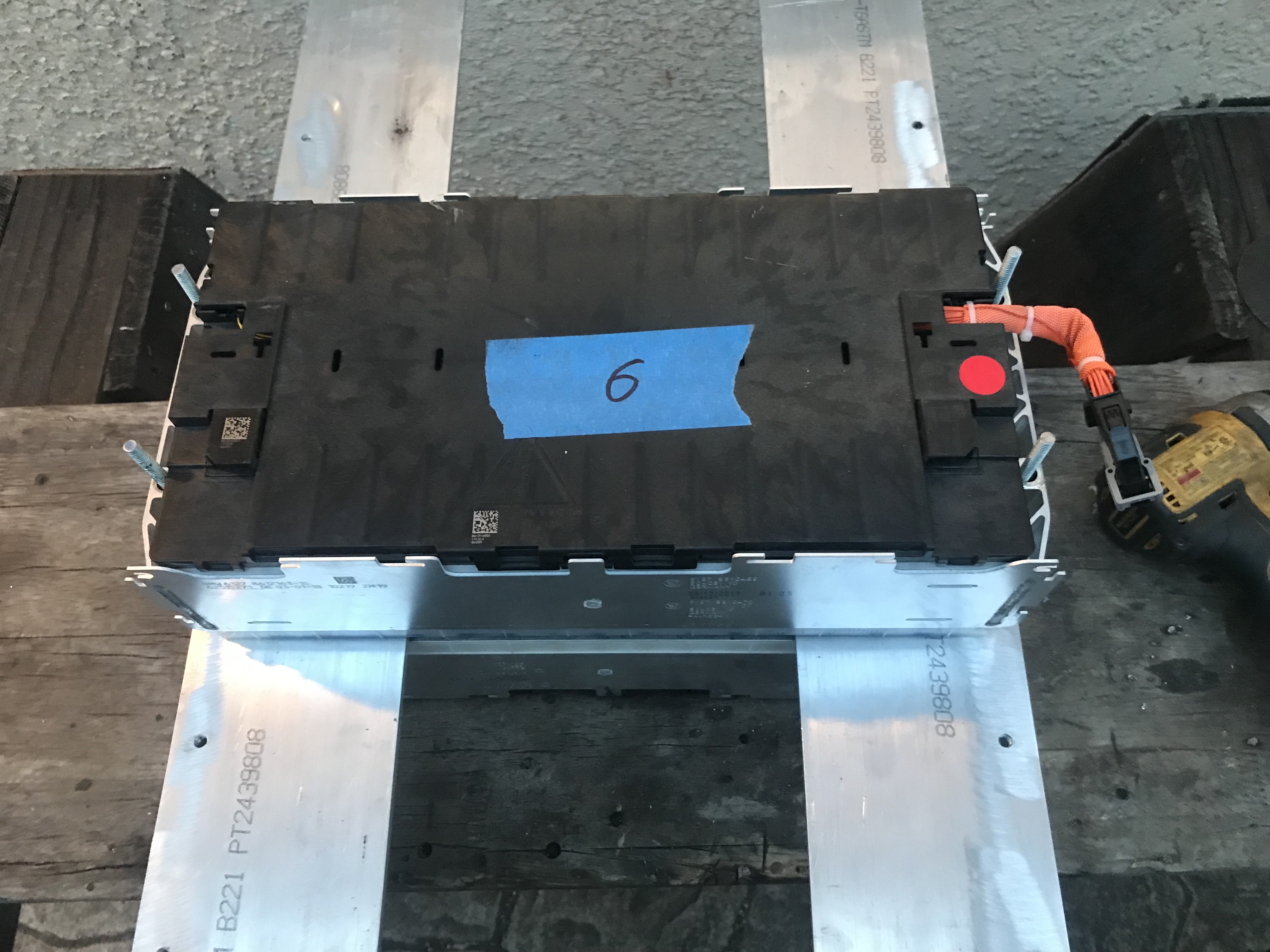

so one on top and one on the bottom, upside down, bat style
- Gregski
- Posts: 2873

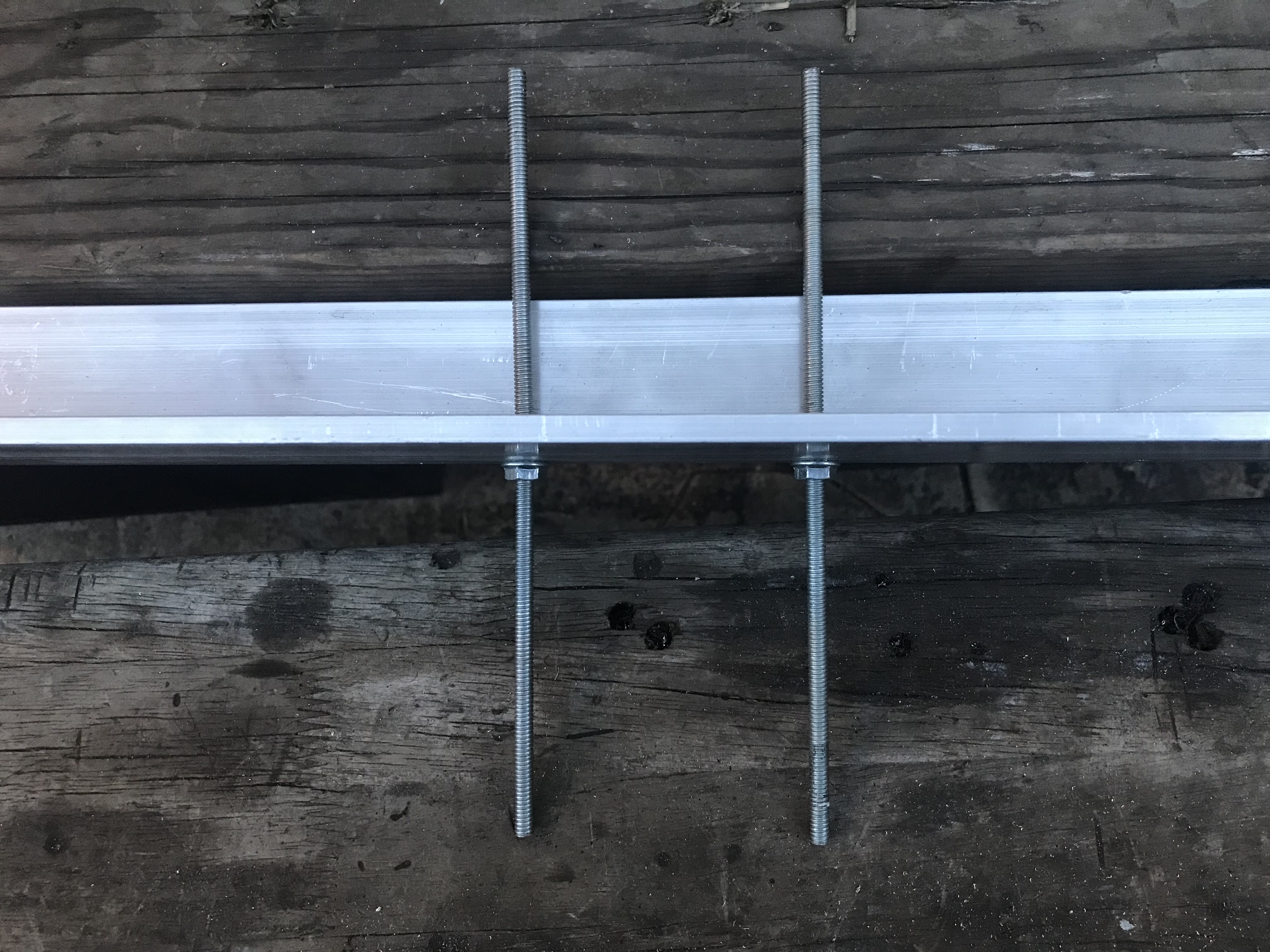

so this is the Oreo Cookie battery tray design, respectfully stolen from Sir Artur Kustusch
you know the saying: Good EV Converters borrow, Great ones steal!
Nice work, never even thought of mounting bmw modules upside down

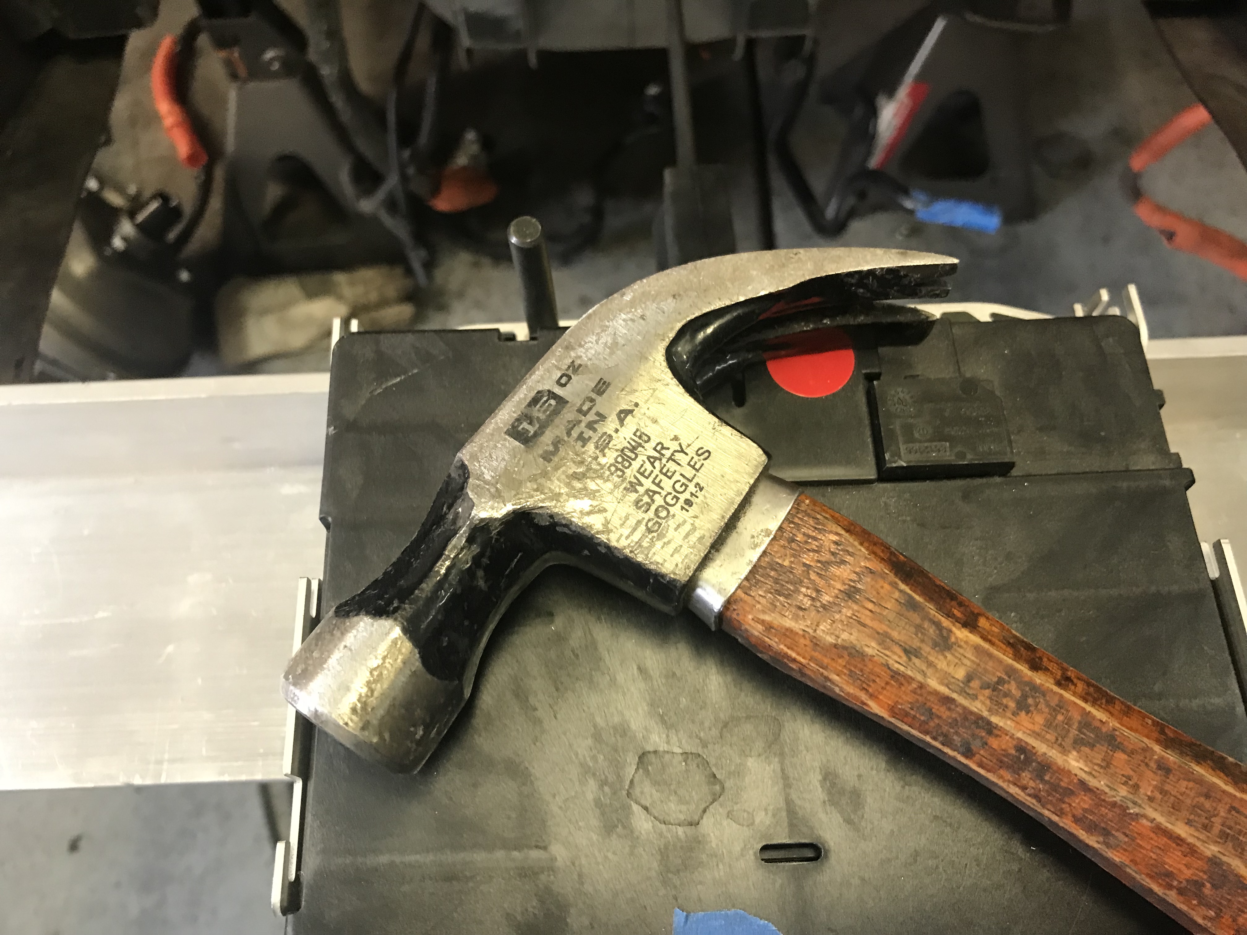

Captains Log: Day 67 of the EV Conversion
I spent the entire afternoon/evening just spinning my wheels, ever had one of them days? I think I worked my butt off but honestly all I got to show for it is one hole that I drilled right under the firewall, which took undoing the entire cab and lifting it up 5 feet, that and an empty bottle of Cab

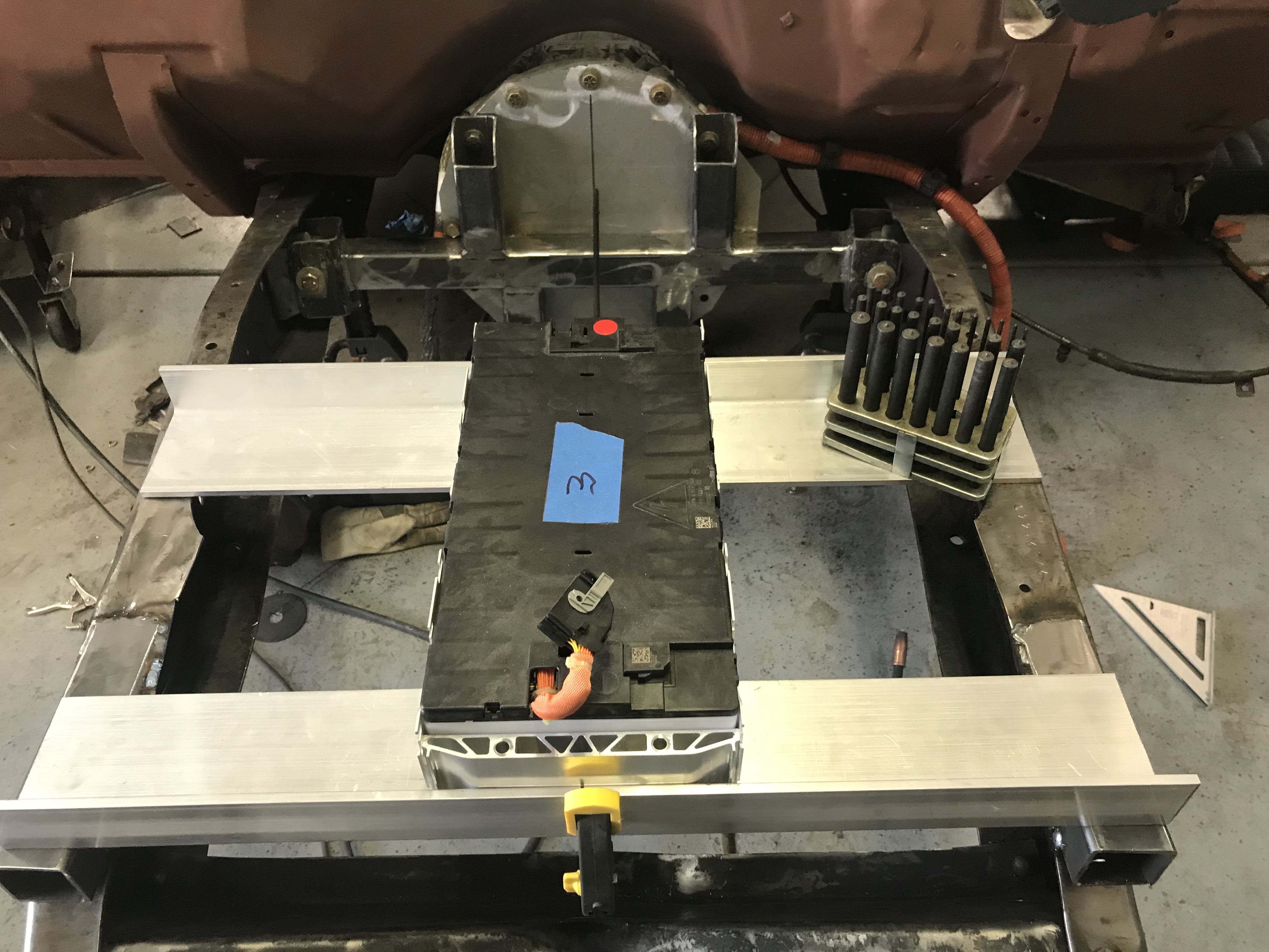

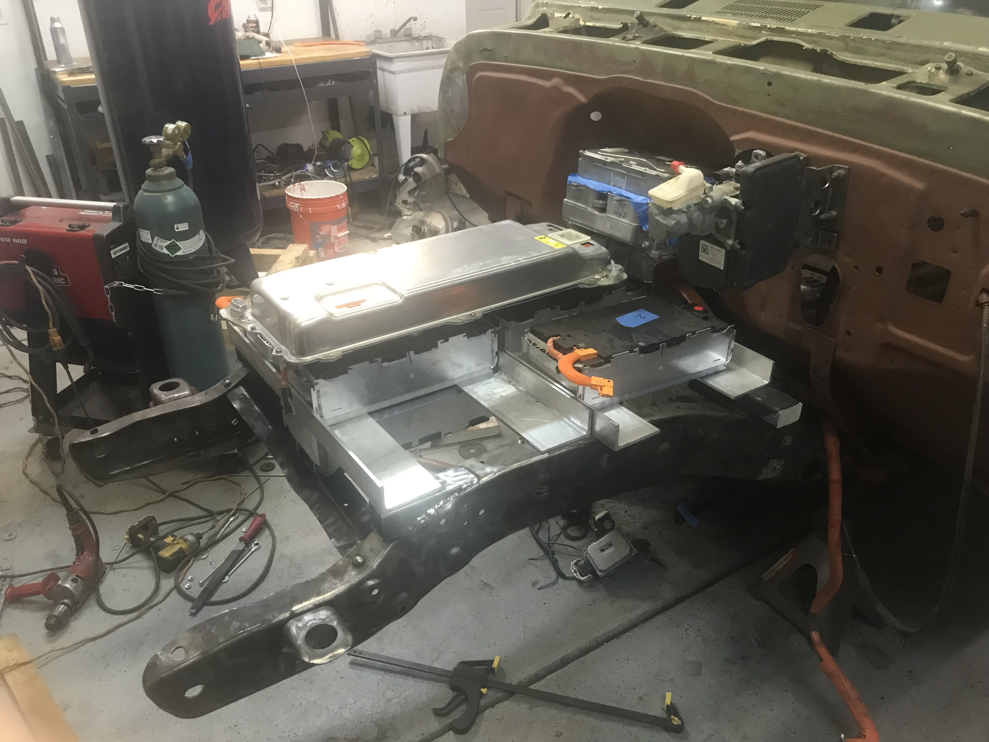

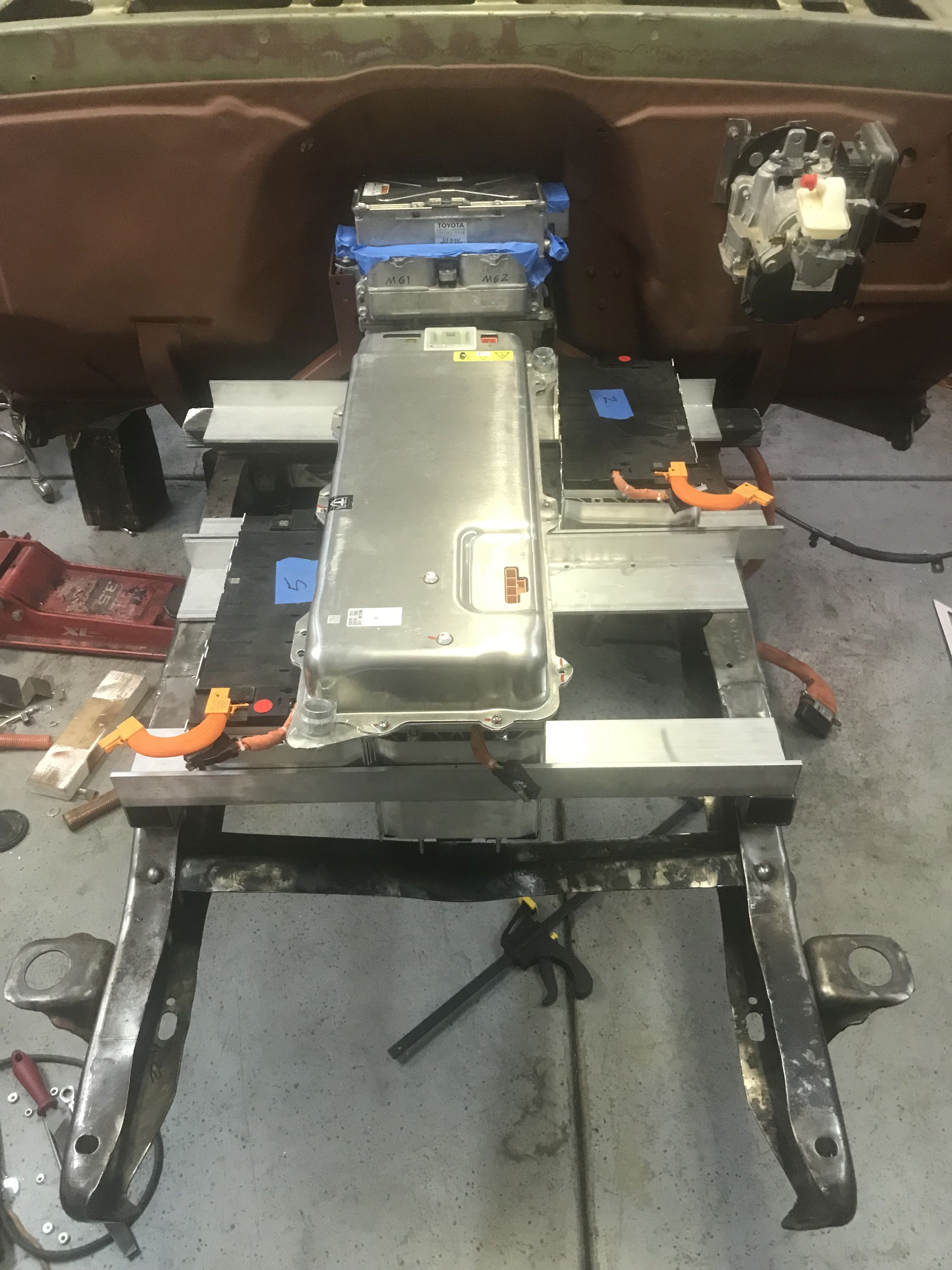

so here's a peak looksee what we are going for, I don't even know if that Tesla Model 3 battery charger / DC-DC converter combo unit [ahem, sorry Power Conversion System, PCS] is laying on there right side up or upside down, (you tell me, ha ha)
I am also entertaining shoving it under where the oil pan used to live there may be just enough of a cavity to bolt it up to the battery tray from underneath, for that German like impossible to get to to troubleshoot feel
