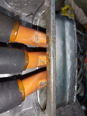

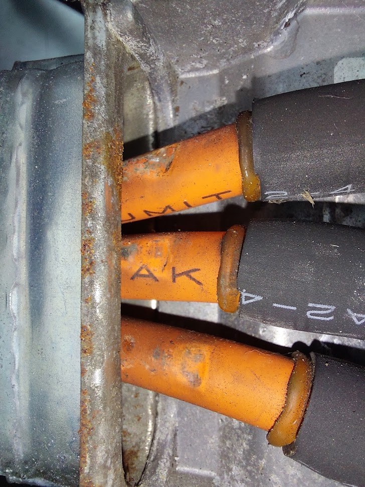

Just a friendly reminder for those who is about to use standard GS450h HV cables as they is. They tend to wear under interference screen caps. In some period of time a short circuit might occur.
Don't know if this issue was already exposed, so warning just in case
