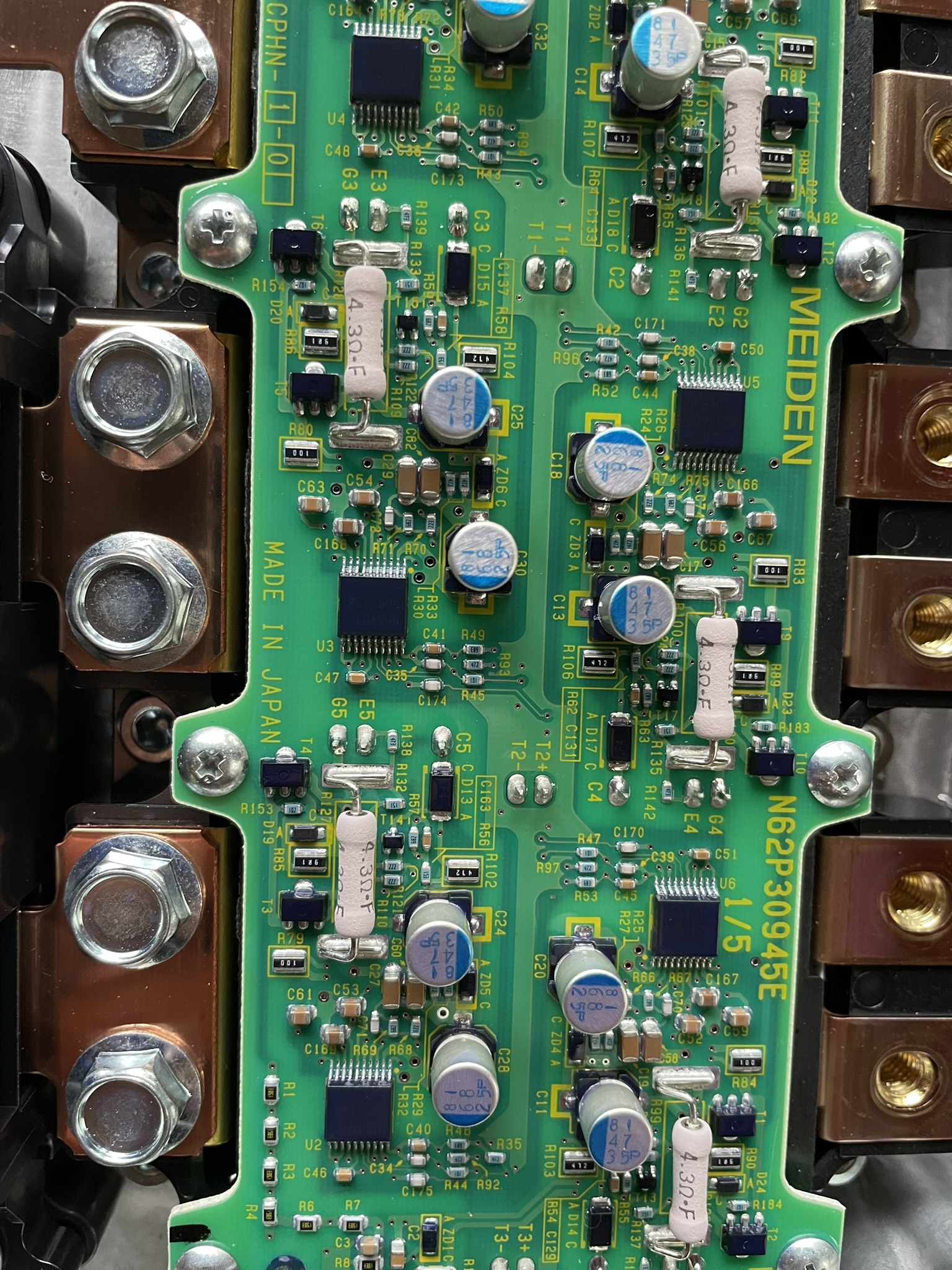

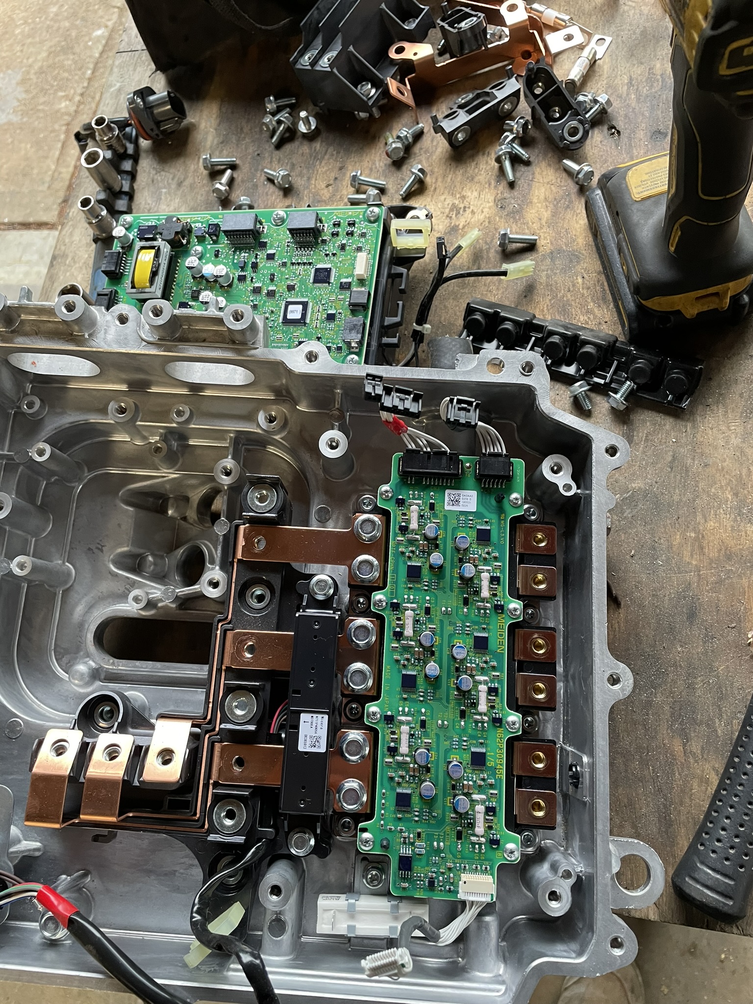

did a little brief tear down of the rear inverter, as id like to de bulk it and save some weight/space.

Under those mainboards there are some igbt with their classic connectors that can be managed with a classic openinverter setup (gates driver+sensor board) ?
My question may seem strange, but CAN management seems impossible to me at this moment.

chentron wrote: Fri Oct 27, 2023 11:56 pm Under those mainboards there are some igbt with their classic connectors that can be managed with a classic openinverter setup (gates driver+sensor board) ?
Yes this is possible, i planned to do this with a Lebowski board before the CAN protocol was available, you would have to keep the mainboard on the top as it handles the isolated voltages, then you would patch into the gate drivers and current sensors.

the great would be that Bratitude will send a photo with all motherboard unmounted, so we can see the naked igbt

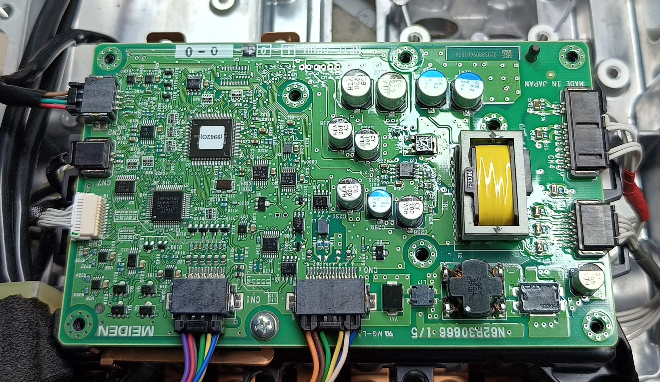

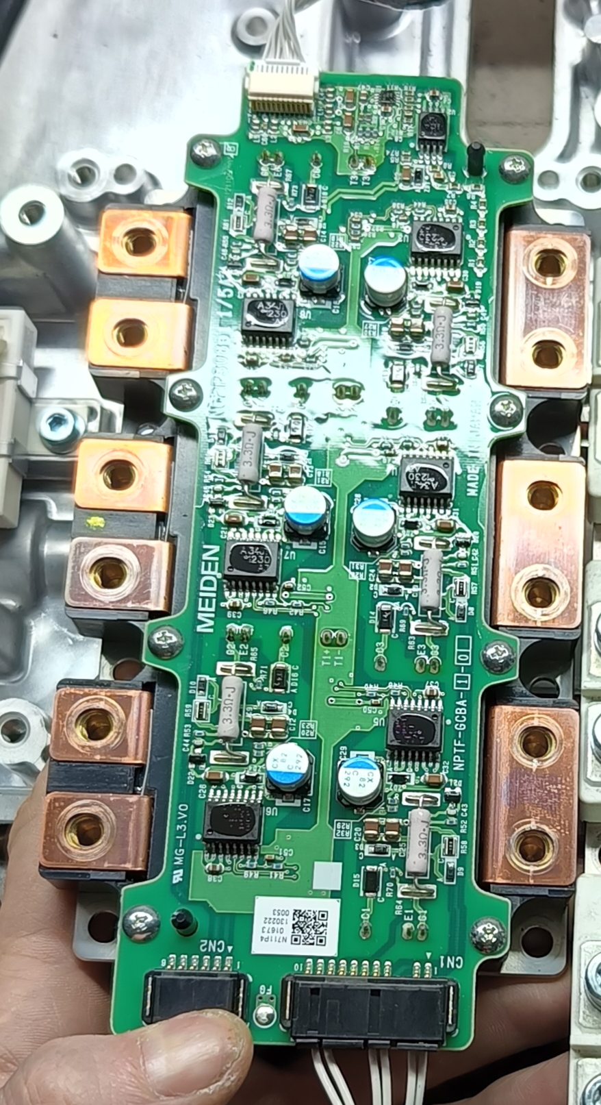

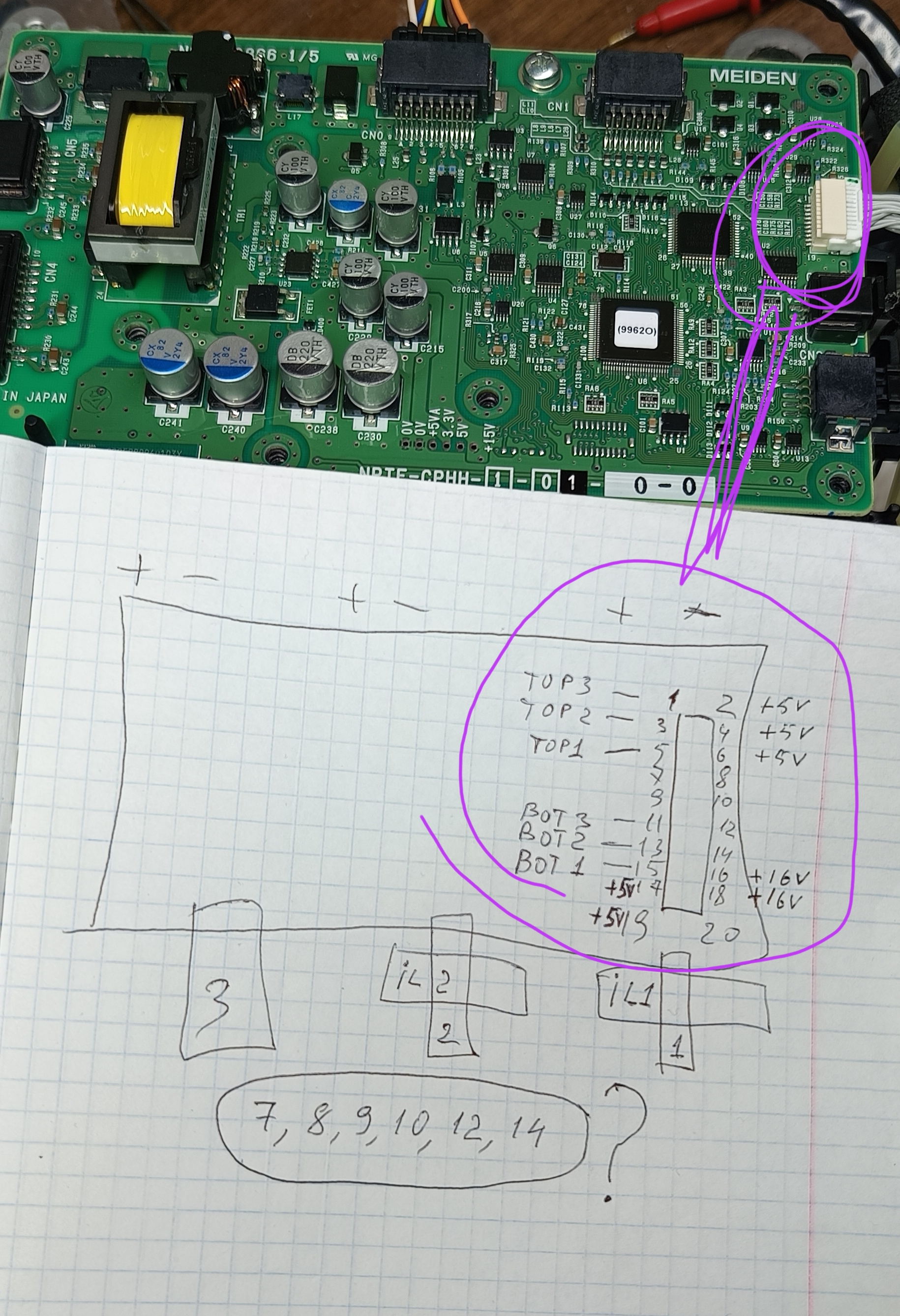

chentron wrote: Sat Oct 28, 2023 2:45 pm the great would be that Bratitude will send a photo with all motherboard unmounted, so we can see the naked igbt
as you can see. the driver power is on the top board. However, I could not identify the main entrances at random.
I also have a desire to saw off the extra part of the case and try to get at least 150 kW from this invertor using the OI v3 board, but the main difficulty is not knowing where the input is.
Is there someone here who knows exactly the purpose of all the pins on this inverter?
evil neodymium :twisted:

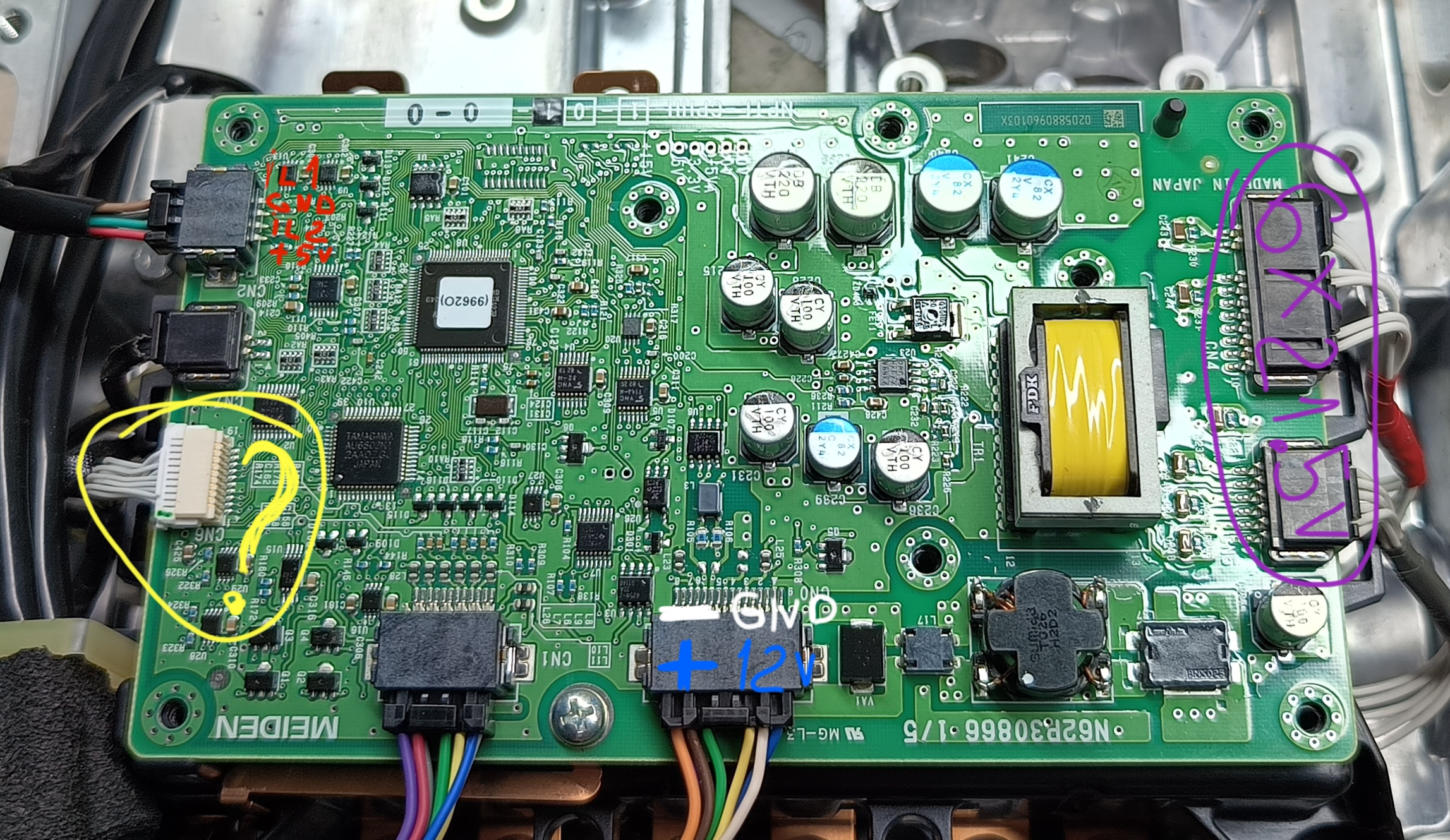

I figured out a bit about the pins on the board.
it remains to find out where the output of information about HIGH volts, temperature and which numbers to give a low sig to open the drivers?
Is anyone familiar with this information?
I'm sure it can easily be connected to a leaf motor or any similar one.

having investigated something by the method of scientific poke (at random) I found out anyway)))

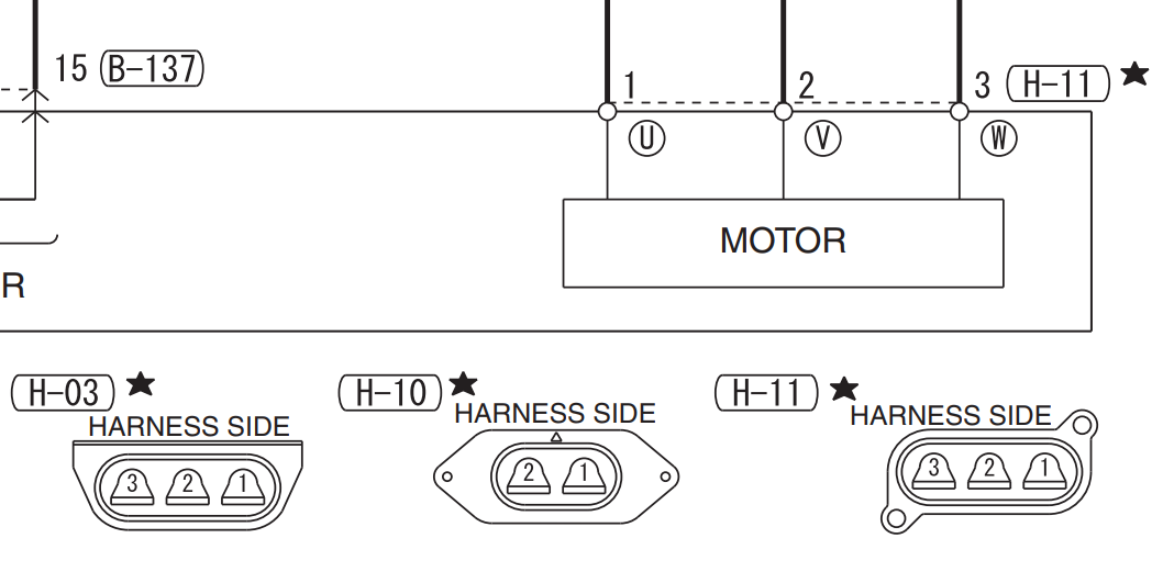

The cable you have linked is from the Front Motor, therefore the incorrect connector.
The service manual however has a nice schematic and in the lower section it has the pinout of the connectors.
http://mmc-manuals.ru/manuals/outlander ... C00ENG.pdf
For the actual cable glands, you can use my 3D printed ones: viewtopic.php?t=3563
FFMan
Posts: 343
Joined: Mon Jul 25, 2022 7:59 pm
Has thanked: 9 times
Been thanked: 50 times
Post by FFMan »
crasbe wrote: Tue Dec 05, 2023 1:26 pm The cable you have linked is from the Front Motor, therefore the incorrect connector.
thanks - i had come across that diagram, and i see the motor phasing, but is it possible to identify each phase on the inverter and the motor. Obs the central one is fine, but i can't see any marks anywhere that help get the other 2 the right way round ?

crasbe
Posts: 330
Location: Germany
Has thanked: 58 times
Been thanked: 180 times
Post by crasbe »
The schematic has U V W with 1 2 3 and the lower pinouts of the connectors has the according 1 2 3 markings. That way you can identify the phases and it says "Harness side" as an identifcation from where to look.
crasbe
Posts: 330
Location: Germany
Post by crasbe »
Oh, I linked the wrong PDF. The one I liked is for the front motor. You need this one:
Same idea though.
