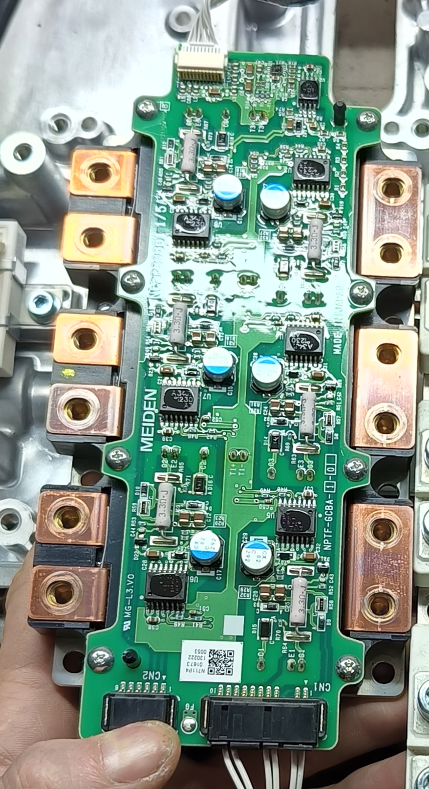

did a little brief tear down of the rear inverter, as id like to de bulk it and save some weight/space.

Under those mainboards there are some igbt with their classic connectors that can be managed with a classic openinverter setup (gates driver+sensor board) ?
My question may seem strange, but CAN management seems impossible to me at this moment.

Yes this is possible, i planned to do this with a Lebowski board before the CAN protocol was available, you would have to keep the mainboard on the top as it handles the isolated voltages, then you would patch into the gate drivers and current sensors.

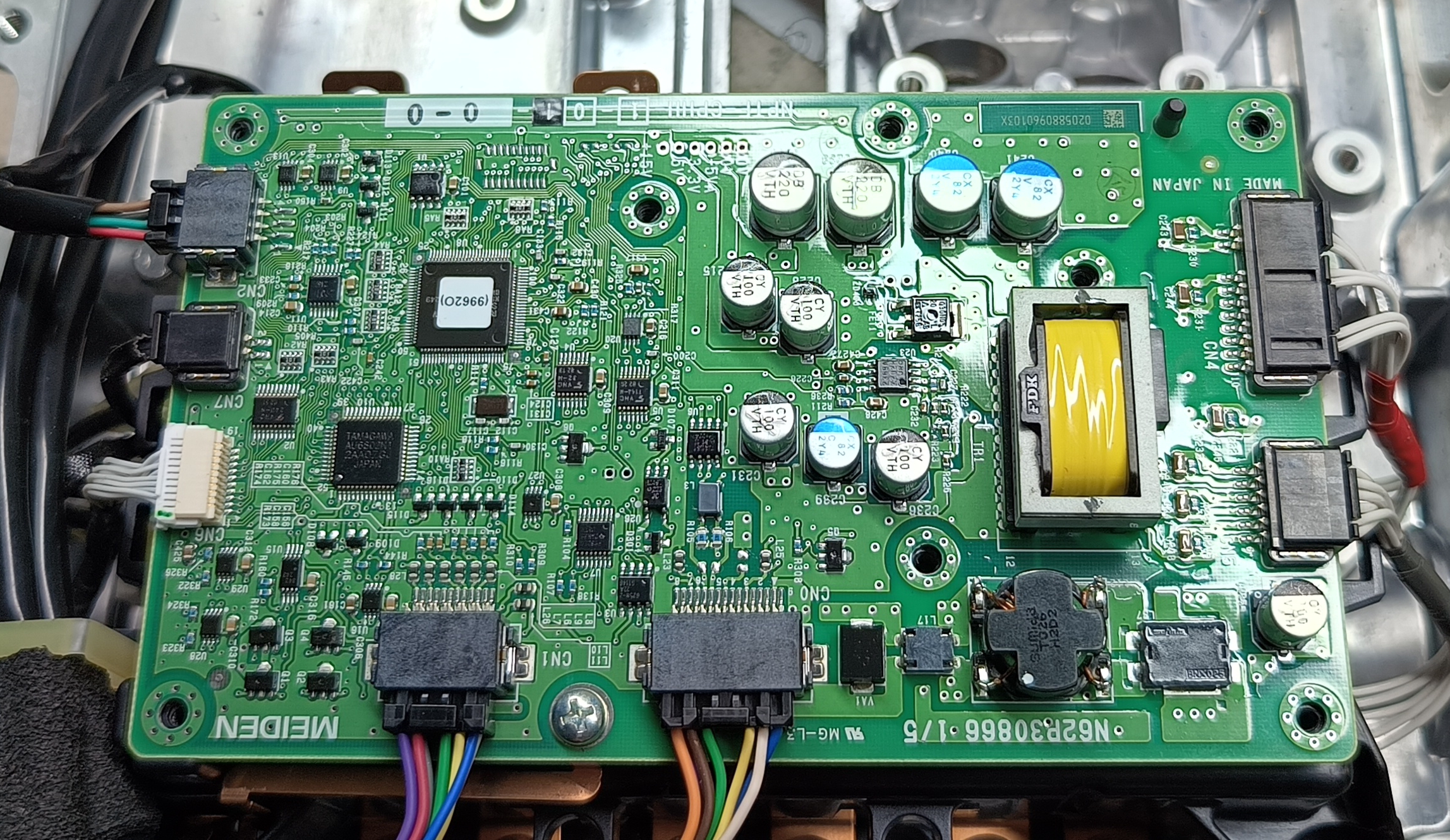

the great would be that Bratitude will send a photo with all motherboard unmounted, so we can see the naked igbt

I dont have the pinouts anymore, but i can tell you that the signals you need are on the white connector.
The black side needs to be plugged in to supply the gate drivers isolated voltage.

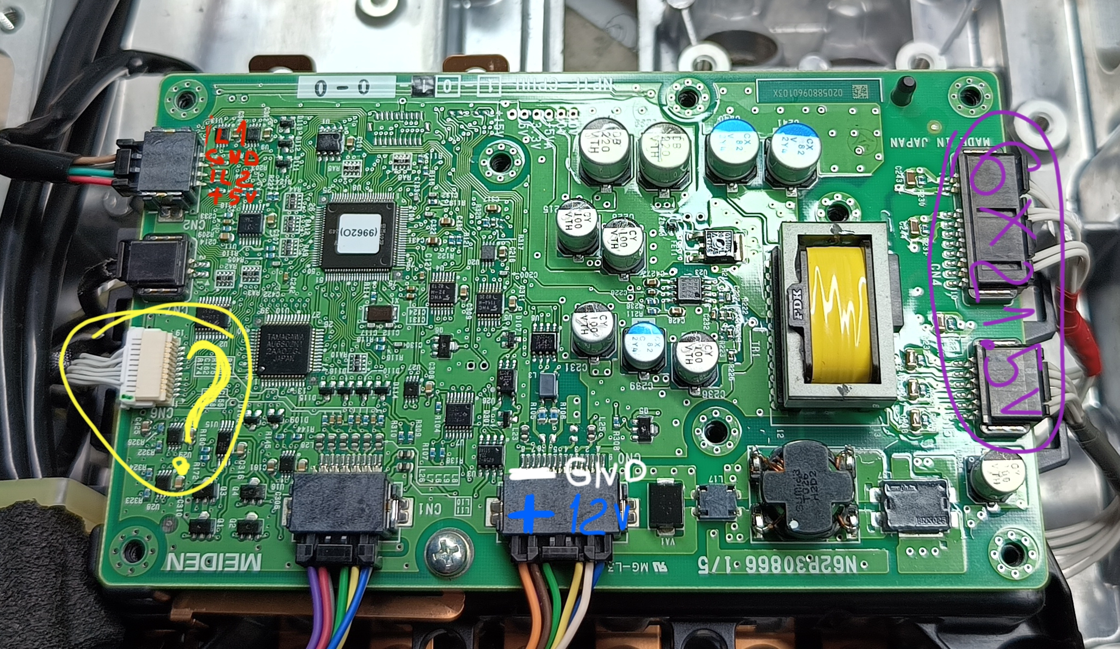

as you can see. the driver power is on the top board. However, I could not identify the main entrances at random.
I also have a desire to saw off the extra part of the case and try to get at least 150 kW from this invertor using the OI v3 board, but the main difficulty is not knowing where the input is.
Is there someone here who knows exactly the purpose of all the pins on this inverter?

I figured out a bit about the pins on the board.
it remains to find out where the output of information about HIGH volts, temperature and which numbers to give a low sig to open the drivers?
Is anyone familiar with this information?
I'm sure it can easily be connected to a leaf motor or any similar one.

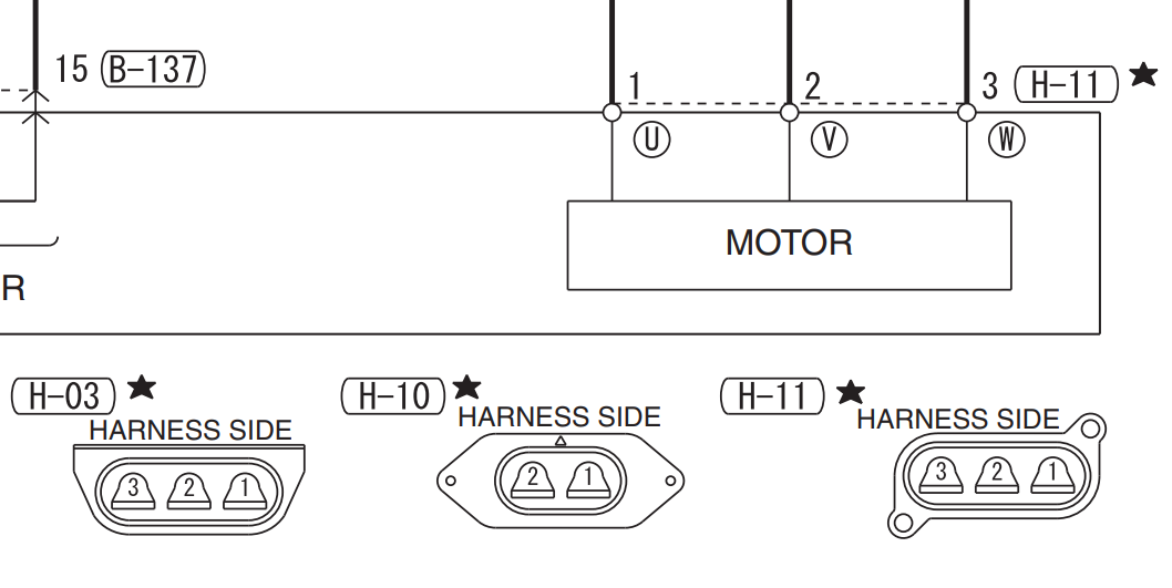

new caller to this thread as am working on this combo (Outlander rear motor and inverter) to replace my prius inverter coupled to outlander rear which has died after 1000 miles of use and refuses to resurrect. rather than buying a new prius openinverter board I'm here
I have 2 outlander rear motors (one in the car, not working on prius inverter) and one on the bench. I have the rear inverter and that is powered and spitting out can messages etc. I have the resolver cable to join the motor to the inverter which is handy. I have sample code which all looks fairly straightforward (ha).
What i don't know and doesn't appear to be marked on either end, is which way to connect the motor phases. I have the short motor cable which claims to be the right one https://www.ebay.co.uk/itm/314893460508 but the clamp on one end is wrong so i'm not convinced. The cable can be made to work if i know the phasing.
thanks

The cable you have linked is from the Front Motor, therefore the incorrect connector.
The service manual however has a nice schematic and in the lower section it has the pinout of the connectors.
http://mmc-manuals.ru/manuals/outlander ... C00ENG.pdf
For the actual cable glands, you can use my 3D printed ones: viewtopic.php?t=3563

thanks - i had come across that diagram, and i see the motor phasing, but is it possible to identify each phase on the inverter and the motor. Obs the central one is fine, but i can't see any marks anywhere that help get the other 2 the right way round ?crasbe wrote: ↑Tue Dec 05, 2023 1:26 pm The cable you have linked is from the Front Motor, therefore the incorrect connector.

The schematic has U V W with 1 2 3 and the lower pinouts of the connectors has the according 1 2 3 markings. That way you can identify the phases and it says "Harness side" as an identifcation from where to look.

Oh, I linked the wrong PDF. The one I liked is for the front motor. You need this one:
Same idea though.
