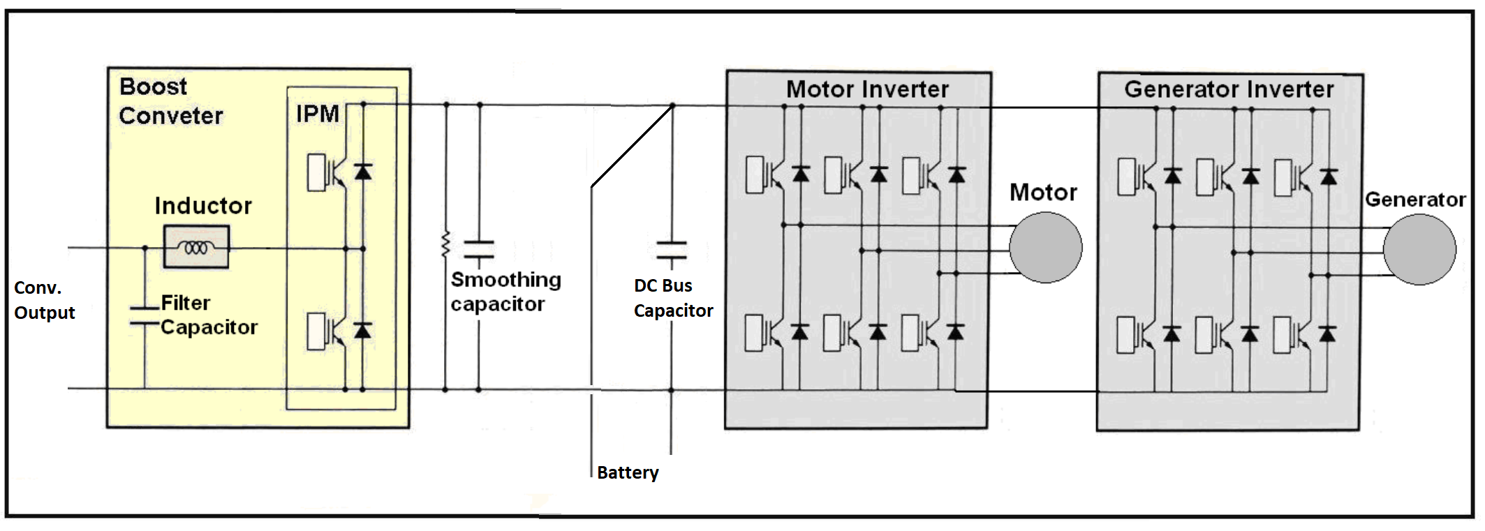

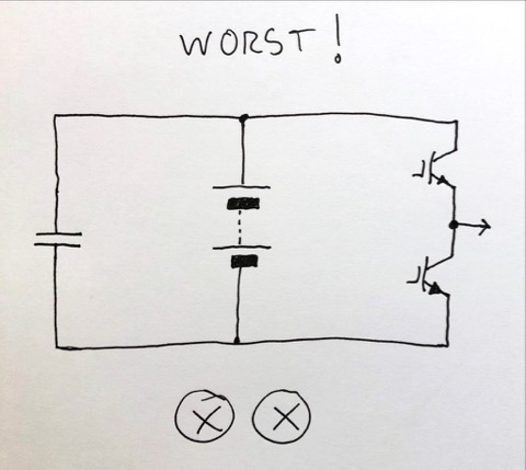

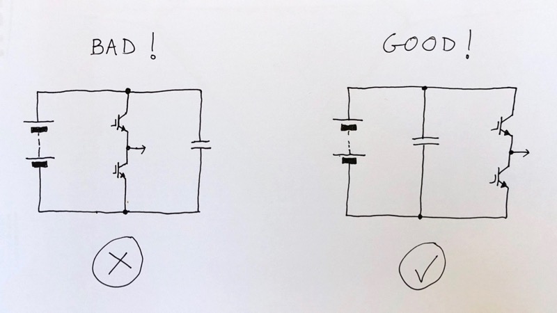

Ok. So I pose the question why did the smallest cap with the highest voltage rating blow? Why do we have a 0.5uf 900v cap in parallel with the big 888uf cap? Well, its a snubber. Designed to soak up excess spikes and ringing on the main DC bus. So there must have been excess spikes and ringing on the dc bus. Why? BECAUSE SOME MORON INJECTED THE HVDC INTO THE WRONG PART OF THE INVERTER THUS BYPASSING THE DC LINK!
I committed the cardinal sin of power stage design. By injecting the high voltage into the terminals I used we effectively created a star connection of battery, igbts and caps instead of a parallel connection. Its a miracle the car made it out of the driveway!

How is that possible? Will you enlighten us?
Posts: 4000
Been thanked: 1115 times
Re: Can't Kill A Toyota Inverter
Video shortly. Bit too much to type:)
Edit : Short version V=L di/dt :)

:shock: OK... what was supplying the current then? I thought you bypassed inductor not put it in parallel?
Hm... i am very interested in your results since a lot of my assuptions depend on your results.

not entirely familiar with the internals if the gs450h inverter are there similar considerations needed , does the side port connection that bypasses the buckboost converter create a similar star connection?

Hmm, thats exactly how my Polo inverter is wired up. The battery cables connect right to the same terminals as the first snubber on the right. No blow for 7 years. Maybe the low power (500V, ~100A DC) and 10 Ohm gate resistors are beneficial there?

I think the key in your configuration is that your large caps are closer to the igbt:s. Yo have also 3 snubber caps. Damien connected battery bethween igbt:s and almost all caps.

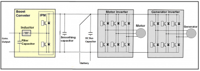

Ah, so more like:

I am more interested in how to use inverter to drive MG2 power stage AND use MG1 to charge HV battery through inductor.
The way you describe wiring your inverter inductor will be shorted and you cant use it.
But if you connect to the 220Vdc terminals and have the buck/boost transistor closed when diving MG2 you could only get like 30kW out of it no? Am i missing something?
Therefore i propose 500A contactor across inductor which would be switched off when charging. It could be wired with one AC relay so it would be off when you get AC on MG1 terminals...

TFirenza wrote: Tue Jun 09, 2020 6:11 pm not entirely familiar with the internals if the gs450h inverter are there similar considerations needed , does the side port connection that bypasses the buckboost converter create a similar star connection?
Yes definitely worth considering, we will have to review the internal layout of the caps. The original e46 conversion using the GS450h inverter from a few years back used this battery connection point and reported blowing up an inverter, but I’m not sure if this was a control issue.

Probably that and also with addition of you using large film caps which serve as a quick reservoir AND a snubber at the same time.

In the gs450h that is the most direct connection point to the main cap, can't get closer to it and there's no other "side" to it.
Can you short the boost converter and find large enough contacts for feeding enough current there? It's after all where Toyota makes the power go through, there's going to be more capacitors there to offset the cable inductance...

Also no need for any contactors. When in drive mode just turn the high side of the buck boost on. I'm going to try and write some muppet software for the atmega 328 to do just that.

Sorry I meant just to run the dcdc from the HV side without having to resort to a contactor to bypass the buck/boost stage. DCDC only draws about 5 or 6 amps max at 360v so no big losses there. Muppet code :
Just turns on the boost hi side always. Low side off always. Runs on prius and yaris/auris boards.
void setup() {
  pinMode(9, OUTPUT); //boost low side
  digitalWrite(9, LOW); //low side always off
  pinMode(10, OUTPUT); //boost Hi side
  digitalWrite(10, HIGH); //hi side always on
// the loop function runs over and over again forever
void loop() {
                     // wait for a second
Tested in a yaris inverter and seems to work on the bench.

Gahhhhh! I am not talking about running the inverter through the buck boost stage. Just running the dcdc from the main hv via the top side of the buck boost.
Posts: 1884
Has thanked: 91 times
Been thanked: 517 times
If I understand correctly, you're not going to bridge the high voltage side of the buck boost physically with a new wire but by just switching on the high side of the half bridge to enable the DCDC?

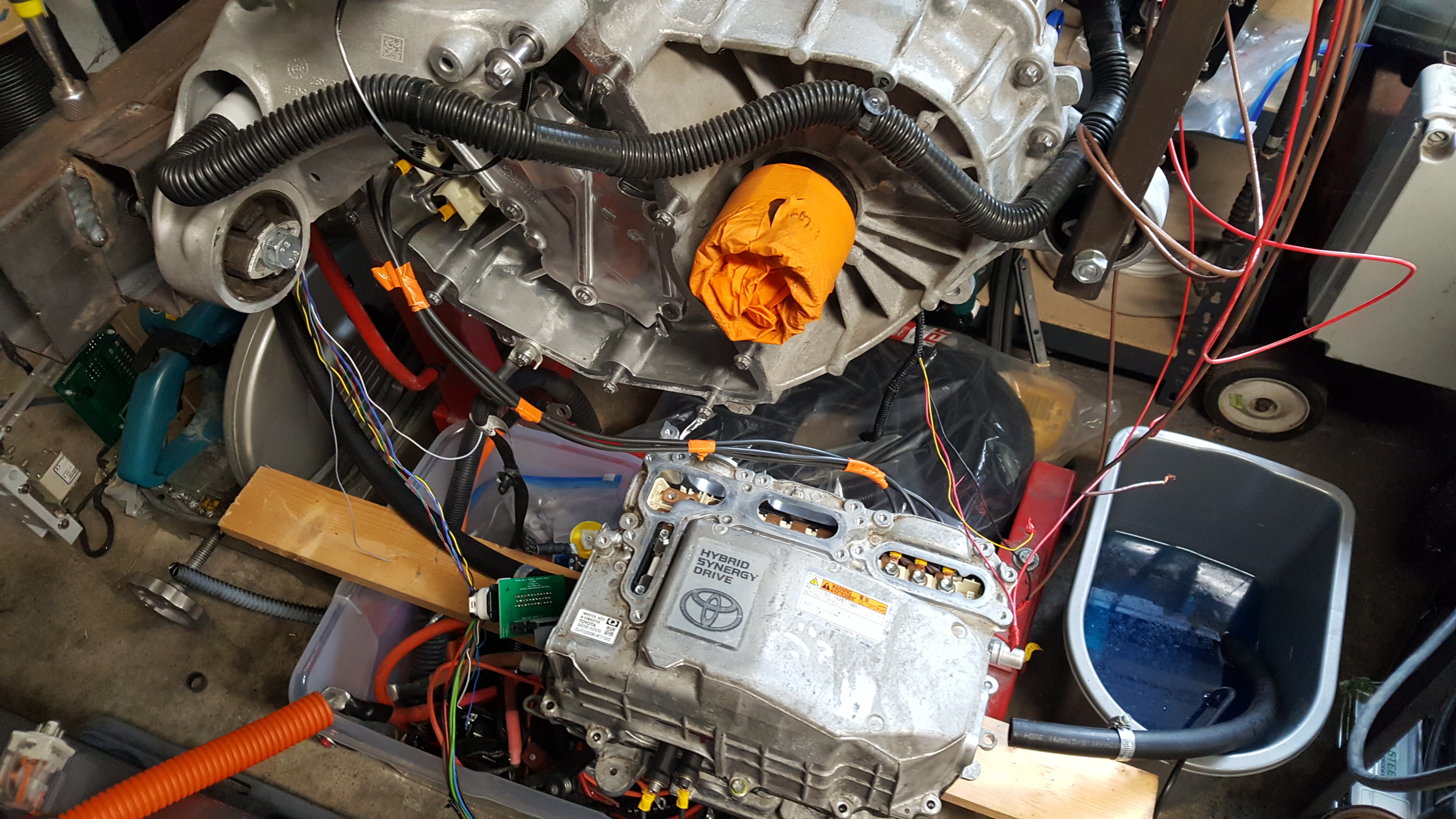

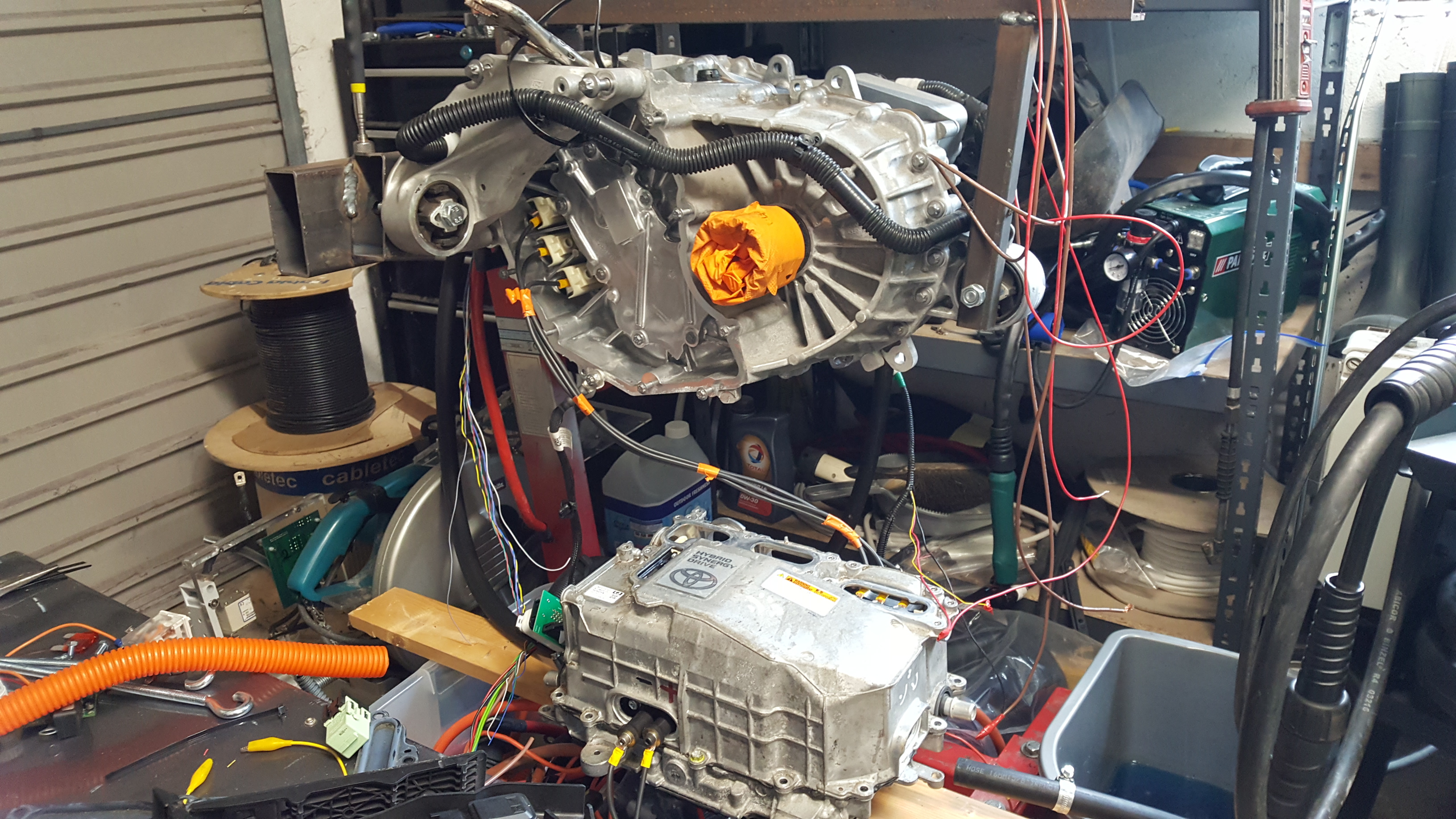

Tested on my Yaris inverter and model 3 drive unit. Muppet code works and lets hv through to the dcdc.
