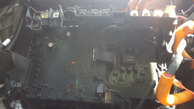

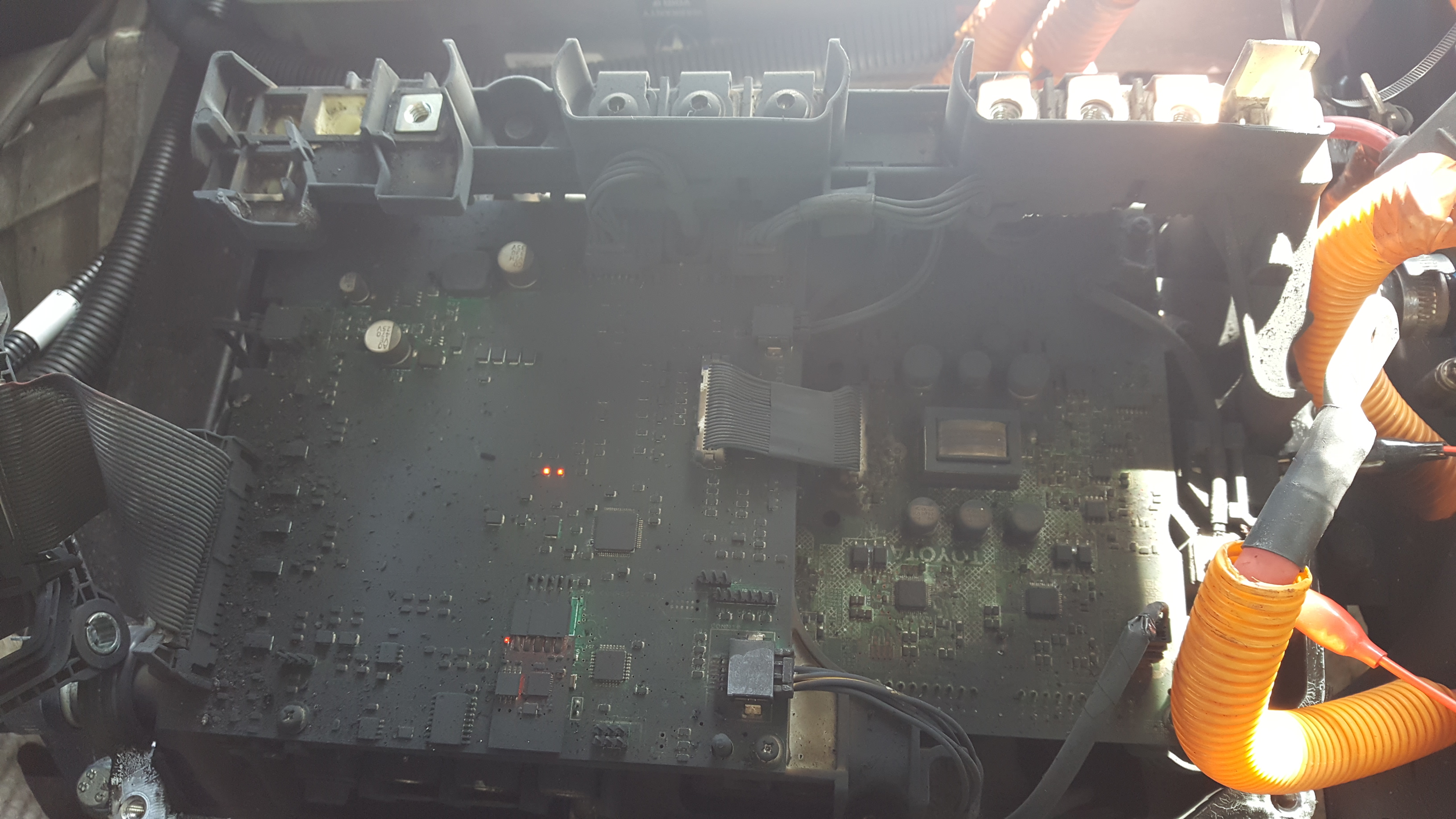

Sooooo....took the E39 for a little spin today. All going well. Lots of power. On the way back in home I hear a little pop followed by some smoke. This is followed by a bang and lots of smoke.
Oh no! The internet was right. The prius inverter is no good. I have failed. Farewell cruel world.

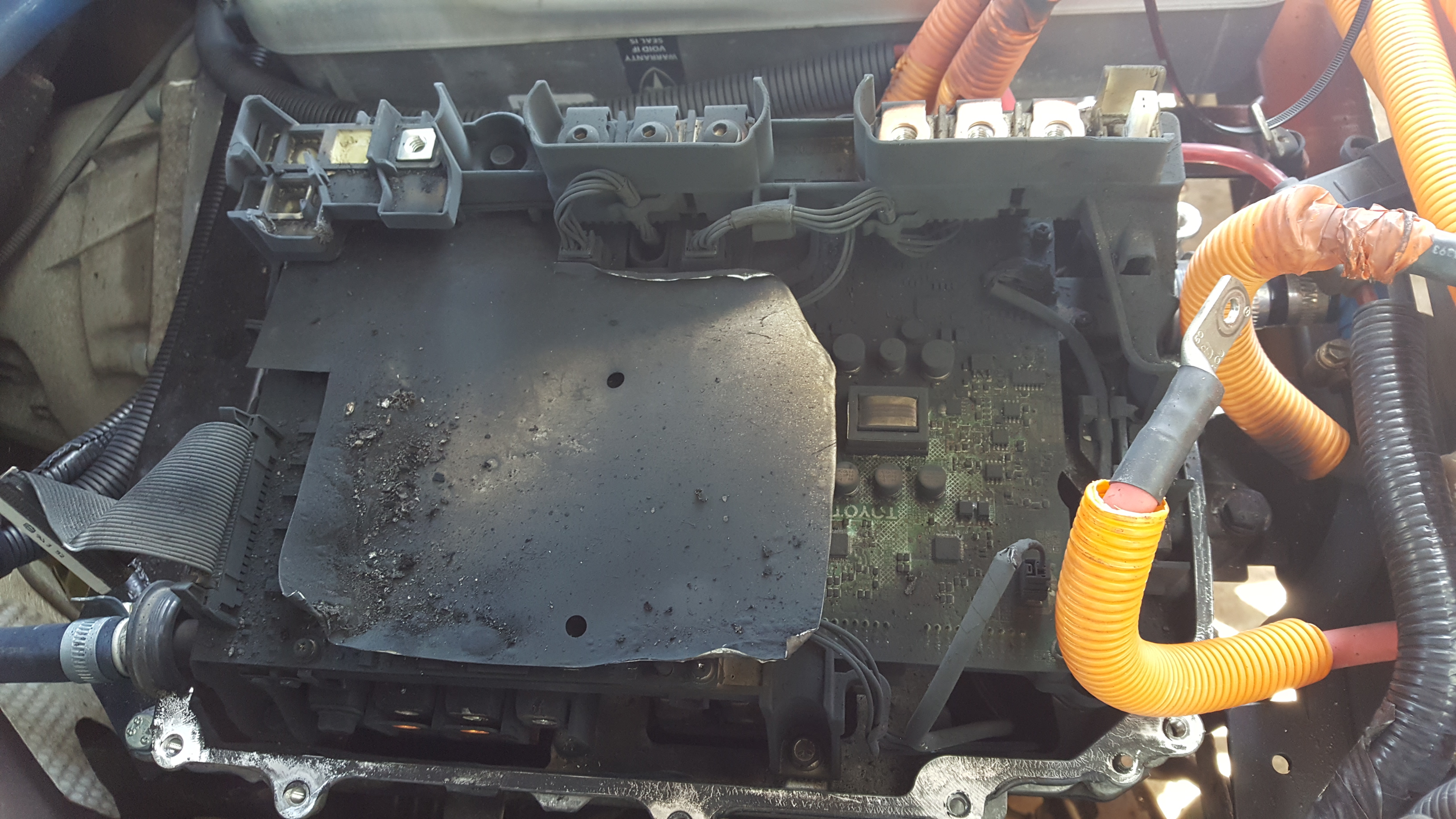

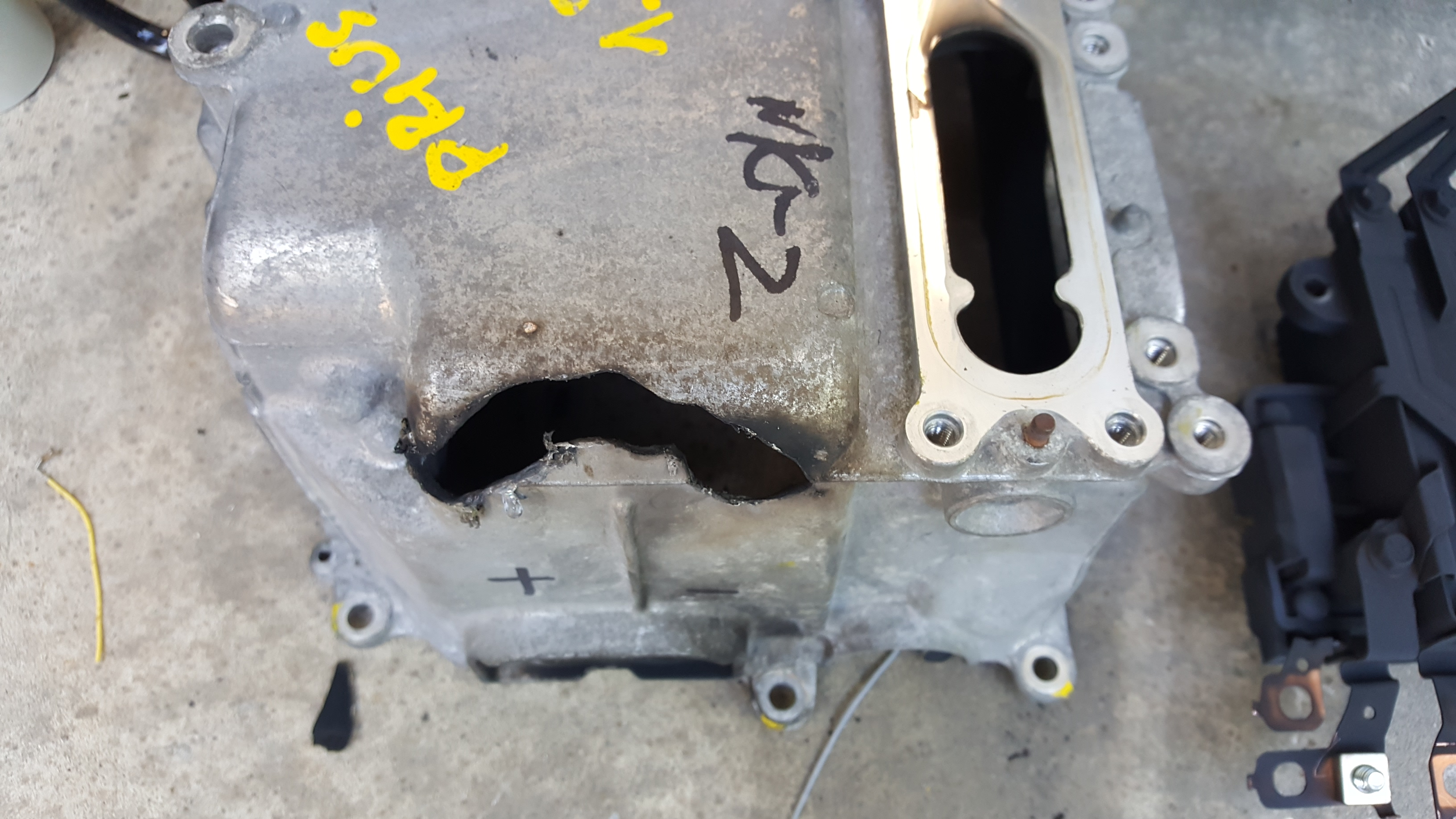

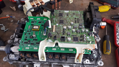

No. Despite there being a chunk blown out of the cover and the insides looking like a coal mine it still works. No I'm not gone around the bend finally, all 12 igbts are fine, the logic board is fine, the igbt driver board is fine. It starts up and makes AC.
What we do seem to have is a catistrophic failure of the main cap. My best guess is it didn't like 400v on the input side as I had the booster bypassed to get power to the dcdc converter. According to the rating printed on it the main cap is rated to 750v but the input side is only 450v.
Video later after I pick myself up off the floor.
....I mean WTF???? It still works...............but it exploded.................but it works...........Schrodinger's inverter!

But.....it still works....how can it still work??

Yep. Think I can see what may have happened. Looking on page 18 : https://info.ornl.gov/sites/publication ... b26762.pdf
I may have rang the inductor like a bell with nowhere for the voltage to go but into the 470v cap....

Scratch that. Looking at the xrays on page 25 it now seems certain the 0.5uf 860v filter cap blew.

Look at the LEDs still shining
So I don't understand - did you connect your 400V battery to where it says "201.6V"? Or where it says 201.6V - 650V? Who rings the bell? Are you clocking the DC/DC?

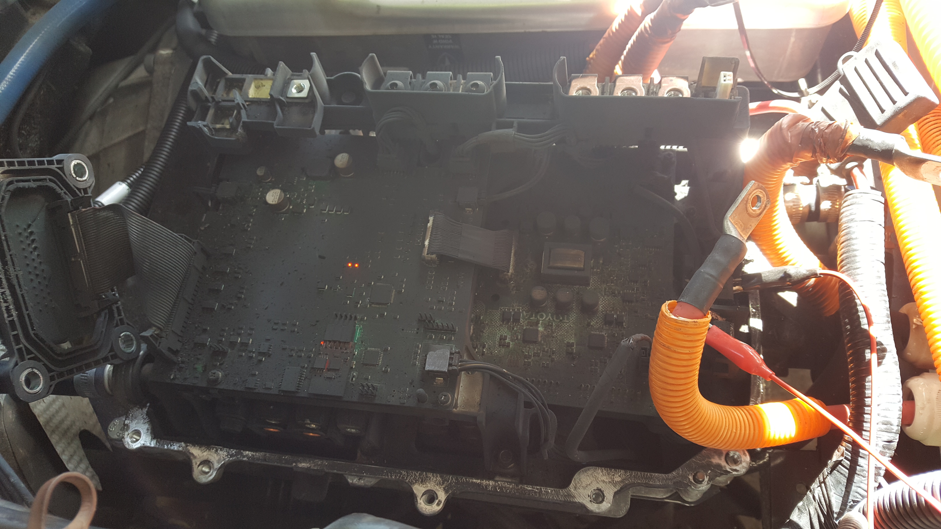

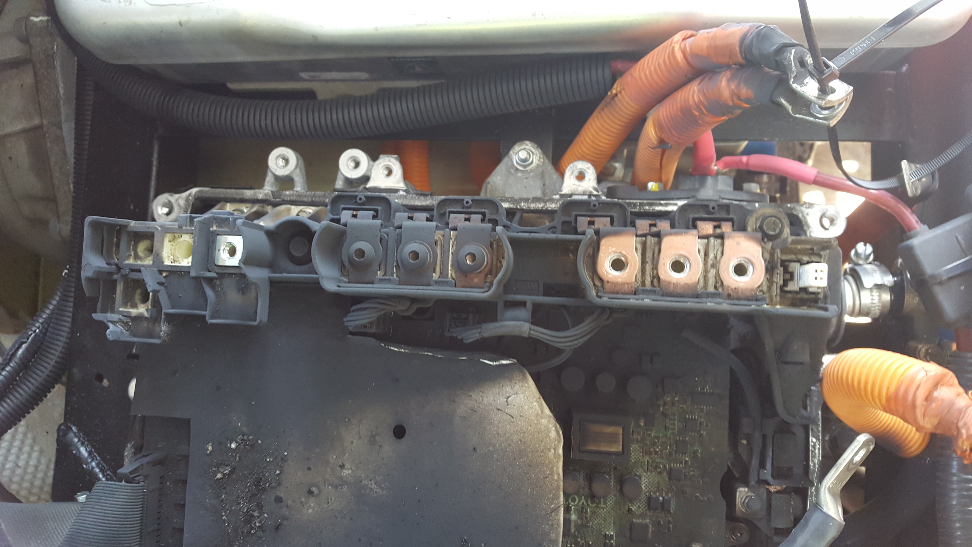

I had 400v connected to the main 650vdc bus AND the 201v input in order to feed the dcdc. I'm not running the boost converter but just speculating if the inductor started ringing with the ripple from the dc link. It does seem that the small 0.5uf filter cap is the one that failed judging by the xrays from the ornl document...

From experience, I can add that the GS450h inverter continues to run fine once the converter has finished exploding violently in its half of the casing, and spewed its guts all over the inverter components! Same black interior on mine, but still running.

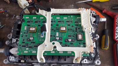

The board is now conformally coated

Puzzled question: what's the current return path form the HV to earth?
It's flashed over to the inverter casing, but I thought the HV battery system is supposed to float from the casing? Or maybe I haven't been paying attention.
Second puzzled question: how come the arc current didn't blow the HV battery fuse?

OK. So it still works, because other elements are rated higher than 450Vdc.
But this begs a question:
1. Is it safe to connect 360Vdc (96S) battery directly to 220Vdc HV input?
2. Do we now ignore inductor and bypass it mechanicaly?
3. What if we wanted to use inductor for charging? So we could use another EV200 contactor to bridge inductor for driving and later open the path for charging?

Haven't been welding lately? Arcs don't really use that much current. An uncontrolled 100A arc is already quite spectacular, especially at 400V, and wouldn't blow a fuse in any conversion.
