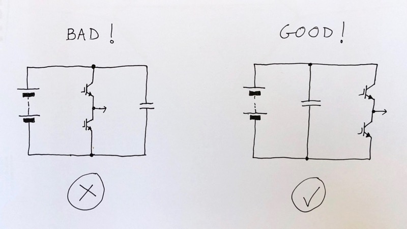

Ok. So I pose the question why did the smallest cap with the highest voltage rating blow? Why do we have a 0.5uf 900v cap in parallel with the big 888uf cap? Well, its a snubber. Designed to soak up excess spikes and ringing on the main DC bus. So there must have been excess spikes and ringing on the dc bus. Why? BECAUSE SOME MORON INJECTED THE HVDC INTO THE WRONG PART OF THE INVERTER THUS BYPASSING THE DC LINK!
I committed the cardinal sin of power stage design. By injecting the high voltage into the terminals I used we effectively created a star connection of battery, igbts and caps instead of a parallel connection. Its a miracle the car made it out of the driveway!

How is that possible? Will you enlighten us?
- Posts: 4006
- Been thanked: 1136 times
Re: Can't Kill A Toyota Inverter
Video shortly. Bit too much to type:)
Edit : Short version V=L di/dt

Hmm, thats exactly how my Polo inverter is wired up. The battery cables connect right to the same terminals as the first snubber on the right. No blow for 7 years. Maybe the low power (500V, ~100A DC) and 10 Ohm gate resistors are beneficial there?

Would be interesting to stick a 'scope across the snubber terminals and see what sort of voltage spikes are on there...
Hi!
I think the key in your configuration is that your large caps are closer to the igbt:s. Yo have also 3 snubber caps. Damien connected battery bethween igbt:s and almost all caps.

Yes definitely worth considering, we will have to review the internal layout of the caps. The original e46 conversion using the GS450h inverter from a few years back used this battery connection point and reported blowing up an inverter, but I’m not sure if this was a control issue.

In the gs450h that is the most direct connection point to the main cap, can't get closer to it and there's no other "side" to it.Dilbert wrote: ↑Tue Jun 09, 2020 10:28 pmYes definitely worth considering, we will have to review the internal layout of the caps. The original e46 conversion using the GS450h inverter from a few years back used this battery connection point and reported blowing up an inverter, but I’m not sure if this was a control issue.
Can you short the boost converter and find large enough contacts for feeding enough current there? It's after all where Toyota makes the power go through, there's going to be more capacitors there to offset the cable inductance...

Please folks lets not draw a parallel with the GS450H inverter. It's a different beast and as celeron55 said we are using the correct terminals in any event. I was not aware of the original E46 guy having a failed inverter. No surprise I suppose as we can't be sharing info. Also if I'm remembering correctly he ran two volt packs in series as of course you need 650v....thus leaving very little headroom on the cap voltages for transients.

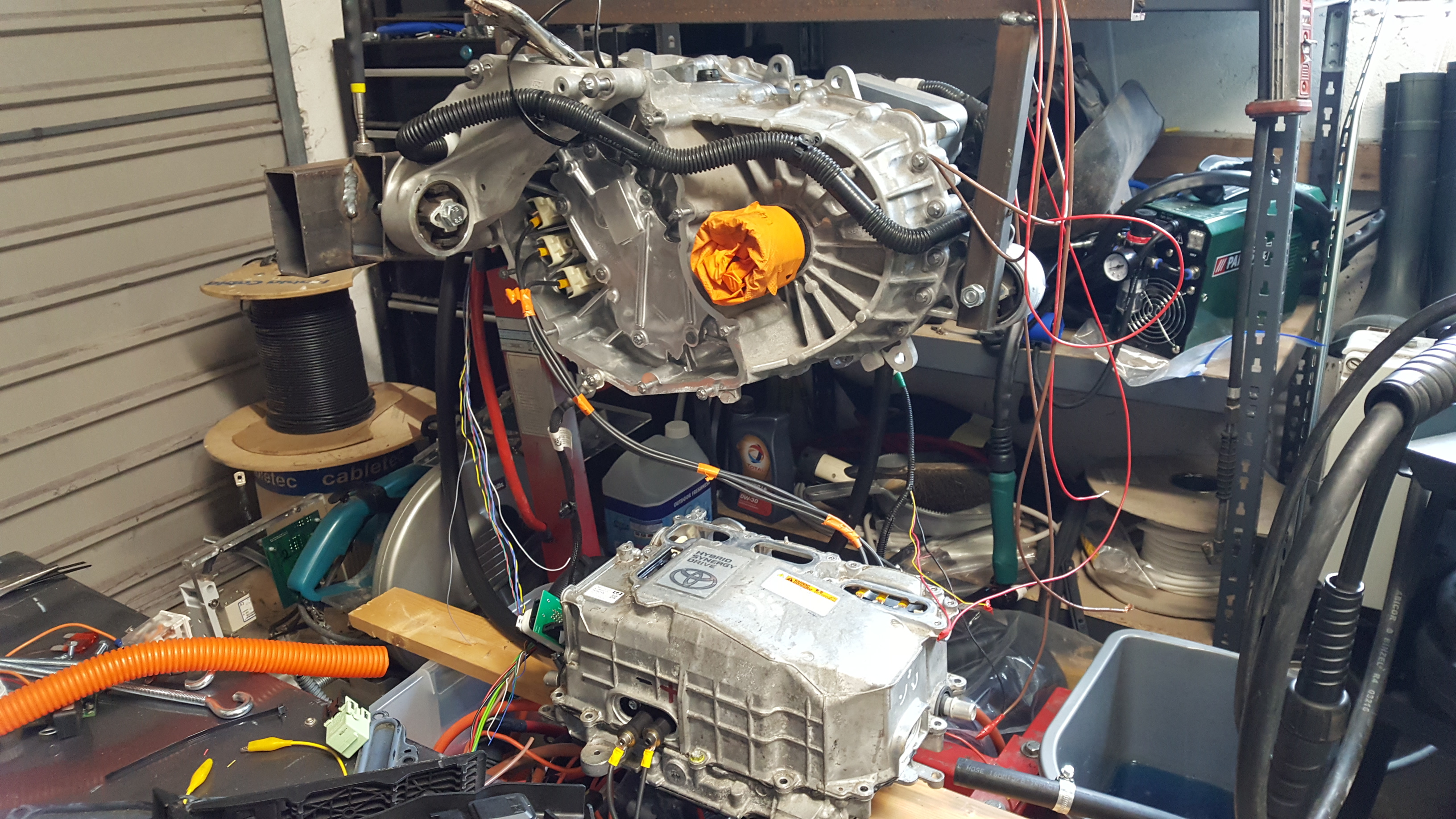

Tested on my Yaris inverter and model 3 drive unit. Muppet code works and lets hv through to the dcdc.
